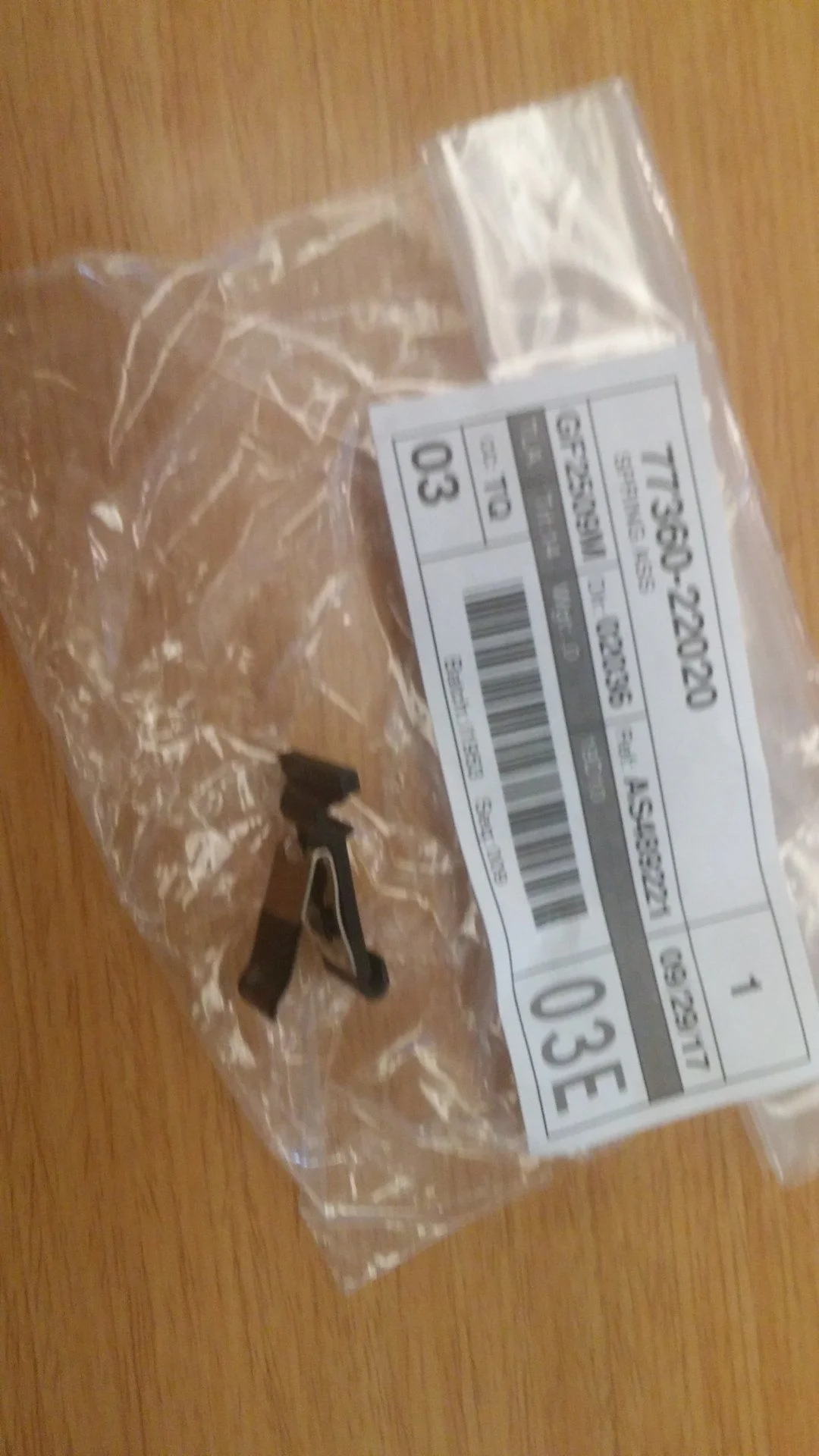

I took for granted when I pulled my gas door lever my door would dependabily pop open. T he little gas door spring clip went MIA and I had to use a Carmex tube as a wedge to help get it open at gas stations...:hillbilly:
finally remembered after 3 fill ups to pick up the clip - back to popping! :D

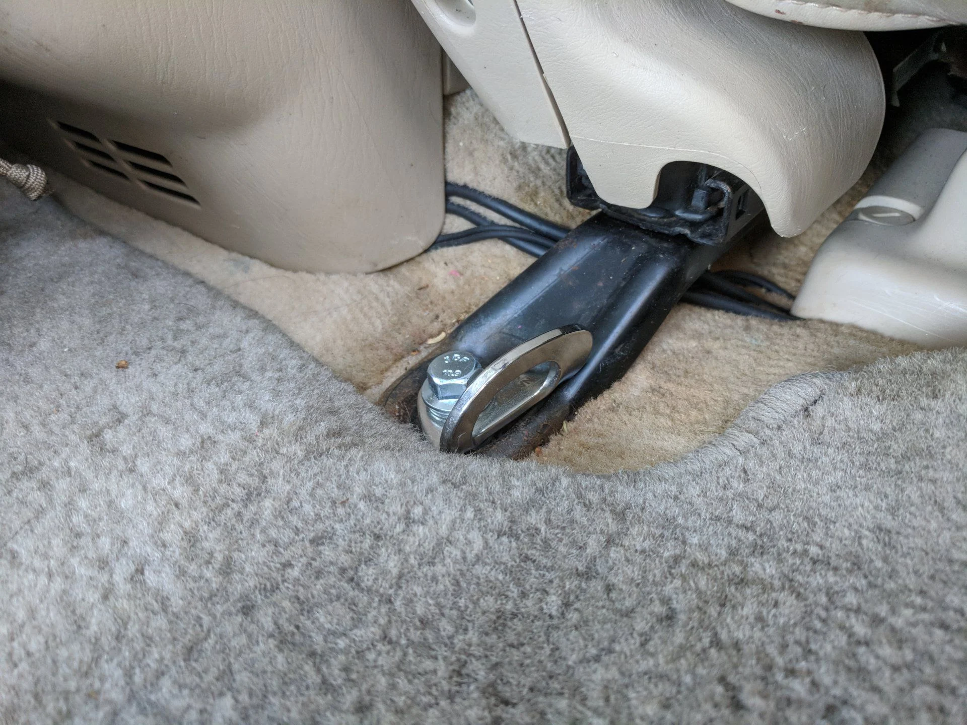

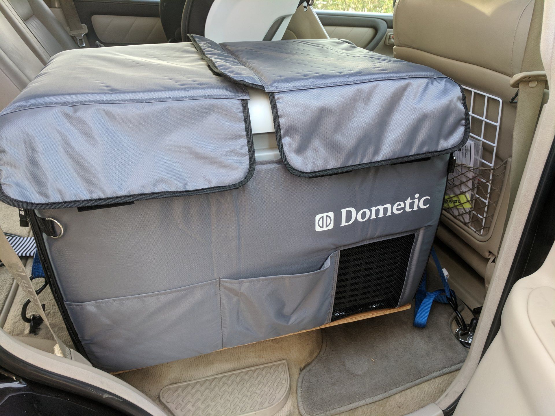

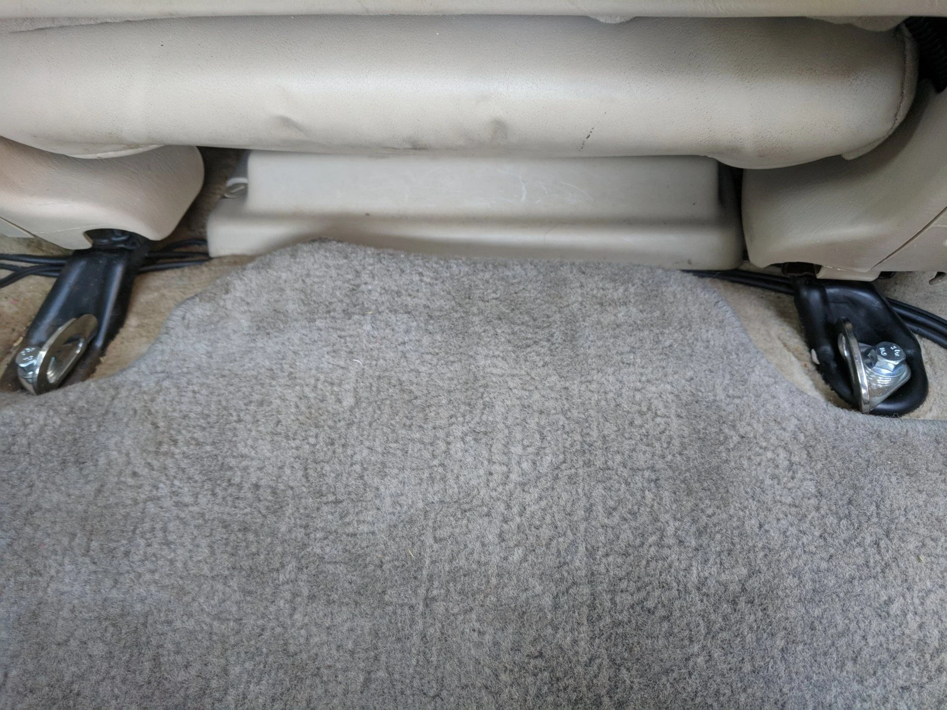

I took out the single second row seat a while back so I could use that spot for my fridge. Didn't like the fact there was no real good spot to tie down the fridge behind the front seat. I added a couple tie downs to the seat mounts. Used some climbing anchors and replaced with longer 10.9 bolts, washers and spacers.
View attachment 1585513 View attachment 1585514 View attachment 1585515
That’s great! I am going to have to copy that on the drivers side! Thanks!

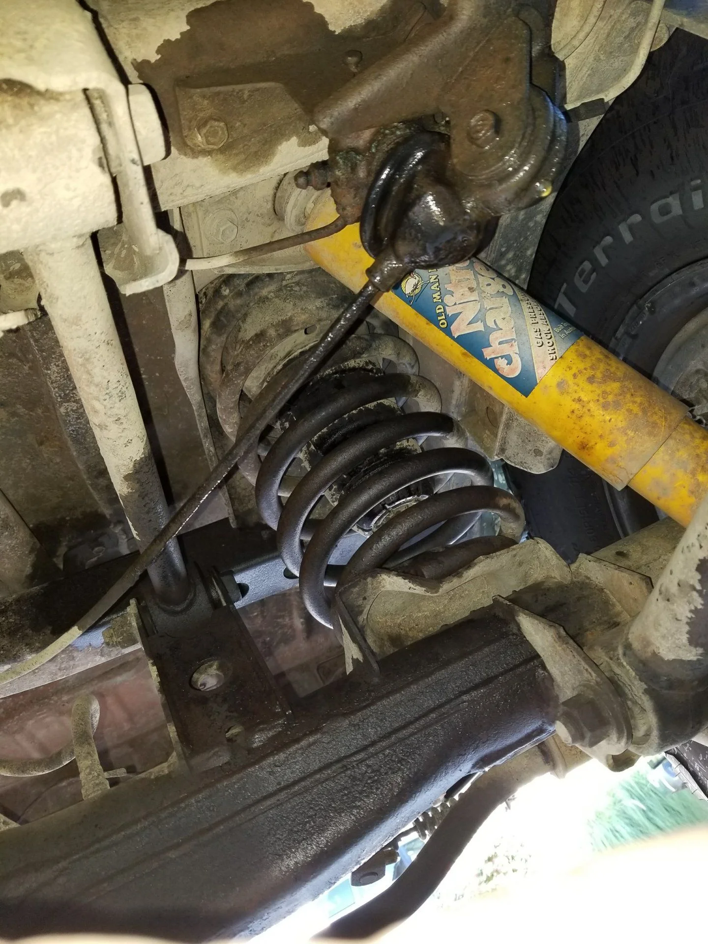

Well, after 2 1/2 years on the shelf "OSO" has finally got the OME 850/860 lift and shocks I bought from jp_waltz.
Now I have to decide if I install 305's or 315's. Checked the date code on the 285's LTX M/S that are on her and they are from '05. Looks like timing was good with this one.

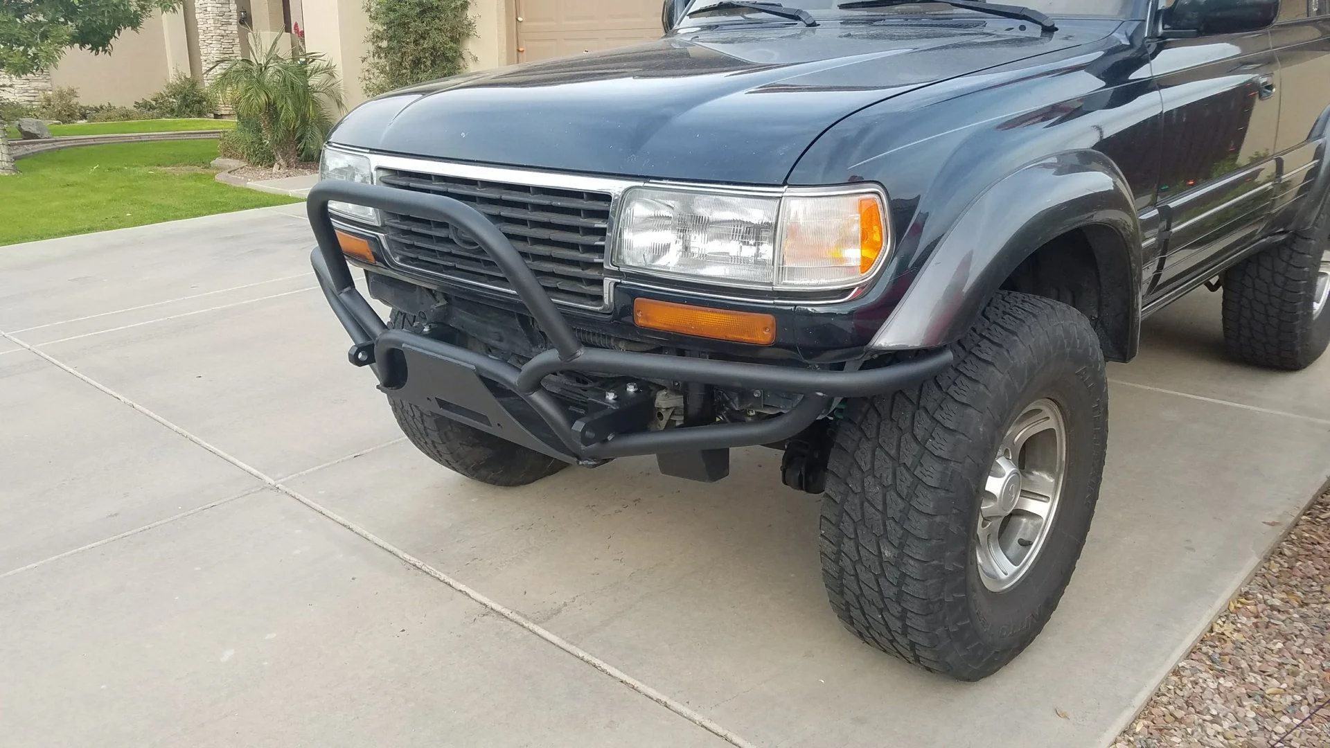

Four years in the making. Four years of b'day presents from the wife let's call it.
Mike at BIOR was great to work with. Local powder coat did a great job as well.
