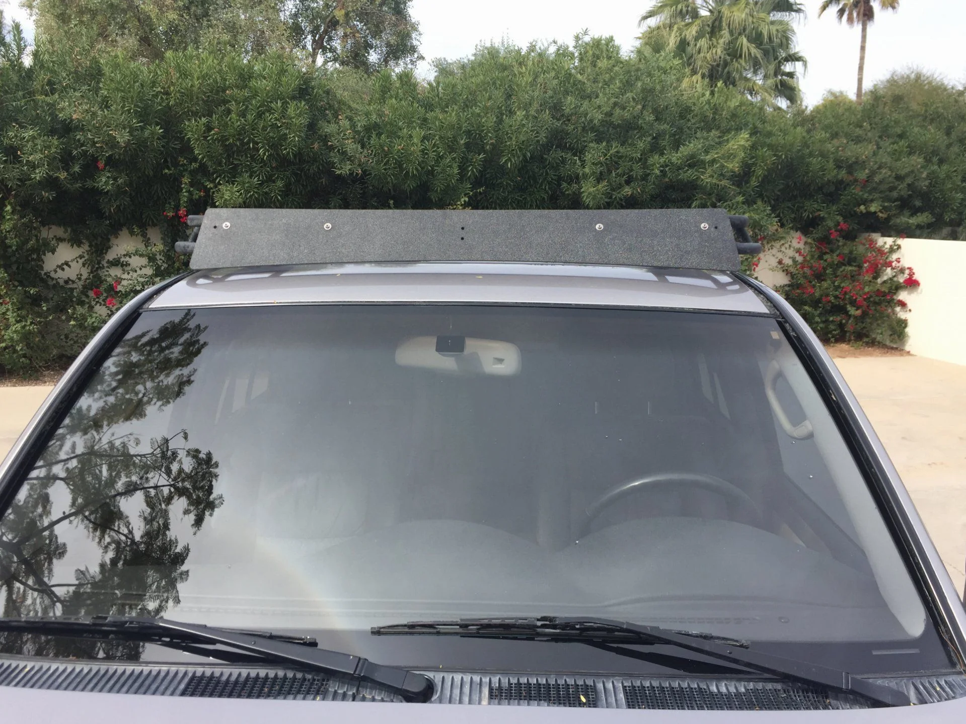

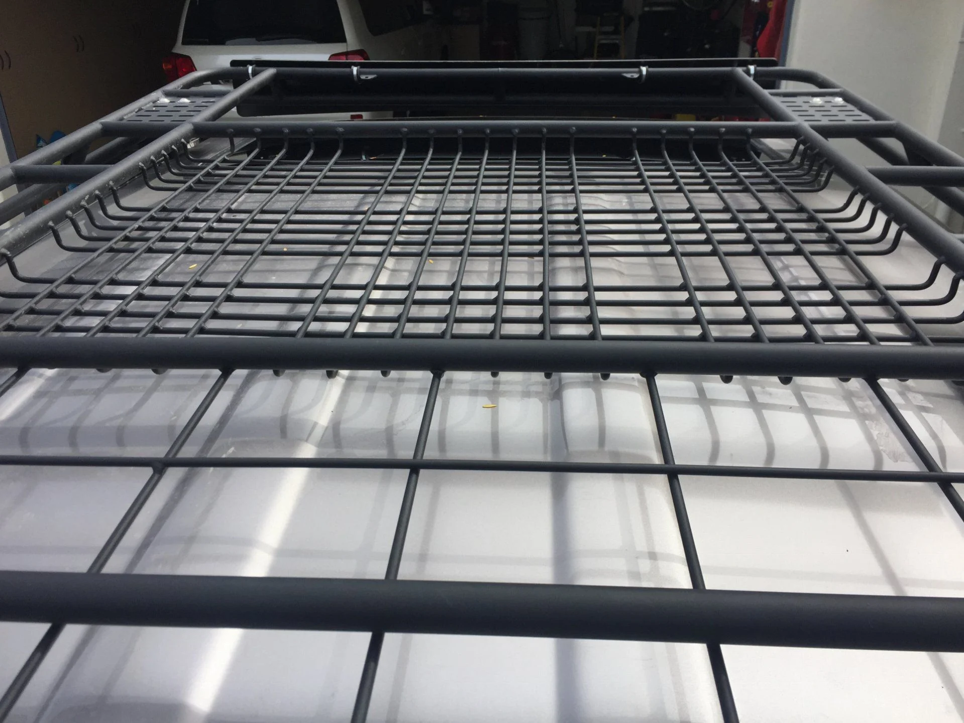

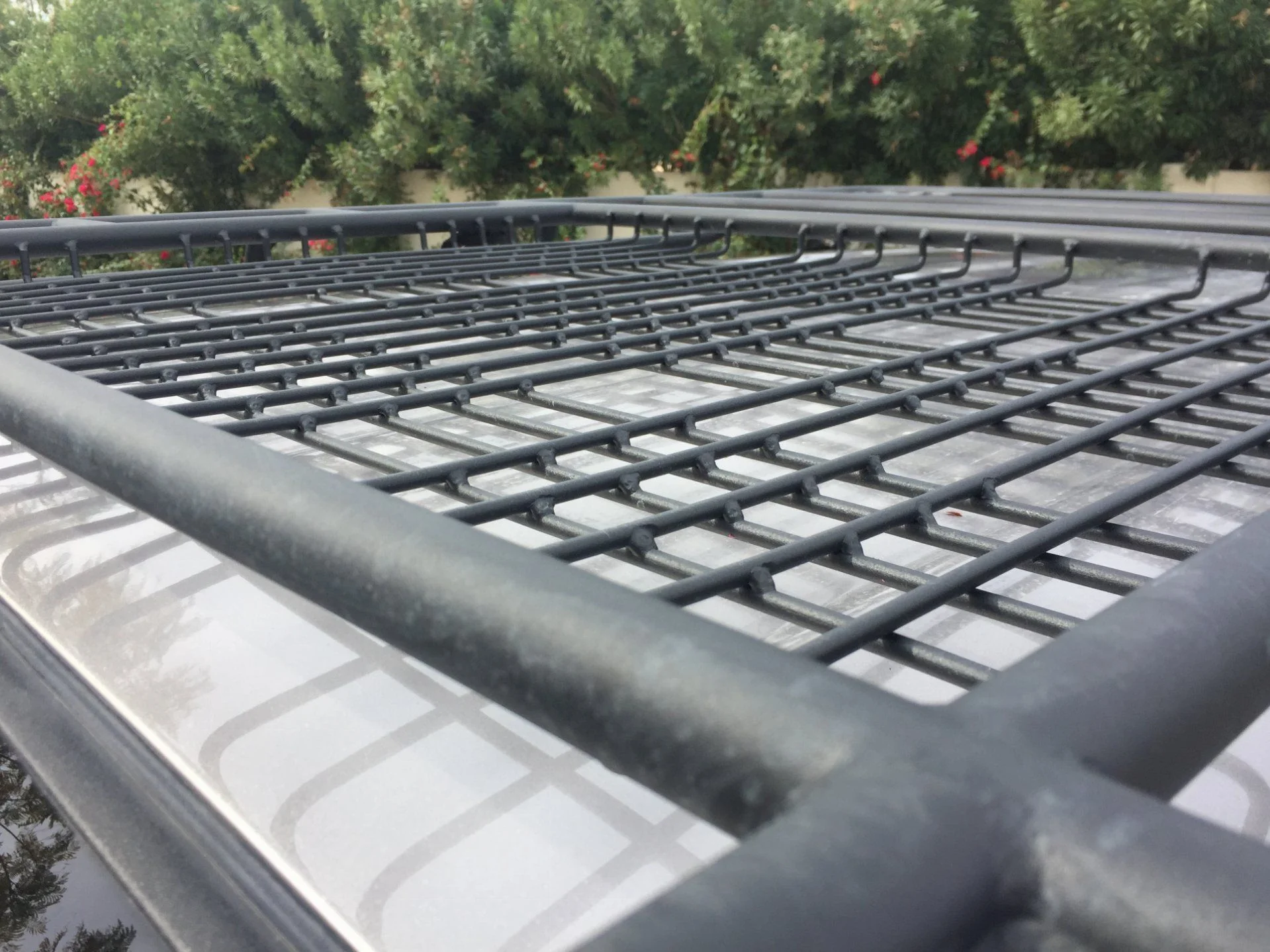

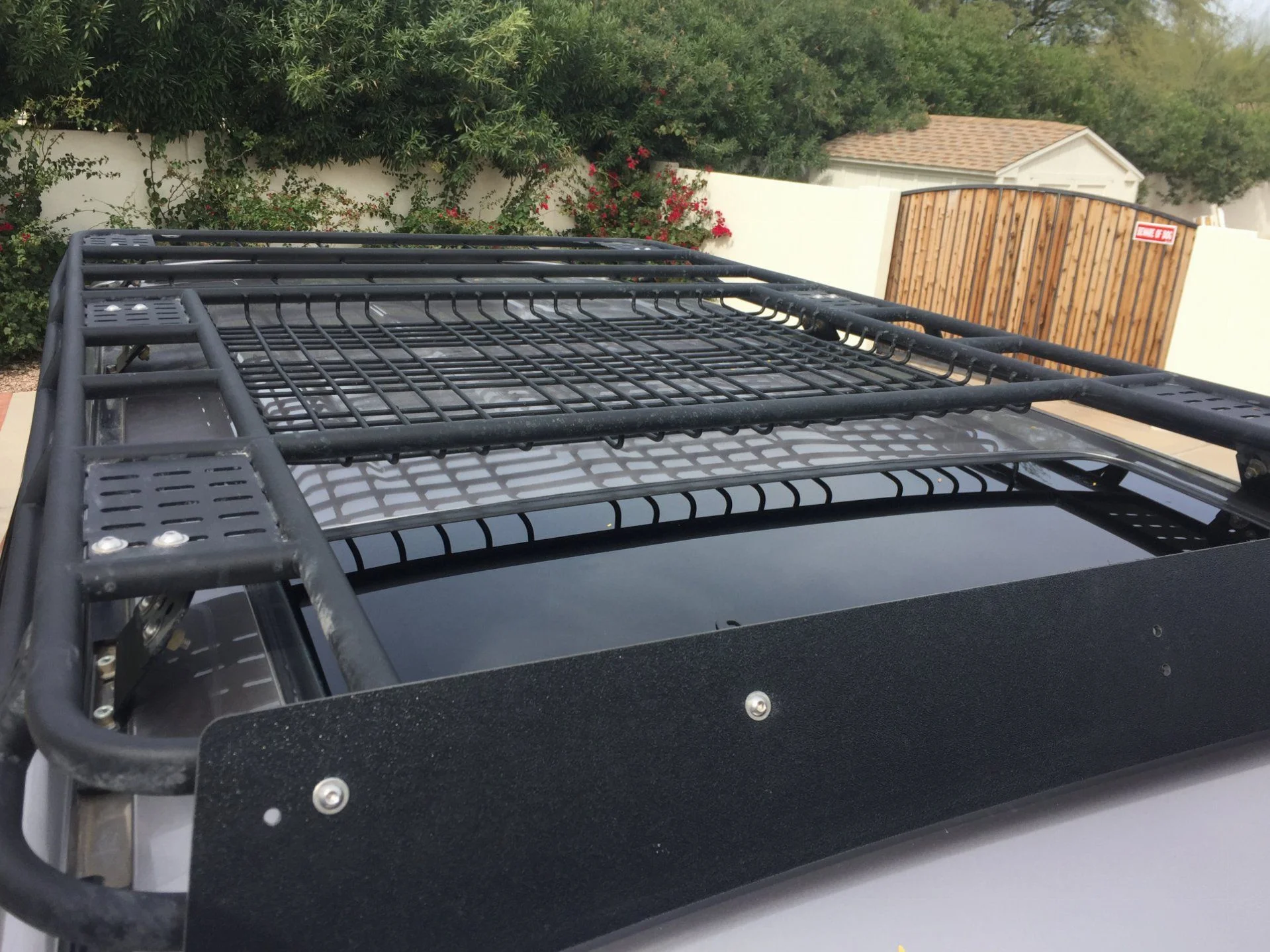

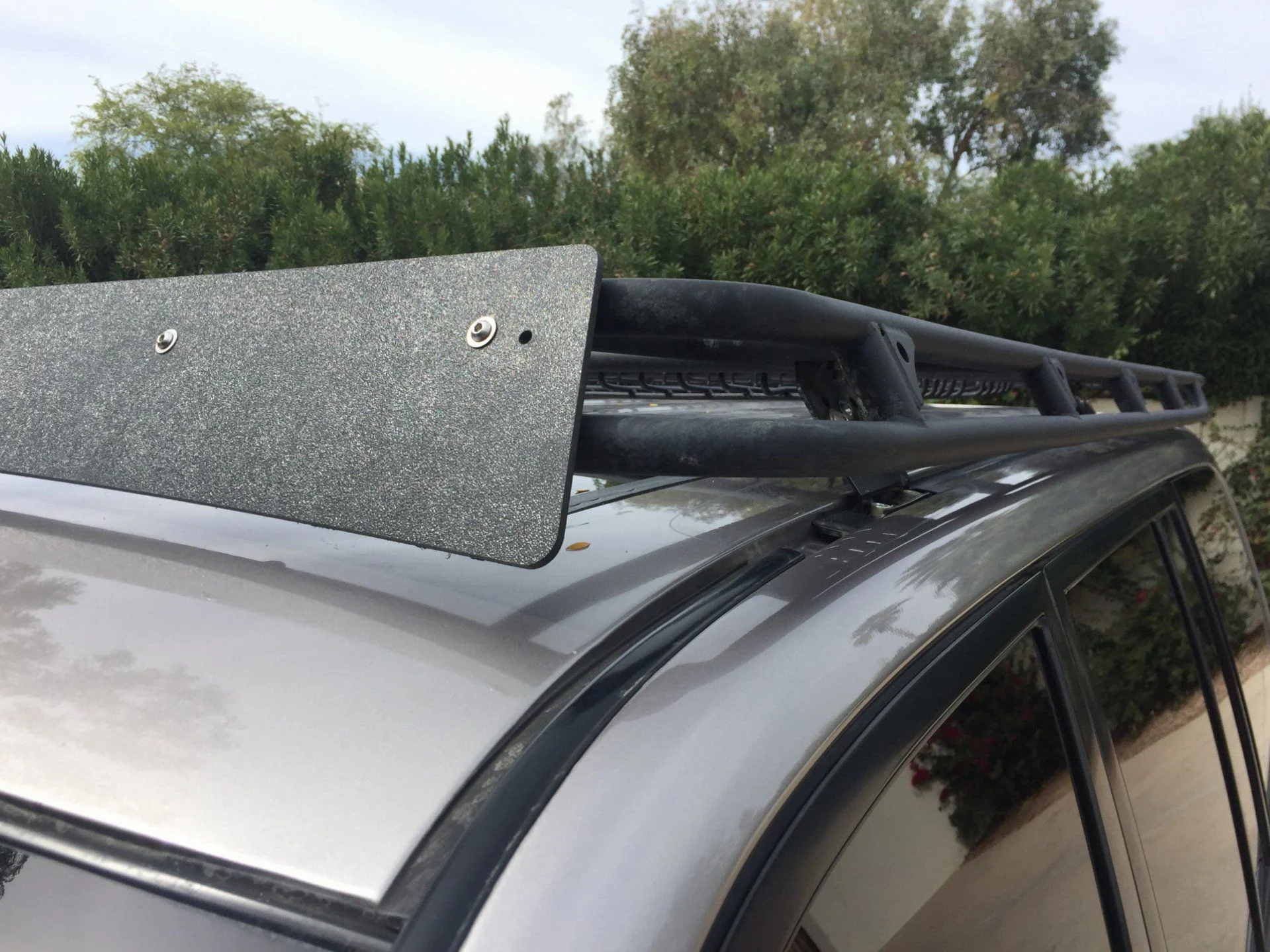

Finally posting photos of my Gamiviti roof rack on the 2006 100.

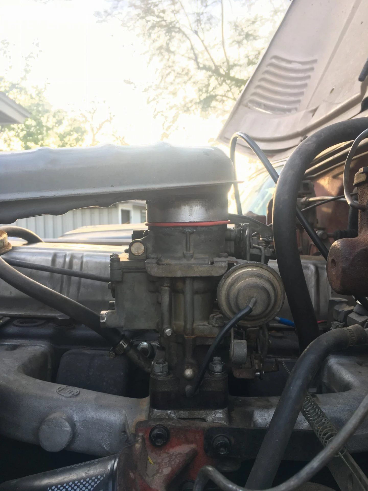

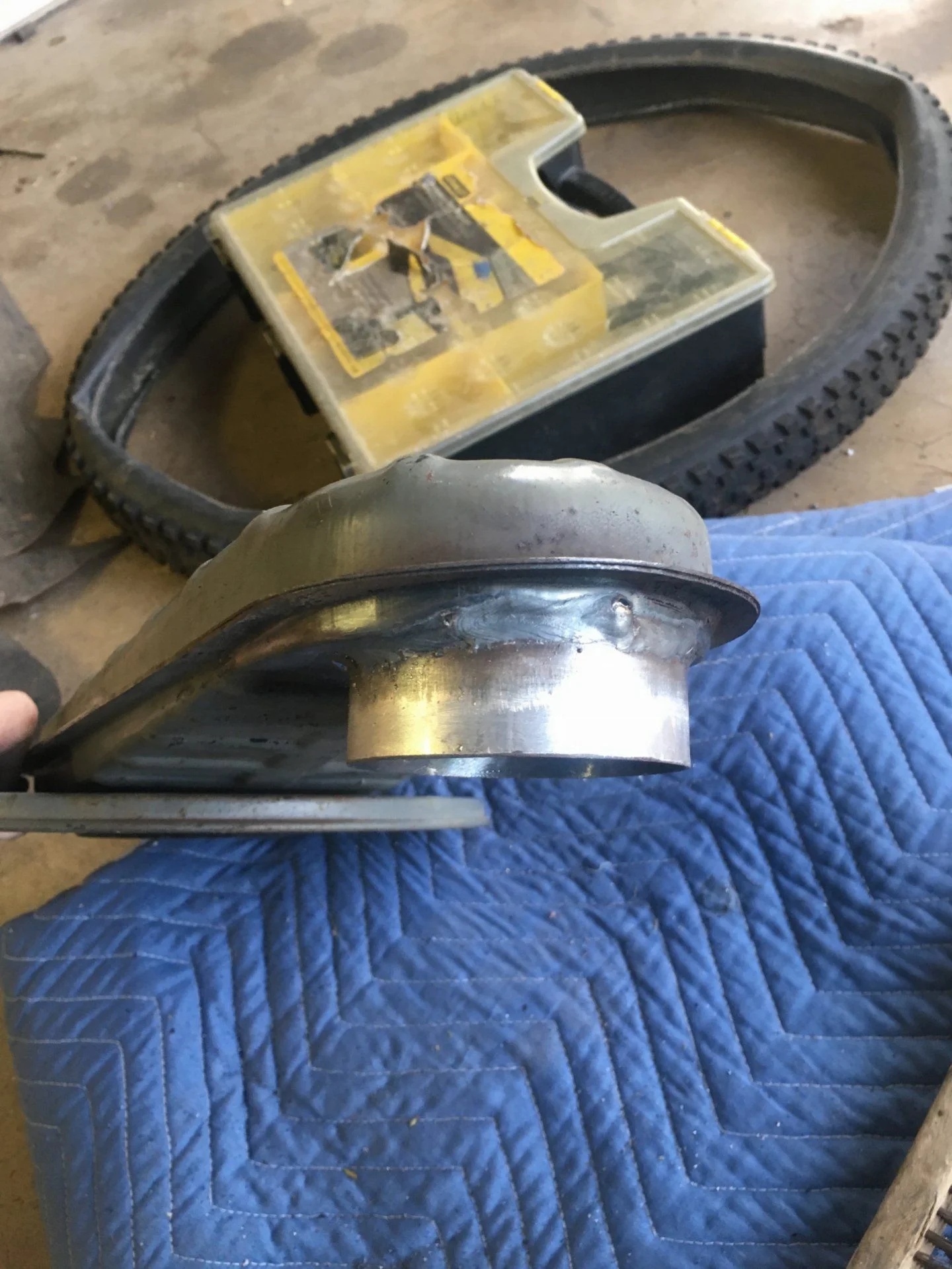

I finally tackled my air cleaner modification I've been wanting to do since I built my F motor. I've hated the way the stock air cleaner mated with the carb. The outlet on the air cleaner was a lot smaller than the carb inlet. It didn't line up right and the boot that tied them together was a joke. I've also been waiting on a part for my old Miller 35s so I could get this done.
Basically I cut off the air cleaner outlet of the stock lid and welded up a 3" ID piece of tubing to slide very snugly over the carb. O-ring is just a little extra insurance. Very happy with the turn out. Now if I can just get rid of this off idle stubble I'll be very happy.

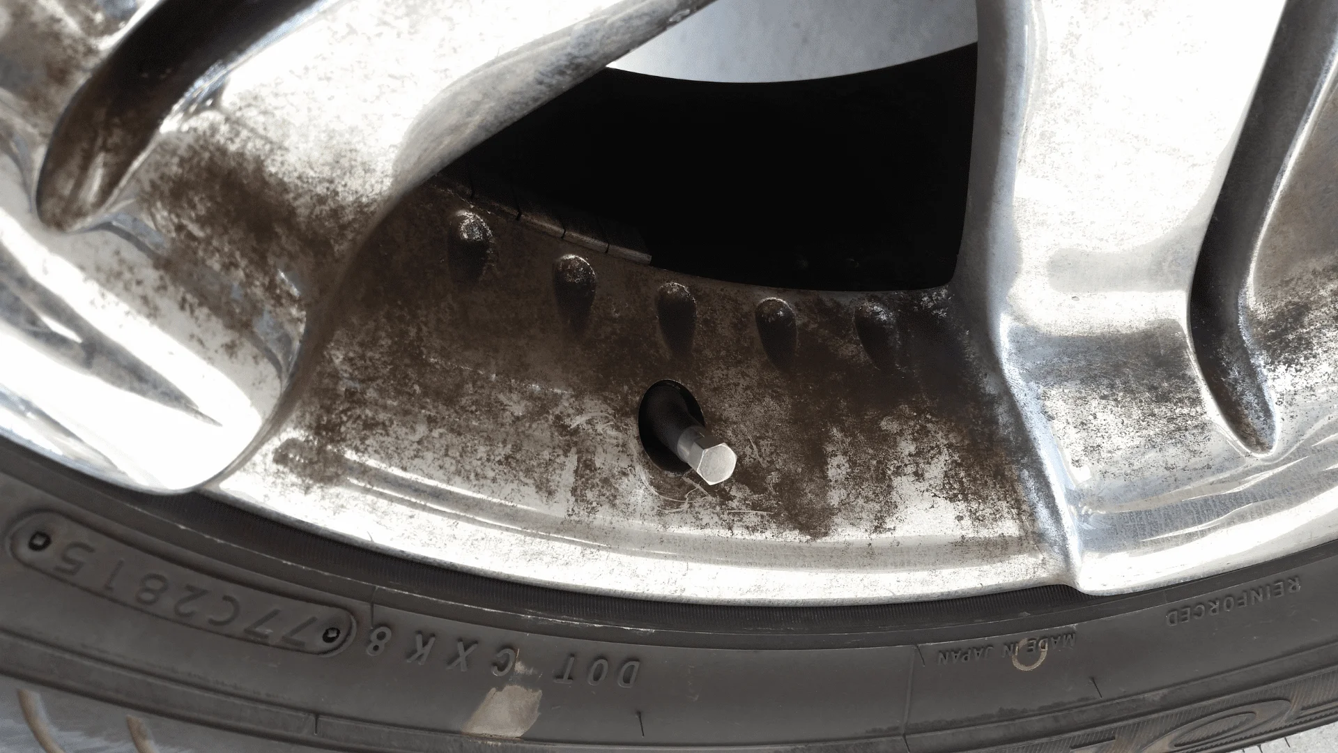

On my Way home from picking up some take out from The Dubliner Friday night, I noticed this...
