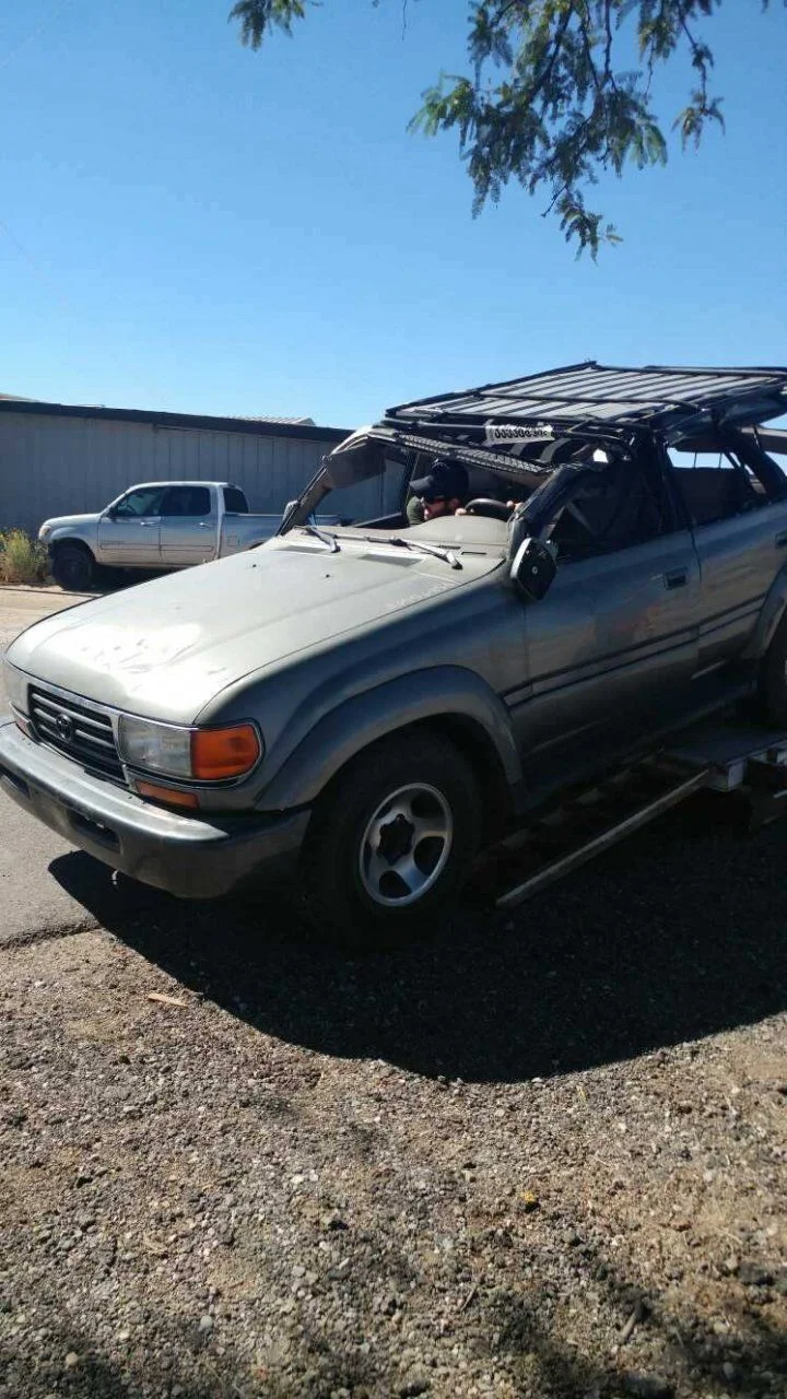

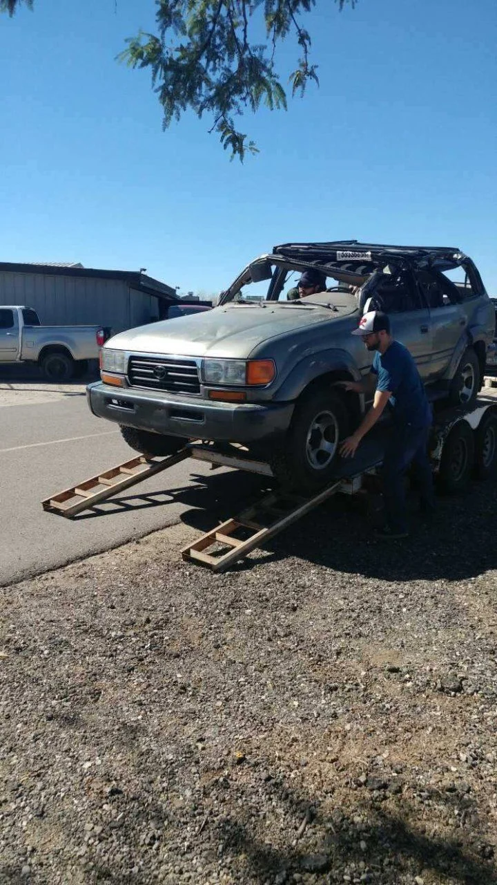

Picked up my new purchase thanks to @Aids10. Dropped it off at a friends shop and will start stripping it...

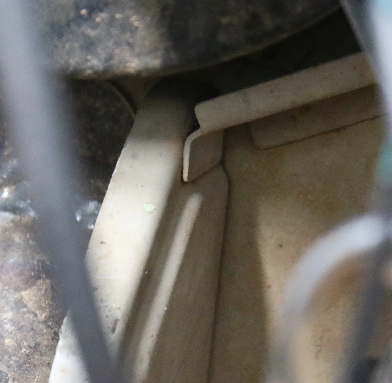

Piece of cake to modify your firewall - all Toyota did was cut the vertical brace back below the booster and add a diagonal stiffener strip.
That was a very short change. 72 model were a change from 71. Toyota updated how they produced the 4X series, stamped pieces out of thinner metal and adding ribbing to strengthen. Not sure if the design changed in 72 but by 73 it had. Picture of my 73 I took years ago showing the single new rib that came up and around the clutch mater cylinder. I removed one from a FJ40 with the idea of using it on my 68. Ended with another FJ40 then another that were already set up with the booster decided to just go thru 68's original brakes and call it good.

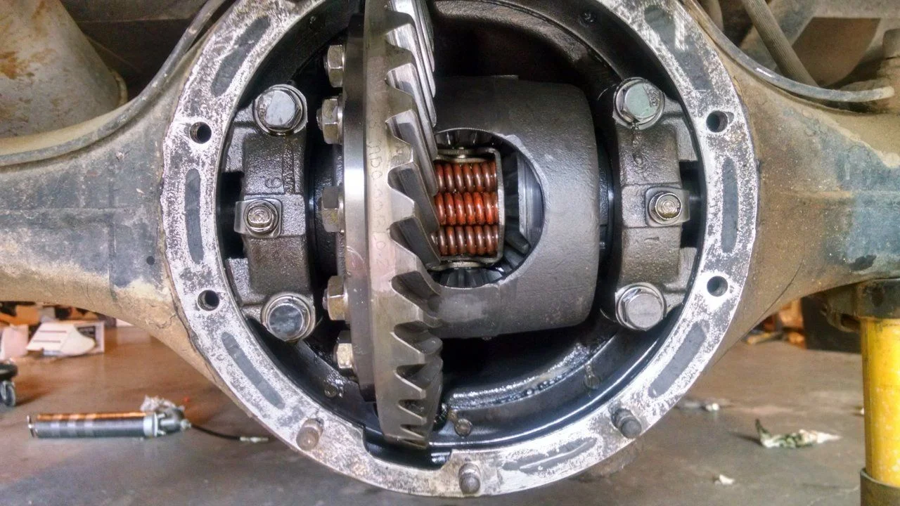

It's hell getting old and forgetful. I put an Auburn Limited Slip in the rear of my FJ40 about 15 or so years ago. Anyway, for the rear disc brake conversion you have to pull the axles. I drained it and popped the cover, and said, oh s***. I had no idea how to even find the clips with that LSD in there. I had to call my mechanic buddy from Jim Click to remind me how to do it.
