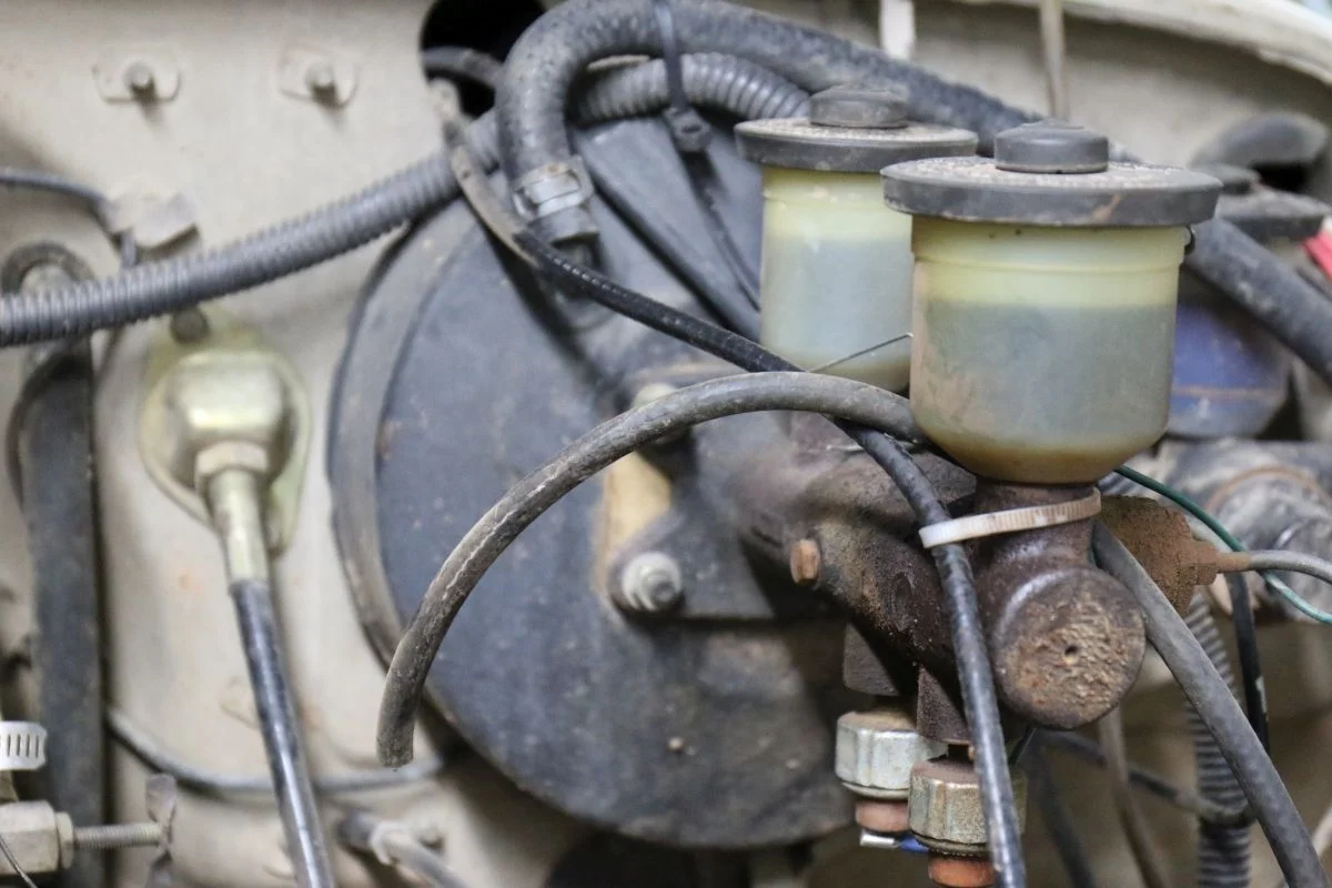

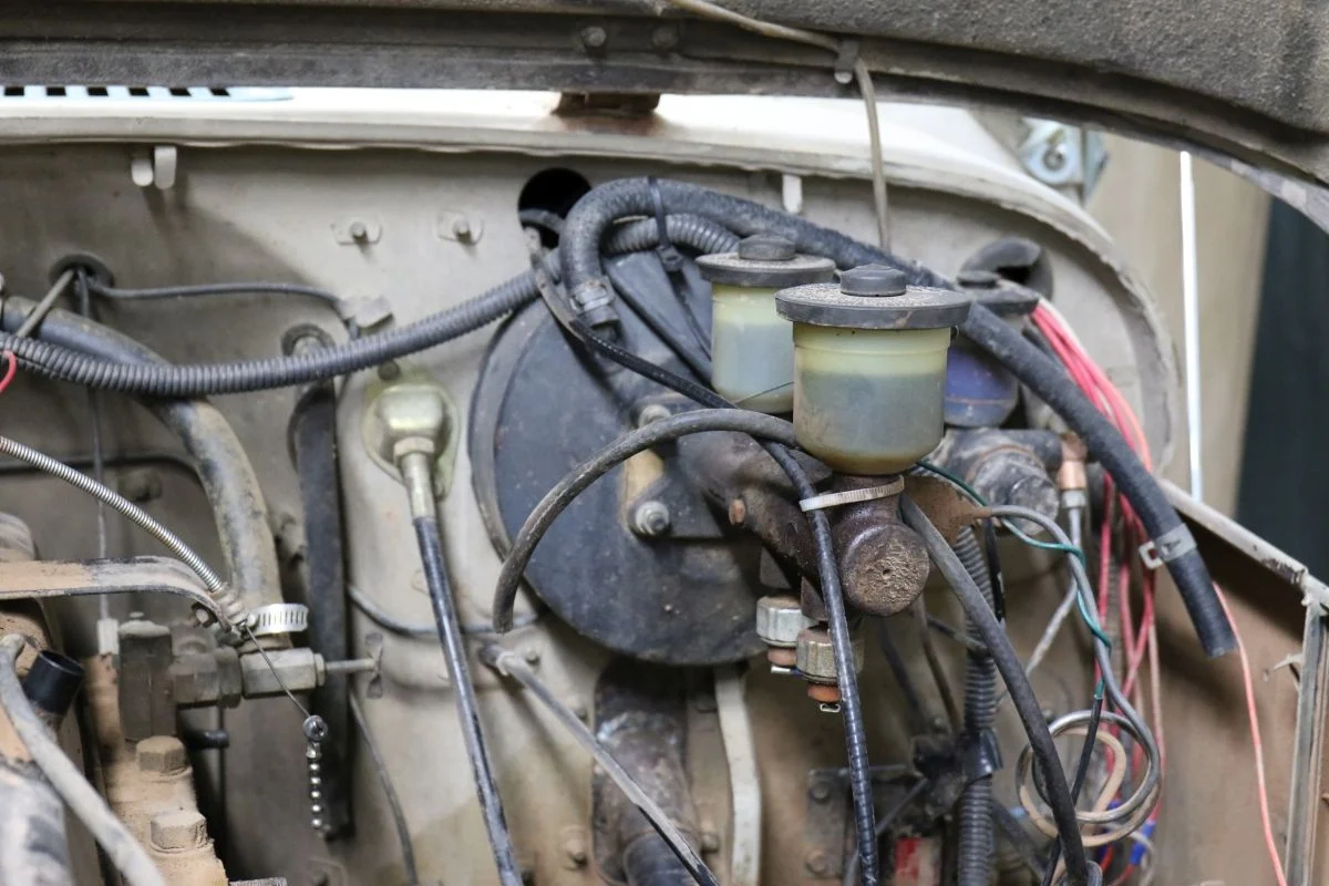

It will NOT fit. The diameter is too large (10 inches). It won't fit past the clutch master, and it also covers the hole in the firewall where the wiring harness comes through.
It is substantially larger then the one on my 74 Pig.
:hmm: Now really curious how the 86 booster from a mini truck compares to the booster from the 84 4X series. Tried looking up booster off the 86 on a online site and came up empty thinking it's NLA in the US market. I do know the clutch master changed in the early eighties, maybe to clear the booster. 8/80 the booster changed design from the big dual diaphragm to a single diaphragm.
My 84 pickup truck booster measures 8 1/4" and fits fine.
All bolt holes lined up on the firewall and the original 71 FJ40 master cylinder.
I picked it up in a Tucson junkyard.
Guessing the original master attached too that booster was set up for disc brake front and drum back. Probably a nice set up when adding disc brakes up front with the low power stock engine and not much bigger than stock size tires. Like the OEM power steering not the best set up for a rock crawler.

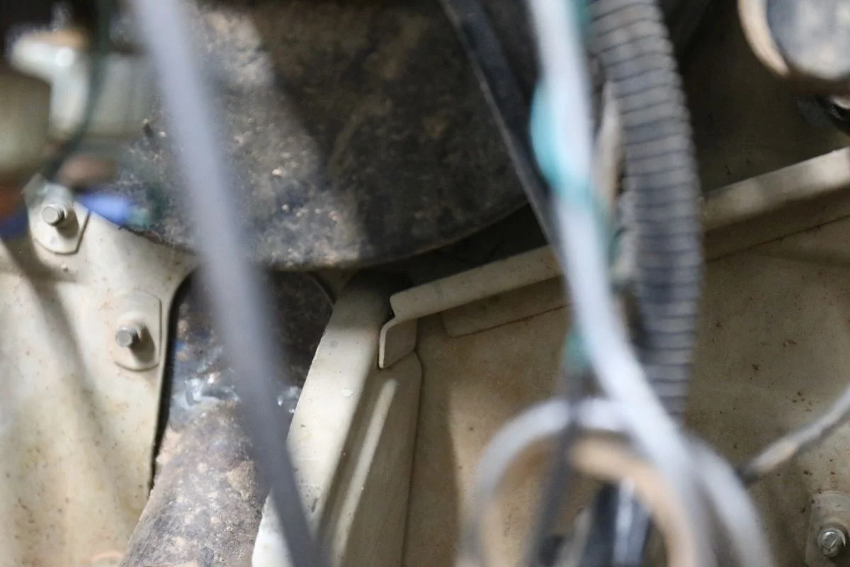

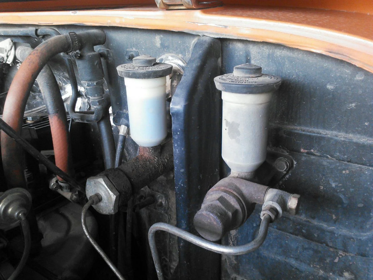

Difference of 2 years... '69's have the added work of what to do with the firewall stiffening member that is in the way.
Piece of cake to modify your firewall - all Toyota did was cut the vertical brace back below the booster and add a diagonal stiffener strip.

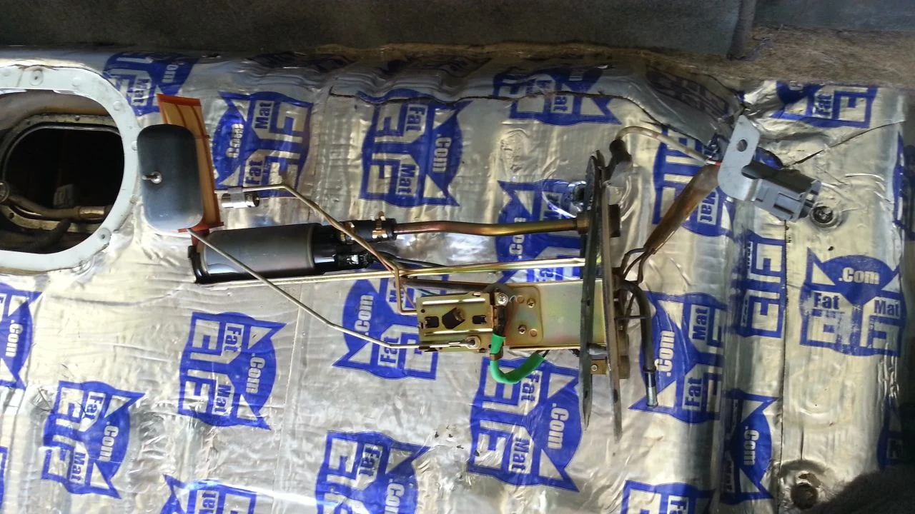

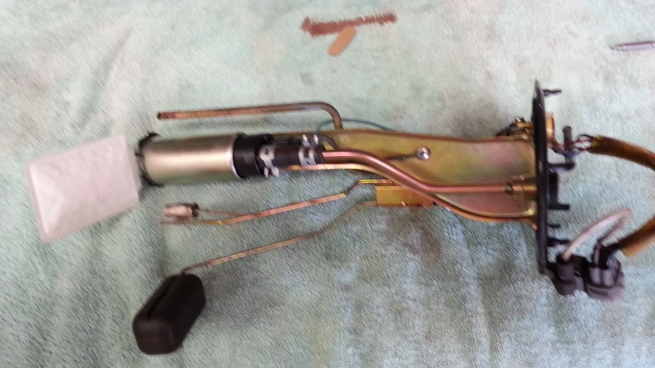

Well still chasing the fault of the 'cruiser flat-lining. The PO said he had the FP replaced because a shop said it was bad. From what I found all the shop did was replace the space in the PO's wallet with air.
Not a horrific job but as usual, one good thing turns to something else.
It appears that the interior guy installed the seat bolts with a air gun, 5 of the 8 seat bolts are stripped. Anyone know what size/pitch these bolts are? Need to buy a metric tap and clear the holes and get new bolts. Found the seat bolts at Mr. T (P/N 90119-10493) but nothing that says what size they are. So for now, more free space behind the front seats :)
P.S. "OSO" also got a new fuel pump relay and load resistor.
