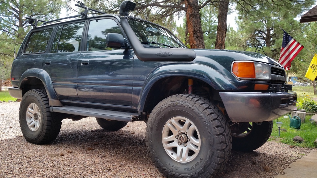

New tires/wheels, I was running 315s on 16" wheels and wanted to step up to a 37 so I went with a 17" wheel for more options .

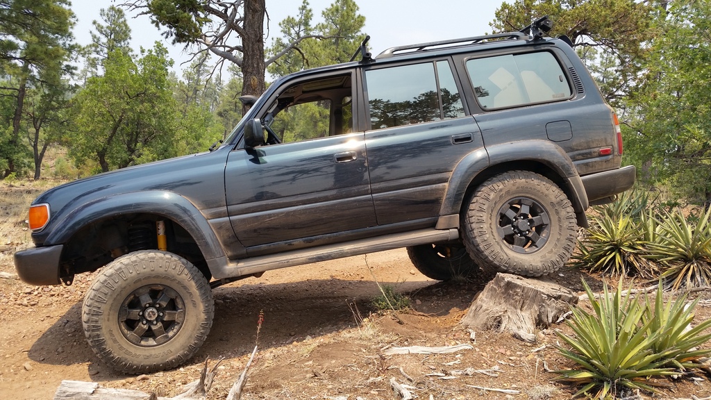

Added spacers to spare wheel holder & tucked the new 315 up in there higher/tighter
Next project: need a roof rack/basket!
Those Sequoia wheels look great with the beefy Toyo's. Any trimming or spacing needed?
It has 1.5" wheel spacers that I was using with the FJ Cruiser wheels I had on it before, I've heard that you can run these wheels without the spacer but it looks like it would be rubbing the frame in back to me. I don't anticipate much trimming but we'll see once I get it flexed out. I'm on 5" coils front and rear now, I will need lower my rear bump stops some.
Very nice. I'm currently looking for these wheels myself for future upgrade. Well done.
