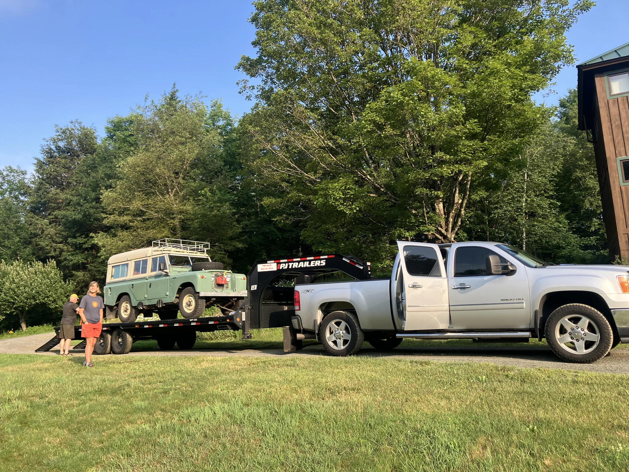

Made more room for my HZJ74 in my garage!.....It fit before but its roomier now....To accomplish this I actually sold something....Sold this '67/68 Dormobile.....Call me a flipper, we only owned it for 27 years....Hmmmm, on closer inspection my wife doesn't appear to be too sad to see it go:D! Its headed to Alaska.

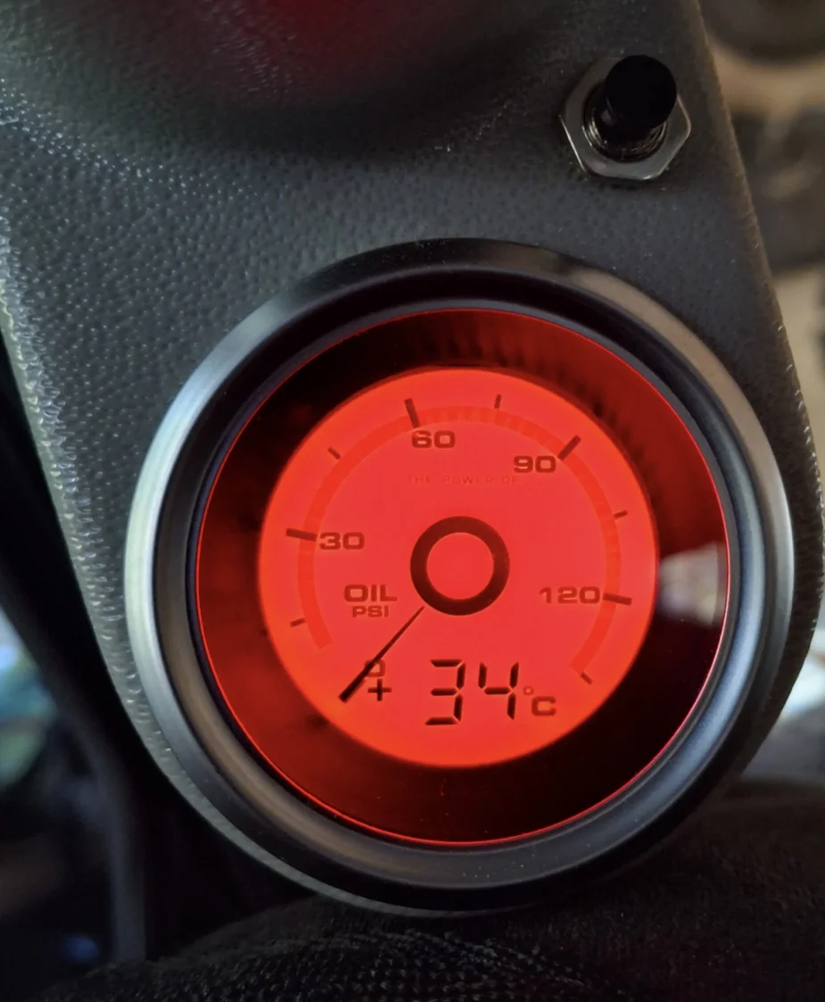

Water temp (~93 degrees F) at 6:00pm on a Land Cruiser that’s been parked in a garage all day. 😩
