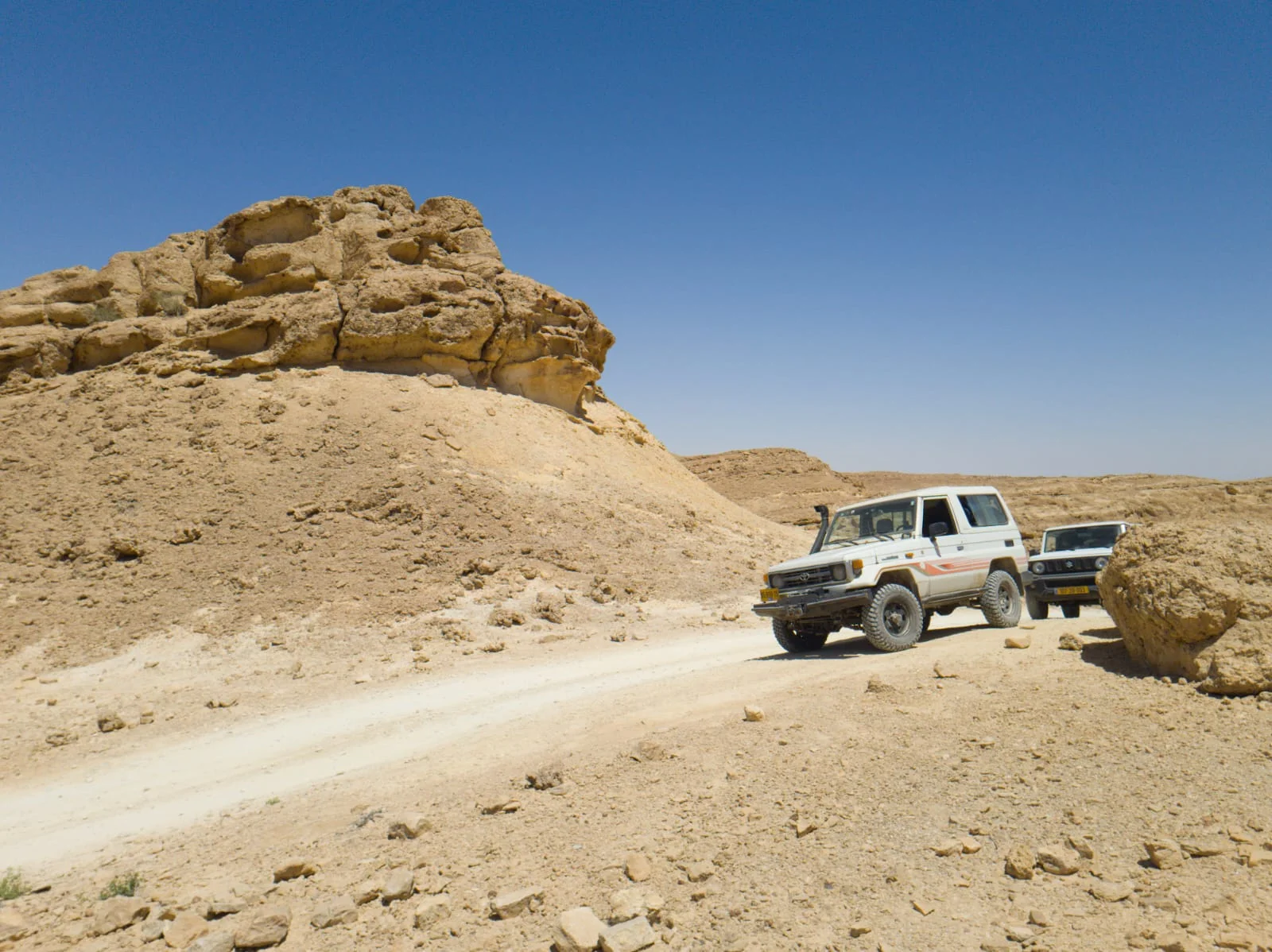

Just finished a net 3 days in the desert.
After the last rain there was still some water in several water holes.
Meeting some interesting people along the way was inlightening
Had to help out the younger generation Hilux😉

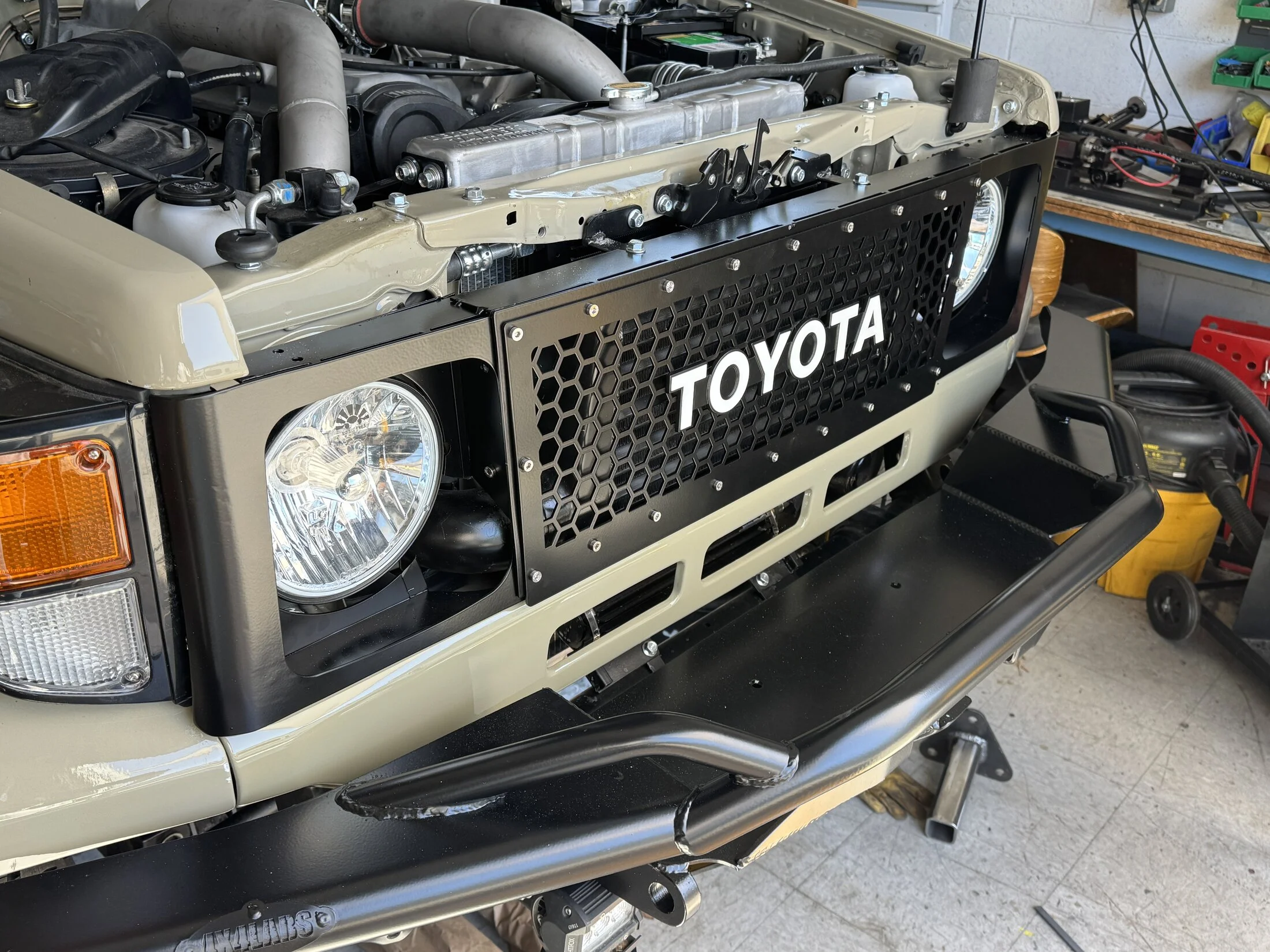

Finished installing the new custom grill, a few little things and... after 3 long years it hit the road with it's own FT power very gracefully.
purdy

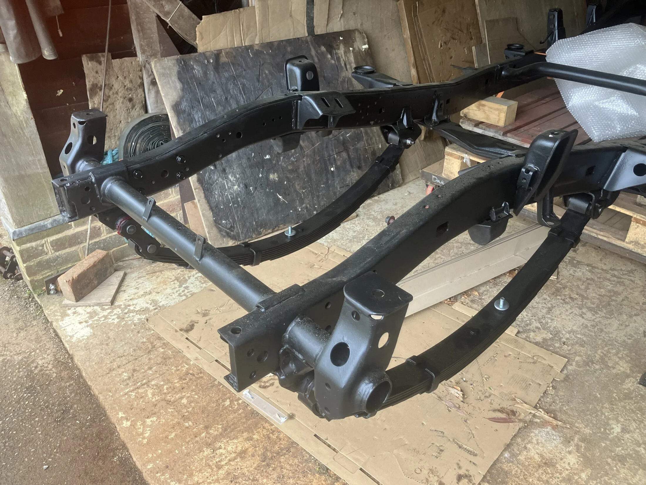

Leaf springs on…..slow progress with any rebuild, as work is getting in the way , but a few pics of horrors with a broken leaf and well corroded pin.
( rear spring ) and a bit of satisfaction .
Rear differential is in surprisingly good order, with no nasties. Primed and ready for paint.

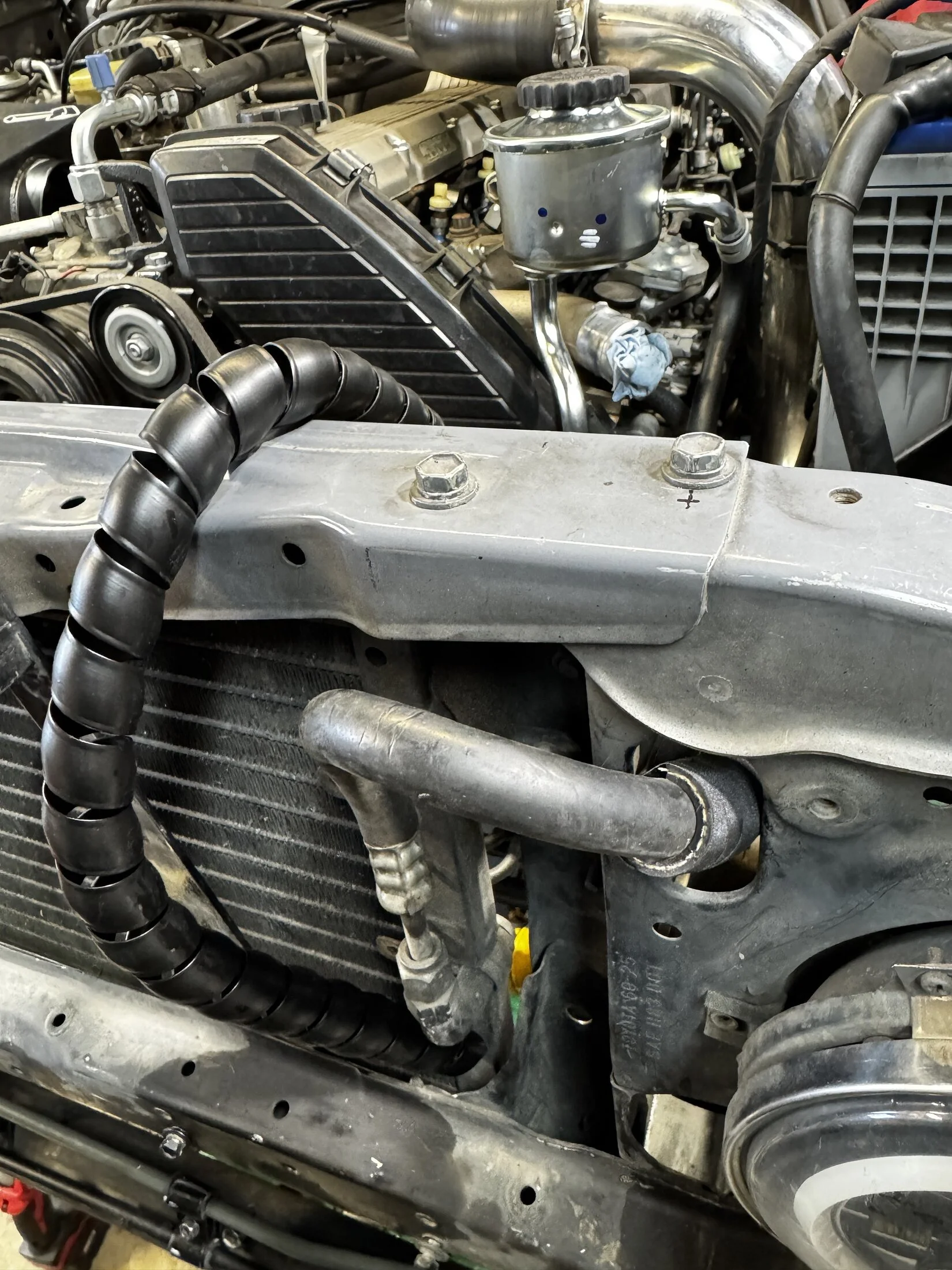

Little more time on the 77 PS and cooling project over the weekend.
New pump in and lines runs sans the return line for next weekends bleed. Used the new fangled washer style. Cute!
Radiator, HDT shroud/fan in and secure AF. Foamed everywhere so hoping very little ram air loss. Routed, wrapped/secured wire for temp sensor. Installed in the top tank now.
Little keeper bracket added to both sides.
My AC lines are all re-routed whack due to the IC and dryer relocation. Wrapped them with OEM looking protection wrap. Feel a little better. Think I'll add heat wrap to the long one that runs over the valve cover to the firewall.
