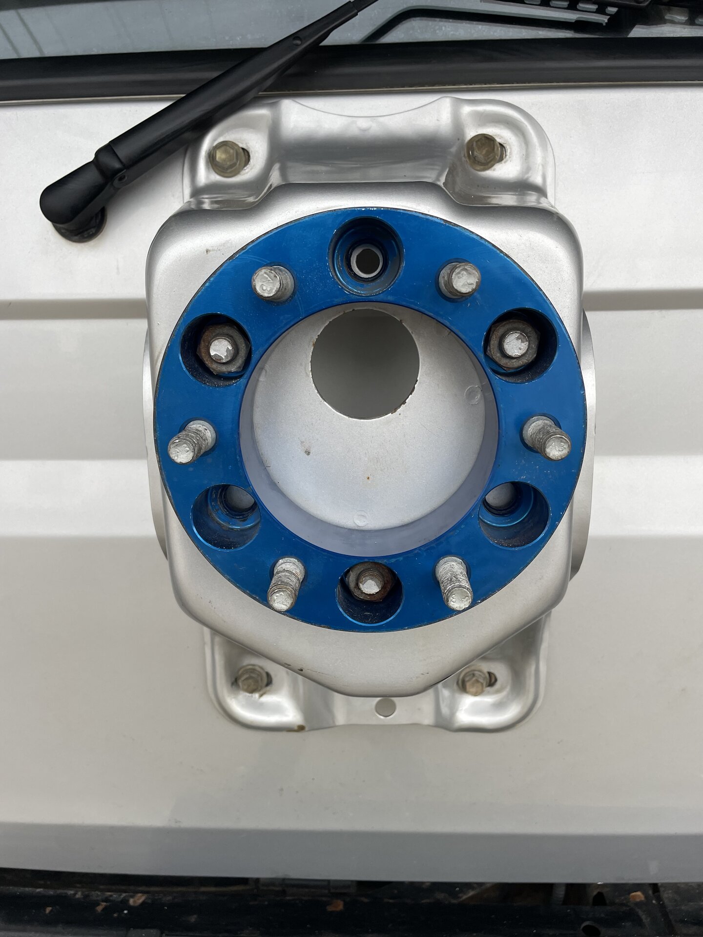

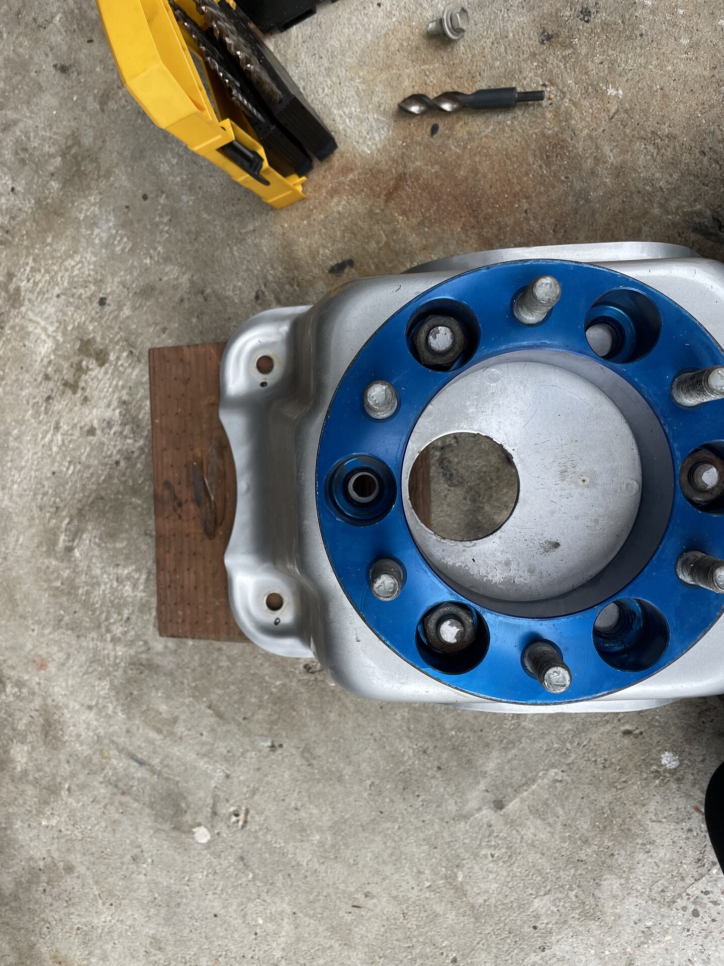

Adjusted my tire mount to fit my 35” spare.

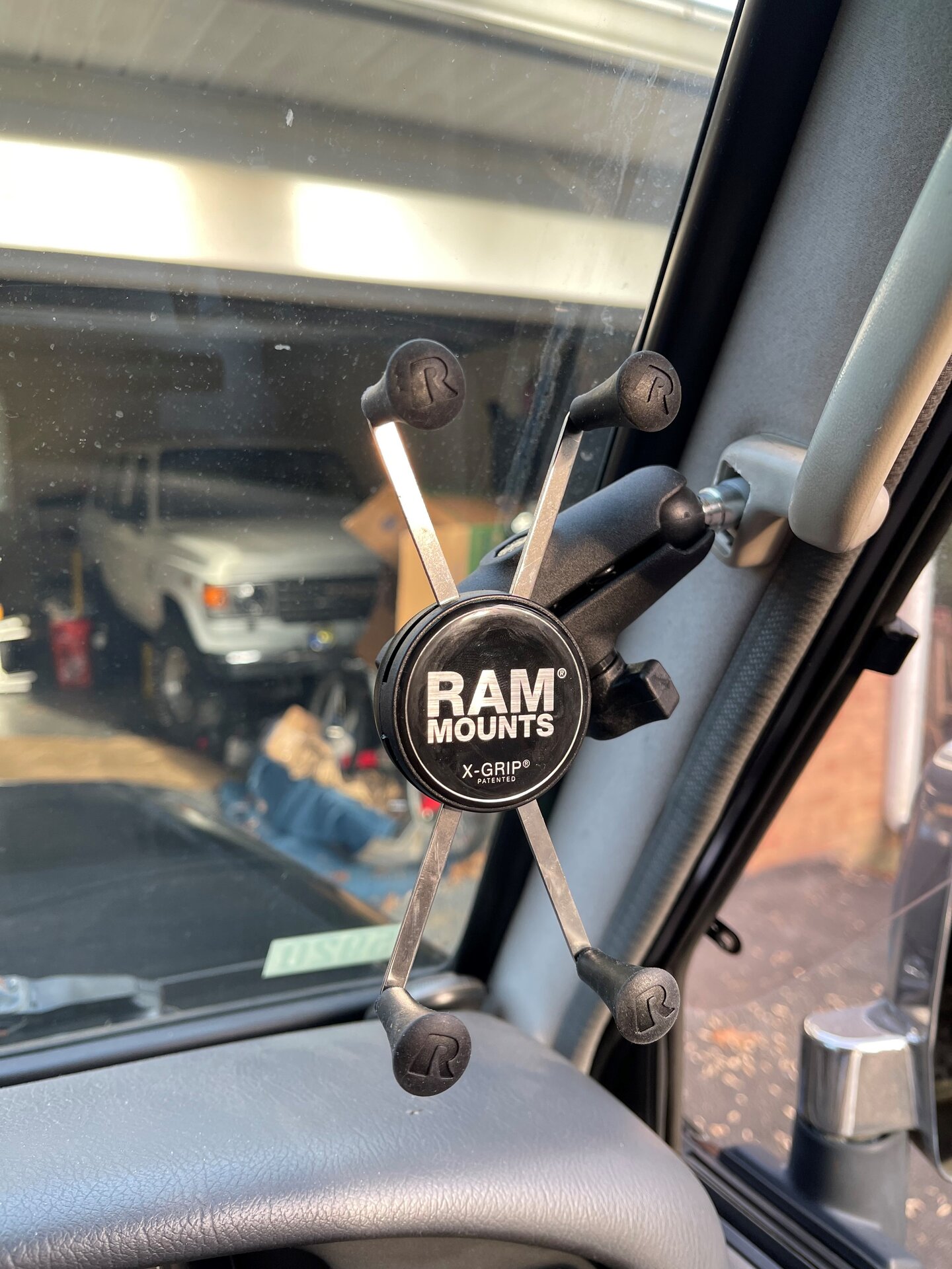

Got the Ram phone mount set up in the grab handle. These three items from Home Depot will get the B-size ball mount fixed to the handle. I cut the spacer and used about 40% to get the ball further away from the handle. Still messing around with positioning, I want it to be in the same space as the A-pillar so it doesn't block my view of the road.

I like this solution... what RAM ball mount part did you use? I'm struggling to understand how those three parts plus a ball mount threaded into the existing captured nut...

This is the RAM ball kit you’ll need.
Motorcycle Ball Kit
Use the bolt from Home Depot instead of the included hardware with the ball mount. The Home Depot bolt replaces the bolt that’s in the grab handle. The washer and nylon spacer can be used to give the same thread depth as the Toyota bolt.
I can take more photos if you’d like.

That looks like it will hold your phone even off roading. I resorted to velcro. If you use a magnet mount center dash windshield area you will find they release your large screen smartphone so that it will fall onto the steel Ebrake handle between the front seats and bust your screen. It's especially dangerous when your wife buys you a new unlocked $700 phone and mag mount for Christmas(because she thought your old busted screen phone and velcro was ugly)

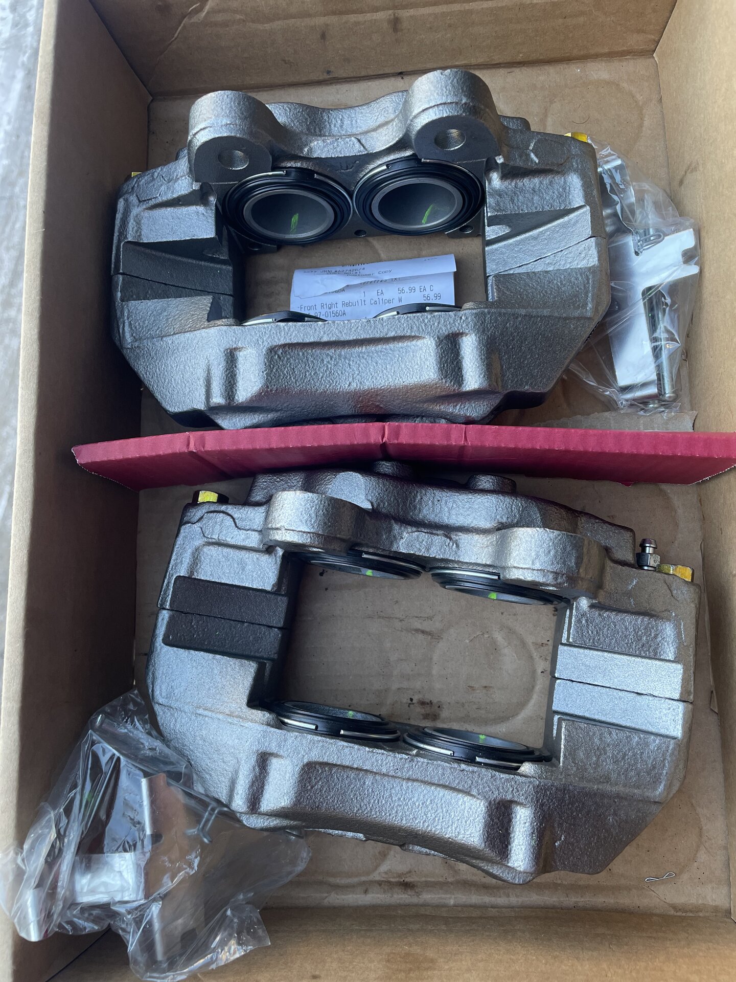

Yesterday I removed the front calipers as I am in the process of rebuilding the front hubs on my 92 HZJ73. They are not looking too bad but not too good either. Not shown is the pound of dirt and crud that came out of them when I took the pads out. 😳
Rather then popping on new pads and hoping for the best, I figured I would get remanufactured calipers.
So today, I went to my local Fat Guys auto parts store and picked them up for less than $130 CAD for the pair. For that price, you can’t go wrong. Plus no worries about sticking pistons or leaking seals or boots.
I cross referenced with ‘95 v6 4Runner. Nugeon 97-01560A and 97-01560B.
Shiny and new …
