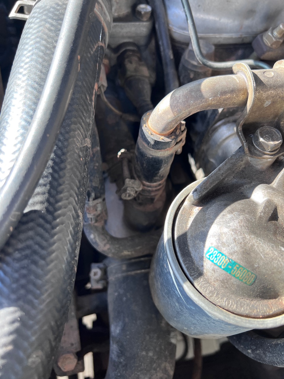

Replaced radiator hoses and every last original coolant hose, especially those with the cotter pin clamps, the toughest being those behind the valve cover near the firewall. Why I didn't do that when the head was off a while back, I don't know...

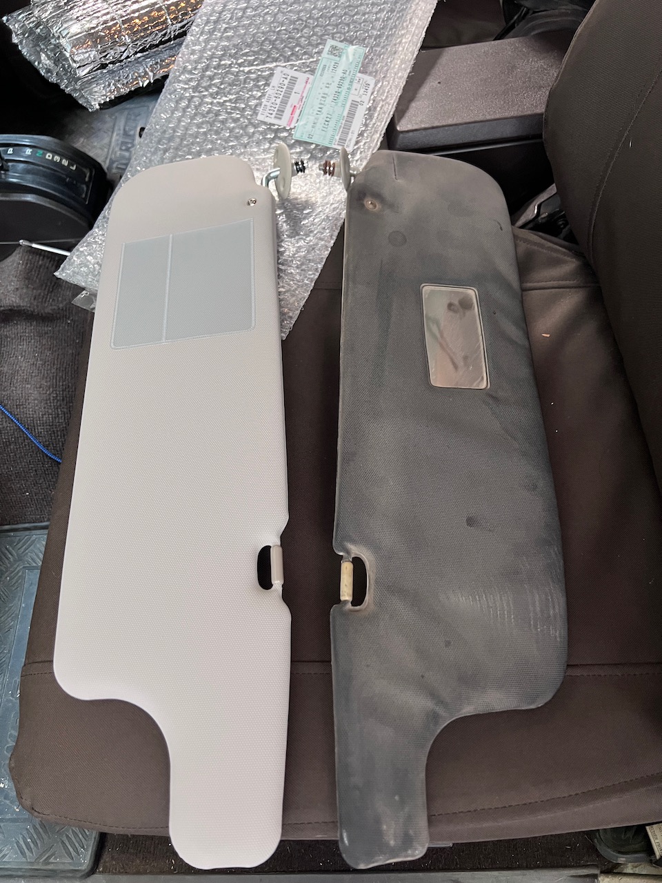

Replaced worn and aging visors with new, clean ones that thankfully were an easy bolt on (well, screw in, I guess) improvement

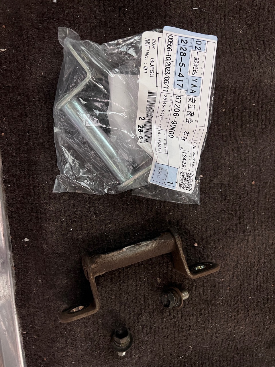

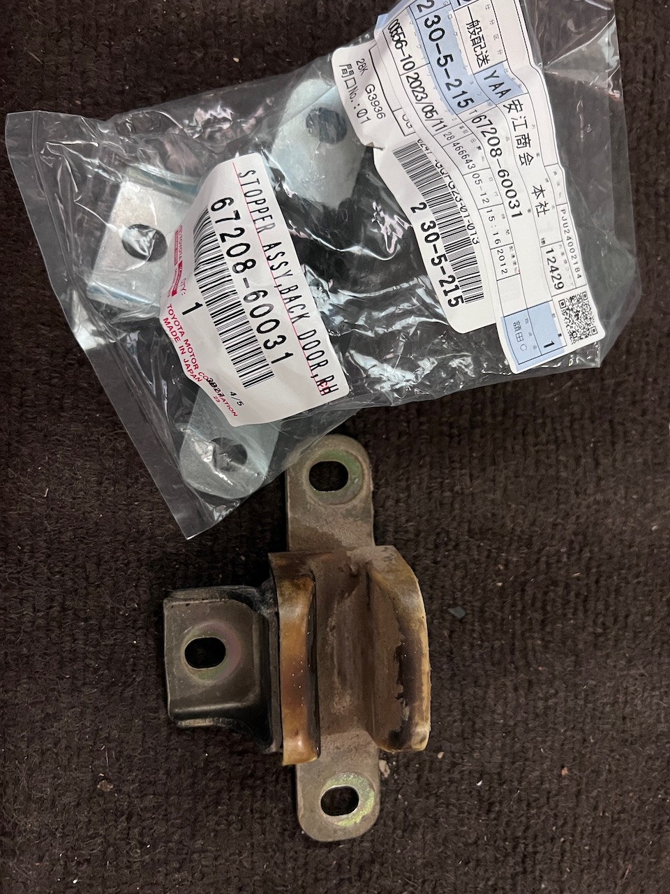

While on the easy bolt on improvement track, I also replaced the rear door stopper bits in hopes of one less rattle on the trail
