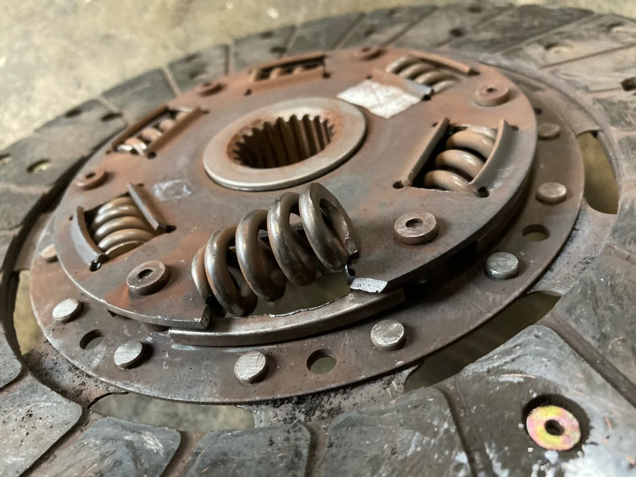

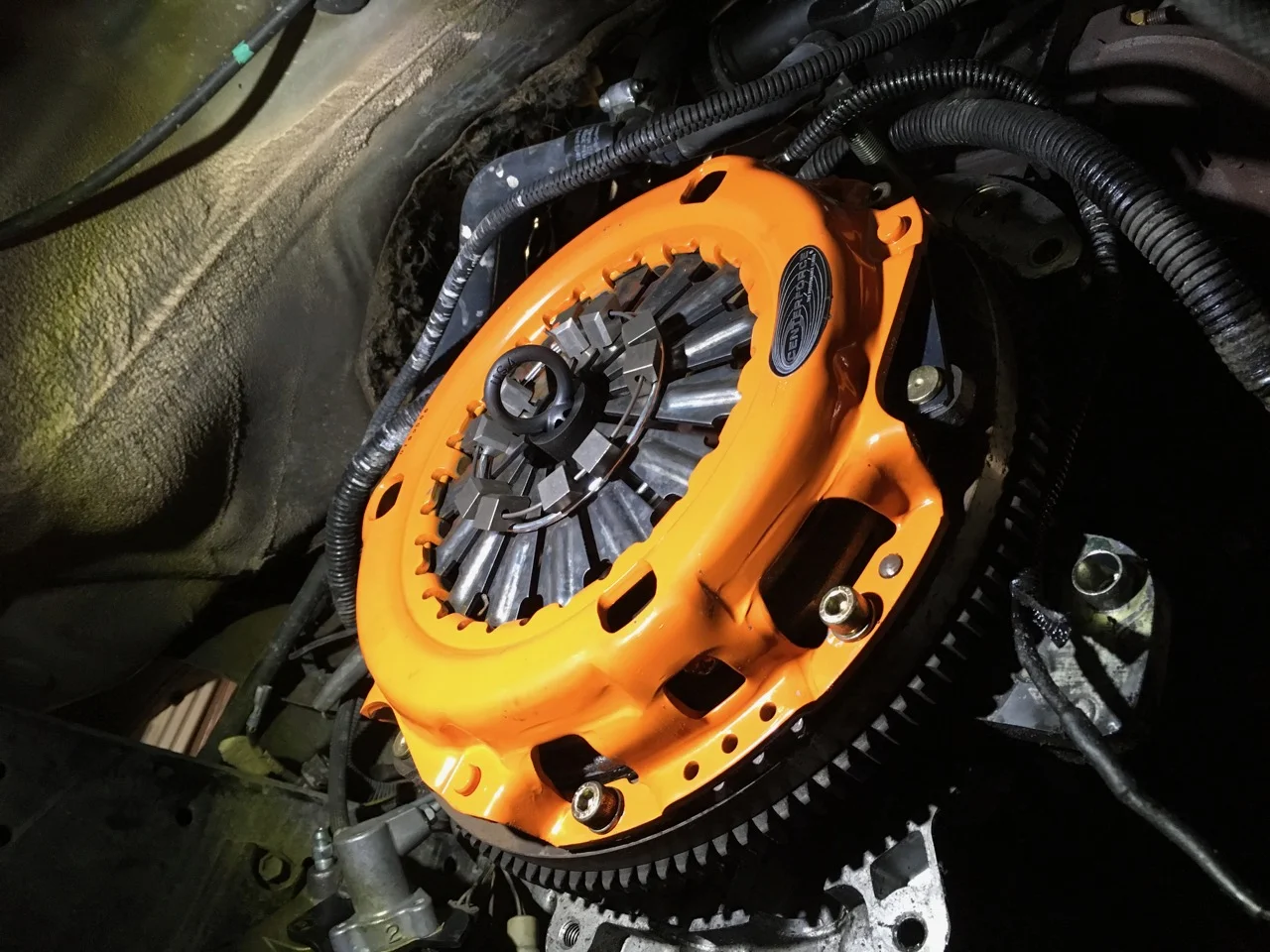

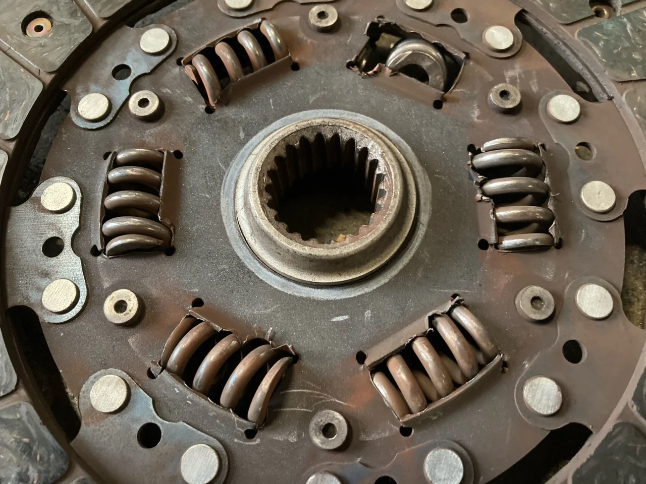

Replaced the clutch over the weekend. It looked pretty bad for only having 10,000km on it! The old one was rated at 300hp/300ft-lb, replaced by a Centerforce II rated at 387ft-lb. Hopefully it will hold up to whatever the 1.9L TDI can throw at it.

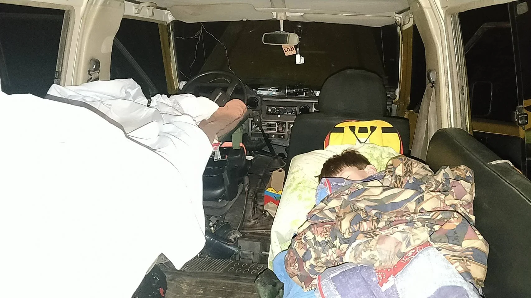

Some pics and videos from the 70 series get together at Windrock in Tenneseee. These are links to videos from my google drive that are shared. We camped in the campground and slept in the back of the BJ73. Hopefully it works.

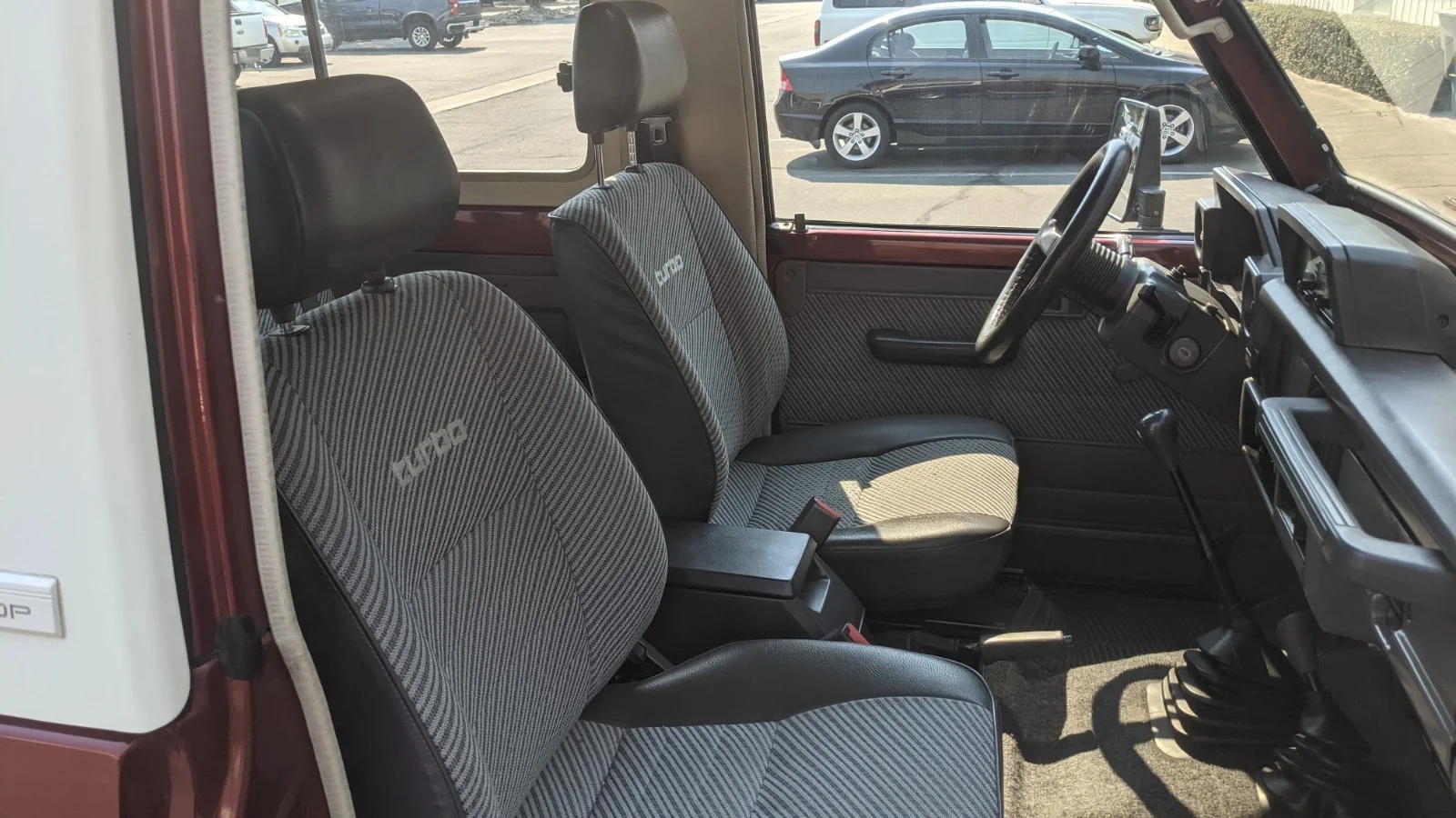

Hell no..Not this one.... I ordered a new turbo for it a week ago. I don't plan on going anywhere fast and its as clean as I've seen, no stains on seats or carpet.
I'll be removing this horrid front bumper and looking for a factory "non winch" and ordering an AC kit from @joekatana.
Previous owner ran all the bearings, timing belt, new odyssey battery, new clutch, resurfaced flywheel, new stereo system, have a tote full of OEM parts, and I ordered a 2" lift kit and 9.5rs comeup winch that came with deal.
