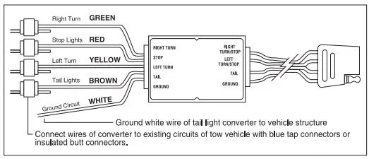

I should add that to rearrange the pins of the kit connectors to line up with the pins of the HZJ77 connectors for tail/stop/turn, it helped me to understand the 3-2 taillight converter that was hardwired into the kit.
etrailer was nice enough to let me know what model was used in the kit: Tekonsha | 119130 | Taillight Converter - https://www.tekonsha.com/product/119130_taillight-converter

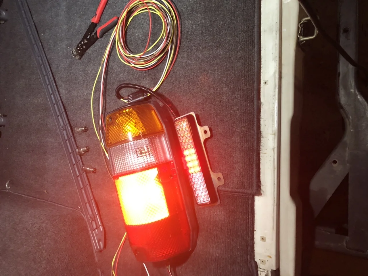

I finished the wiring of the kaymar led pods and tapped them into the etrailer adapter I mentioned a few posts back. Everything works well (turn, stop, backup, and tail). I also added odd iron led lights but had to take them back out because of turn signal hyper flashing. I know it is a common issue that is easily fixed but that will be another day.

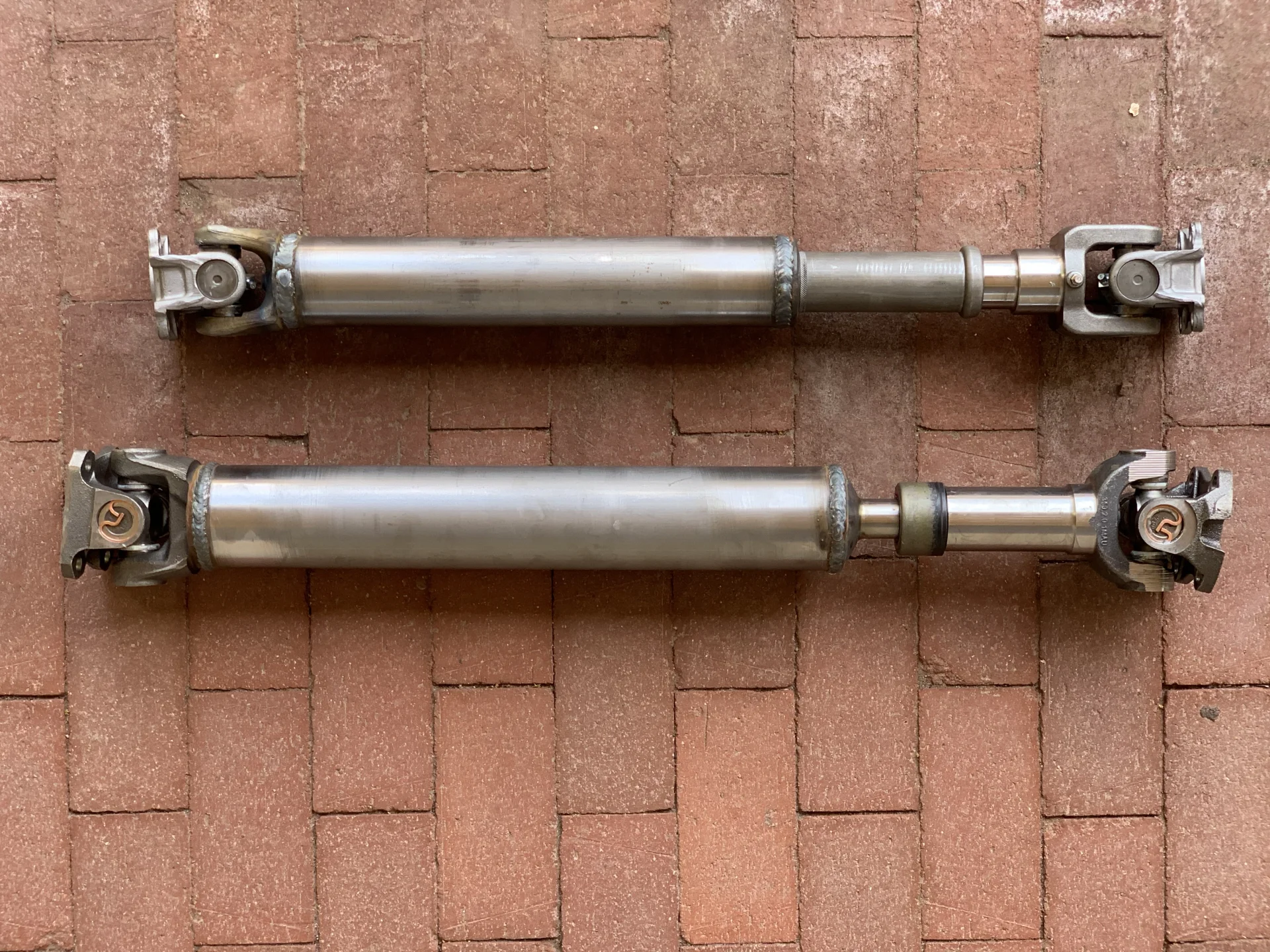

I referred Bill to Ujoints in ABQ. They did all of my driveshaft work when I lived in NM.
Thanks for that recco, @Onur. Actually, I wound up working with Santa Fe Auto Machine here in town. The rear is totally new (all Spicer) and the front was salvageable except for the slip yoke.
Eric at SFAM is excellent.
They did my Ujoints on the LX back in the ABQ days
How do the Spicer joints hold up with the 70 series? I know when people tried to use them on the 80 series they didn't last very long.
Purchased a trailer wiring kit off etrailer that uses the exact same male/female connectors to the combination lights for a different Toyota vehicle. I did have to re-pin the connectors so they properly match up with the HZJ77 connector pin locations for brake, tail, and turn signals. I tested everything after re-pinning the connectors and hooked it up....and it worked perfectly.
What is nice about this kit is that I can now tap into the wires of of the wiring kit rather than butchering and splicing the factory OEM harness for the bumper lights, The 4-pin trailer connector can also be easily adapted to 7-pin trailer connector as well but that is a project for another day.

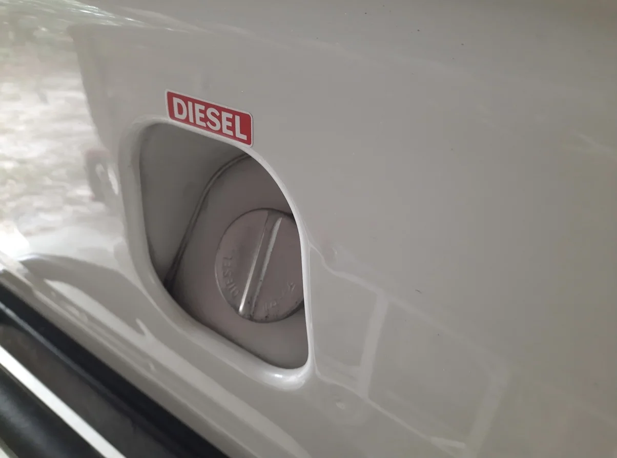

My rear tank never had the “stinky fuel” decal but that oversight has now been corrected. 😊
