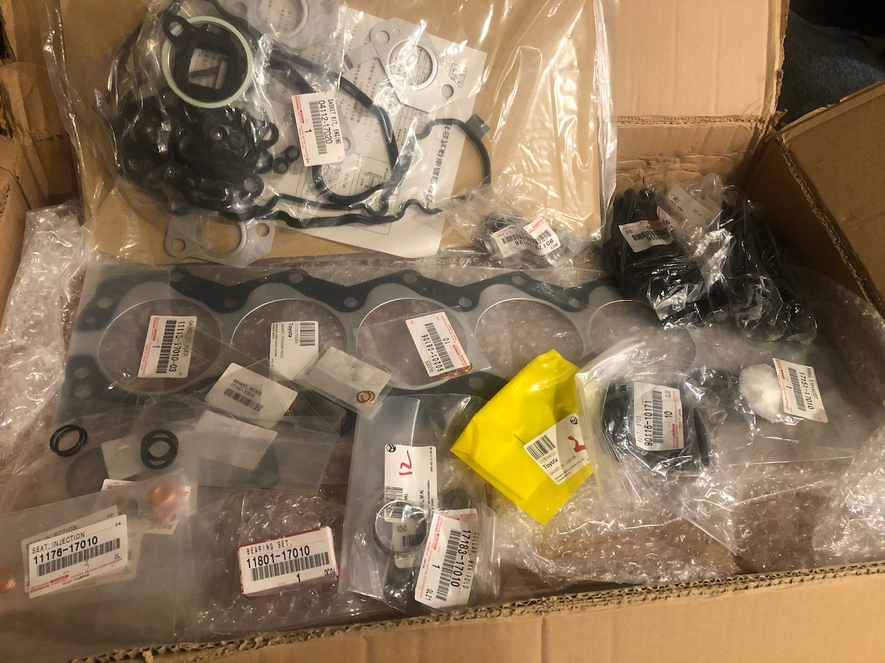

Then, got distracted/exhausted staring this pile of bits for a head gasket job my HDJ81...which will have to wait until my return.
