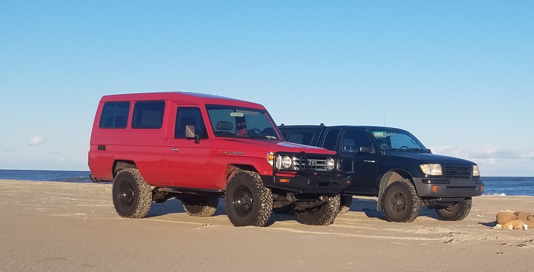

I have those same 35x10.5 tires mounted on 17x7 4runner steelies on my Troopy. 31x10.5R15 on the Tacoma.

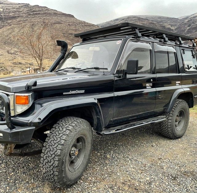

42611-60B70 which are hilux/prado steel wheels 17X6.5 is an option if you can get your hands on some. Based on my research, they are the closest you will get to 4" BS for that rim style.

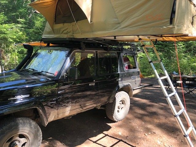

These are what I have. No spacers on mine. I'm running BF Goodrich KM2's in 255/75/17... spec'd as 32.1x10 but they actually measured out to be like 31.5" tall. I only get a little rubbing in one of my front wheel wells in reverse only on a locked out turn... one of the tires grabs my inner fender apron material.
Are you running wheel spacers with those?
Thats my only issues is finding 17" rims, then getting spacers. I assume outside a custom rim, you aren't finding the right back spacing?
Yes, unfortunately I am running 1" spacers. That puts those 4runner rims to just about stock position. 1.25" spacers might be a little better option, or best if one could get the rims Honger has. There are custom options out there but too pricey for me at this time.
@Honger, I think it's pretty close to stock height, maybe a slight lift. I can take some measurements later along what @FJBen mocked up in the photo and post those. If your troopy has stock suspension I would be interested in those numbers. The Tacoma in the photo has about a 1.5-2.0" lift and the wheel wells sit pretty even to the troopy's.
I also had the same wheels on the PZJ70 (No spacers also) and my experience with them is the same as you. Great wheels but not easy to obtain it seems like.
