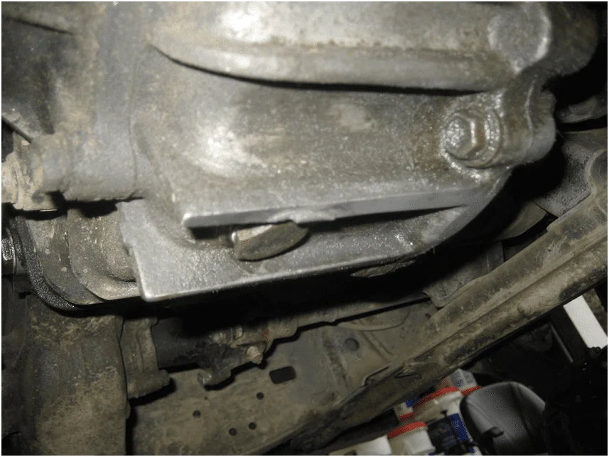

When I removed my Cruisin Offroad skid plate, I found it was bent or arched upwards.
The bend was not a crease and was undetectable by casual inspection.
That plate has been holding up the transfer case for almost 2 years.
The aluminum rib on the case has been rubbing the steel of the skid plate all that time.
Local machine shop bent the plate back.
The nub of metal near the drain plug in this pic is unworn metal matching up to a hole in the plate.
2 or 3 mm of the rib was abraded away.

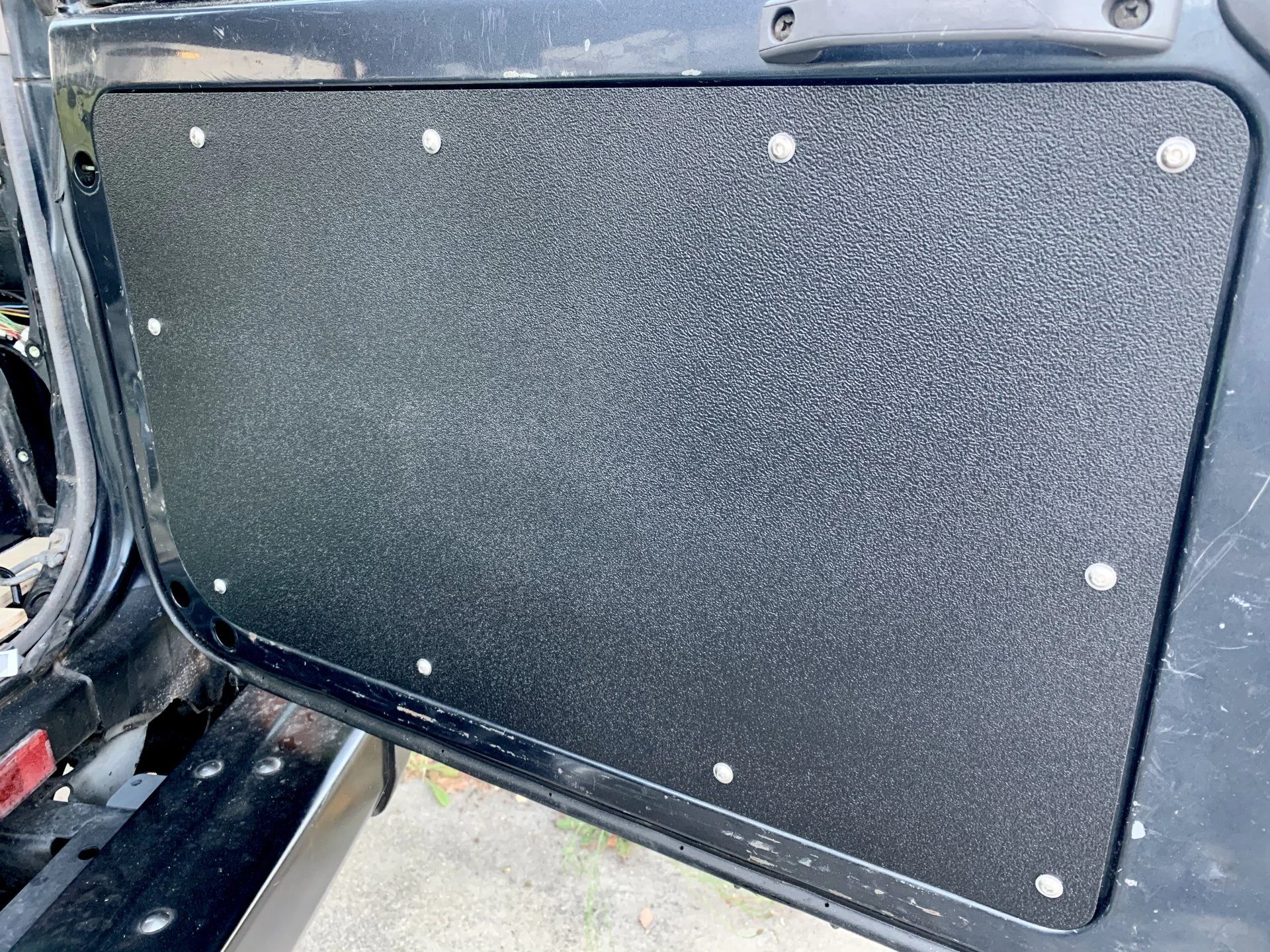

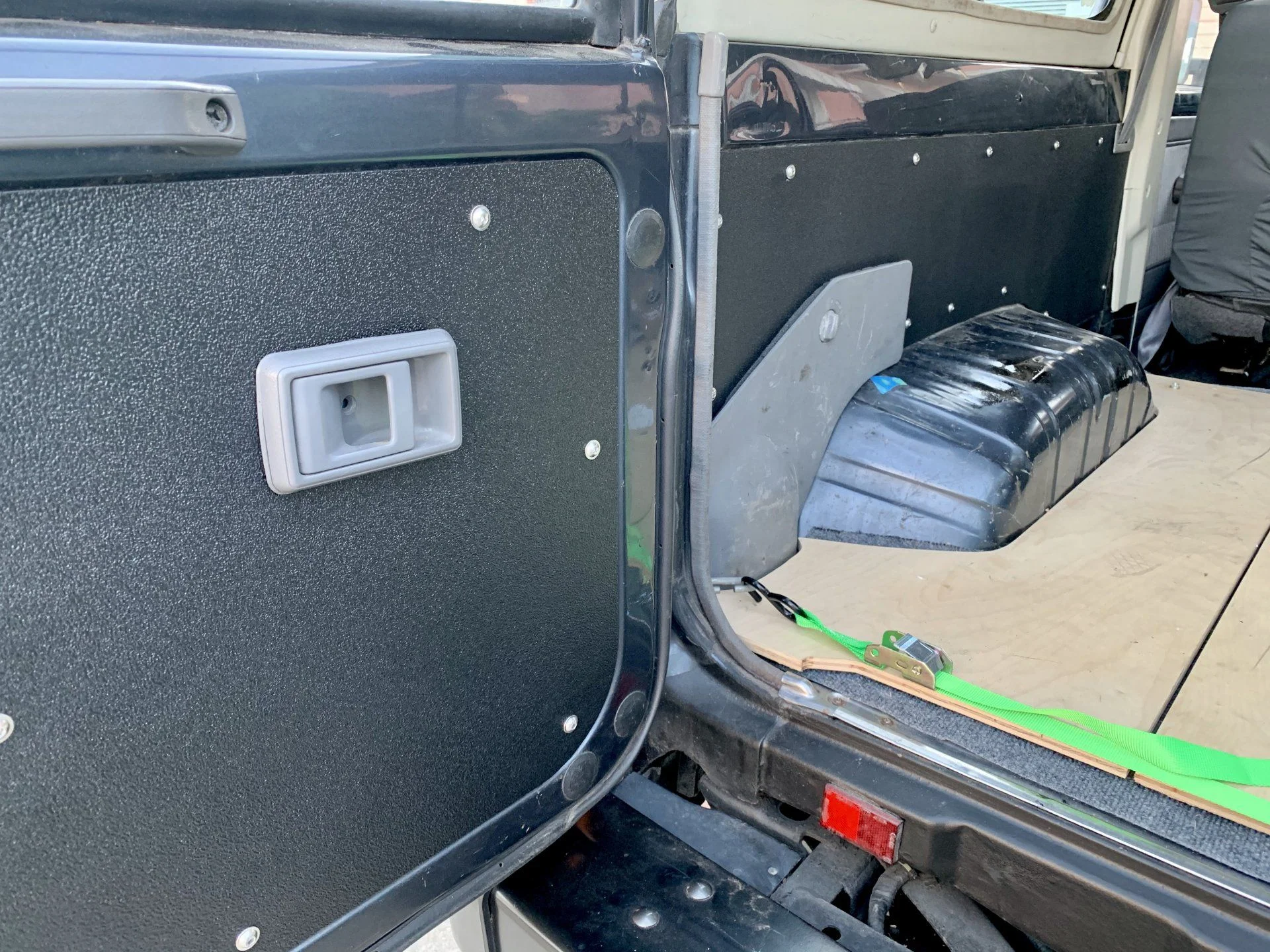

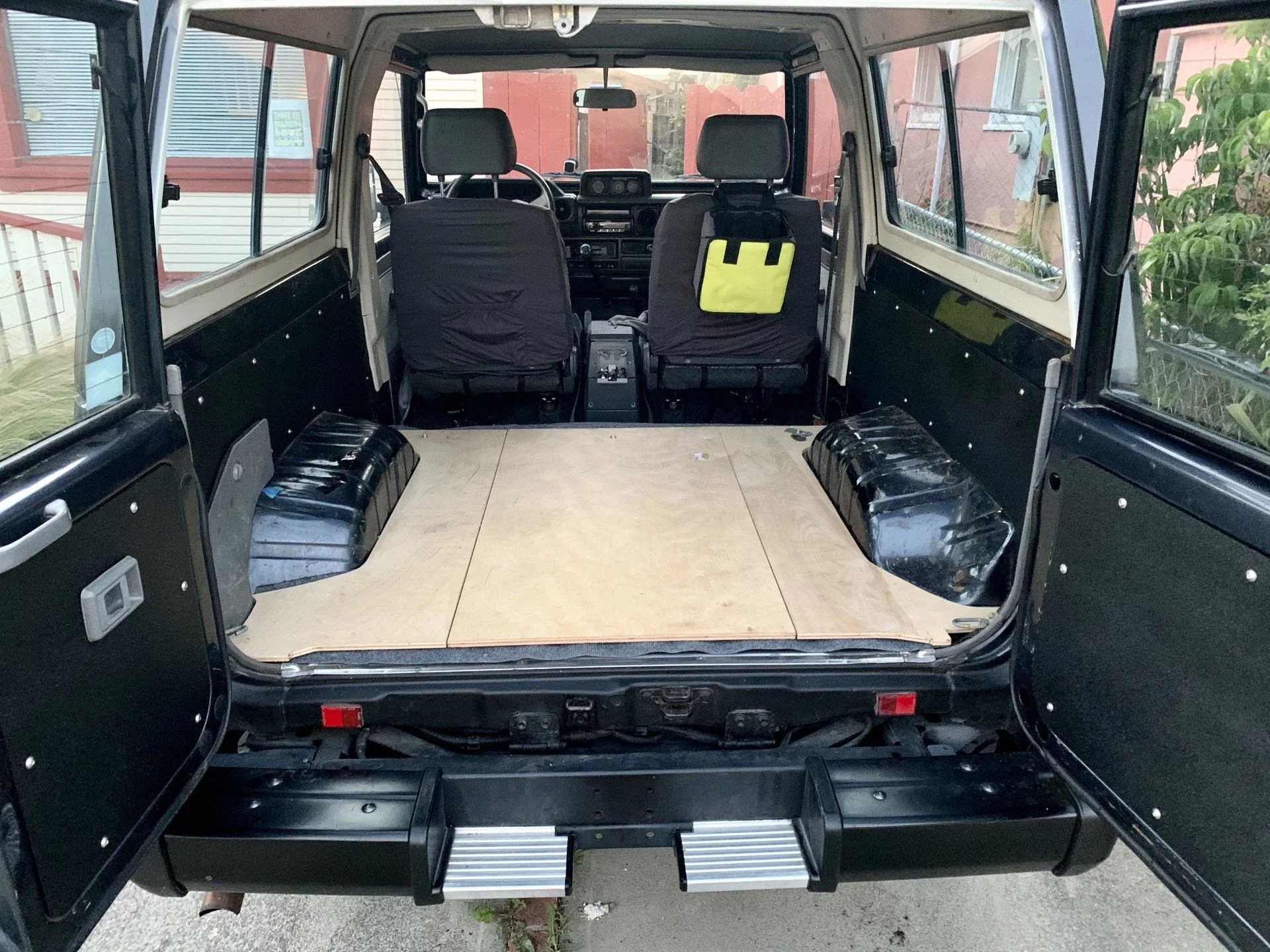

Sprayed the trim panels I made with Raptor liner. First time I’ve sprayed bed liner so I’m pretty happy with the texture I got.

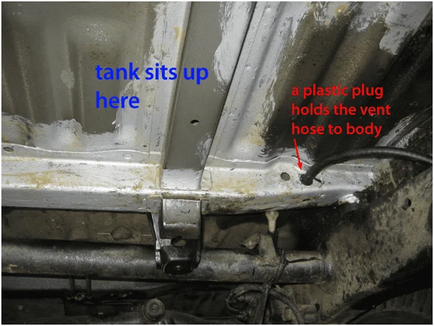

Next up will be the floor platform. I already have an L-track. Need to figure out where I’m gonna secure it towards the back. Anyone know if there is enough room to add a rivnut on one of the raised ribs of the tub above the fuel tank? I’ve been pretty nervous about drilling a hole there.

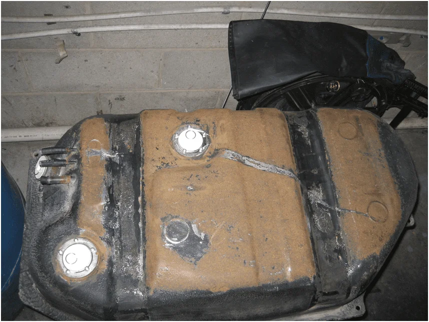

These are shots of my BJ74's tank (top side of tank) and the underside of truck.

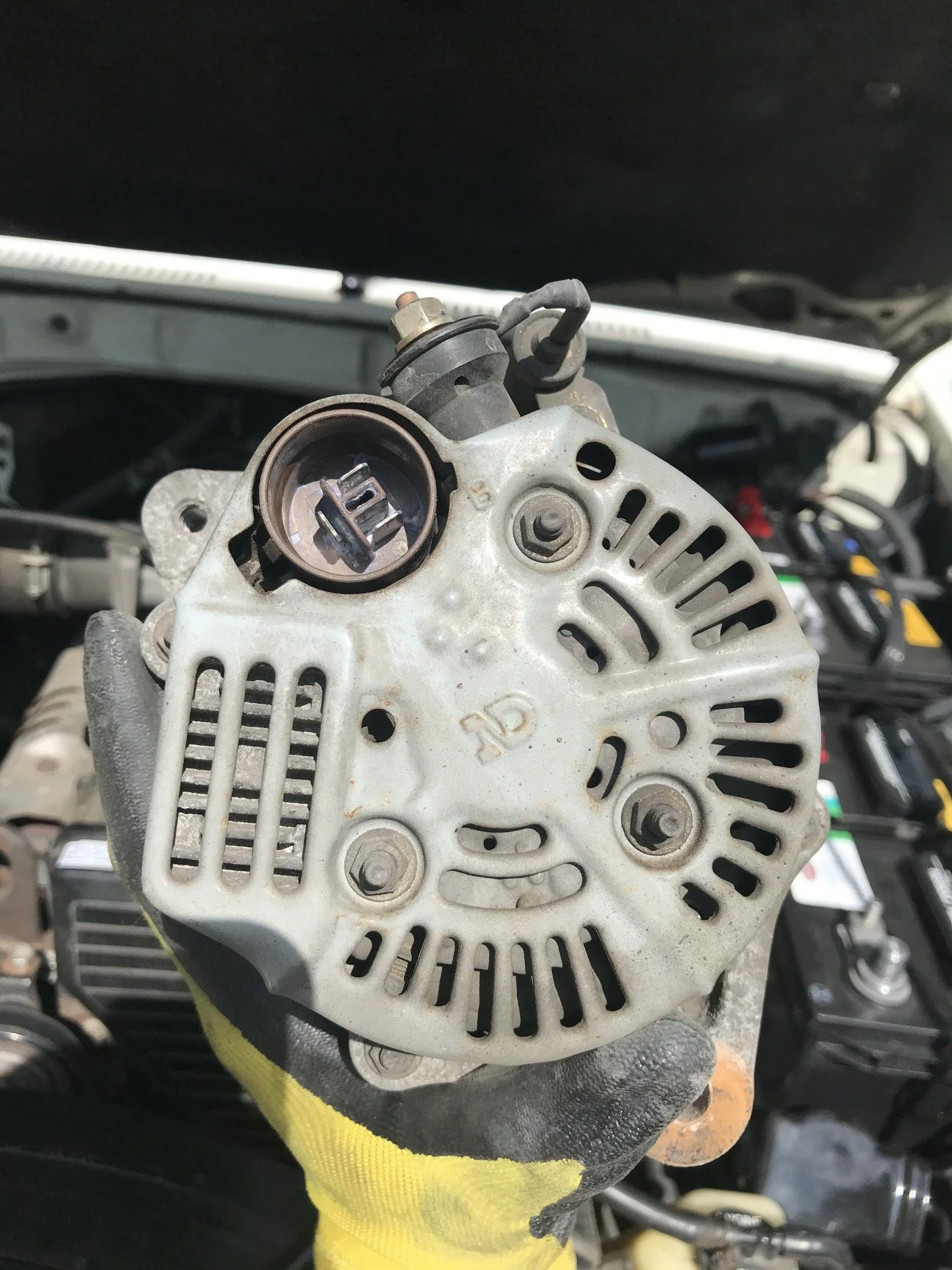

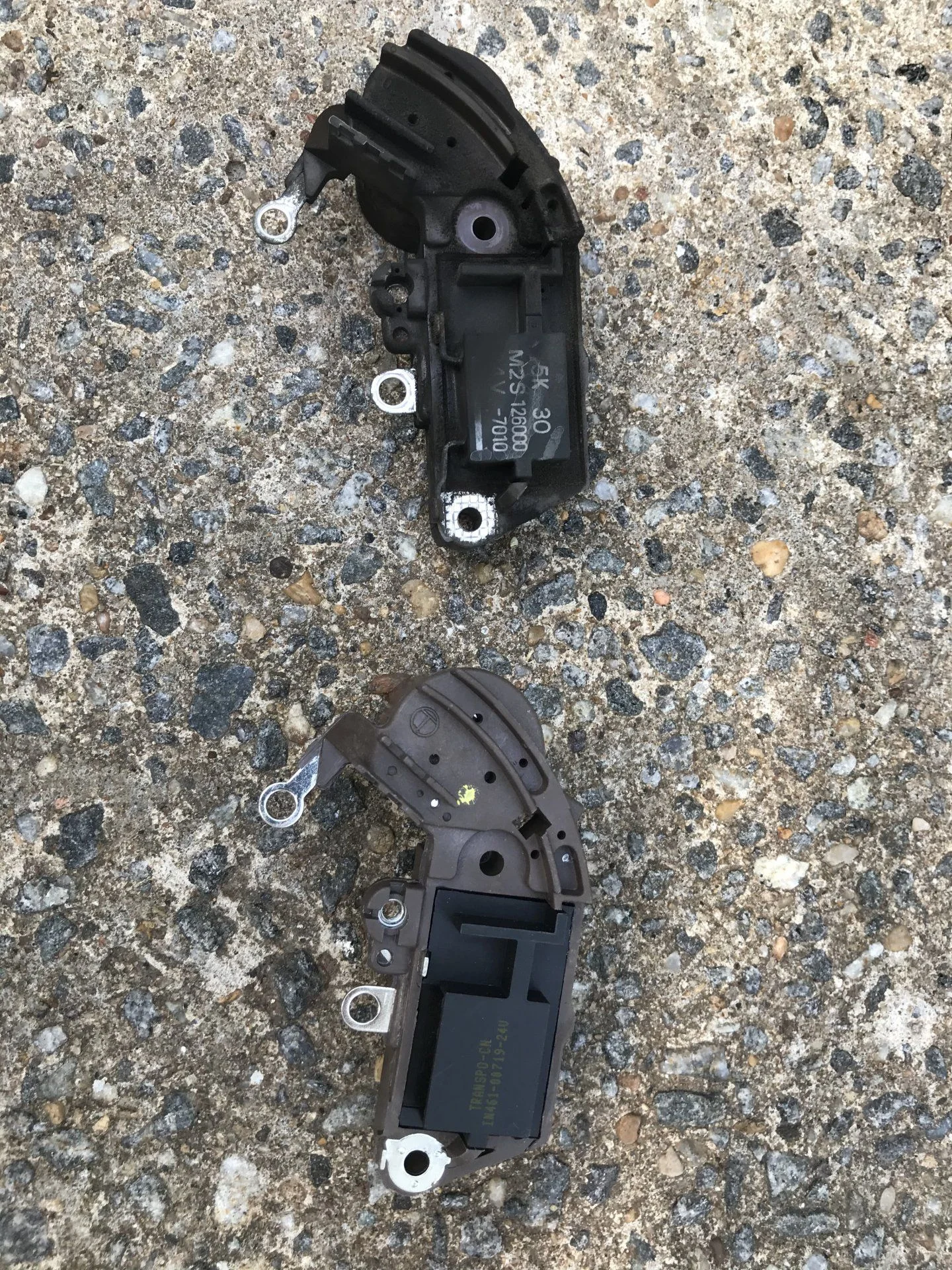

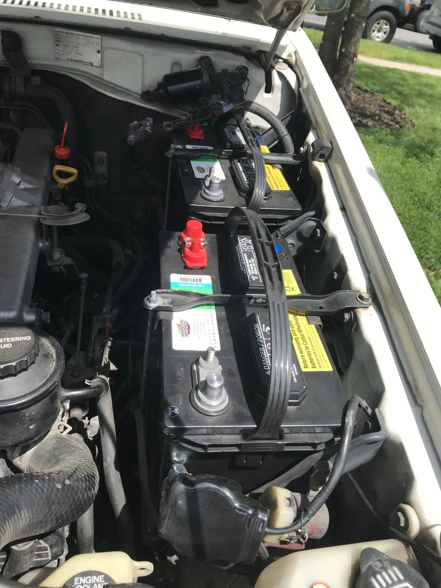

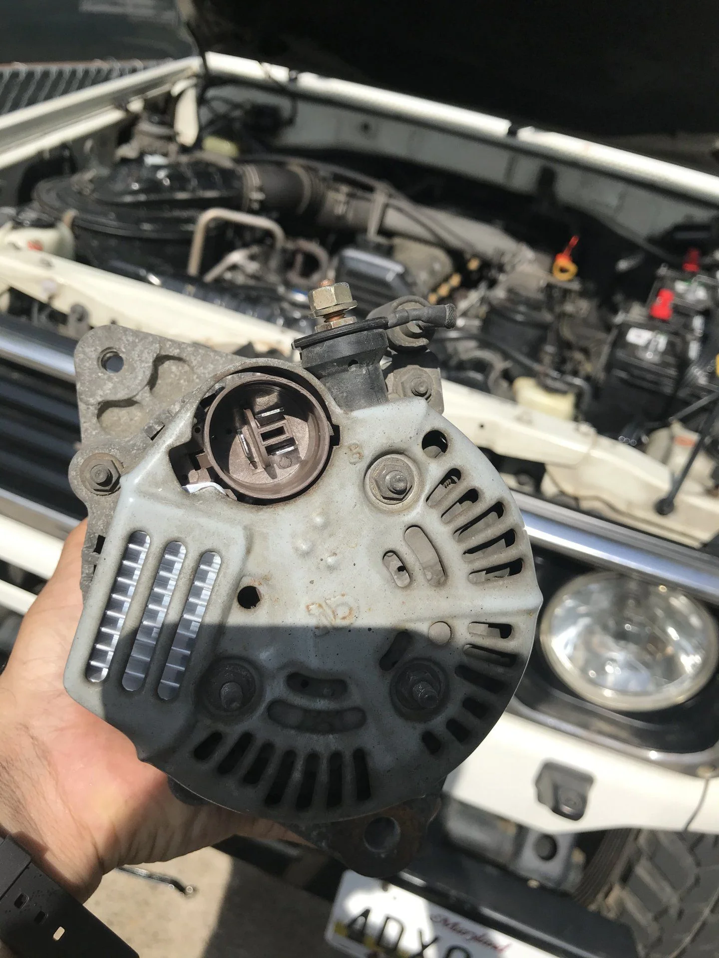

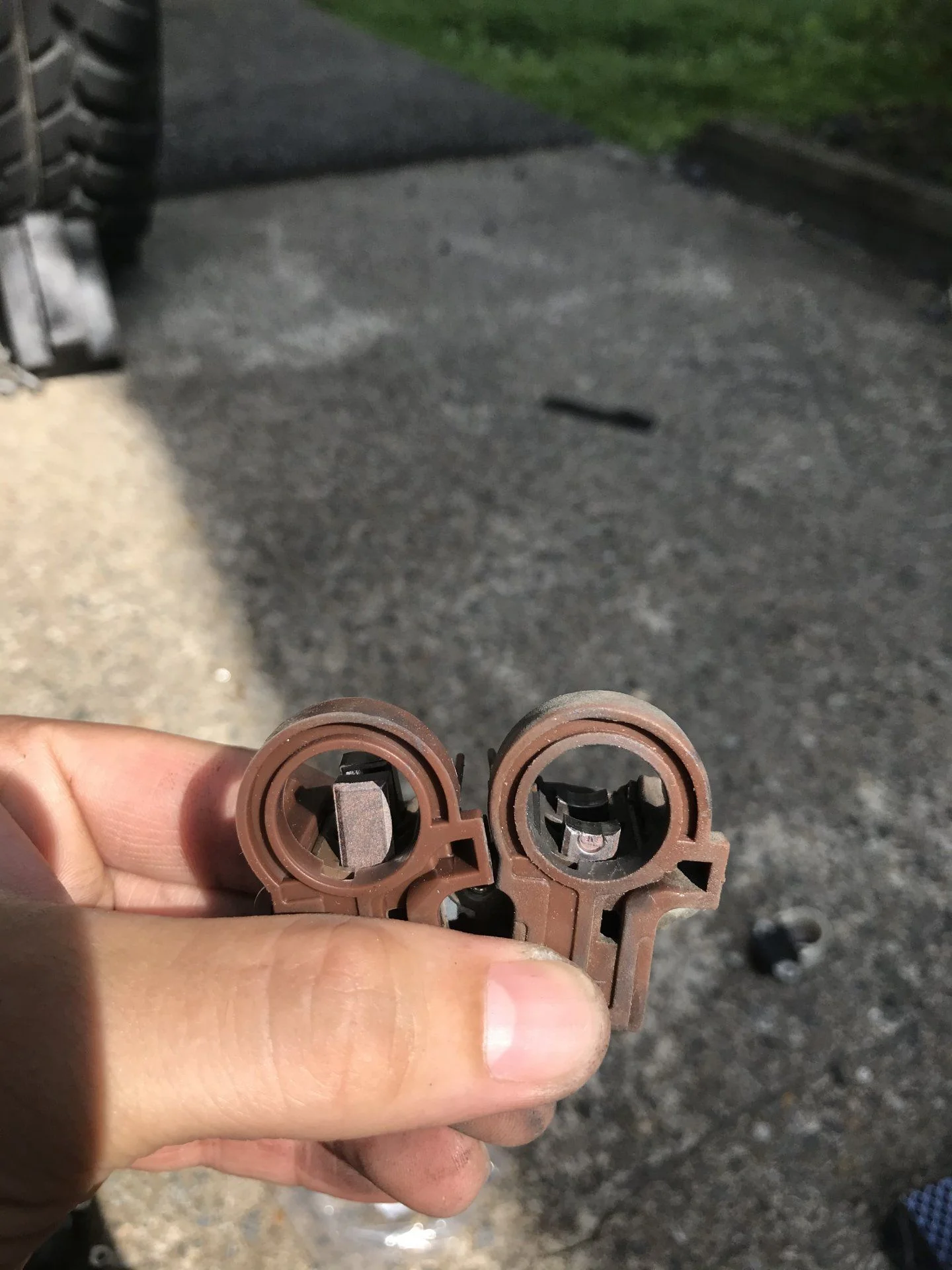

Thanks to this forum, I replaced the voltage regulator and brushes on my Hzj73 alternator; along with 2 new batteries. I had some charging issues and I think the worn brushes were the culprit. Intermittent lights not charging batteries. I’ll keep monitoring it but so far so good!

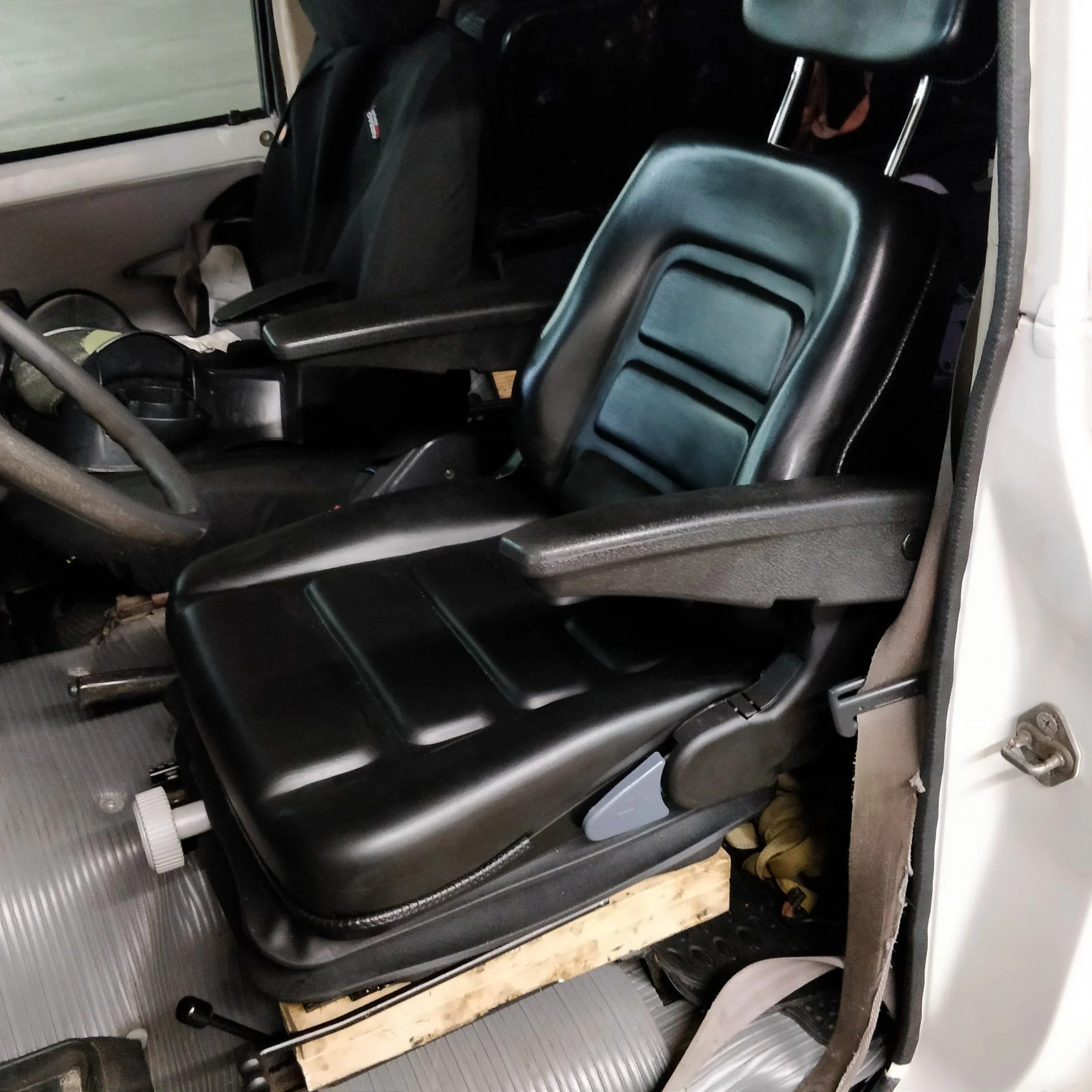

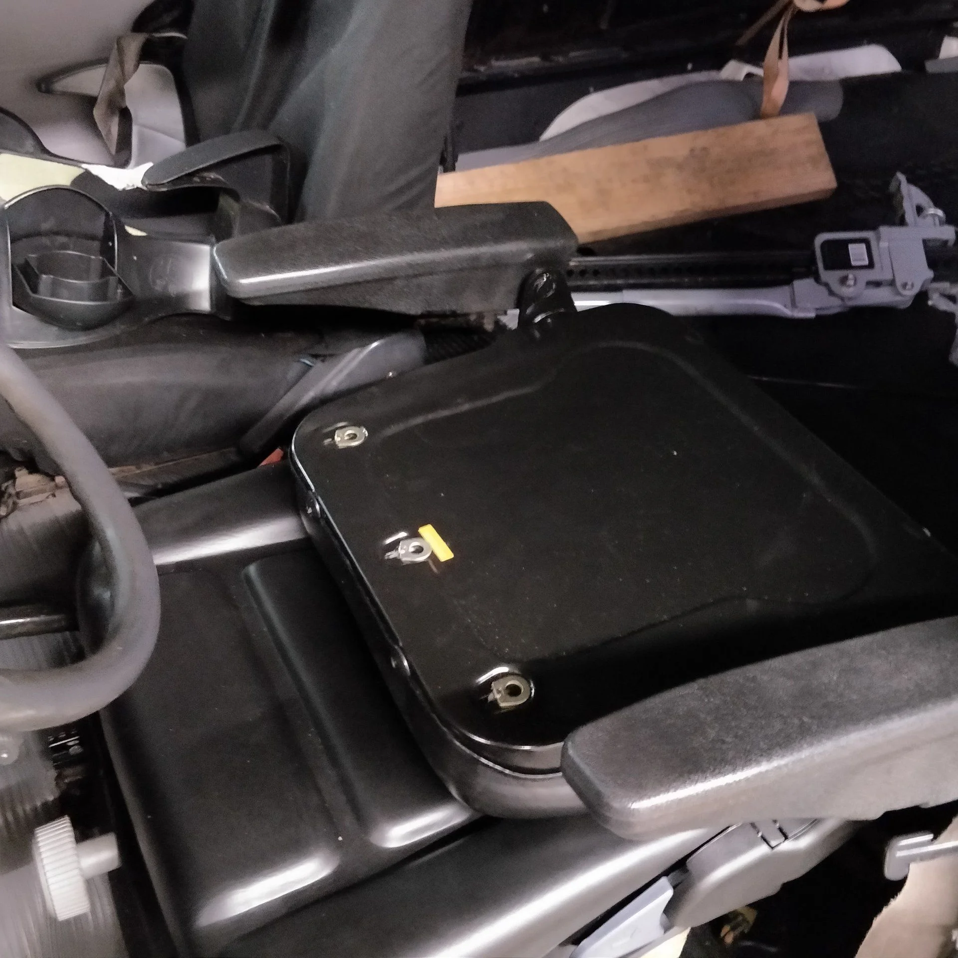

Put in my new driver seat. It's a heavy equipment suspension seat. It does wonders for my back smoothing out the ripples and bumps in the road that normally transmitted straight through the original worn out seat.
It's it's a bit high I stacked the new adjusting rails on top of the old ones so now I have double the forward back movement if I want it. With the extra height and extra adjustability there's plenty of legroom now. my head would be too close to the ceiling if I was taller than 5/10. Also nice to have armrest that are also adjustable.
I like the construction and material of the seat very durable and utilitarian it fits with the 70. The seat folds forward completely which will work with my sleeping plan when camping as well as hauling big things if I decide to put one on the passenger side as well.
The wood block underneath the seat on the left side is a spacer 5/16 bolts go straight through from the seat all the way down to the mount on the floor. I'll paint that would block black to match at some point.
The seat was designed for heavy equipment not for a road vehicle. It has a headrest but it is a low back design so you can turn your head around and look behind you at the plow or implement you're pulling behind a tractor. I think this is great for off-roading and vision when backing up, but it lacks protection from whiplash if you get rear ended. I'm going to try to figure something out here but I haven't done it yet.
What material did you use for your panels? TIA
I used some birch plywood. I think it was 5mm thickness, just went into Home Depot and picked up whatever was closest to what I had in mind. Wanted something a tad thicker than the oem mdf material, I knew I didn’t want to use mdf.
I need to do that too. My door panels are floppy weak and secured by 1 time use plastic inserts. Your wood looks good coated with the bedliner.
thank you!
That's really cool.....Rebuilding/repairing alternators, electric motors, power tools, wheel cylinders, master cylinders, getting tires recapped, getting clutch and brake parts relined, all used to be common before we had so much cheap stuff coming in from overseas. If you didn't do it yourself there was a shop somewhere in town you could drop it off to get it done. Things were also made better, made to be able to be taken apart and rebuilt, not just thrown away.
Thanks. I am definitely happy with the way it came out. Do it while your current panels are a decent template, cause my quarters were not original, so making them was such a pain in the ass compared to the door panels which were original.

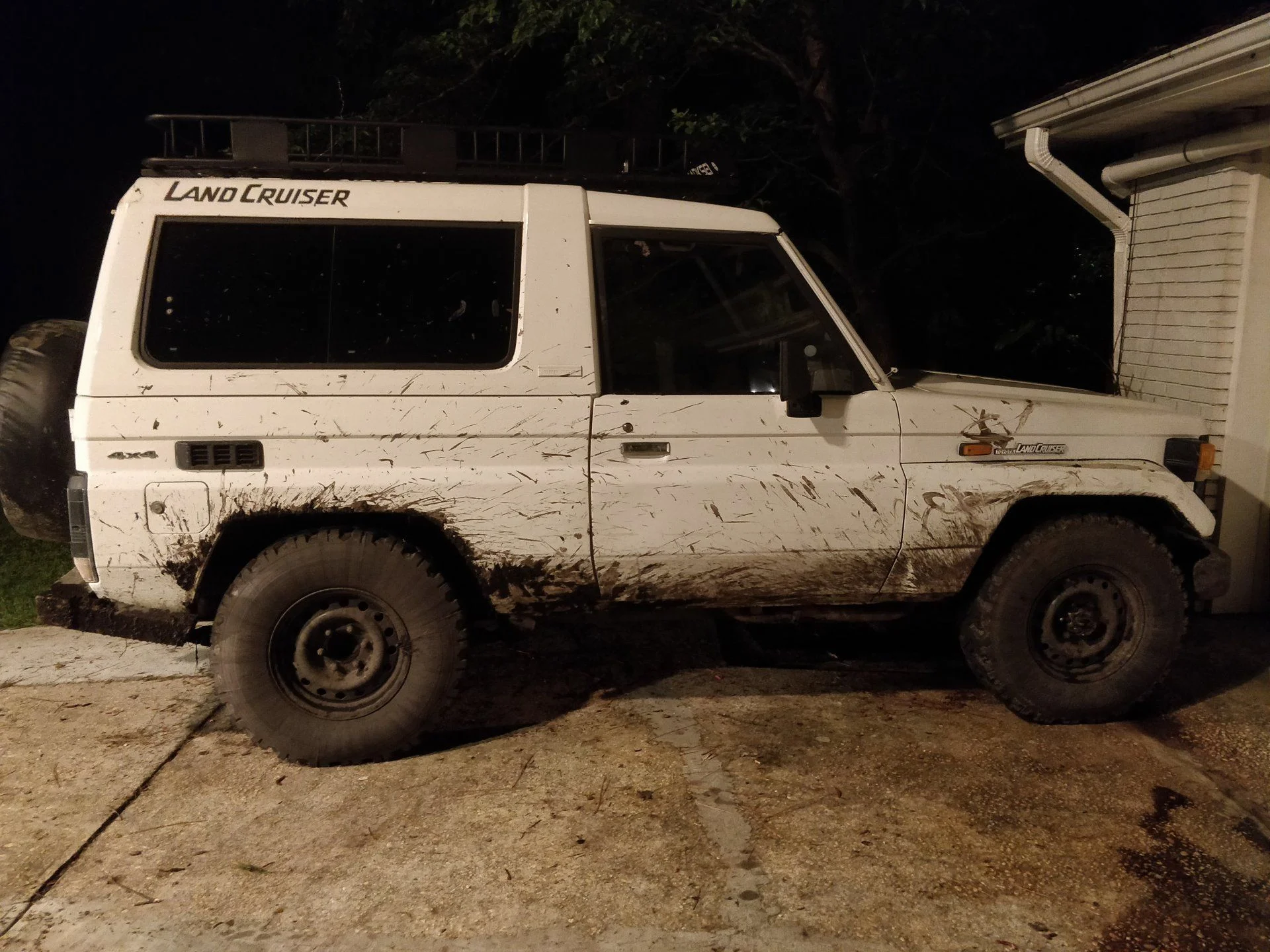

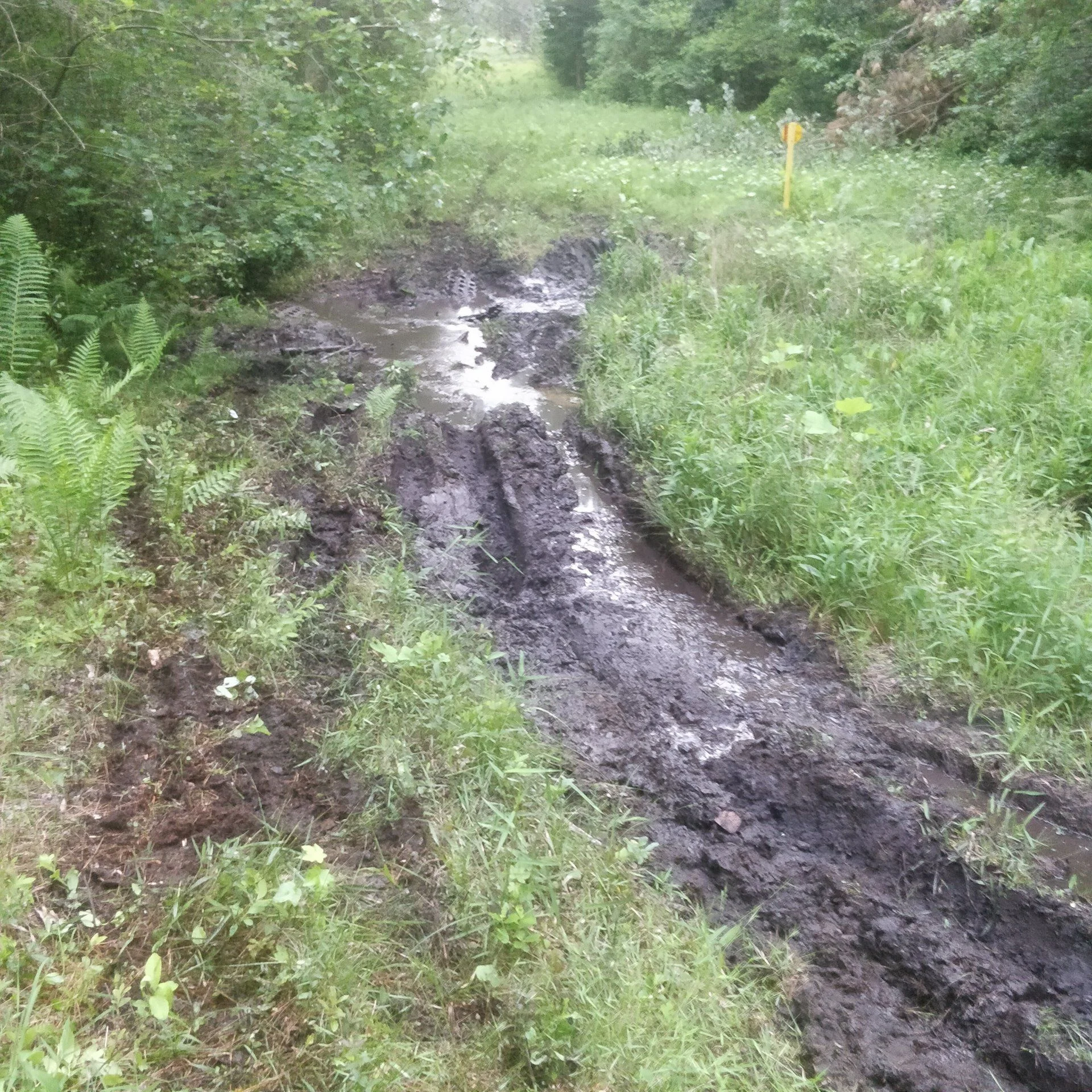

Decided to test the new tires exploring a right of way road. The fairly well traveled dirt road ended at a low spot where a stream crossed. Some atv tracks across the stream. I walked it and it felt pretty good. What I didn't realize was I was walking on top of Pierce steel plate that was under 3 inches of wet sand that the power company had thrown down at some point. Just off the peirced steel plate it was knee-deep soup. .....I buried the back tires trying to climb out on the far side..
Spent two hours doing manual recovery with a high-lift jack. Lucky for me I was able to dig up some of the old pierced steel plate and make use of it. to my surprise it is a lot harder to high lift winch a 4000 + pound landcruiser when you're almost 50 that it is to do the same thing with a Suzuki samurai when you're in your 20s.....yet the mind says "you can do it"... I will feel this tomorrow.
It was a good rehearsal for my kit.
