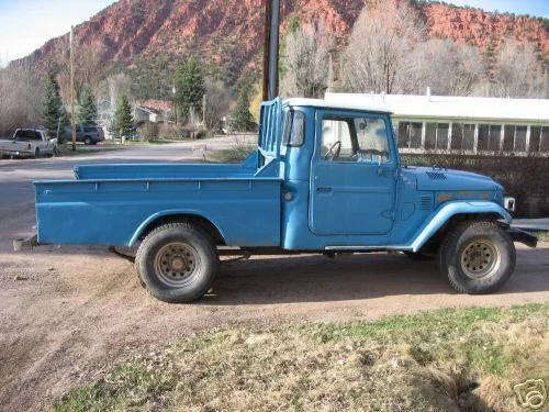

Anyway, I bought a blue one. 1976 HJ-45 LWB pickup originally from Honduras. It's ROUGH. Well, the wiring is worse than any PO pics I've seen or heard of. It's been beat up, and had some interesting repairs. Ever seen someone weld patches onto a muffler to save money? Neither had I until I got this. (but it's an original Toyota muffler, albeit with some nasty patches).

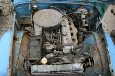

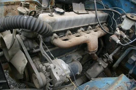

The engine is pretty clean. And it will kick over on ether, but past that is anybody's guess. I suspect it's an EDIC or fuel pump problem, but because of all the other work to get it roadworthy, and some other projects right now, I'm pacing myself to not tinker with it too much at the moment (which is NOT easy to do). I don't really mind rebuilding it, and I might think about repowering it with a 2H or possibly 12HT, but I might very well leave it as is. I'm not exactly concerned with having tons of power or going fast.

Here's a pic of it with the bed, this pic was on eBay. I've got to resize my other pics, I should be able to resize those later today.

I could see dropping $10k to $12 in it in a heart beat. That particular diesel engine is very weak on power, most install a turbo system on it and it really wakes them up.
Coming from central america I knew that it would have patch work done to it all over the place. The fenders and body were full of bondo. The frame was straight but had some unusual fab work done.
Are you sure it has an edic motor? Do you know what one looks like (not trying to be a jerk, just trying to help you trouble shoot). A number of the rigs in that region didn't have them... (EDIT) Looking at the pictures closer, looks like it does have one...

I *think* that is an EDIC. It's the fuel cutoff solenoid, whatever the real name is supposed to be. :) All I know is that when you energize the solenoid, the lever pulls back (or is supposed to). I also understand that there are three positions: off/on/start. do they have detents when I pull the lever by hand, or no? I don't feel any... I'm assuming the EPC will show if mine *should* have an EDIC, or if it was later added on mine. With the state of the wiring here, I'm not yet brave enough to hook up a battery to see if that unit actuates the arm. I think I'll jerry rig something up with my 12V power supply to see if it actuates or not. Since it is only one wire, I assume that it's a modulated voltage to actuate it between off/run/start, but I don't really know. I've got a FSM for the FJ/BJ series, and I don't offhand remember if it includes the HJ. I'll have to check when I go up to the shop later today. I'm sure it will have that info (if it includes H series trucks)
