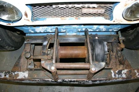

But I actually did something on my HJ today. No, I'm not really ready to rip into it yet (well, my hands say "yes," but my wallet says "no"), but....
So I bought a PTO winch a while back (thanks Jeff!). Today i got motivated enough to at least make sure it would mount correctly. There was a bracket that had been welded onto the bumper which got in the way, so today I decided I just *had* to cut that bracket off. To do that, I needed the plasma cutter. To get the plasma cutter to the truck, I needed the truck in the shop.
To get the truck in the shop, I needed the Power Wagon. Now, the HJ doesn't exactly roll too well, so the small incline that is in front of the shop wasn't even enough to get it rolling inside. So, since we had intended to get the plow on today, we just used the plow on the Dodge to give the HJ a nudge into the shop. So easy!
Then I had to cut the bracket off. Don't get excited, it was like 6 inches long and I had to cut all of 6 welds. It wasn't even worthy of a picture, that's how lame it was.
But once it was off, I laid the winch in there. Fairly good, but I think *something* is tweaked in there. All 4 bolt holes for the winch brackets don't quite line up, so I need to figure out what is bent if I care that much. Or I could just bolt the front down and enlarge the holes in the back (they'll be under pillow blocks anyway, so nobody will see them). Either way, I'm happy to see the winch on there. It looks good. I can't wait to mount it up for real. :)

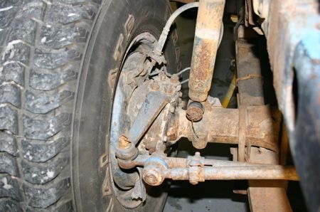

As to the front....
I want to keep the disc front end under there. But I also want to rebuilt it (obviously). So I think my plan at the moment will be to swap the drum front under the truck, so that I can remove the disc front axle and rebuild it sooner rather than later.
A couple of questions though....
1)The right side has an air scoop, while the left doesn't. Is this normal, or were parts only replaced on one side at some point?
2)The U bolts go around a small bracket on the disc axle, the drum axle has substantially larger brackets on the top of the axle, does this matter, or is it just a minor change?
3)The housings between the drum and disc axles are interchangeable, correct? The only *real* difference is the knuckle, right?
4)The seals in the Marlin kit are generally considered to be the best option here, yes?
5)Eventually I'll buy an OME kit for the whole suspension, but in the meantime I just want U-bolts for the front... Are these available on the cheap by themselves until I go for the whole OME setup?
Anything I'm missing? The pictures of the disc front axle might tip someone more knowledgeable than I onto something stupid I'm about to do... :)
Dan
As far as I know, the dust shield with the air scoop is a 61 series (and later) part - I've never seen these as a stock 40 part. If you look back a few pages on my build thread, you can find the part number for the later style dust shield
I think that's a relatively minor change, though I would imagine the beefier, the better (which would argue for using the drum axle as a core and rebuild it with the disc knuckles)
Yes, in terms of the mounting pattern at the hub flange, so long as you have the 8-bolt pattern on your full floater, which you do. I don't believe the axles are 'interchangeable' however -that would mean a fair bit of welding action :^)
I'd agree with that, though if you have the centering tool, you will be fine with stock seals too. The Marlin shields are a better and heavier-duty design though, and they're not expensive, so why not? The only negative would be their relative newness on the market.
Sure, you can find them at a 4x4 supply for $8~11/piece. Since it's temporary, it wouldn't really matter if you used imperial u-bolts instead of metric (harder to find at the local shops, IME). The OME u-bolts will be metric.
