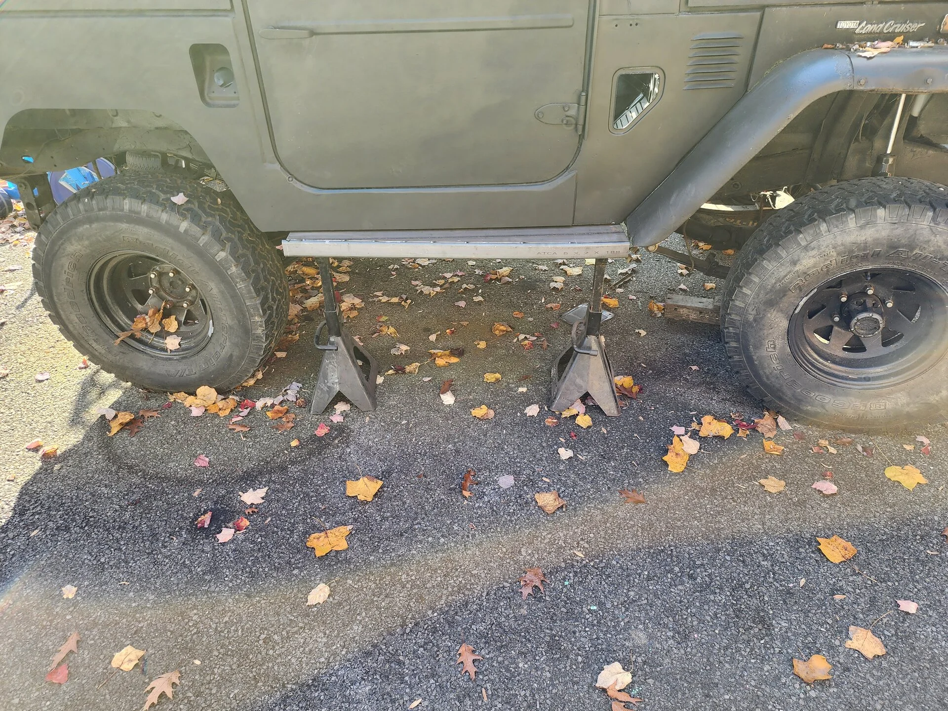

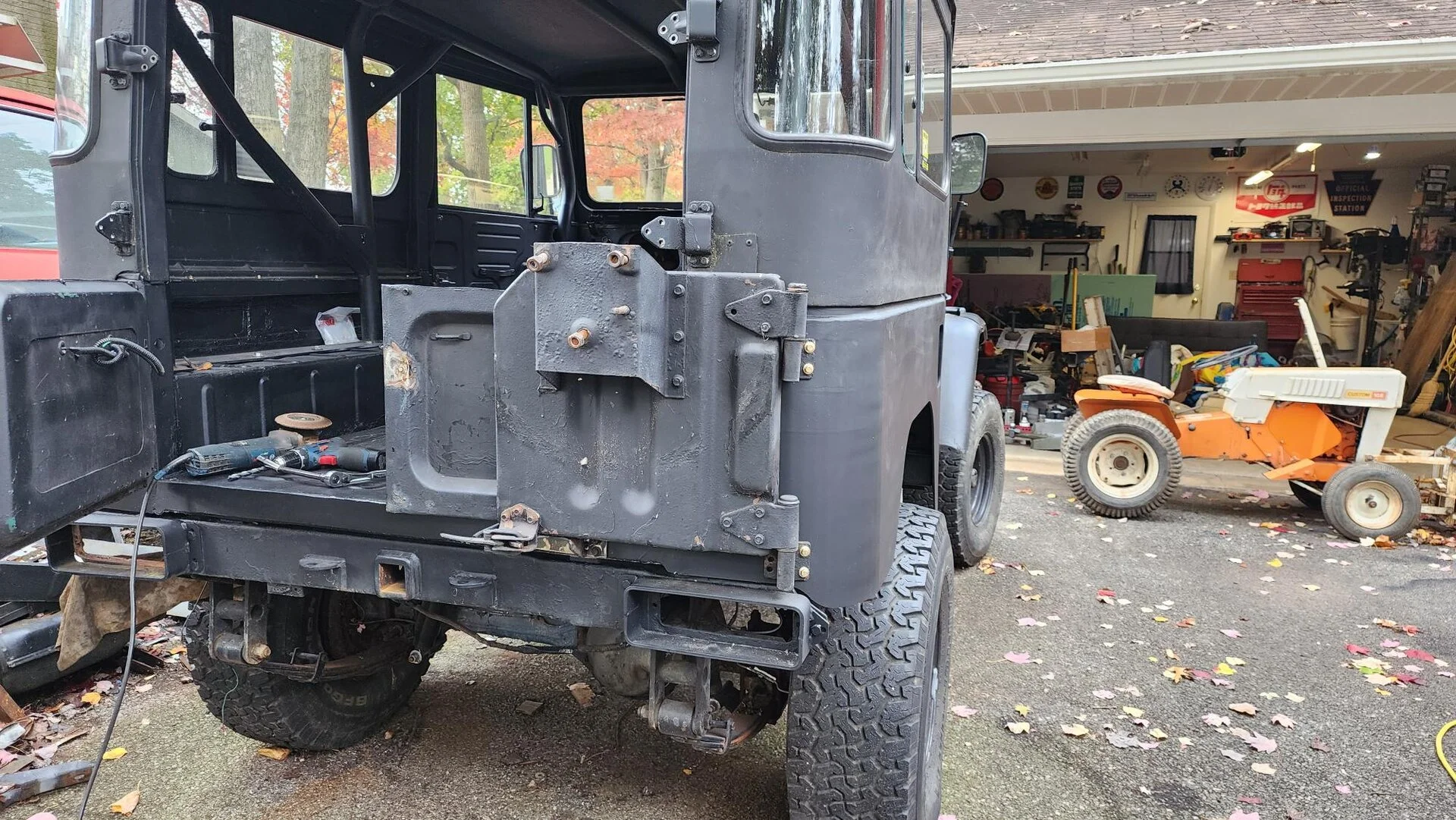

continuing with this 74 rebuild....have to say i really like the buds 0.1875" quarters.

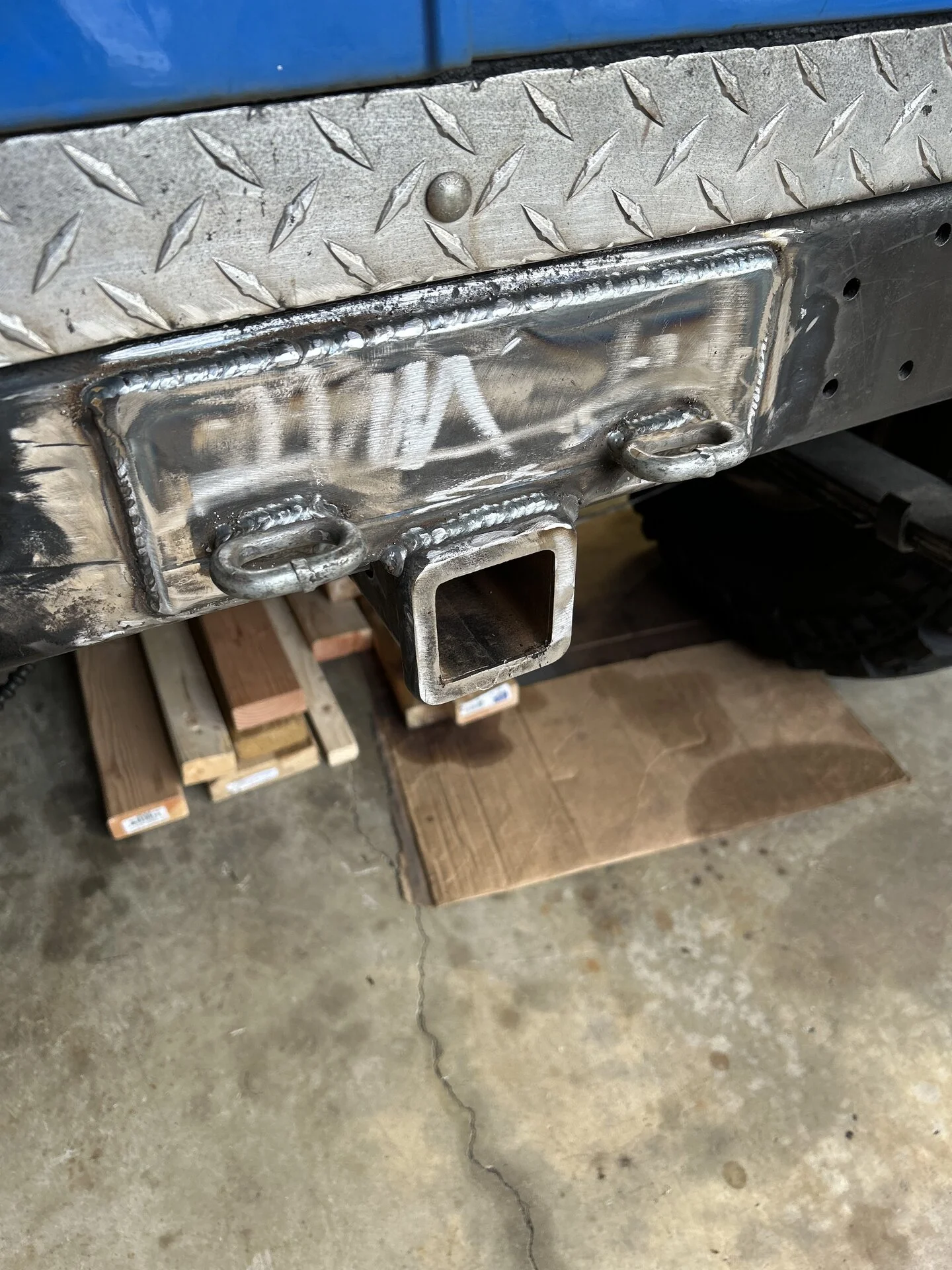

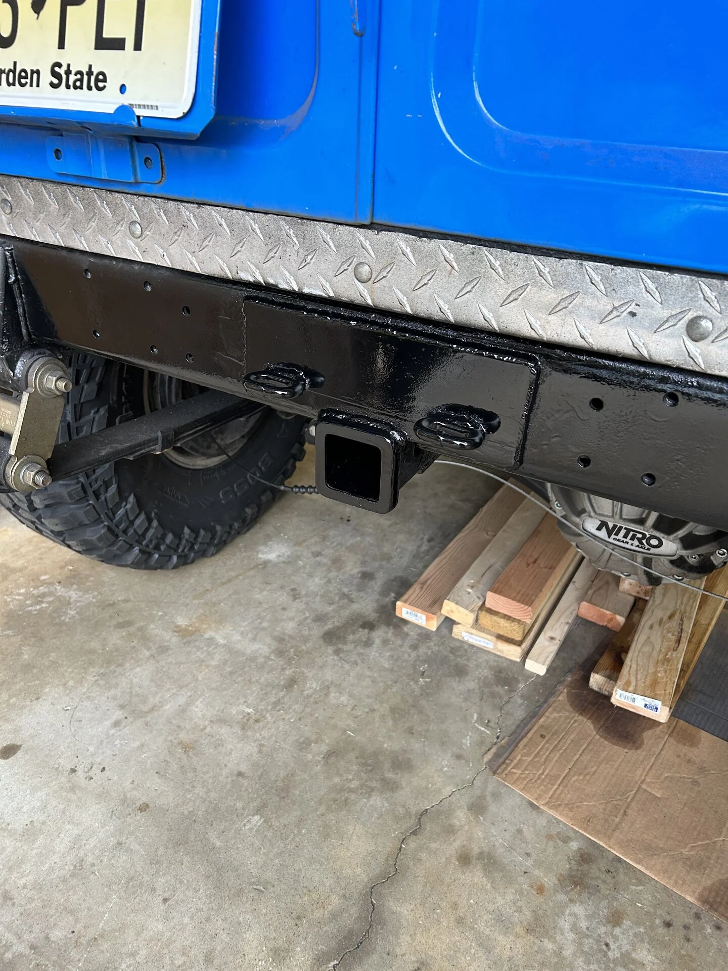

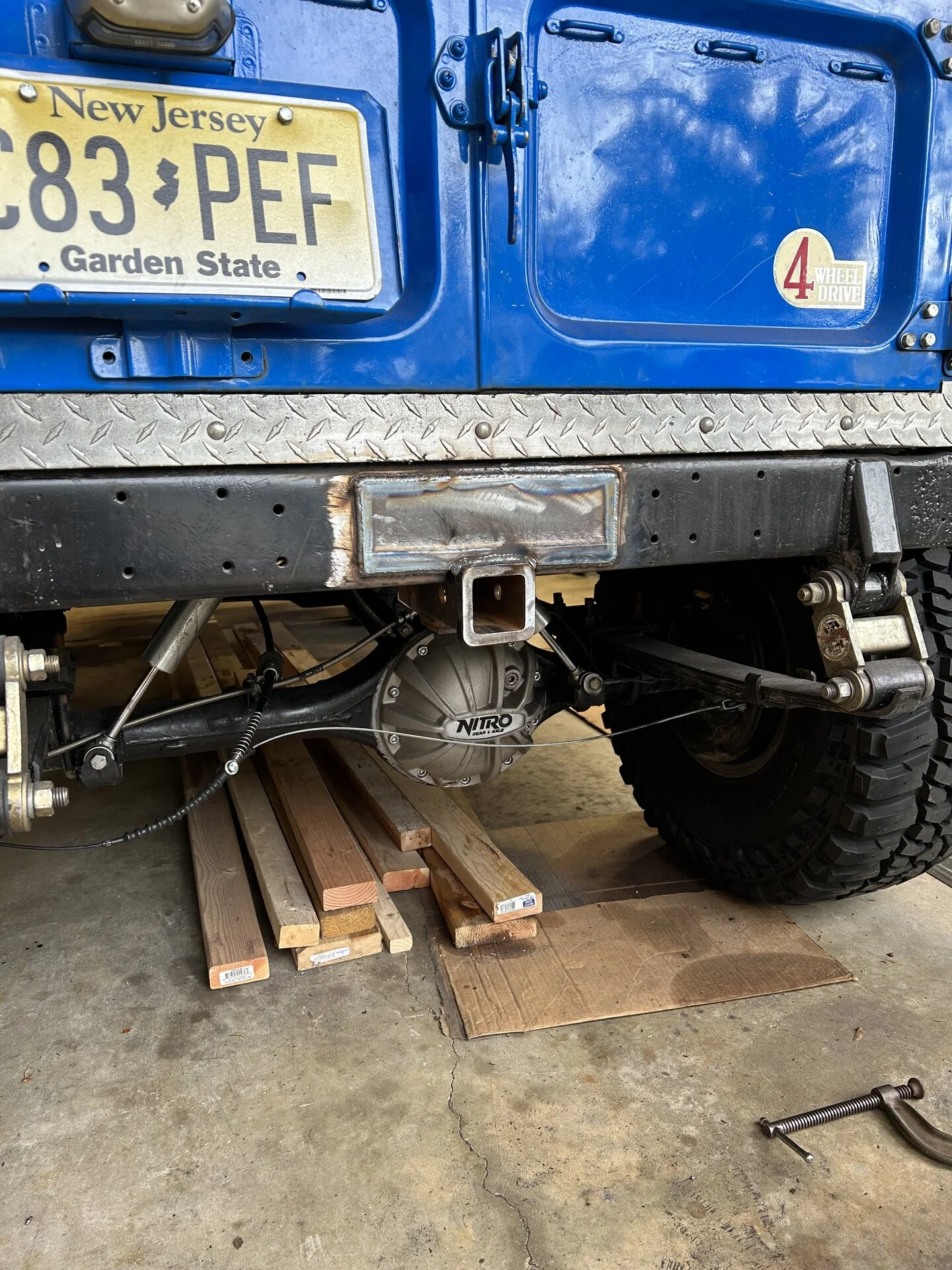

I wanted to be able to move the empty flat deck trailer around with the FJ40, as our tow rig is the wife’s Expedition and if she’s running around with a bunch of kids I don’t always have access to it. I’ve had an old trailer hitch that I think originally came off a Chevy pickup, so on it went. It runs full width behind the bumper and welds into the frame rails pls the bumper itself. Should be fine for light duty stuff, and serve as a recovery point as well.

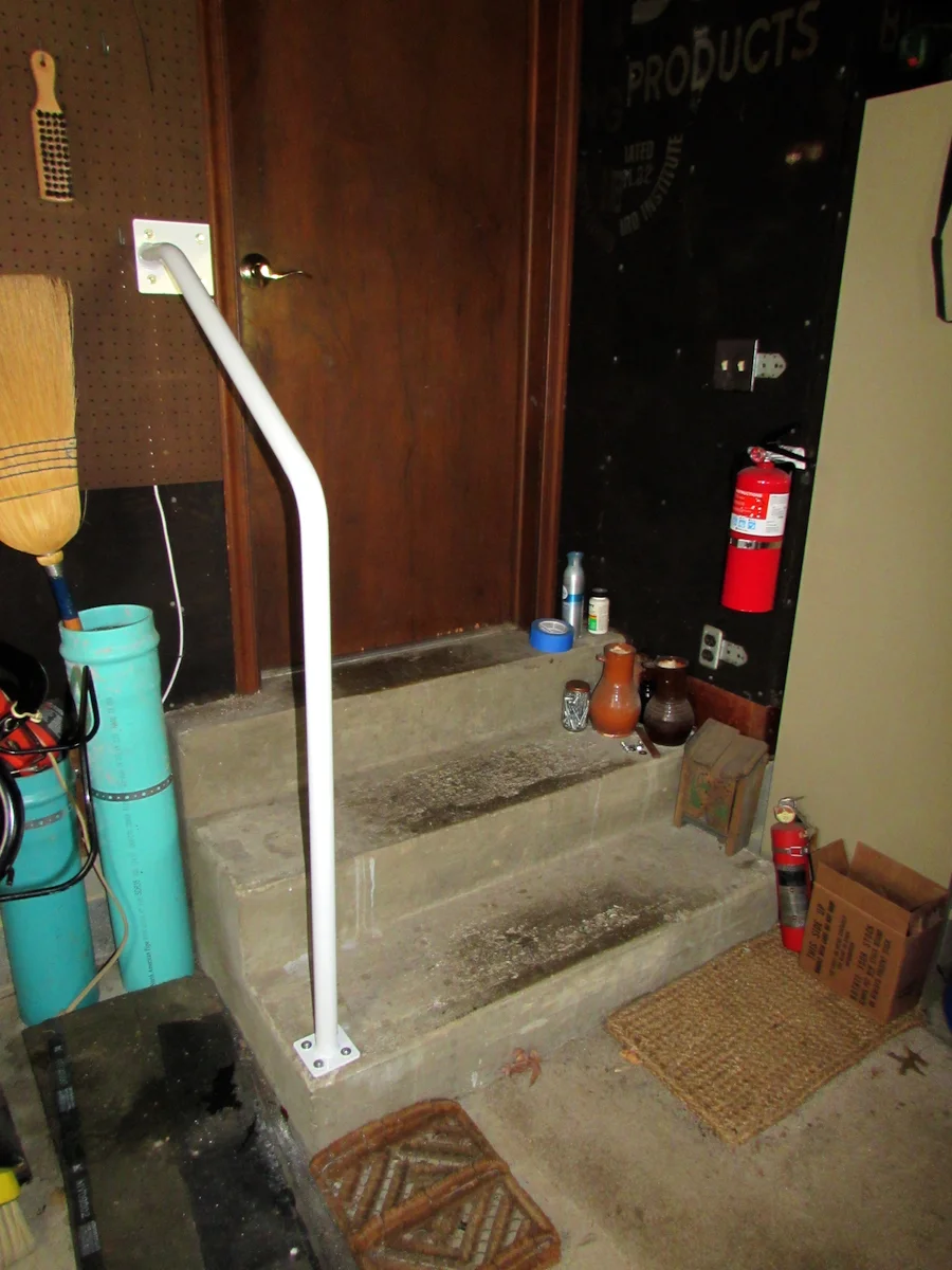

So, the other week my eighty-plus-year-old father nearly took a bad spill in his garage. The steps to the kitchen have never had a handrail since it was built in the late sixties. I guess better late than never.
Bent up a tube, cut out some plates, welded them on, and powdercoated everything up. Have to head over there this afternoon to install it for them.
img_6507edit-jpg.3473578
And got it installed...
Wow, nice work Andy.

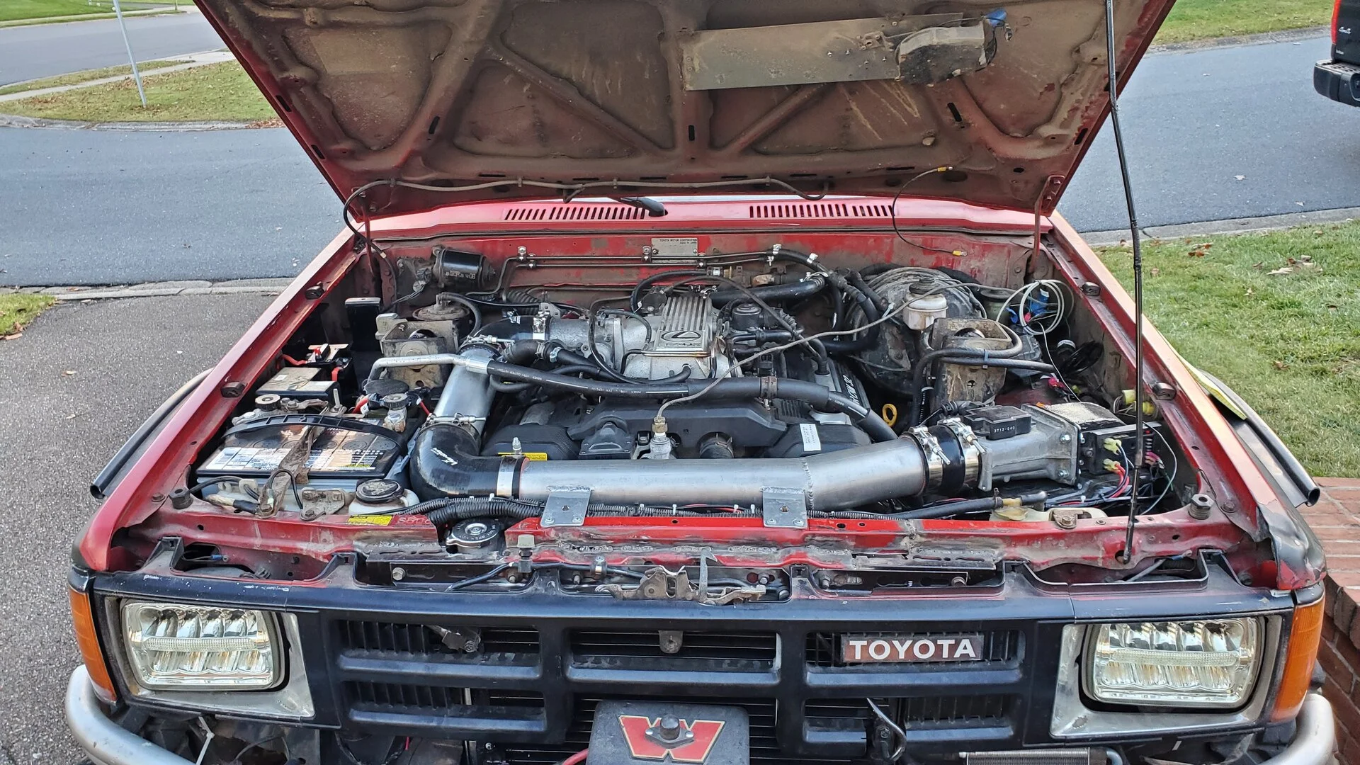

I still can't believe that fits....
