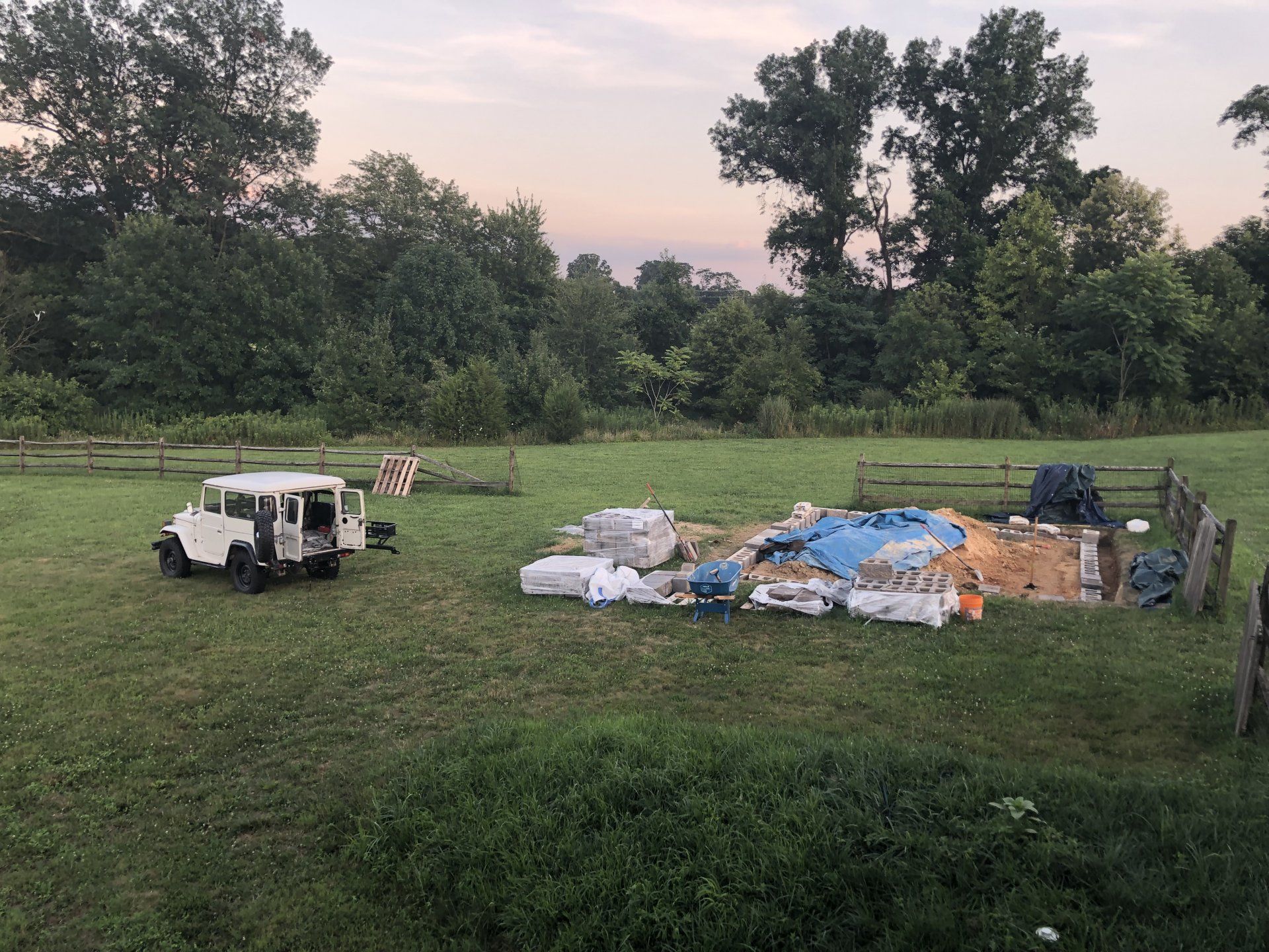

The recent monsoon did some serious work on my retaining wall shed foundation - and I’m out of leveling sand to correct it.
No problem, I thought - just hop in the Mazda and grab a few bags from Lowe’s. Like an idiot I’d left the keys in the ignition (for the second time this month) so the 40 had to tag in.
Since it was already up and running, might as well put it to work. Ended up grabbing 500lbs if drainage gravel, 250lbs of sand and 40lbs of beer.

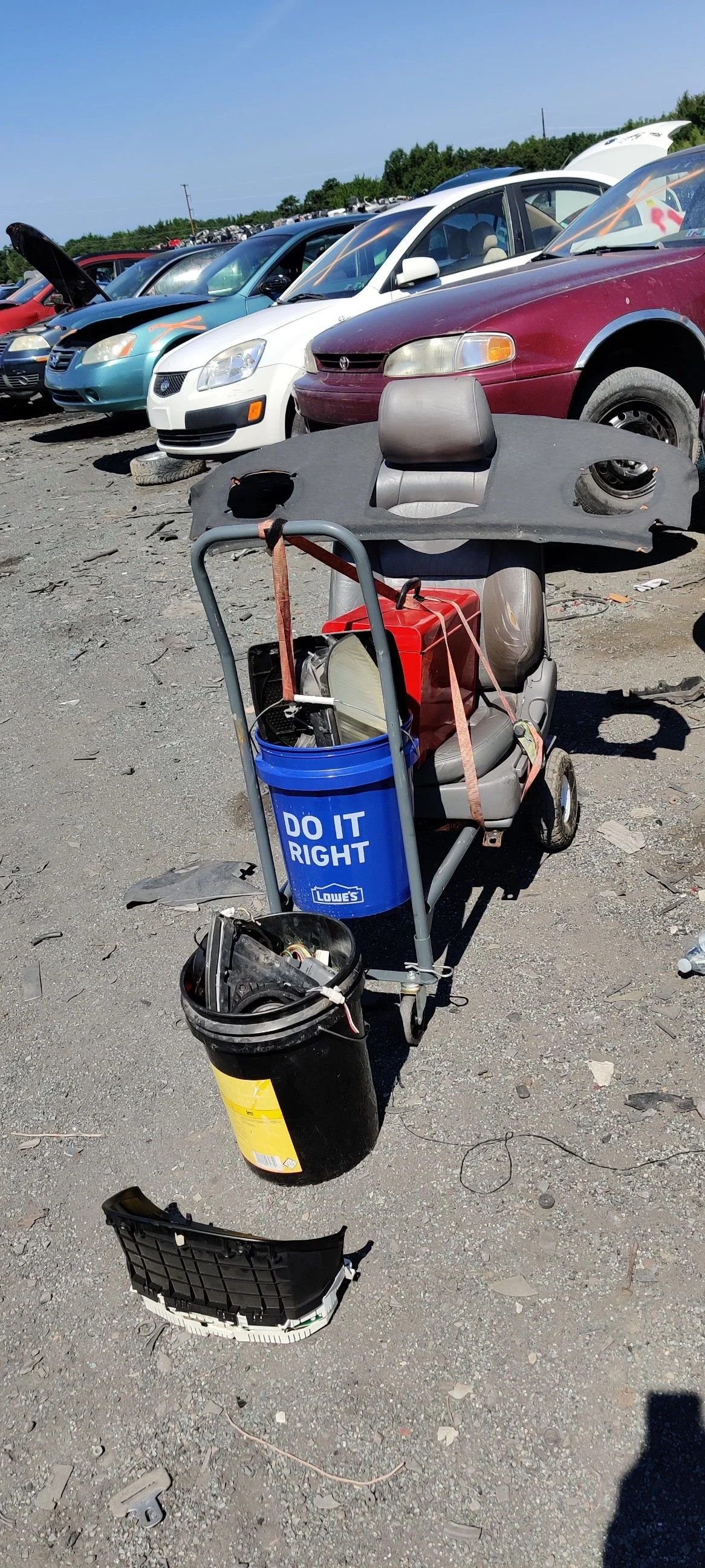

Last weekend before heading to Andy's I stopped at Harry's because they had an 94' SC400 that Andy needed the ECU (which was already taken) and the MAF from and I could use a few parts for mine and well:
Score! Heads lights in better condition than mine, driver seat that stays in the locked position (on braking my seat would like to flip forward), rear factory speaker pods with decent speakers (I have some installed that are just sheet metal screwed in and now melted due to the sun), rear parcel shelf cover and speaker covers (to clean up the look of the rear), both front windows switches (mine are going bad), trunk light (mine had melted?), And cluster to hopefully get some parts off of (Lexus has needles that are lit up and we'll.prvioisnowner painted over them and tried to use black lights to illuminate them and it didn't work...) All in for $256.

The recent monsoon did some serious work on my retaining wall shed foundation - and I’m out of leveling sand to correct it. View attachment 2383643
Even the Bible tells you not to build on sand...
Matthew 7:26-27 - (26) And everyone who hears these words of mine and does not do them will be like a foolish man who built his house on the sand. (27) And the rain fell, and the floods came, and the winds blew and beat against that house, and it fell, and great was the fall of it.”
It does exactly what your picture depicts - the sand washes out from under it, settles, and everything falls apart.
Just following the manufacturer’s instructions. The sand is only about 1” deep - basically enough to do the final leveling of the blocks with a dead blow by sinking them into the sand. then there is around 6” of crusher run under that to serve as the more solid base and prevent frost heaving. Once the wall is buried I suspect I won’t have this problem but while the sand is still exposed it’s proving to be a mess of biblical proportions, for sure.

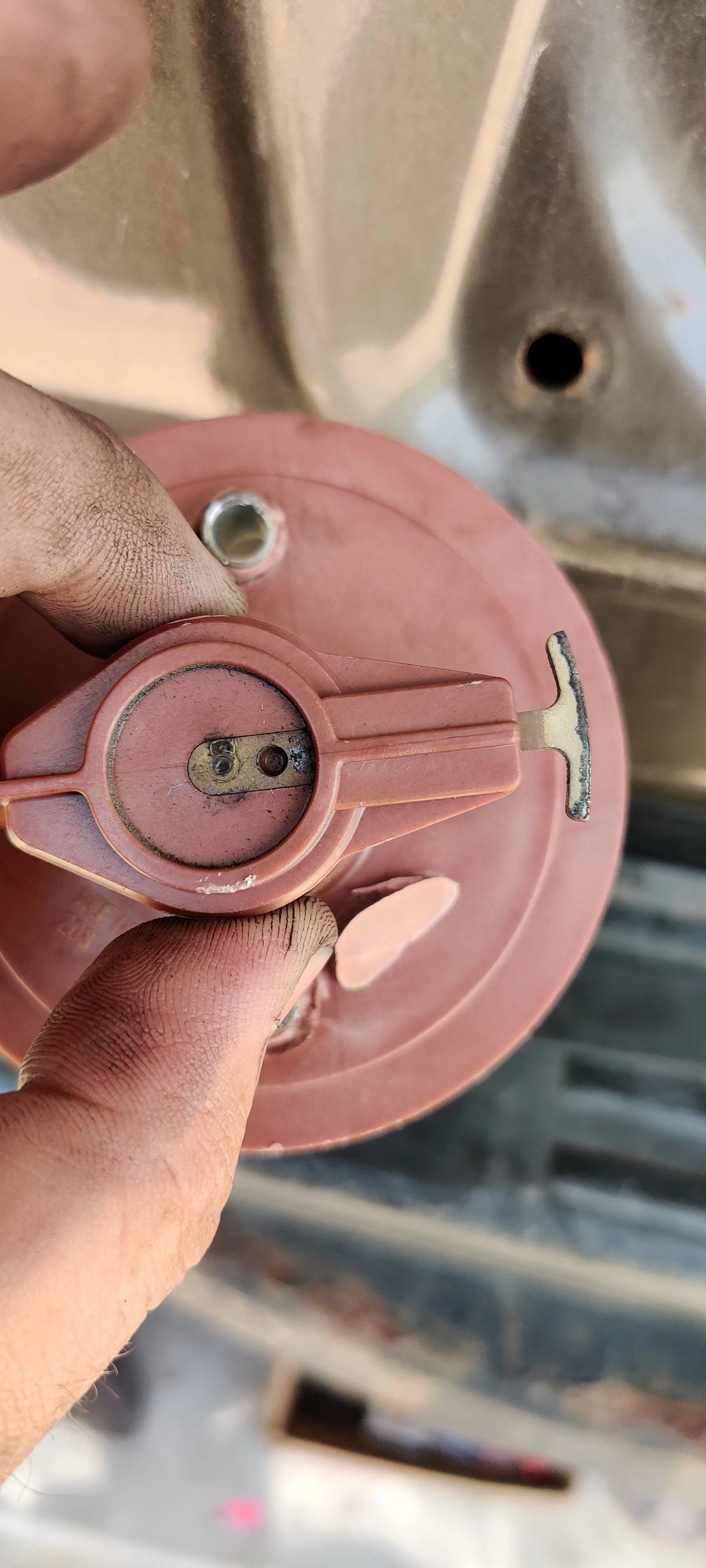

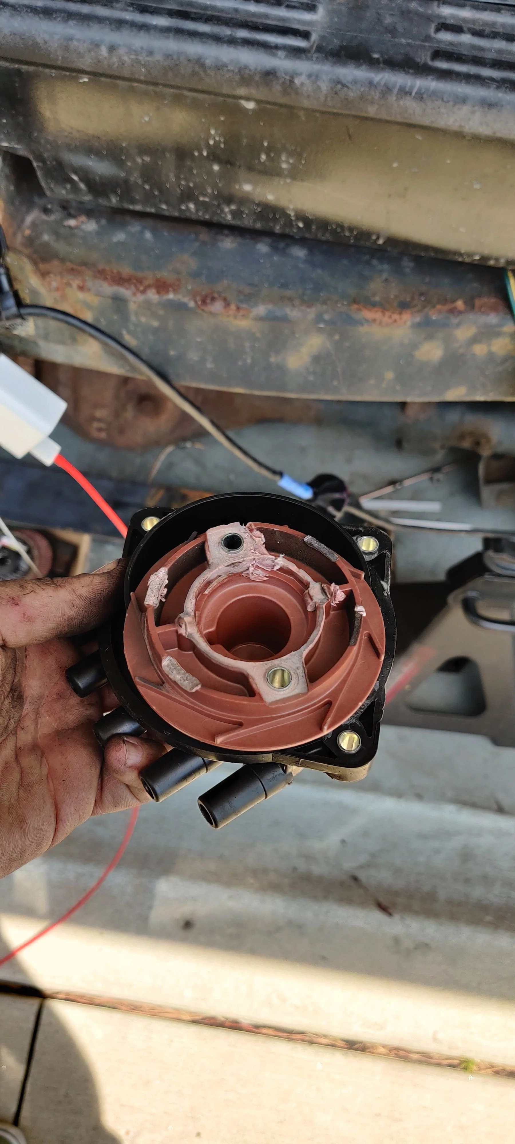

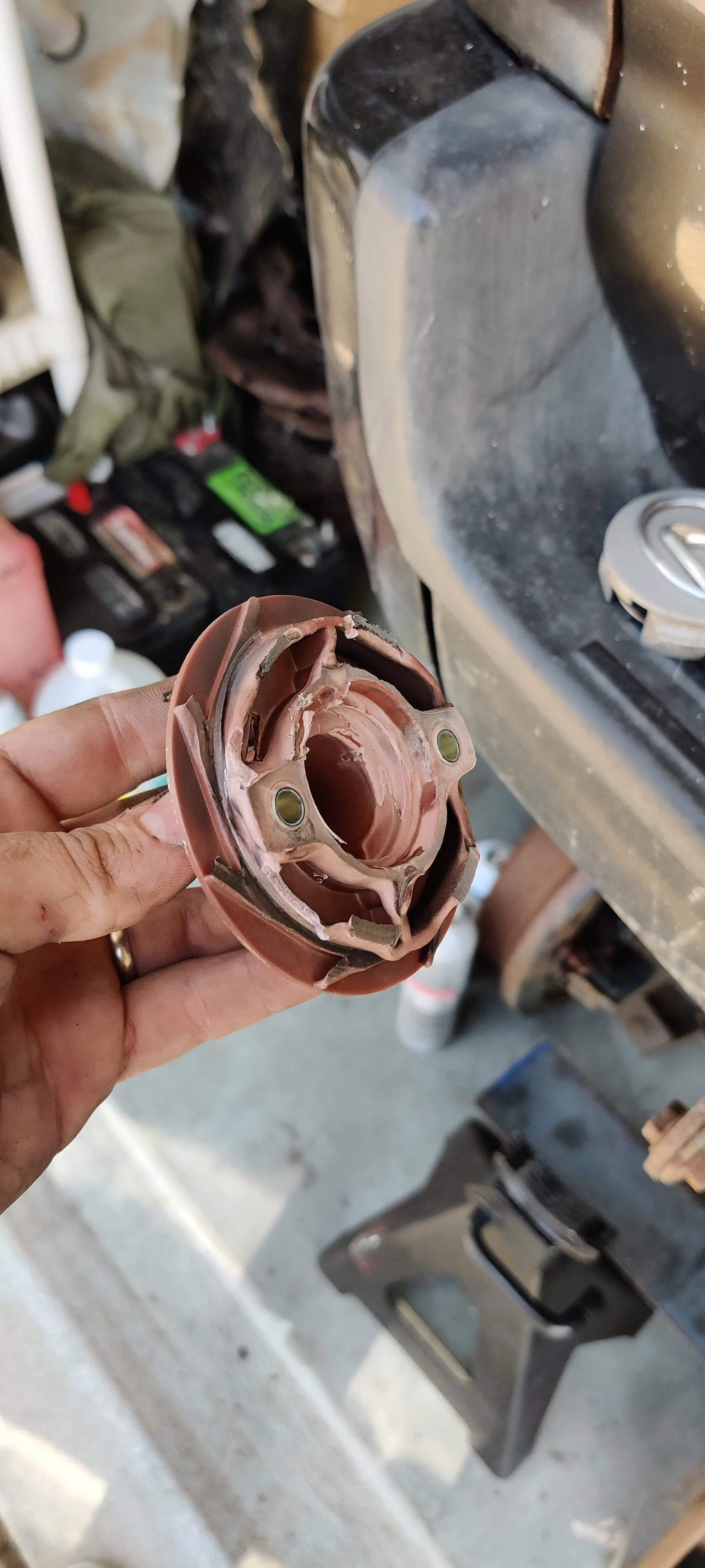

Started to tear into the 1UZ and hit a couple of snags on the way, first being this:
Driver Side:
Passenger side:
To get to the came shaft seals you need to remove the distributor caps rotors and housings.
As I was working on the drivers side I noticed the bolts for the Distributor housing weren't even hand tight D'Oh! -_-
The distributor cap was melted to the housing and the rotors was melted around the cam gear spokes, I had to hammer it off from the back end of the sprocket...
My only guess is that due to the housing being loose, this thing must have been arching like crazy causing it to melt. I am just amazed at how well the car ran with the housing that loose, passenger side was not as bad but still had to be chiseled off...

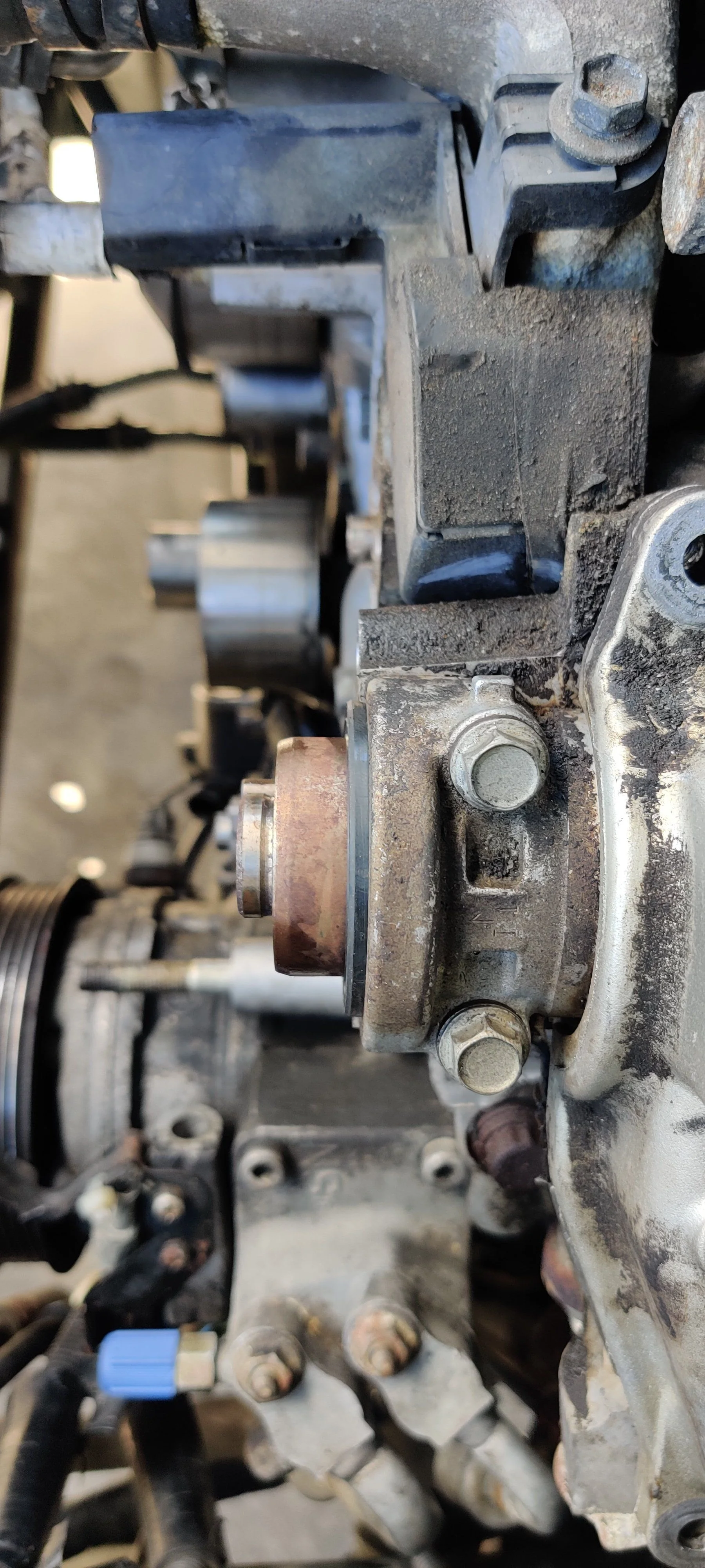

Then I reached my next obstical:
The cam shaft seals I purchased are too thick D'Oh! Again! -_-
and even if I tried to used them, when you try to install the backing plate for the timing cover, it begins to push the top of the seal out....
So the distributor caps, rotors, and a different set of cam seals have been ordered and are on the way. The car sits dead again in the driveway...
The upside to this is I actually think those came shaft seals will work on the 5VZ in the 4Runner so when its finally time to do them I will be set!
