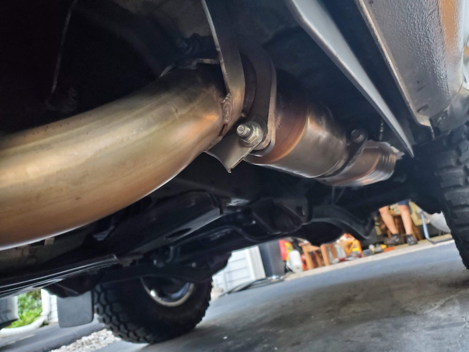

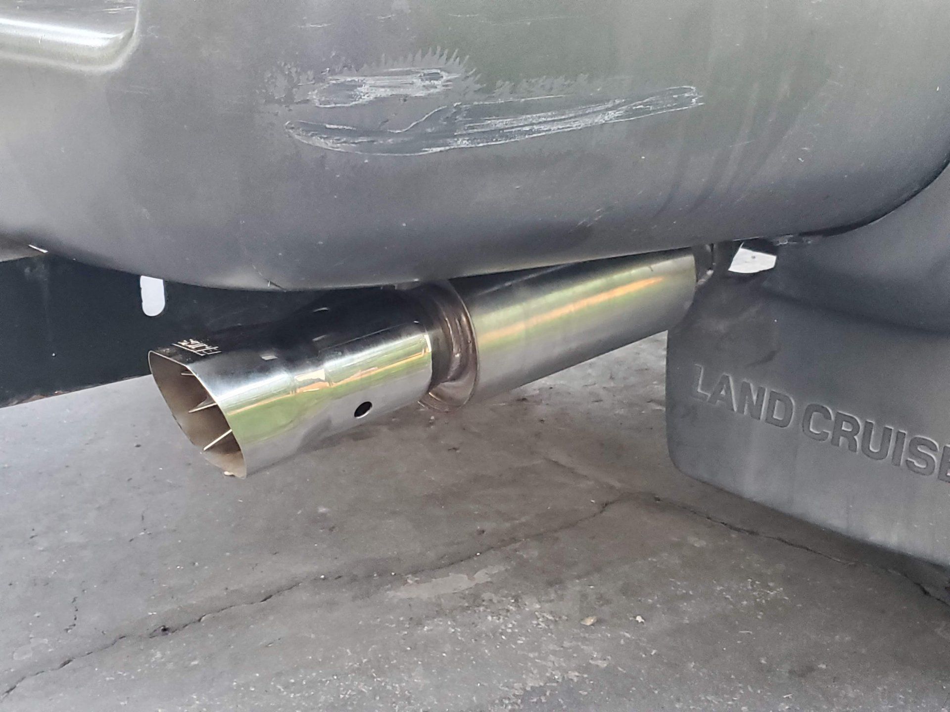

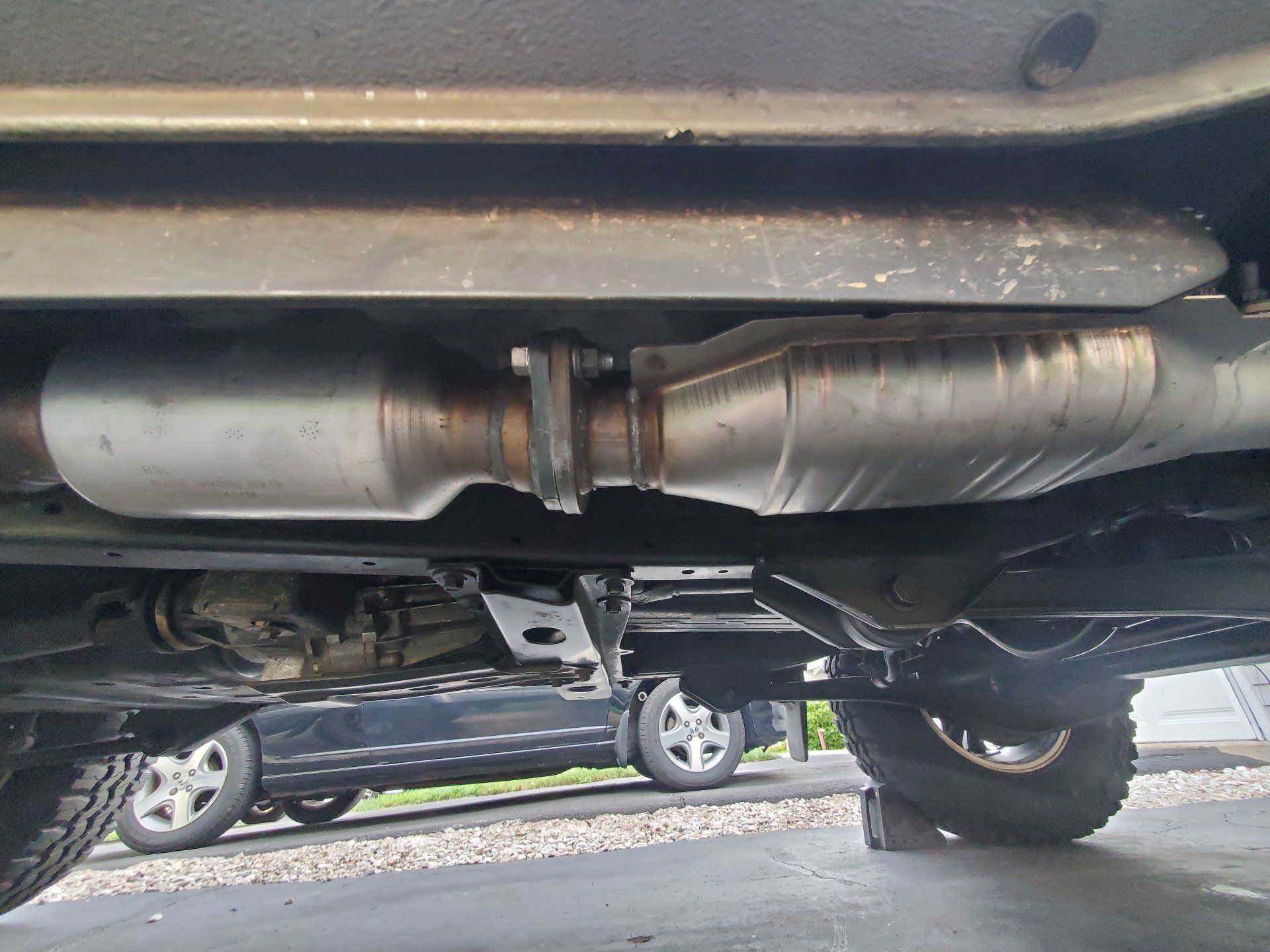

Replaced the old 80 exhaust with the MagnaFlow down pipe, catalytic converters, new O2 sensors and a Borla exhaust.

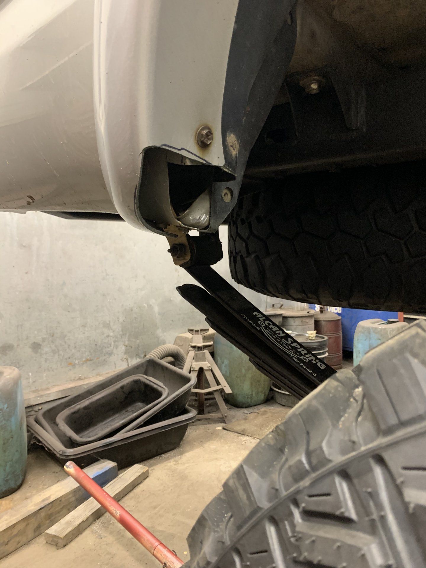

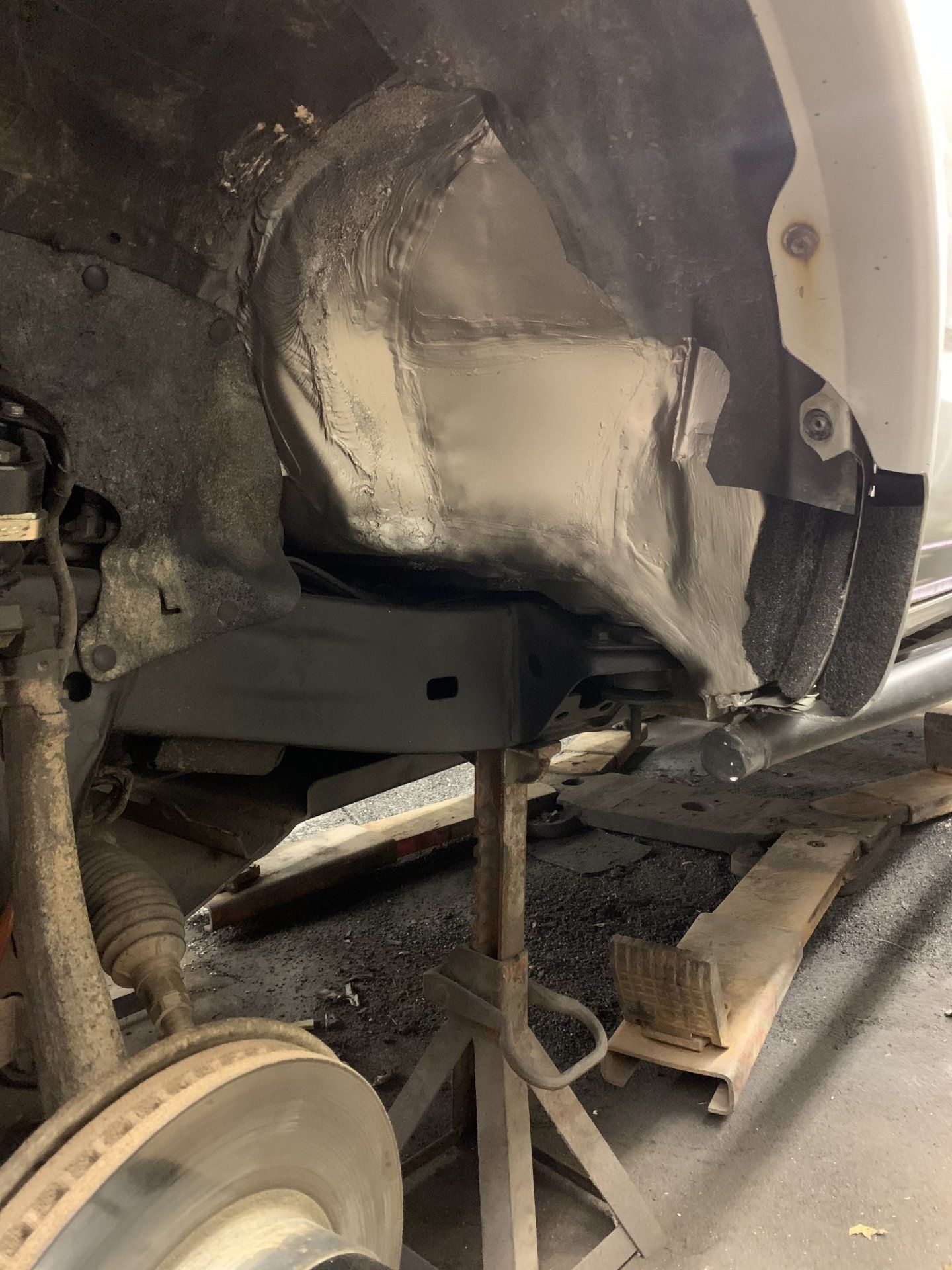

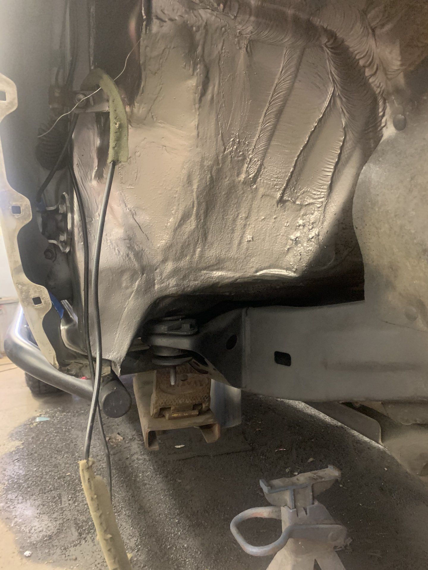

Update to the wheel well tub. She’s all done. Still rub the frame on full lock but I can live with that.
How much did you cut the outer fender? And what did you do in the back?
we didn’t have to cut any of the fender only the flare towards the bottom back end there- we used some foam pipe insulation and spray adhesive to fill the voids of the flare. The back we just trimmed the flare and some sheet metal too the first mounting location. It may rub still in the back will find out on the trails.
Here are some more pics
Ok I lied. We had to cut some of the fender under the flare I found a picture

Wow that is all you had to cut out of the fender and the flare???
Do you have a body lift? We had to cut more out of the 4Runner.

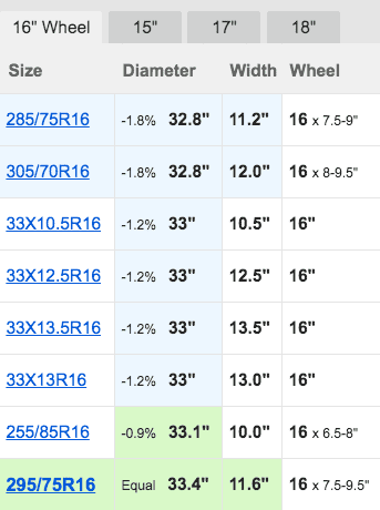

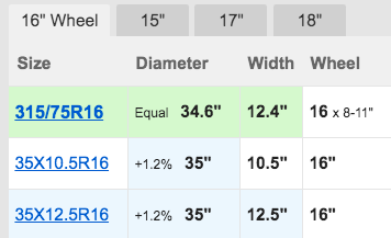

No body lift- that picture is full stuff with no strut. Also those tires are 34.5 x 11 I don’t plan on going bigger anytime in near future.

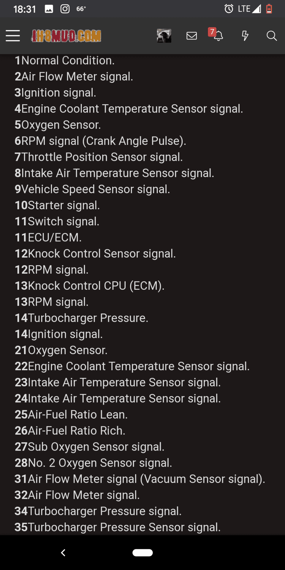

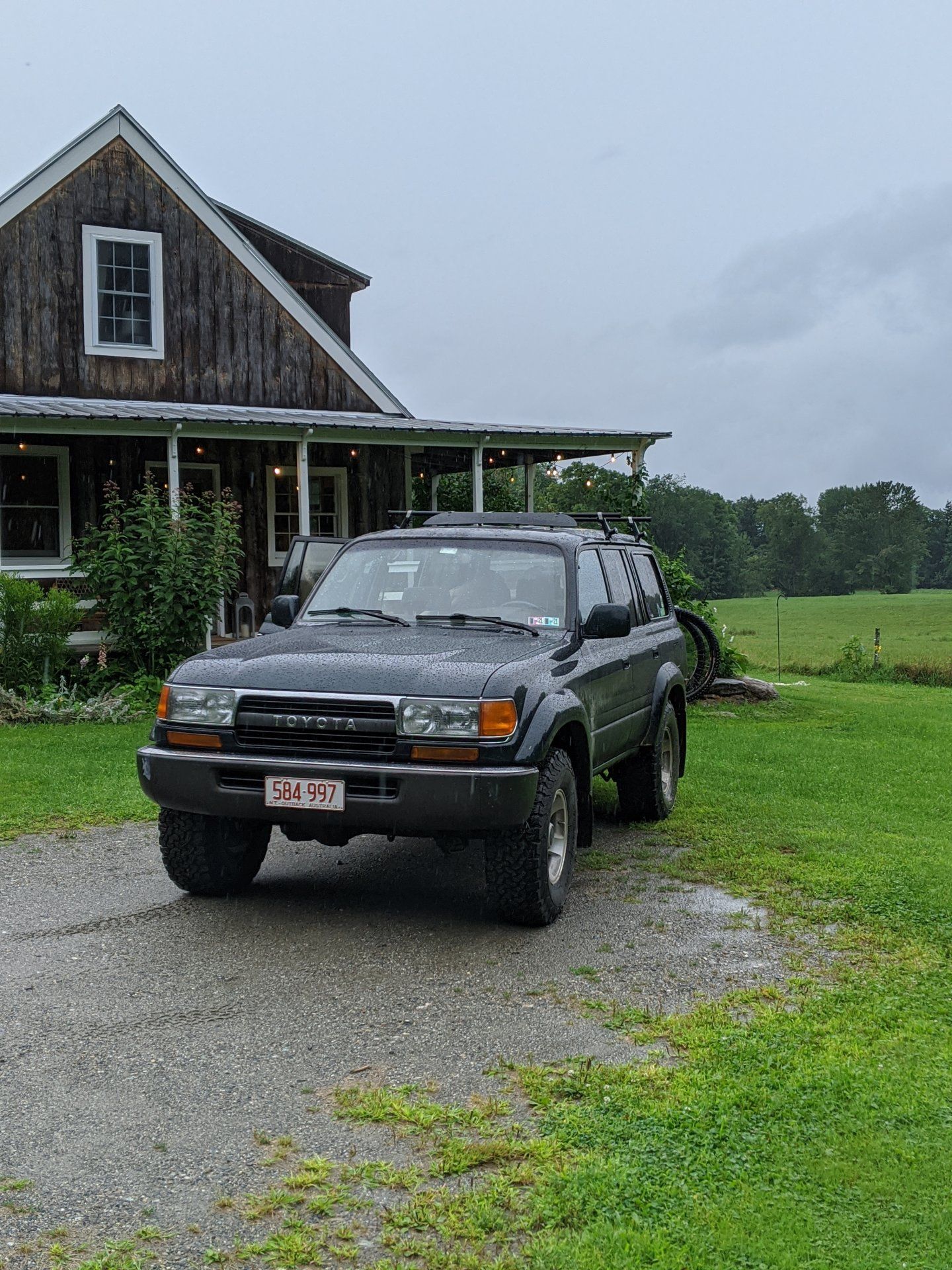

Took my cruiser on a trip to VT to get away for a while. Drank some beer, hiked a lot and tore up some mountain bike trails. Truck ran great, 1200 miles without issue until I got home yesterday. Started with a lopey low idle and would stumble hard on acceleration until about 2500 then woke up and ran fine until I stopped again. Then cycle would start again. Pulled codes 12, 25, 26. In the last 1500 miles or so, I did plugs, cap, rotor, O2 sensors and NGK wires. Like most of us, I'm on limited time and need to get this figured out asap. Any suggestions where to start?
Pulled and "plugged" the hose from the pair system to the air cleaner and that did nothing. Got that idea from one of the multiple threads on this issue. Any other ideas? No water crossings etc, just dusty VT roads. I was initially thinking bad gas?

What are codes 12,25,26 for? Loose plug wires?
