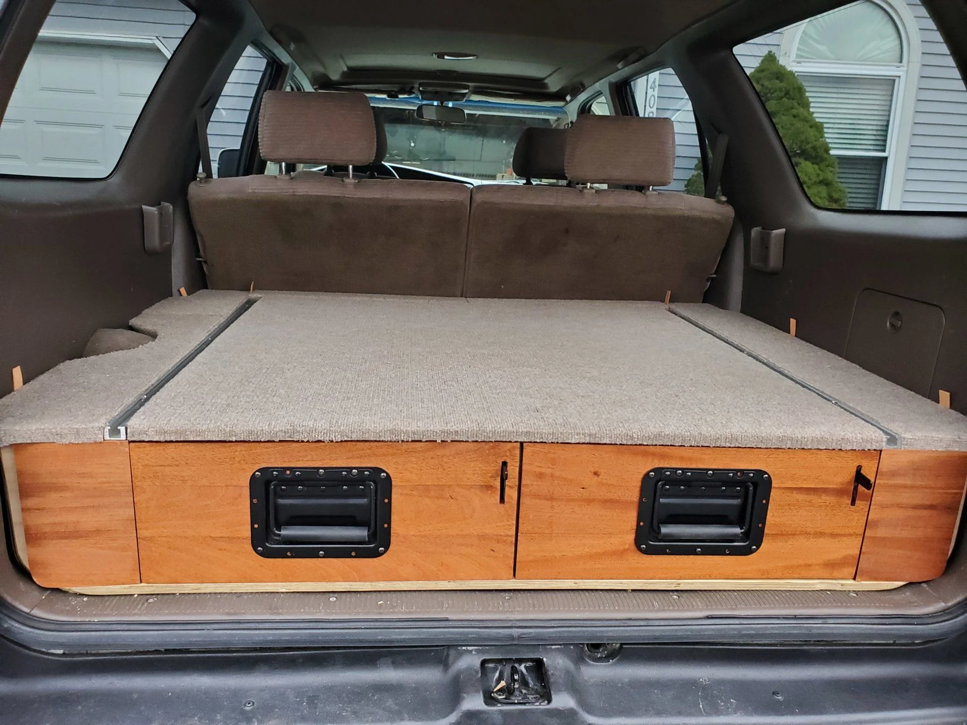

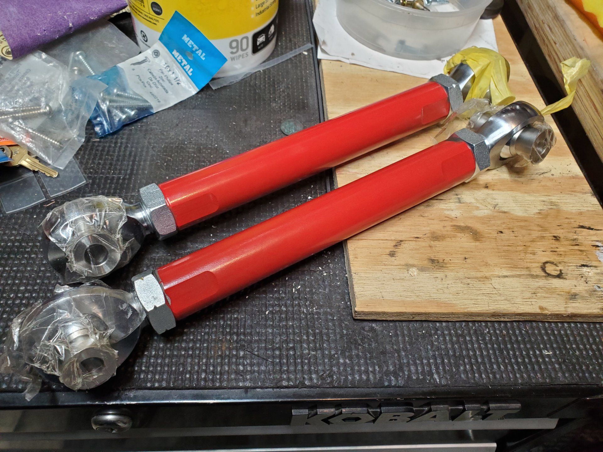

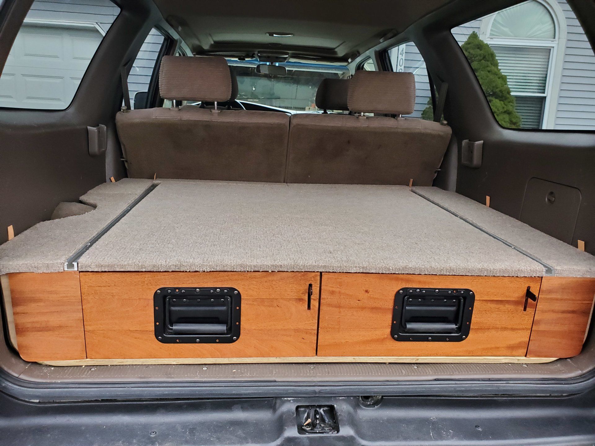

I completed the installation of the drawers on the 3rd gen 4runner and powder coated my new rear upper control links.

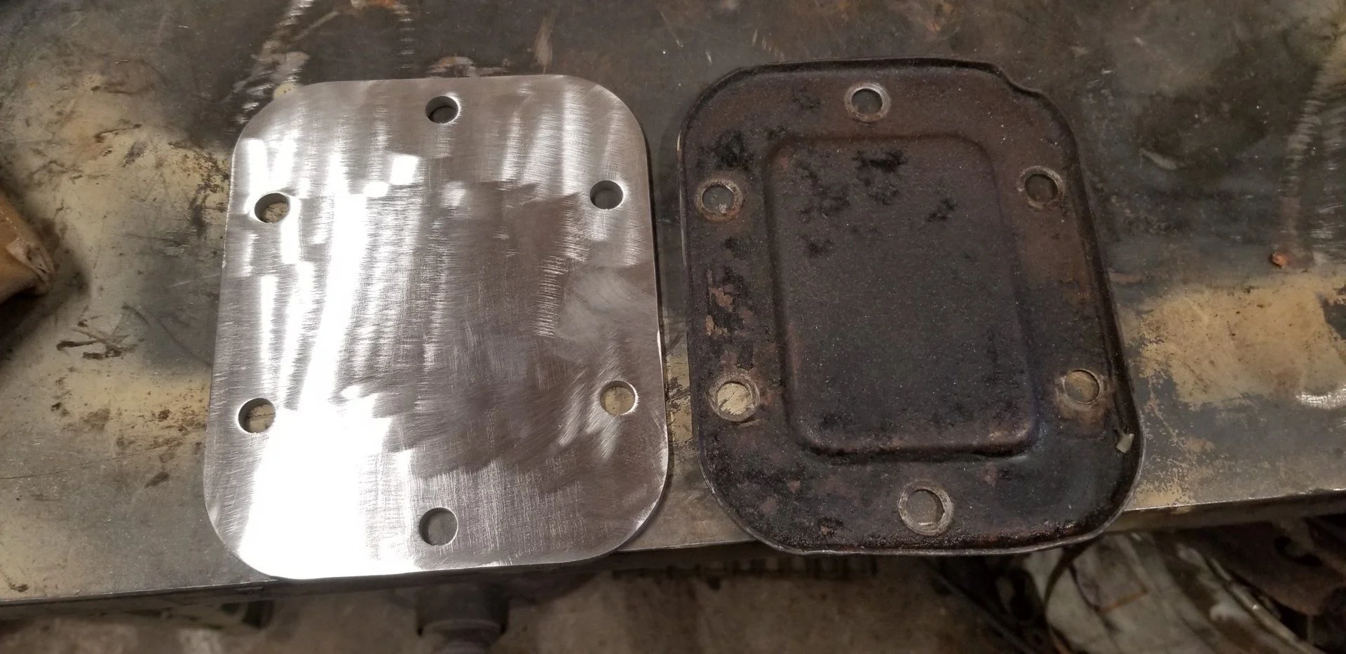

a couple of guys were at the shop working on their draft sight drawing skills and flow programing for the water jet, which was really convenient as i was in need of a new pto cover for my h42.
didn't really want stainless, but it's what was on the table....at least rust won't be an issue.

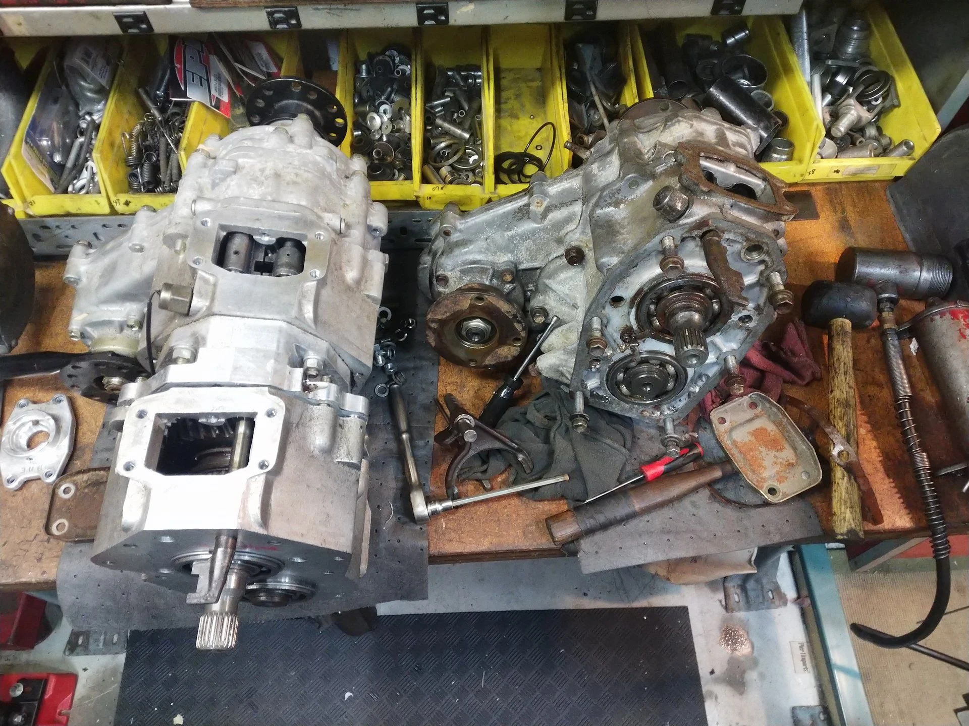

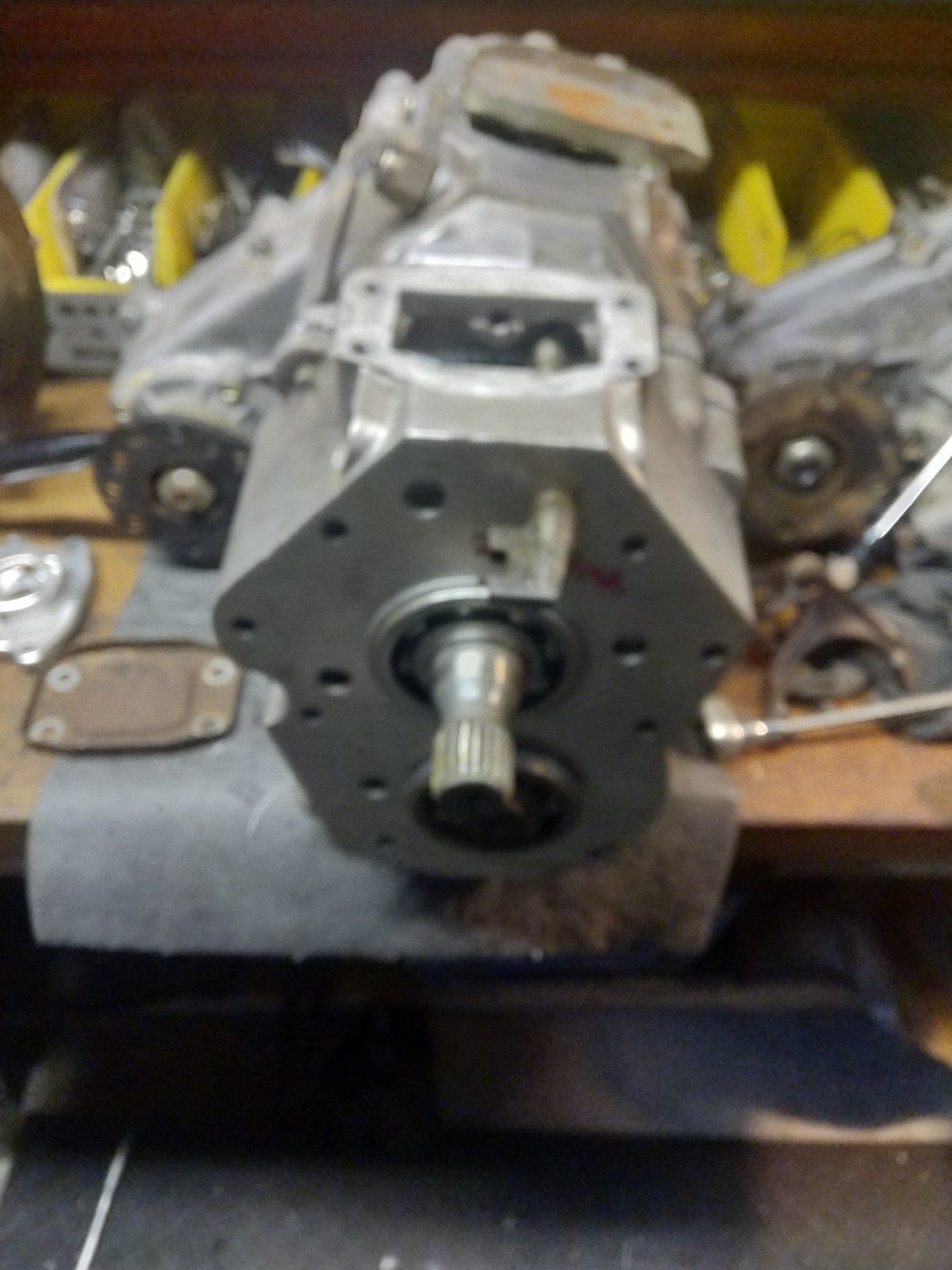

Yes and no, ground clearance gained, but now more mods to shifters and mounts. And if used with a traditional crossmember no ground clearence is gained. In fact it may be a problem with your crossmember where it crosses over the front output flange.
You've seen my skid/trans mount, the adjustable hight one you got so excited about....
I have a plan for shifters, shouldn't be a problem :banana:

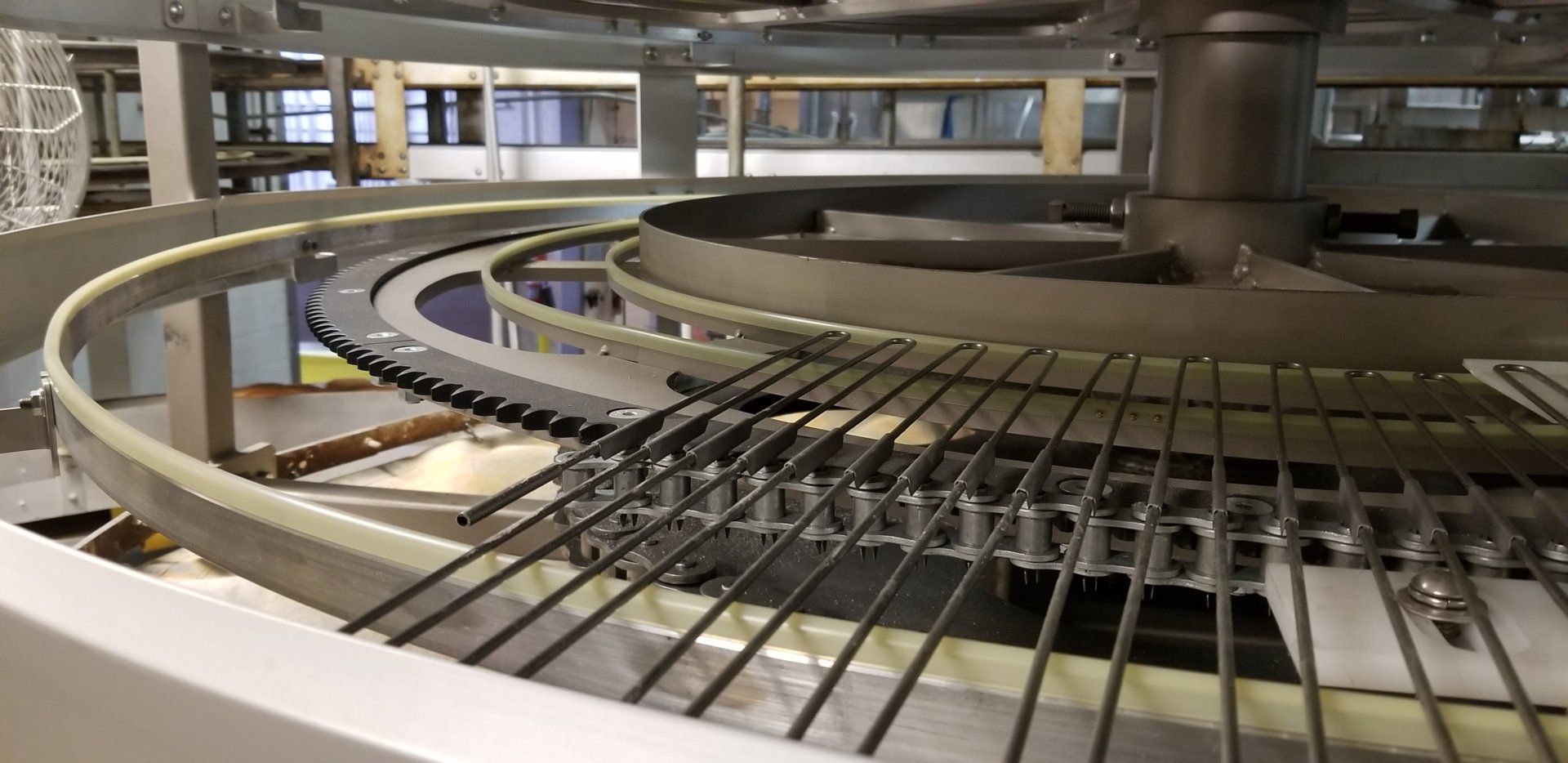

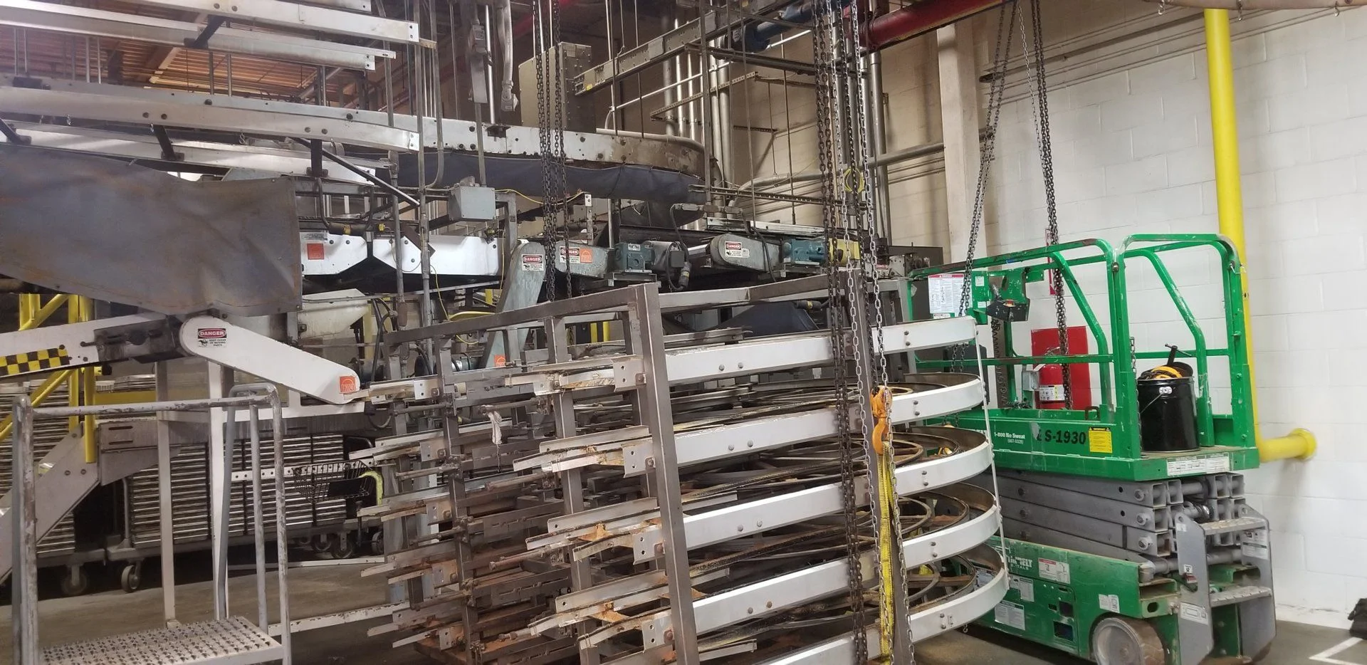

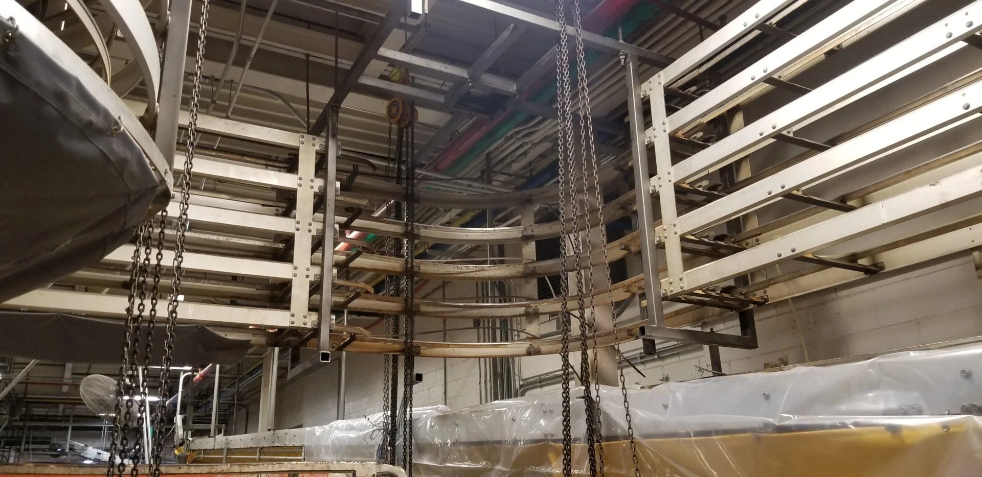

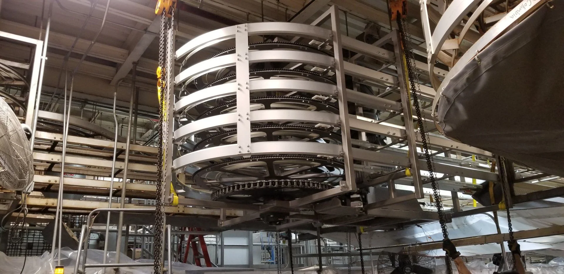

Race track cooler rebuilt in orangeburg SC.
New drive, new take up, one new 90, rebuilt two 180s, all new chain and wearstrip.
4580ft of chain....twice as much in wearstripping.
