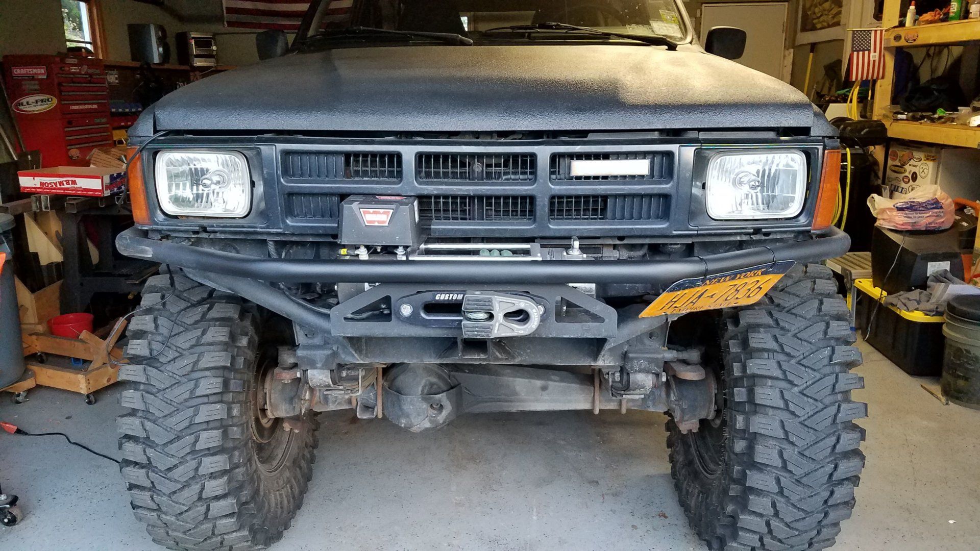

Been a long time since I've spent any time on the truck, but I managed to clean up the front end a bit. Ditched the silly light bar and bumper hoop.
