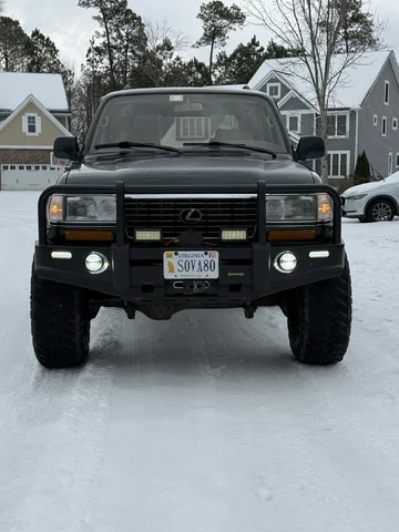

Spent the cold weekend in the semi-warm garage and finally got around to wiring up the lights on the front bumper. With little to no instructions and just a 9v battery and multimeter in hand I finally got it all sorted out. Fogs run to a 900-series AOB control on the dash and are switched with the main lighting circuit. Markers are white LED with standard lights but tied to the flashers and change to amber for that operation.
Actually, I forgot to give a big shout-out to Curly Dave for this, who gave me the basic jist of what to tie into on our dusk exploration tour of the Mountain River trail a few weeks back
