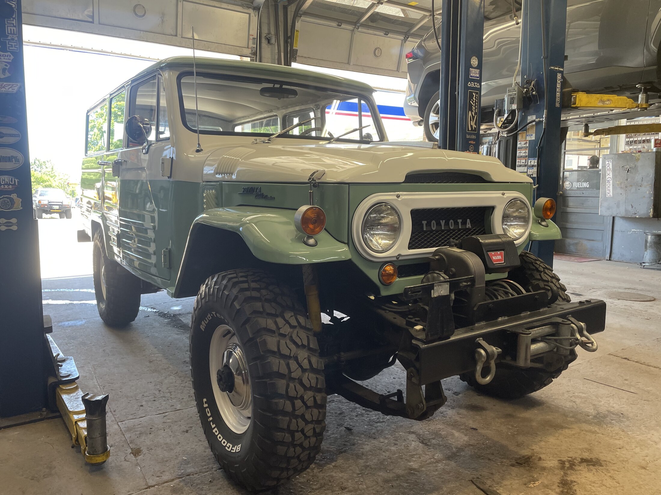

All the parts finally came in this week for a little suspension work on the 60 series.
Tires had been rubbing in the front on tight turns -- got caster shims -- and figured if I was going to take it all apart, I might see if I could fix the 60 series lean to the driver's side with an extra leaf.... and then in preparation of taking it on a trip with you all, I found some u-bolt skids. Installed all the front stuff over the past few days and took it for a spin this morning. No rubbing and riding a little higher from the driver's seat!
Before any of that started though, I went down there and found a nice power steering fluid leak. The pump had been relocated down to the lower passenger corner of the engine to put a new AC compressor up top, so it was a bitch to take off. Thinking I'd do one of the FJ62 / HJ rebuild seal kits, I snagged one of those. Whatever this pump is, I don't believe it came from a 60 series land cruiser and was impossible to even take off its bracket. There was one spotty looking permatex'ed gasket to the inlet port in the back that I re-did and it looked like the source of my leak was cracking in the inlet hose. Easy enough to replace, and will return that rebuild kit to CruiserCorps. Steering is like 5X smoother now that there is sufficient fluid in the system.
Also discovered there are no bolts in the front two body mounts of the truck. I don't think it's going anywhere, but another project for another day.

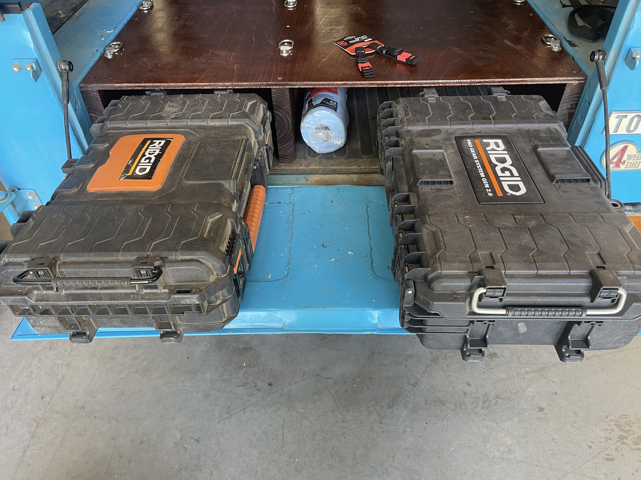

I finished up my storage system. Simple and somewhat light. The box is bolted to the wheel wells so it can not move and will hold stuff inside with the tailgate closed. Also makes it easier to get to my cooler.

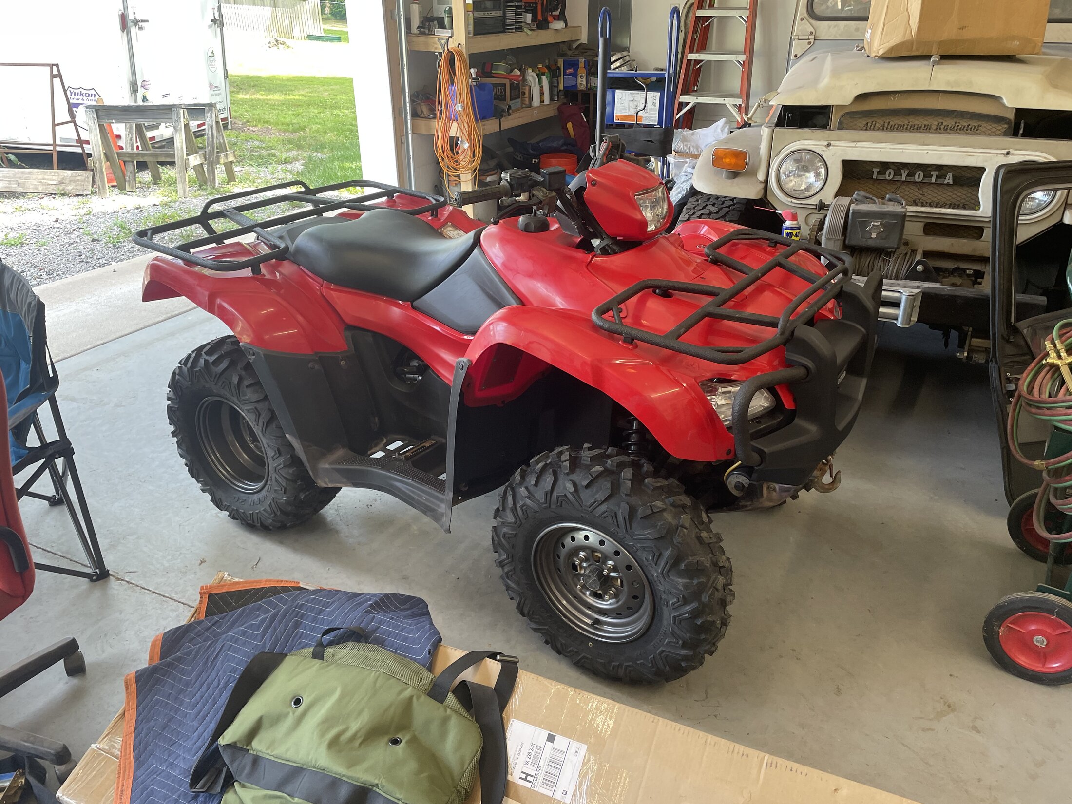

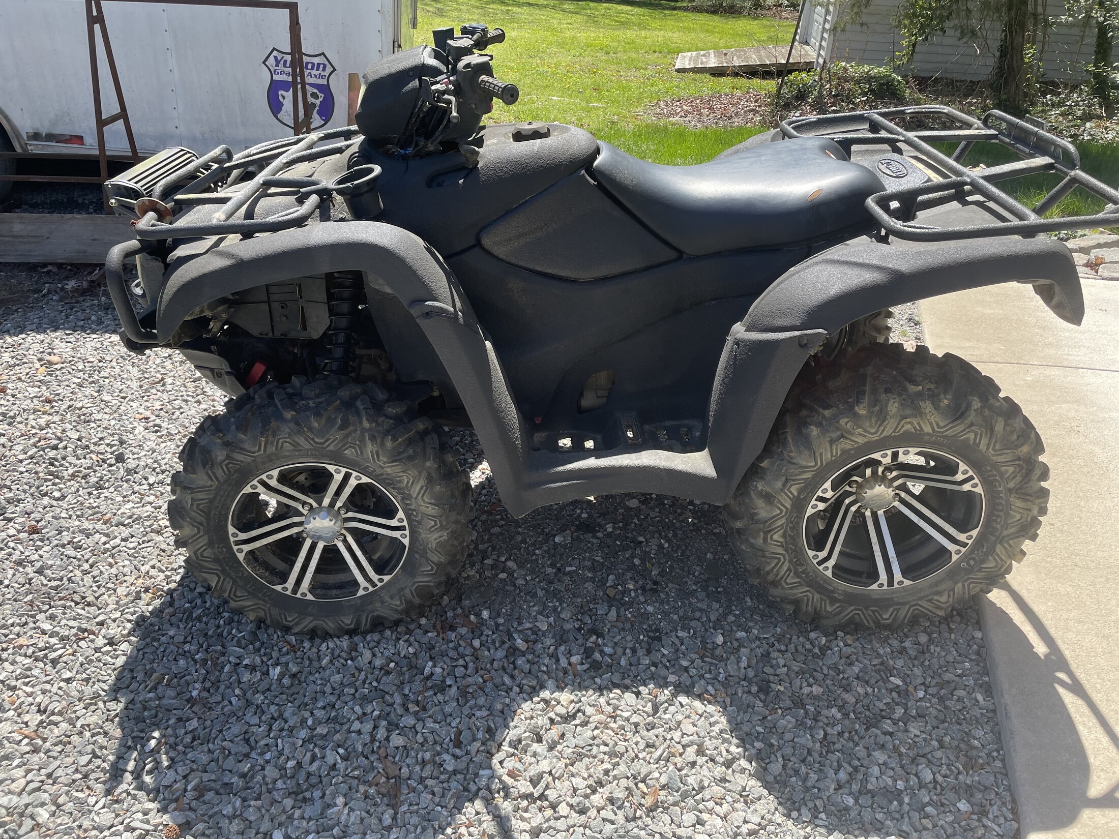

I also wrapped up my 4 wheeler transformation. From blacked out to the factory red plastics. Lift kit and oversized tires off and stockers back on . It should be ready for miles of service. A scary thing is it will pop a wheely with me on it from a stop!

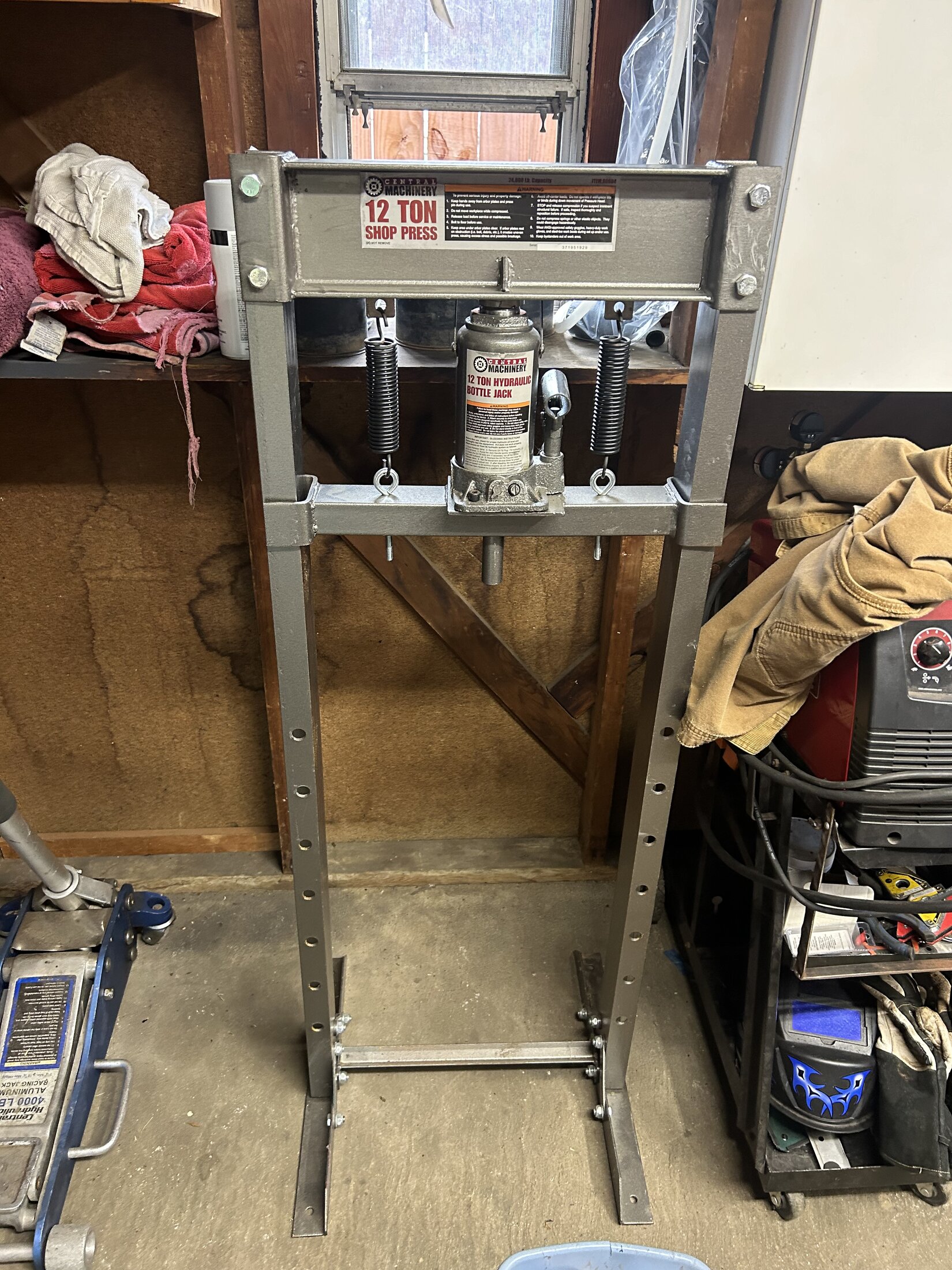

I know some people have them but I "needed" one too. Fb find only used once and a full driver set too
