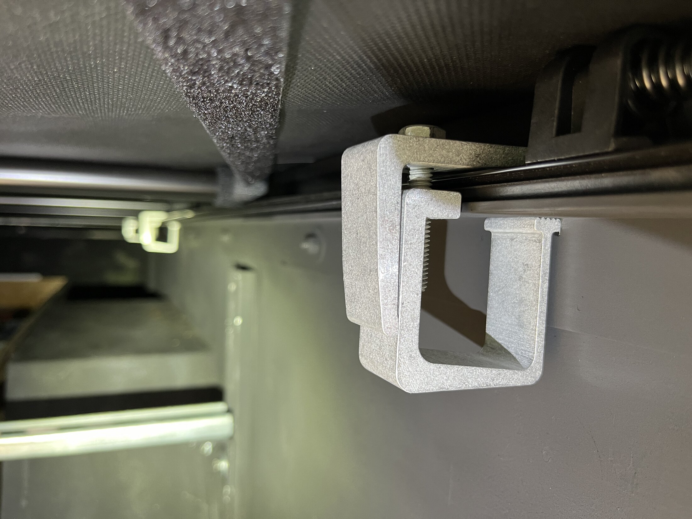

Near perfect fit but had to add some angle to the inside to ensure it clamped down properly. I did have to shift it to the rear to make sure it covered the tail gate all the way. Made for a 2020 Ford 150 8' bed

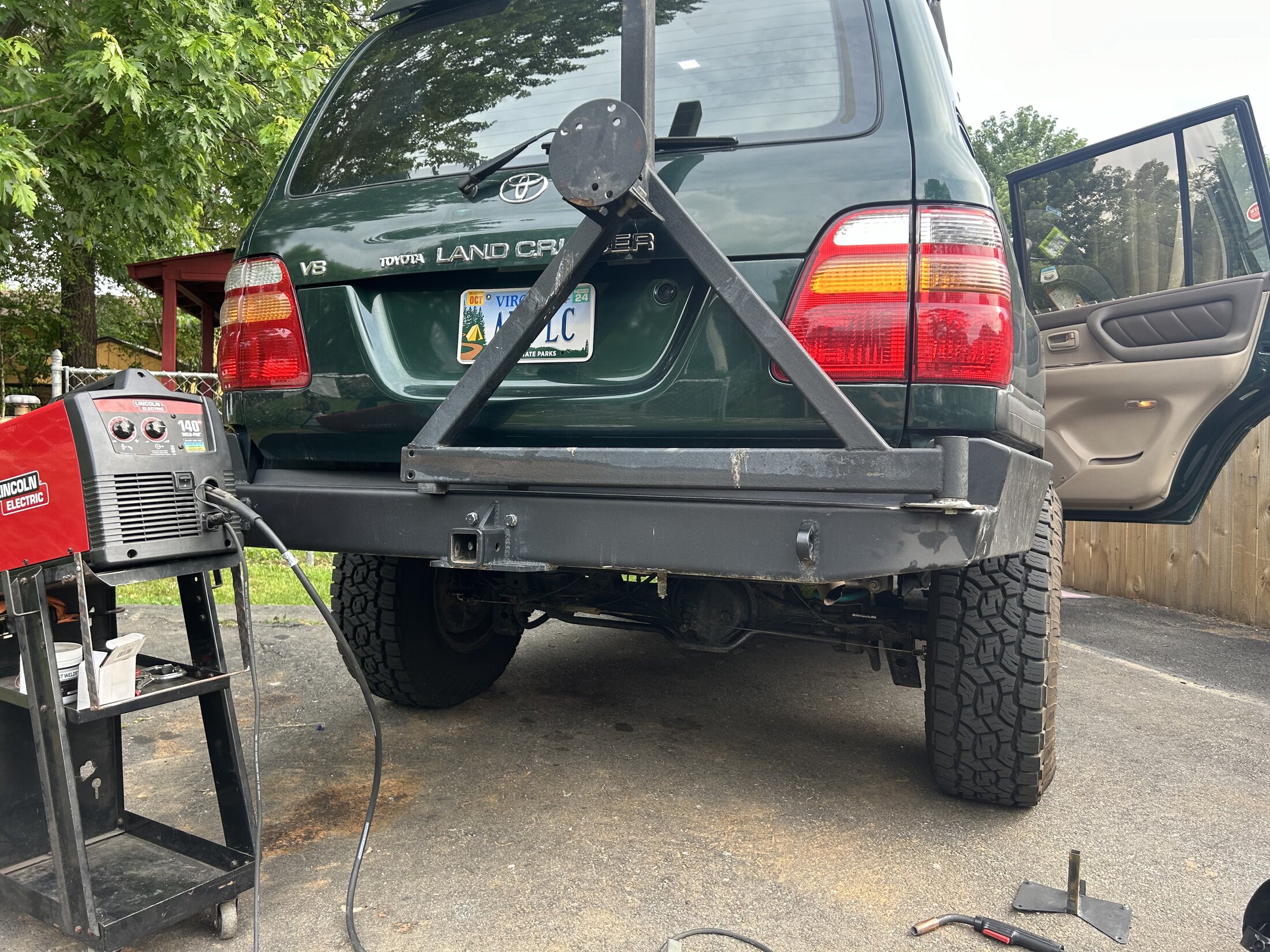

Working on the swing out. Getting closer. Thank you for the advice at the meeting from a couple of you. I opted to use what I have and have a 1.5 shear ;) drilled a tapped an m12 into the spindle from the bottom. Will add some bolts into the bumper for added support and then to figure out the latch. I have some ideas but still figuring it out.

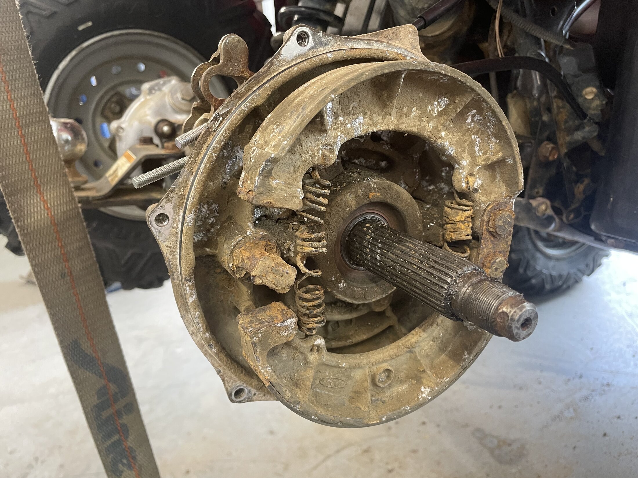

Did some pm on my 4wheeler. Front brake pads, tie rods, spark plug and oil oil filter and diff fluids. This thing had been run hard! Should be good to go once I get it back together.

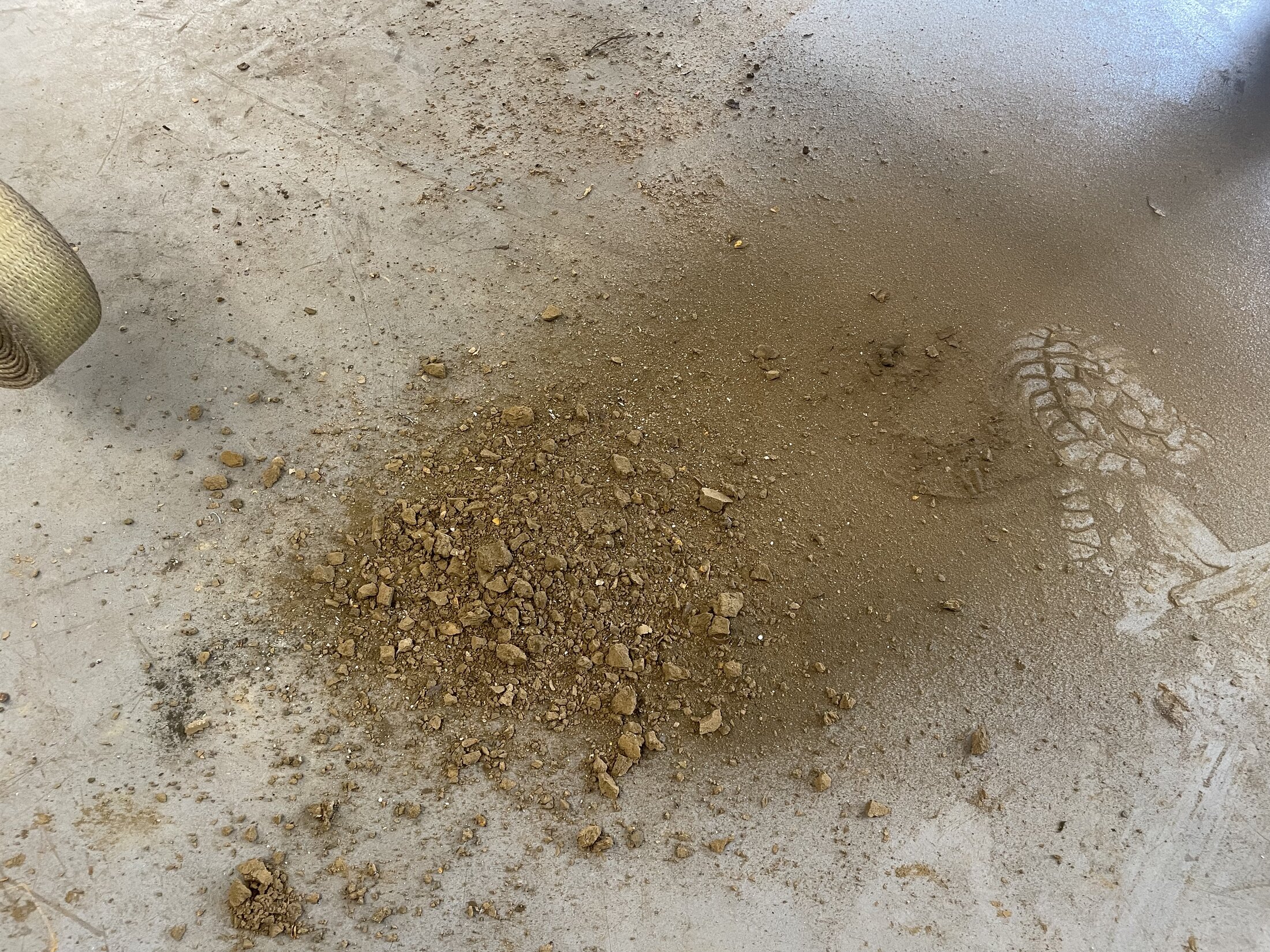

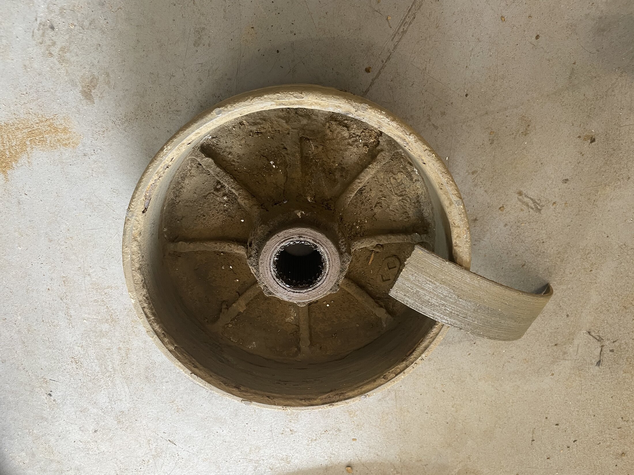

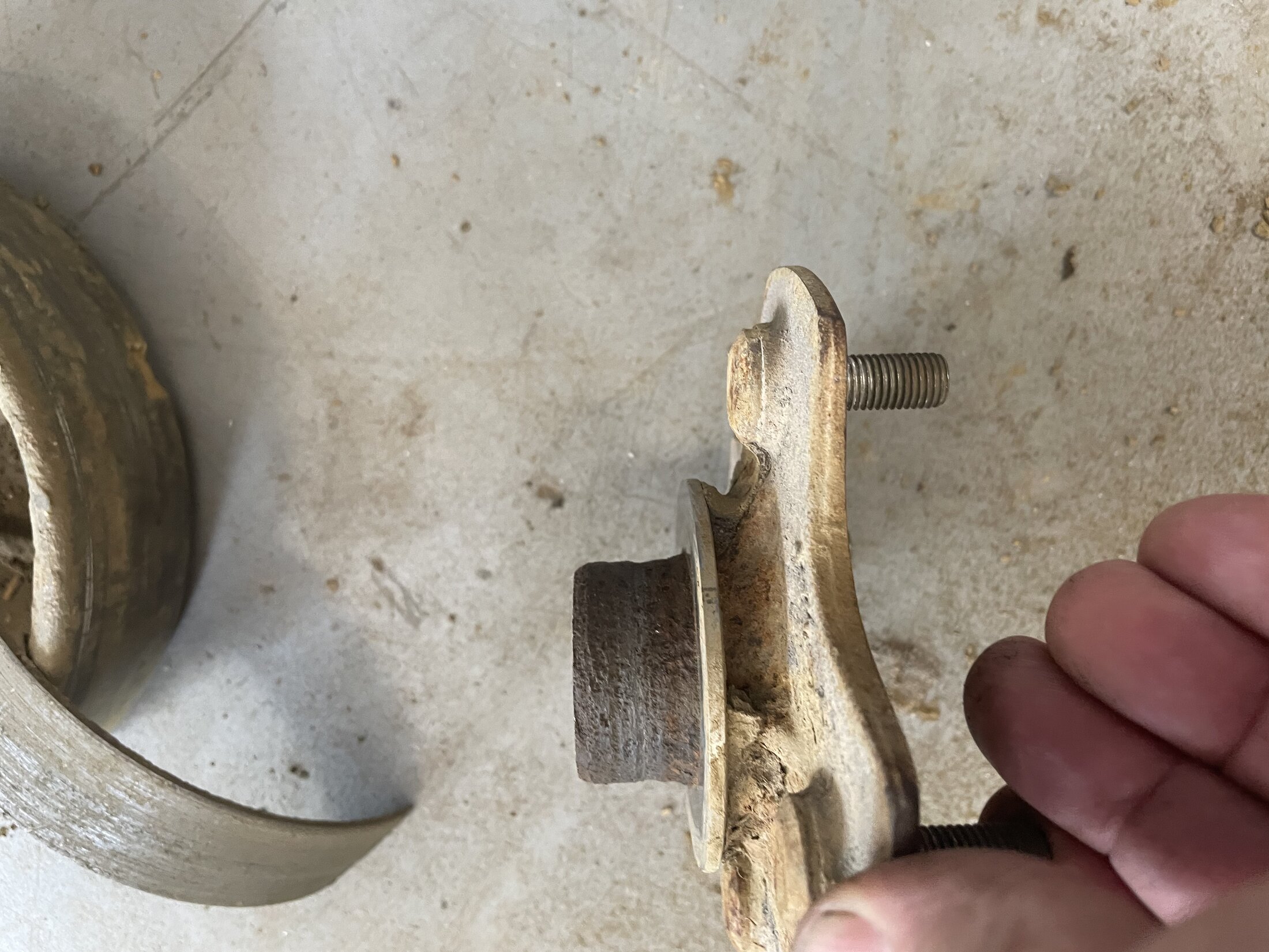

Holy Mother of ...........
Sad thing is the whole housing has an O-ring seal on it and the hub flange has a seal on it. Now sure how all that mud got in there @FamilyCamper ???
Let say I had to get out the torch to get things apart. The mud is baked onto the drum. I am going to let it soak in Kerosene for a day an see if it will come off. Wire brush, wire wheel, sand paper, metal scraper and razor blade could not get it. Drum is $300, so I will find a way to clean it.
new shoes, seals, hub are on the way!
