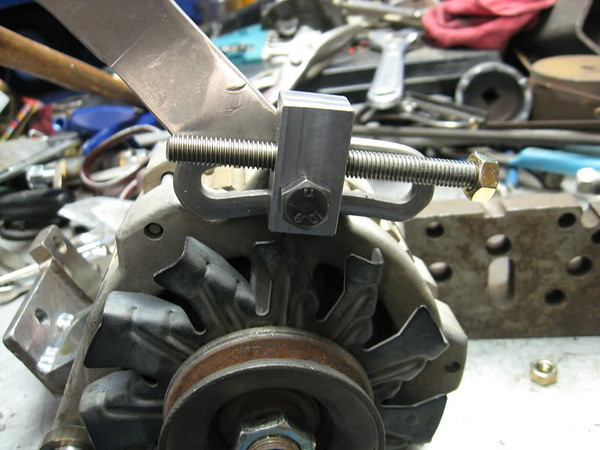

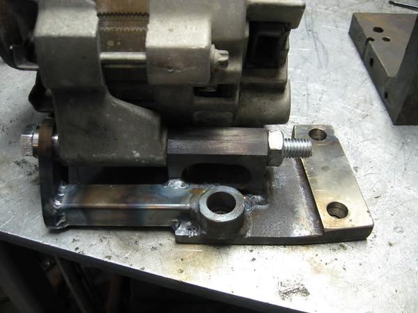

I went with a Delco CS-130, 105 amps dead stock out of the box.
Mocked-up:
[EDIT: Can't find this pic]
Pivot bracket:
Beginnings of the tension bracket:

Ive been running the painless dual kit with dual yellow top's for year's with the 8274 and a 9500hs with no problem's as far as charging.I think the stock unit's last awhile and take some abuse. I checked on the mean green unit's but they were about $600.00. I can go thru a couple stocker's for that.I drug my az about 75' in a pond on my side till I could set up on all four's out of 5' of water then up a 12' bank till this set up finally died.dried every thing out and still going today.. HTH Kenny BTW thank's for the pic's of the set up ntsqd was wondering how hard it would be to do that bracket!

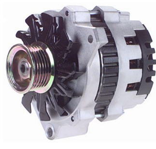

120 amp GM Alternator out of 1989 Caprice Clasic with a blue and white paint job. The red and blue lights had been removed from the roof.
Stay away from some of the smaller bodied high output GM alternators found on Caddies etc.
