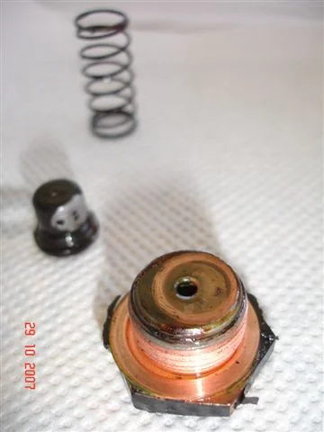

Time and time again I cop the consequences of taking shortcuts but I never seem to learn. I didn't open up those "valve thingies" when I reconditioned this mastercylinder - So now I've had to pull things off again to get at them. (I couldn't get any fluid to come out of the master cylinder at all.)
At least this should silence any debate on the purpose of these "thingies" (- As far as MY mastercylinder is concerned anyway. Perhaps others are different?)
Boy- What a mess I found inside! I expected it to be clean because I have been meticulous with fluid changing and maintenance but they couldn't have been more clogged up with "crud". I seriously think the manufacturer (AISIN) leaves all the debris from their manufacturing work in places like this. It is the only explanation I can think of for what I tend to find!
I used a 27mm socket to undo those big "hex nuts" and it took so much force I was worried about buckling the firewall. Anyway, here's a photo of the m/cyl after I removed the "valve thingies" and spent a lot of time cleaning out the crud-caked holes they sat in:

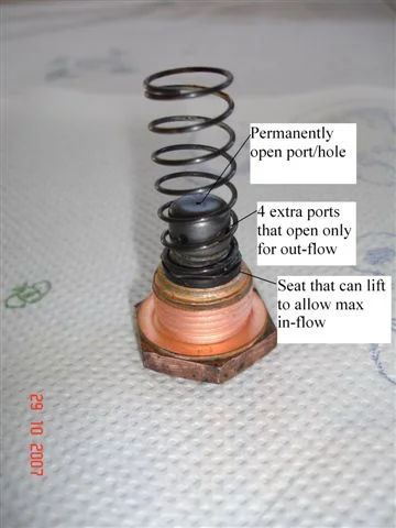

On my "drums-all-round" BJ40, these "valve thingies" are identical for the front and rear brake circuits.
They don't leave any residual pressure permanently in any line because they have one orifice that NEVER CLOSES.
They do however allow 5 times the OUTFLOW compared to INFLOW because of four extra "valved side-ports" that open only for outflow. ------And this provides the safety feature that projekdotnet helped me to understand. (The ability to successfully "pump the brakes" when you have air in the lines.)
I suspect those of us that discard these "valve thingies" are also discarding this valuable safety feature.
There is also a feature that allows unrestricted backflow when the backflow pressure exceeds the spring pressure. I'm not entirely sure why this is present. - Probably to ensure the "valved side-ports" don't get damaged - ----Say, -when you force a wheel cylinder piston back in with a G-clamp as I sometimes do when fitting new linings.
Anyway here is what each "valve thingie" actually looks like on my m/cylinder.

But the fact that these "thingies" CAN'T leave any permanent pressure at all in a brake line contradicts what you are saying.
I thought the photos would prove that they can't leave LASTING residual pressure?
All I can think of to explain what you and others are saying is that the "valve thingies" you are removing are entirely different to mine ---and that they can somehow be selected to leave differing amounts of PERMANENT residual pressure (like 1psi, 2psi etc)

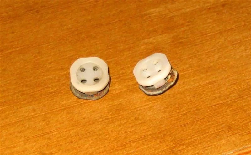

that is what our U.S. 1975ish with 4 wheel drum brakes ,residual valves also look like:grinpimp:
Thanks pbgbottle. Well they certainly look identical to what I found!

This being true, what I have on my ORIGINAL Aisin mastercylinder (the one the vehicle left the factory with) are not "Residual Pressure Valves" at all.
if you can imagine say a plate blocking a hole and having a spring behind it rated at 10 psi --above 10 psi and the plate is off its seat and allows flow but a below 10 psi the the spring force is greater than the hyd force and closes off the hole leaving 10 psi trapped in the line. These aren't the components exactly but that is the principle.
Thanks bsmith. Can I suggest you take another look at my photos though. (Of the "valve thingie").
The hole in the centre of the cup is OPEN ALL THE TIME. Nothing EVER moves to block it. This hole makes it IMPOSSIBLE for any residual pressure to be left in my brake lines (other than from the weight of the fluid itself) - provided no-one is touching the brake pedal of course.
Edit Nov 09 - Since this thread was posted - my understanding has changed. I now believe these "residual valves" are fitted to maintain a slight positive pressure in the brake lines BUT ONLY WHILE THE WHEEL-CYLINDER-PISTONS ARE RETURNING TO THEIR NORMAL POSTIONS AFTER A "BRAKE APPLICATION". I think this is done to keep pressure on the lips of the seals to help avoid fluid leakage. (Not so important on disc callipers because their pistons move far less.)
