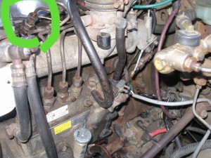

Bleeding the 3b injection pump.
To bleed the air out of the injection system Crack the bleeder screw (circled in yellow) then untwist the pump (circled in red) till it springs up and pump till no more air comes out. Push the pump down and twist closed before closing the bleeder screw. Try that if it's still having problems you are going to have to crack the injector line top nuts all four (circled in green). crank the motor till diesel spills out of all of them, shouldent take long.
