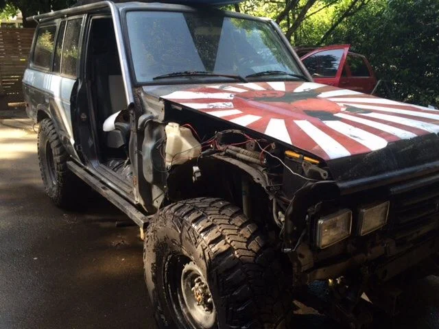

So can wee see this exo cage?
Still fine tuning some things... Ok, I'm lazy.

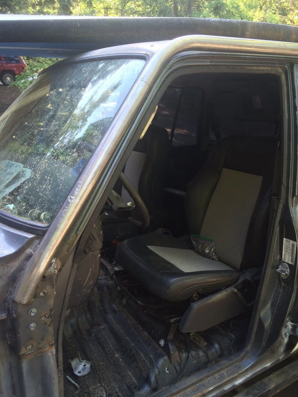

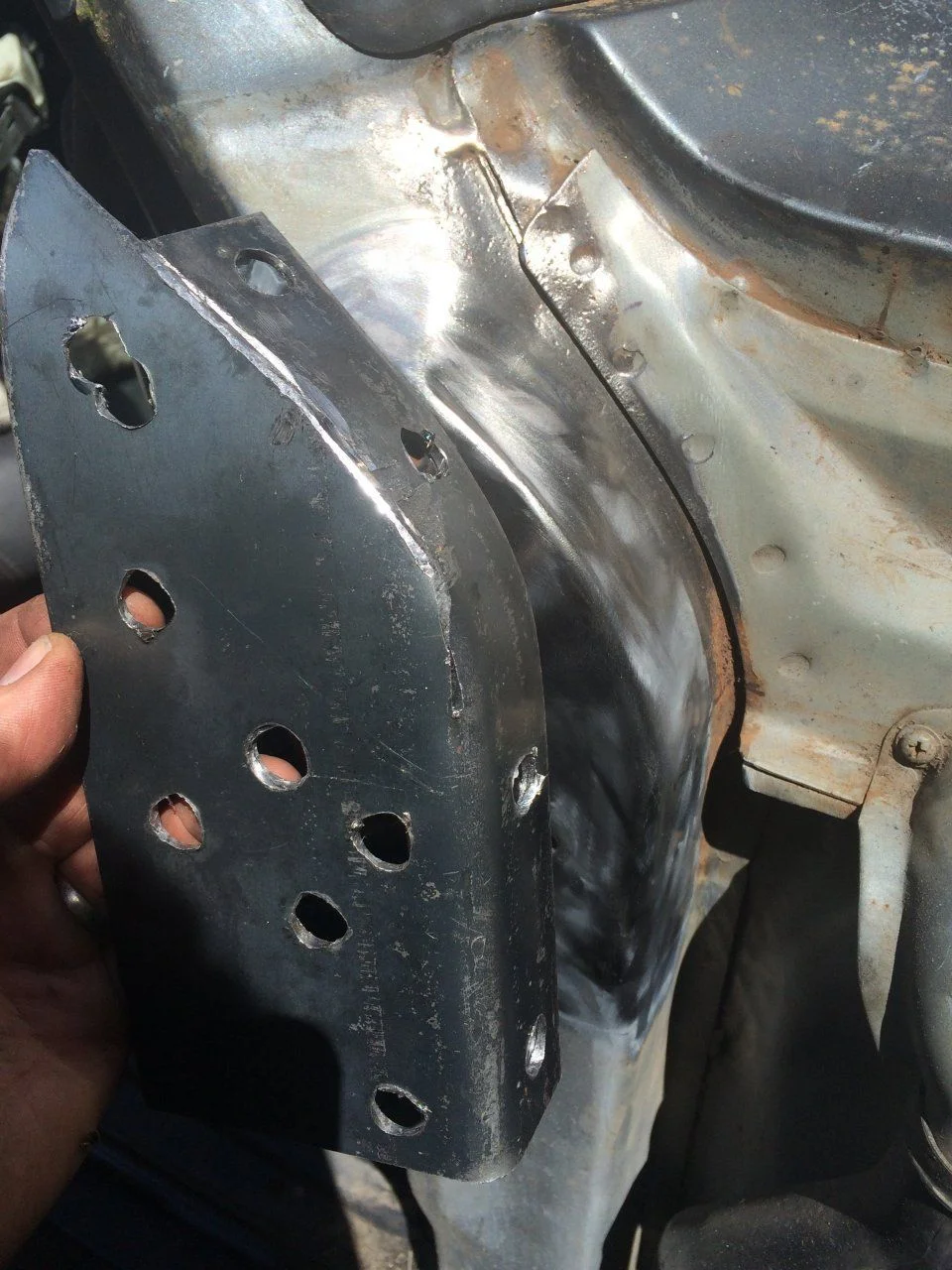

Really all I got, spent all my time making these brackets to tie it into the cowl/A-pillar. Whole thing will be body mounted, no frame tie in. An exo lid and interior cage hybrid so I can get some cross bracing and not look like a jungle gym. I still wanted exposed roof bars for sliders and roof rackish.

Why no frame tie in?
Welp... from what I've gathered people suffer serious vibrations by tying the body to the frame rigidly without rubber gaskets like the body mounts and I'd rather have the cage firmly integrated with the body than the frame in case they separated, keeping me and the fam safe.

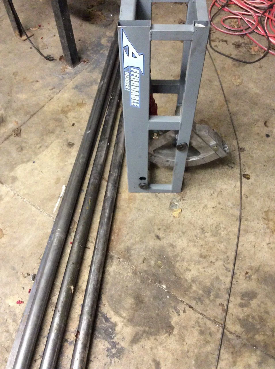

Got the top bar for the windshield bent (4 bends) but ran out of time to get the ends notched.

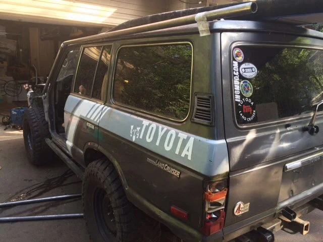

I'm going to pull in the rear portion tight to the roof line but need the lateral bracing first, goal is to keep all the tube about .5" off the body.
So, was this for "tree sliders"? Or just more protection for the family?
Cool, I'm not a big fan of exo cages, but there are not trees here.

Yeah I'm not a fan either, what you see already will be the only exposed portion except for roof bracing. The uprights and X bracing will all be in cab.
I wanted the tree sliders as we wheels TSF and its all trees plus I got rid of my roof rack in prep for the toobage which I can also mount and lash stuff to.
