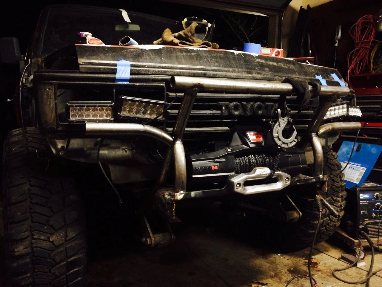

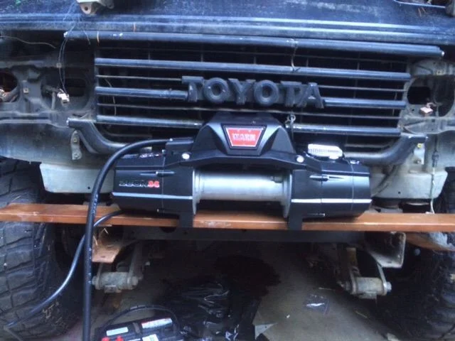

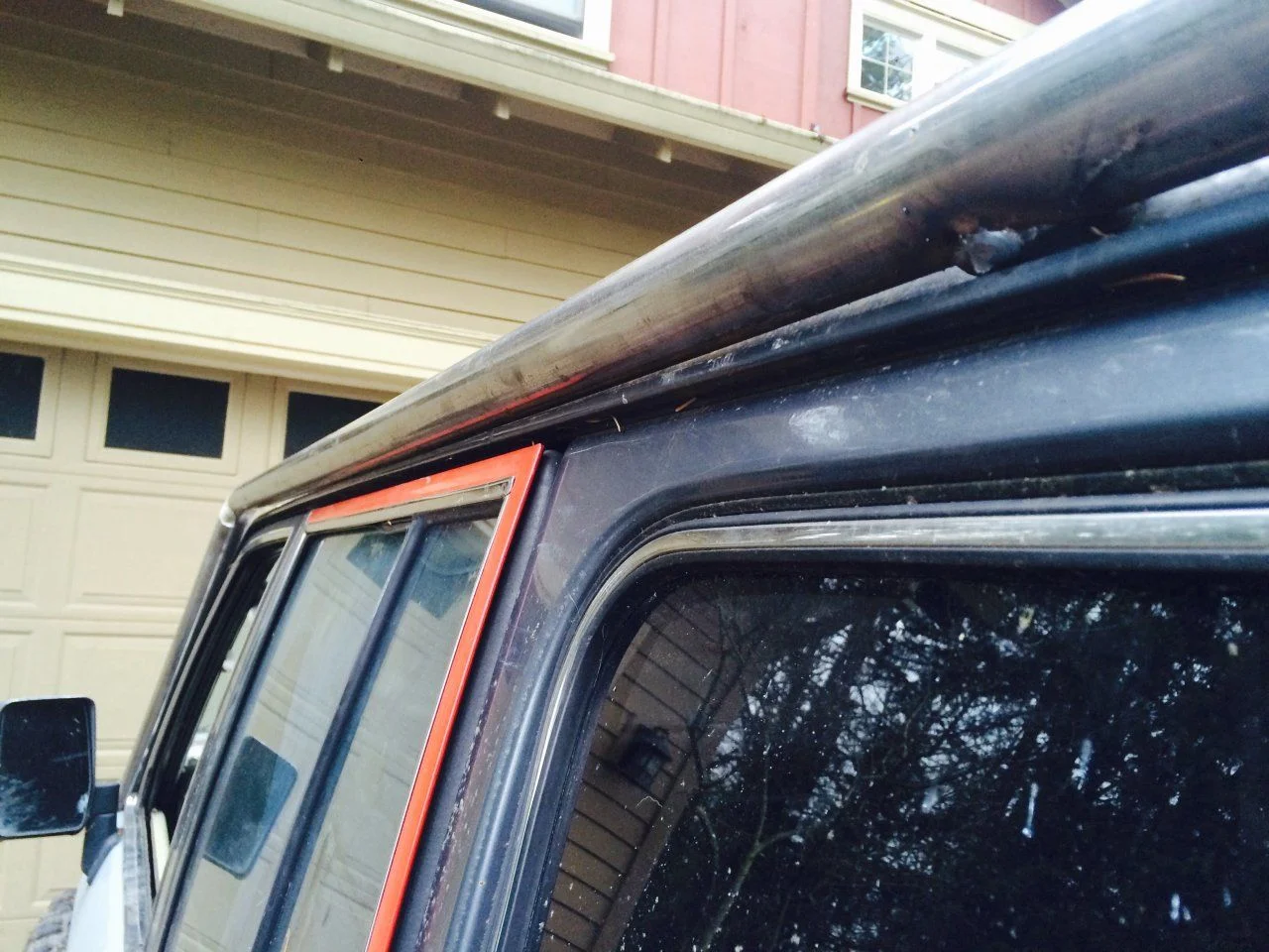

Bought a nicer winch (excuse the mockup pic), also found a pic I giggled at which was the night before Rubithon 2014 got the fxxxer back in there by 5 AM the morning of.

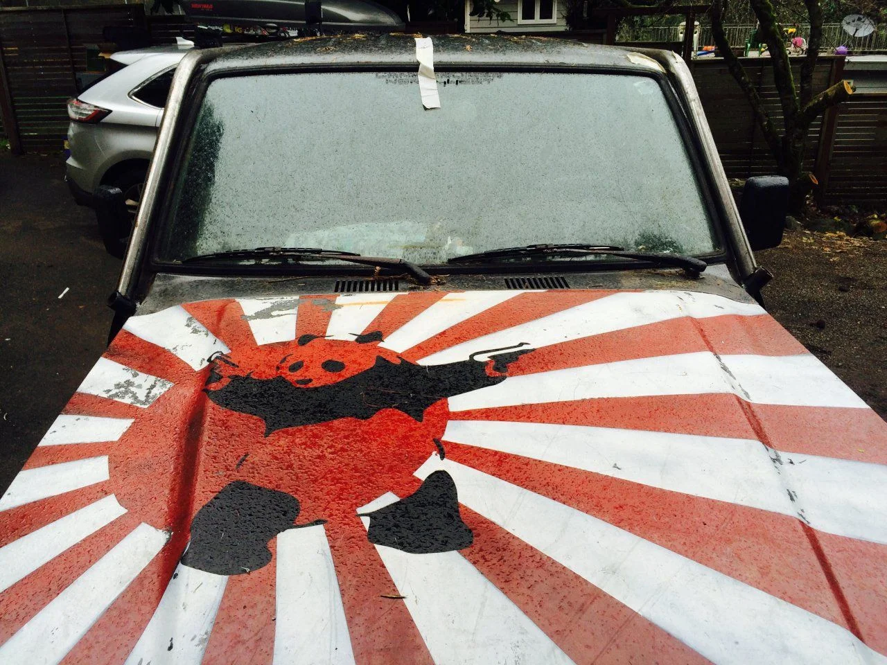

This probably also belongs here. Buddy and I built a truck for a local cheap car rally last summer, Gambler 500. Rig was bought for $600 with 300k miles on it, we got a little carried away with the paint but came in first out of a 31 car field.
That's bad ass..
