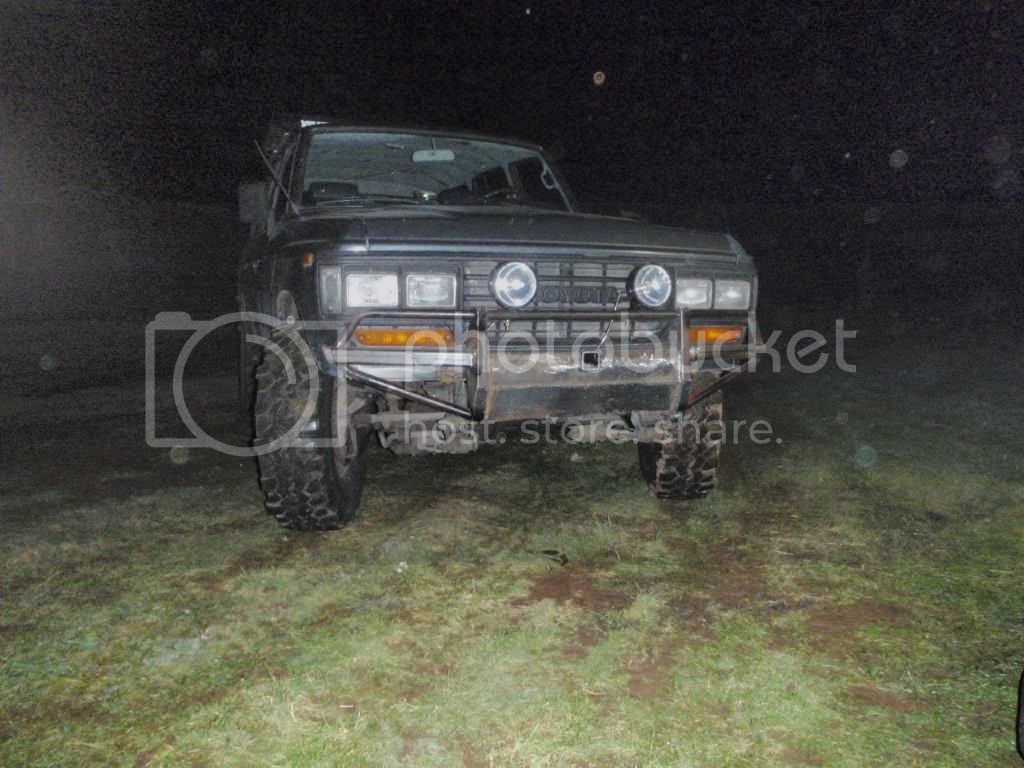

I'd love some feedback on the bumper, it's something I'd been mulling over for a while, the round tube is only tacked on now so I could change it if I wanted. The main frame is 2x4 1/8 wall end to end. Rotted muffler replaced with single glasspack and turndown, sounds pretty good for 30 bucks.

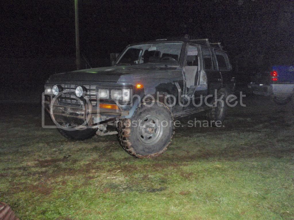

Is that thing on fire in the 4th pic? ;)
No it was cold out and it's my breath, I thought it was a cool effect. Scary.

I like the bumper, it fits with the battle wagon theme. The picture with the fog looks like WWF wrestler could be driving into an arena or something.

Hell of a truck :cheers:, love the look of the bumper, I've been looking for a bad-ass looking bumper like that for a while, still havnt found the right one, only thing I wouldnt change on your, is just make it bigger and beefier. If that makes sense, more plate,tube ect.

as far as the bumper goes, I wanted something high clearance and not toooo bulky, I think I accomplished it.
