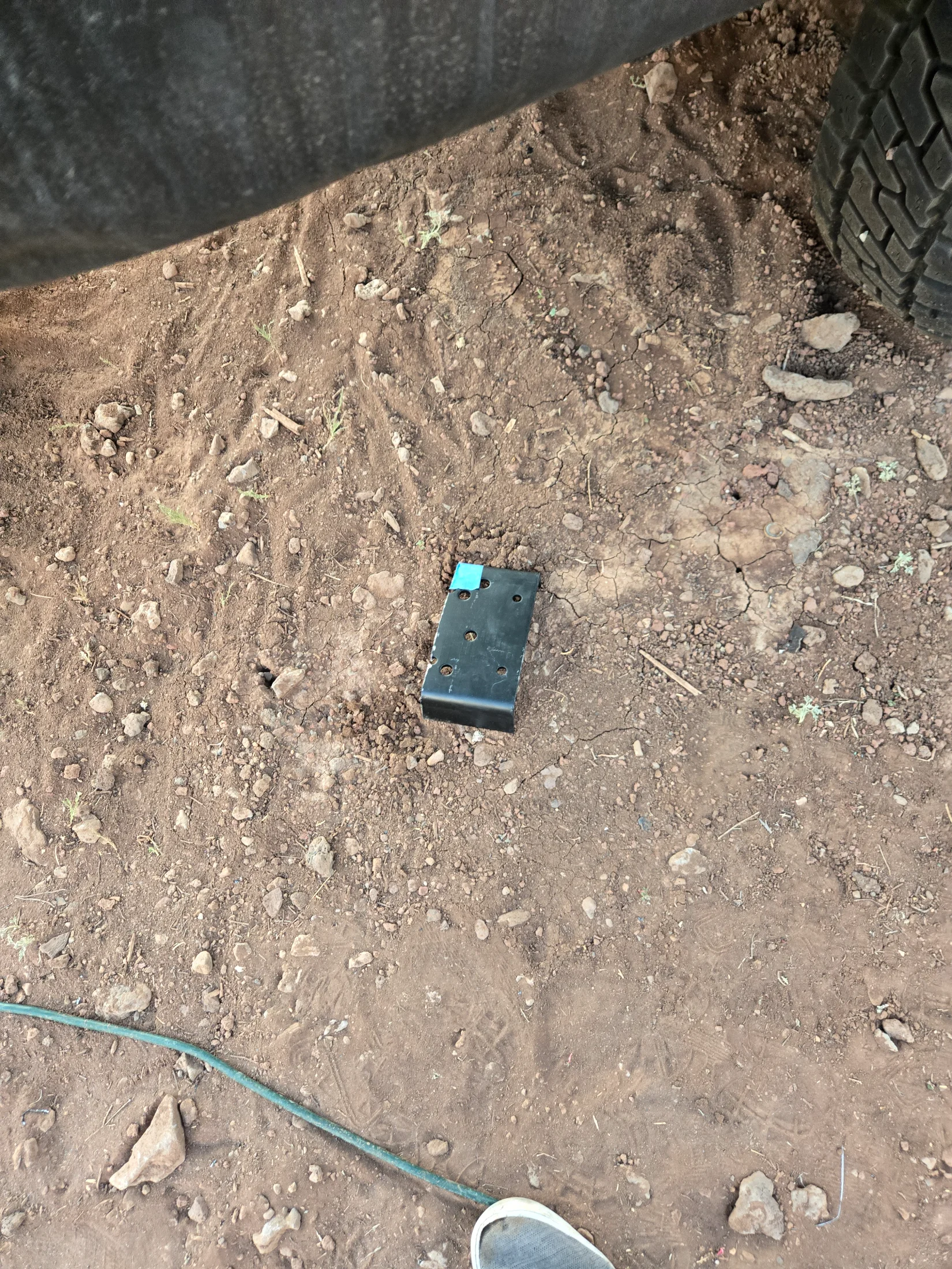

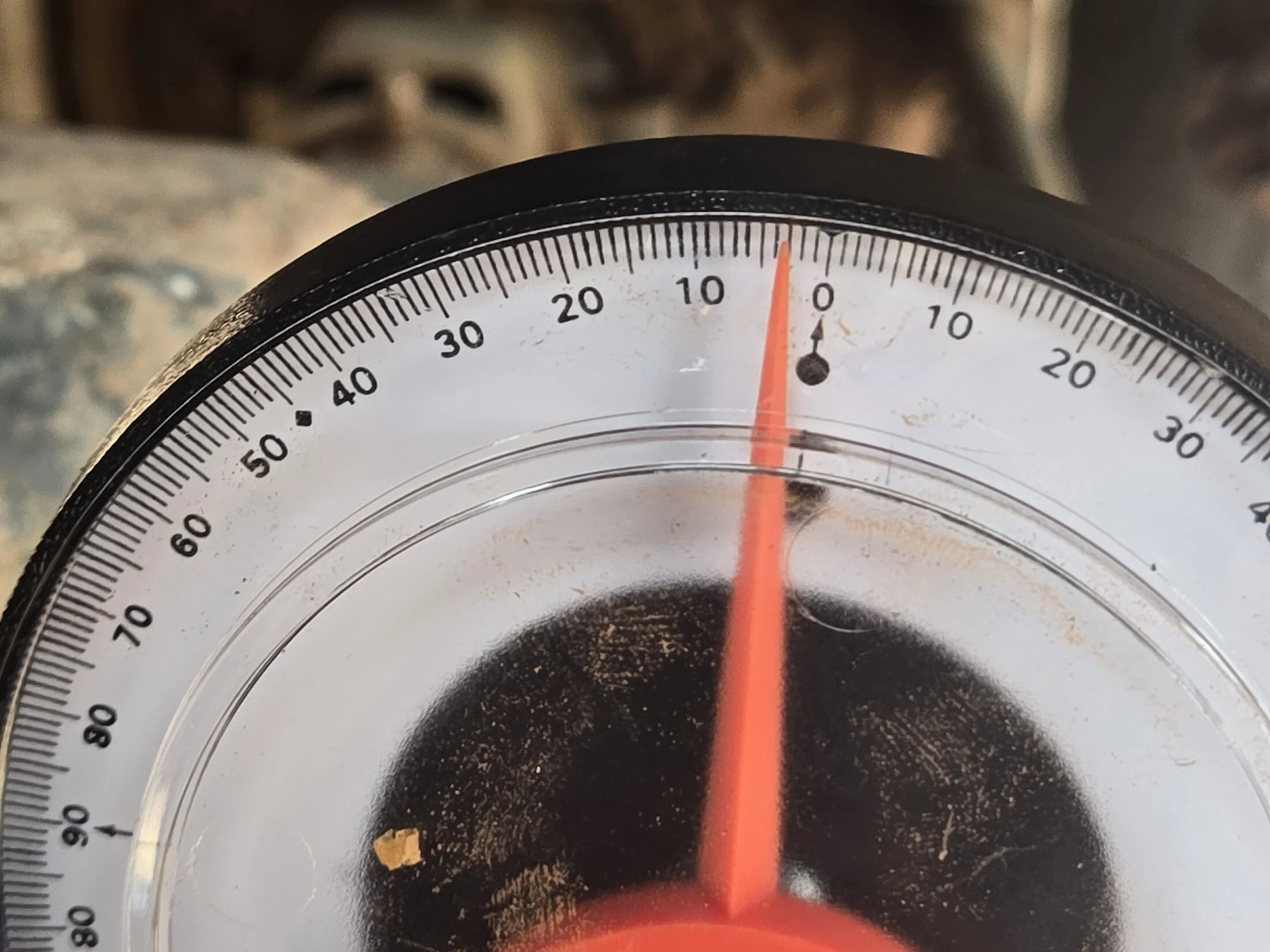

I did a bunch more beveling on the caster plate and got it to sit nice. I can still rotate it anywhere on the axle, but I have it to where the pinion is only going to tilt up a tiny bit. I hate that I am putting so much effort into this lol the last 50 SOAs I did we just cut the perches off, welded the perch I cut off on the opposite side and used the ubolts to locate it and wham bam send it.
Id say that 3 degrees positive is good for 35s no?

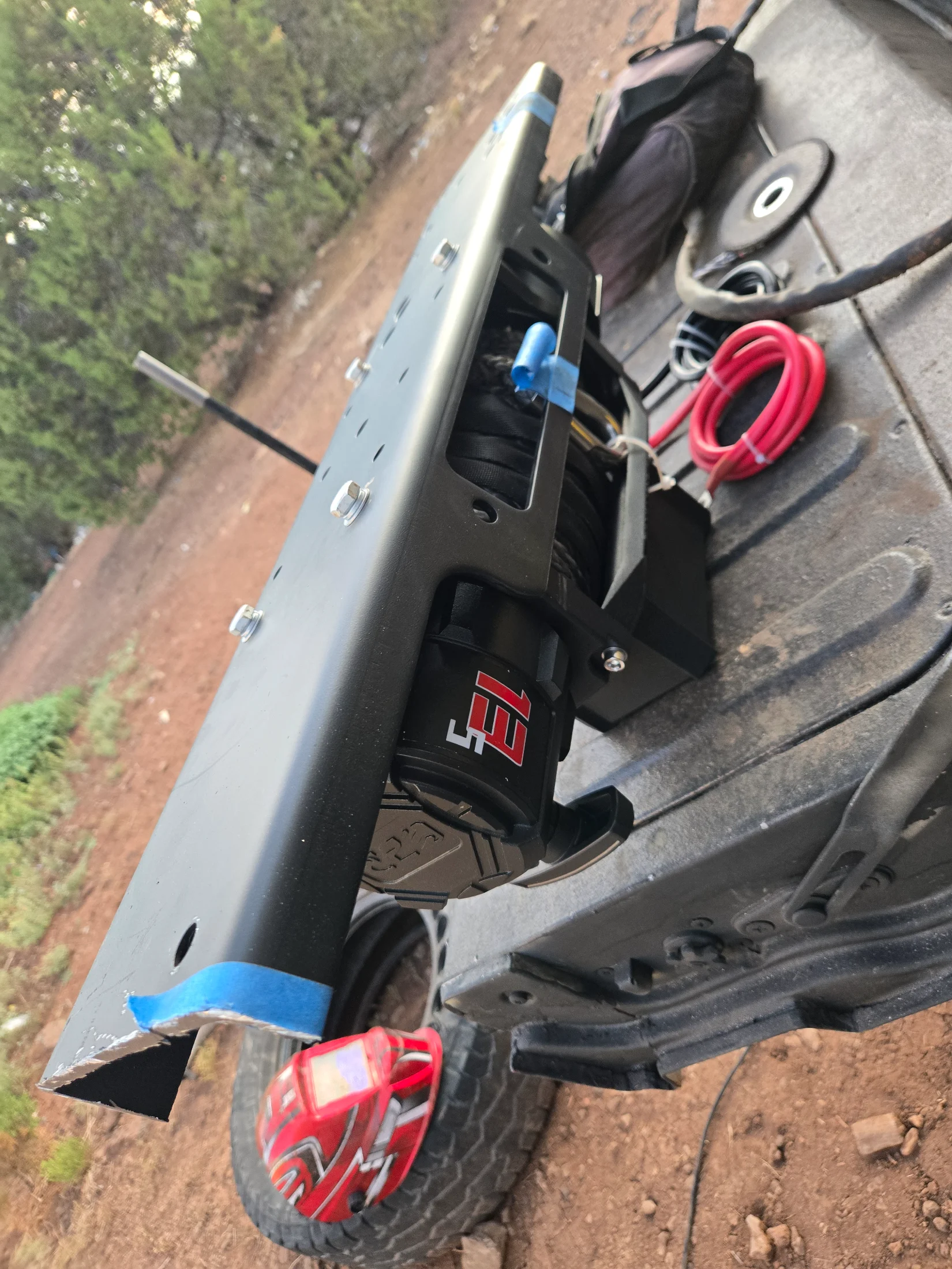

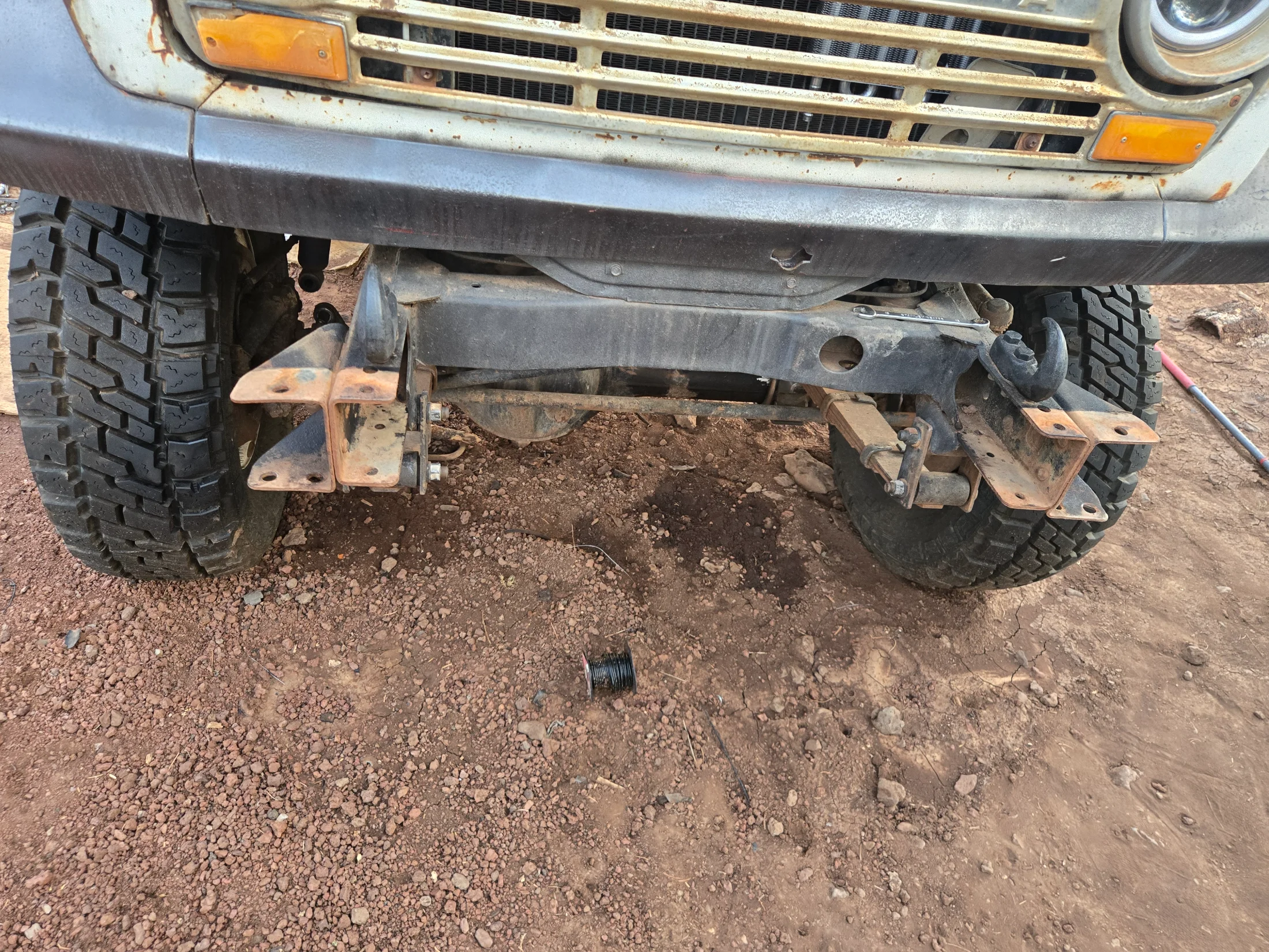

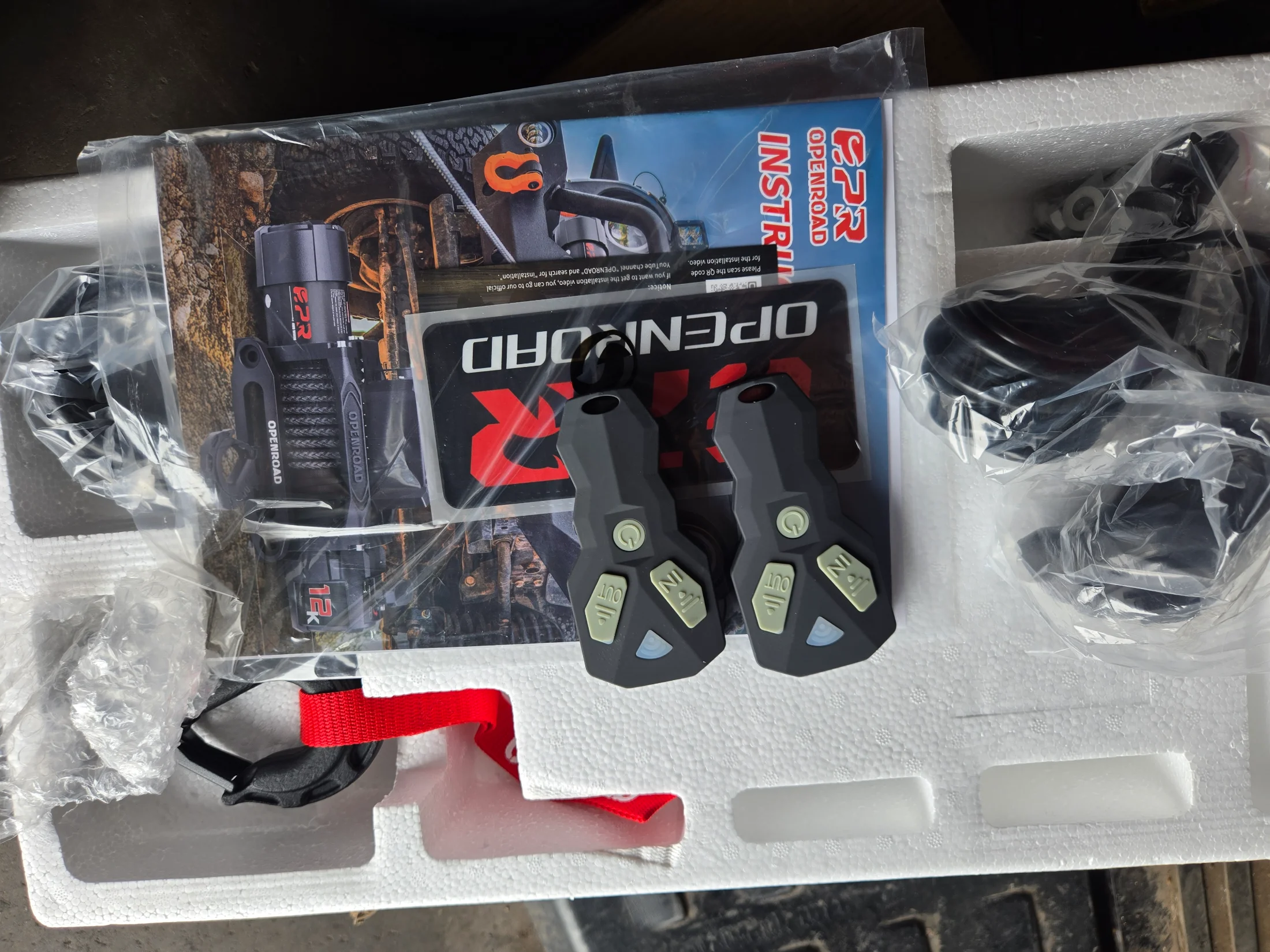

Passenger front corner is done. its tacked. and this is closer to 5.5" of lift rather than 4" but I assume its going to settle a bit. not sure because the leaf is flat, and the shackle is at a prime angle. Unforseen issues are brake lines not long enough, need to find those but all the ones I see say "does not fit 2 line wheel cylinder system" and mine is. Shocks also at full extension are about 1.5" too short to reach (story of my life...) So I have to find the correct ones. high steer kit is in the works as well. I bought a winch plate to mount the winch as well so when that comes I can do that.
Factory pad is 1" +/- below the 3" tube on top of the spring, new pad is 1"+/- on top of 3" tube below the spring.
1"+1"+1.5"+ spring pack height" = your lift" I don't believe you'll get to 4" without a spring change.
3 corners are done. Rear sway bar? Useless. Now to plan where the rear shocks will go lol my uncle is an engineer and he came over and said I can use his shop to put some fat solid welds on this when om done tacking it up so ill drag it to his place and weld it solid. I really didnt expect my 31s to look like hotwheels tires but oh well. It could be worse. Lol if someone would buy my stocks i can swap on the new wheels and 35s
