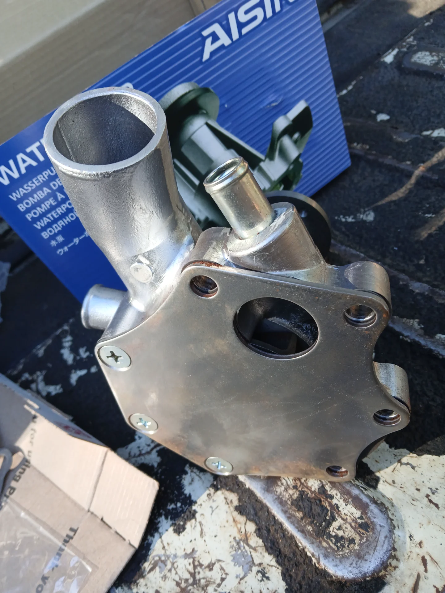

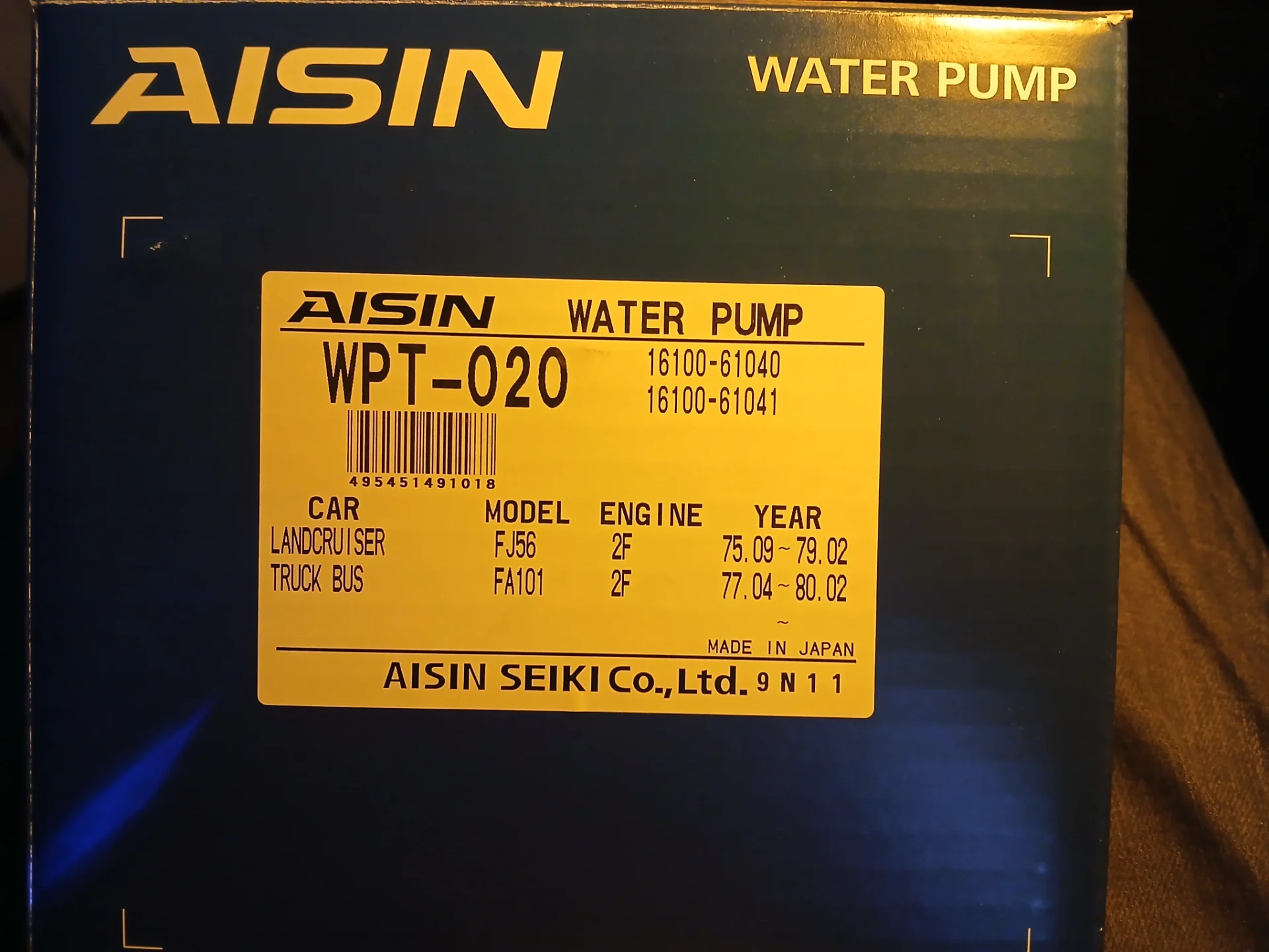

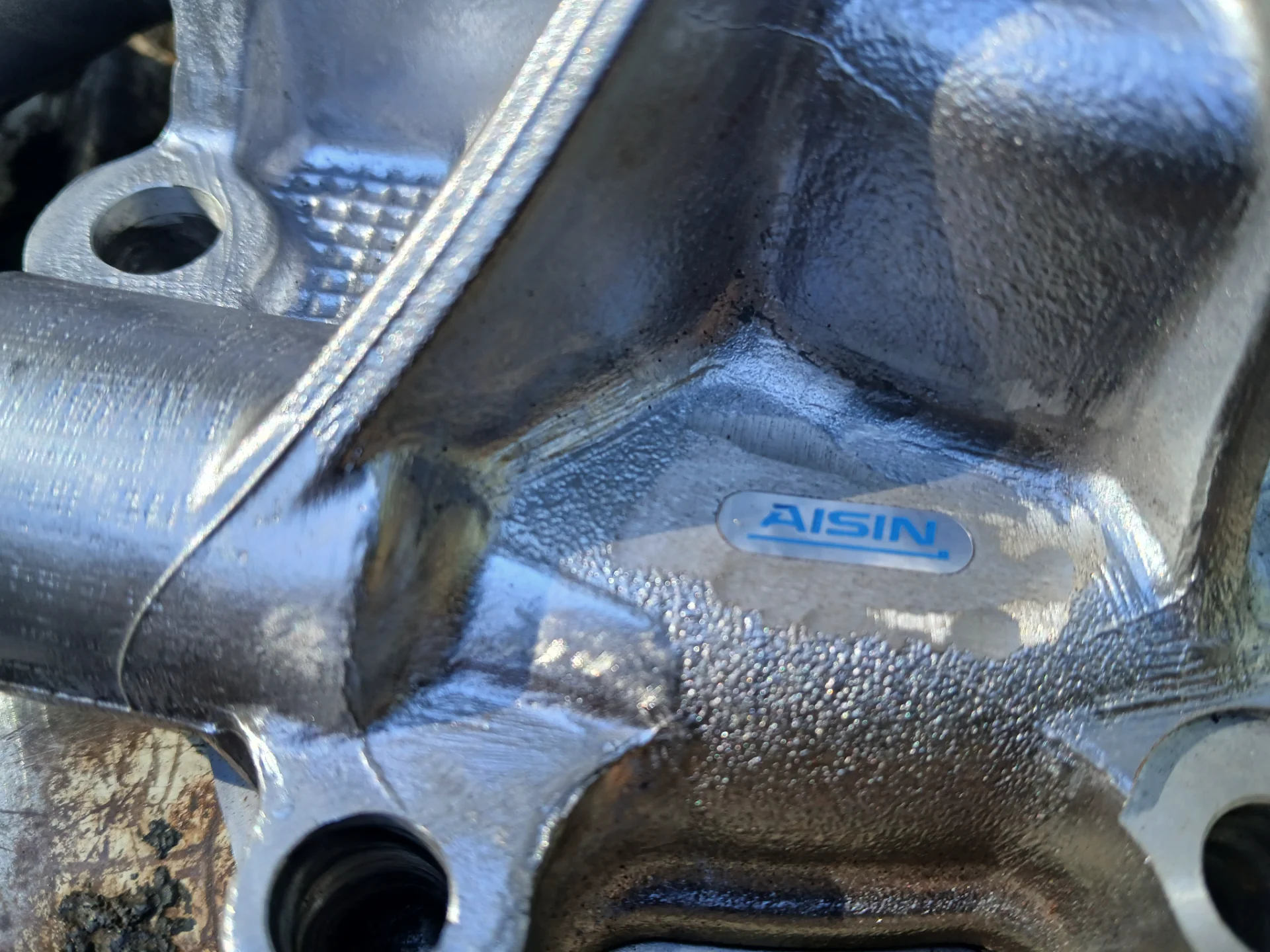

I panic-buyed one too, from CityRacer, listed as with oil cooler/without fan clutch, just the way I like it. Box says all the right things, Sticker (?!) on the pump says Aisin...
