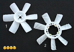

Are you saying that you do not know what a fan clutch is or what it looks like looks like?
with the engine off and cold, can you spin the fan or not? that should determine if you have a fan clutch or not.
Pretty simple to determine if you have clutch fan or not by looking at the fan itself. #1 is non clutch, #2 is a clutch unit and will have a metal device in the center of the fan. For what it's worth, on my 2F I use an early 76 water pump with a non clutch fan. It does not have any oil cooler fittings.
