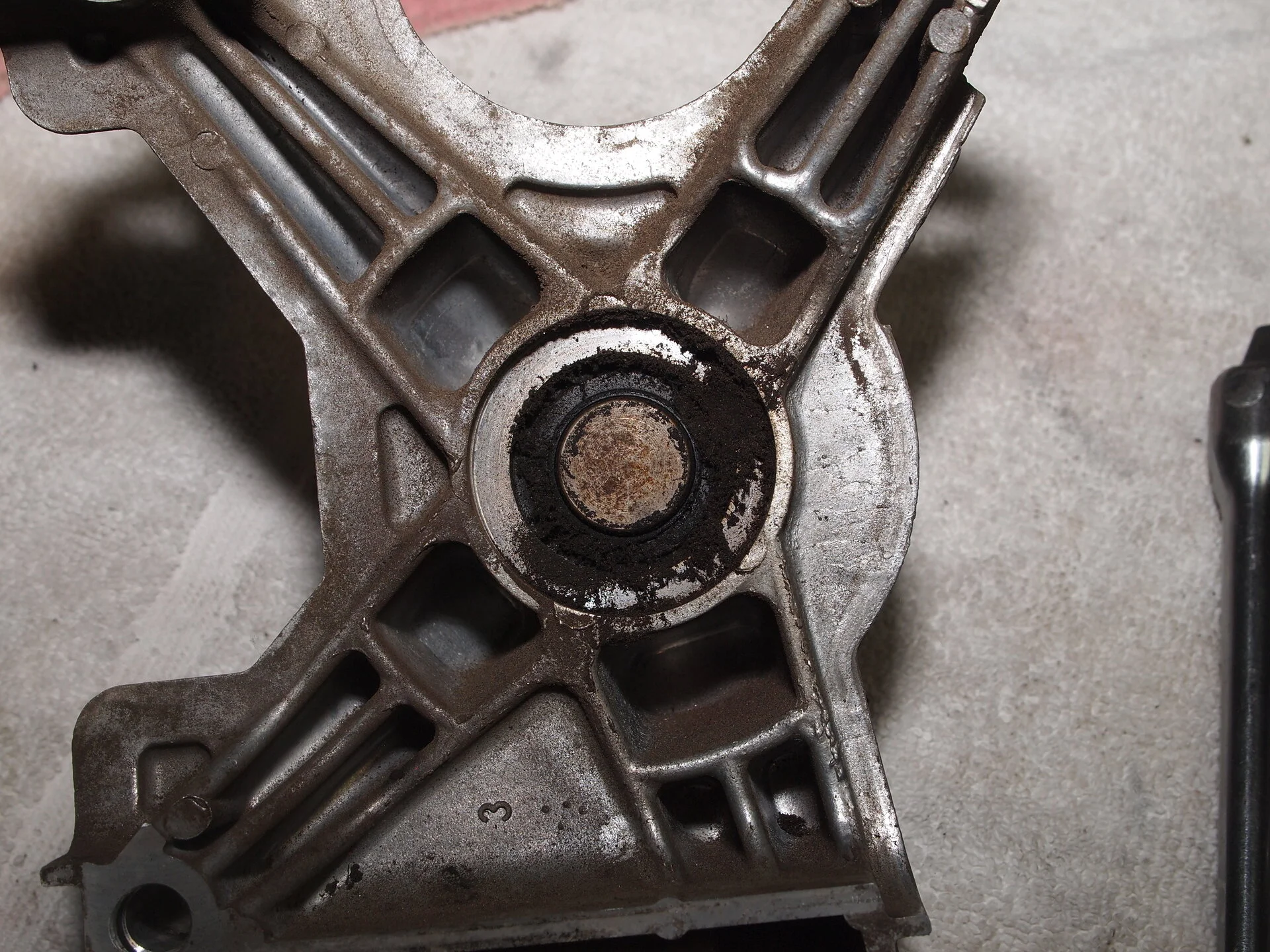

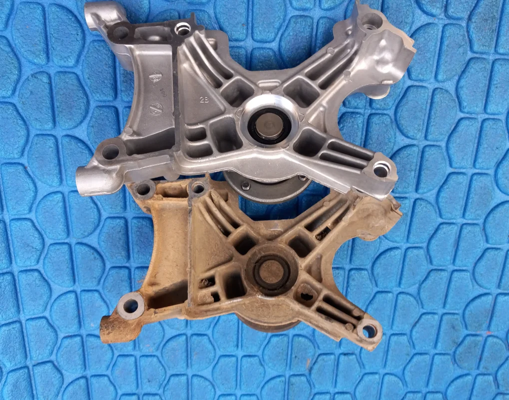

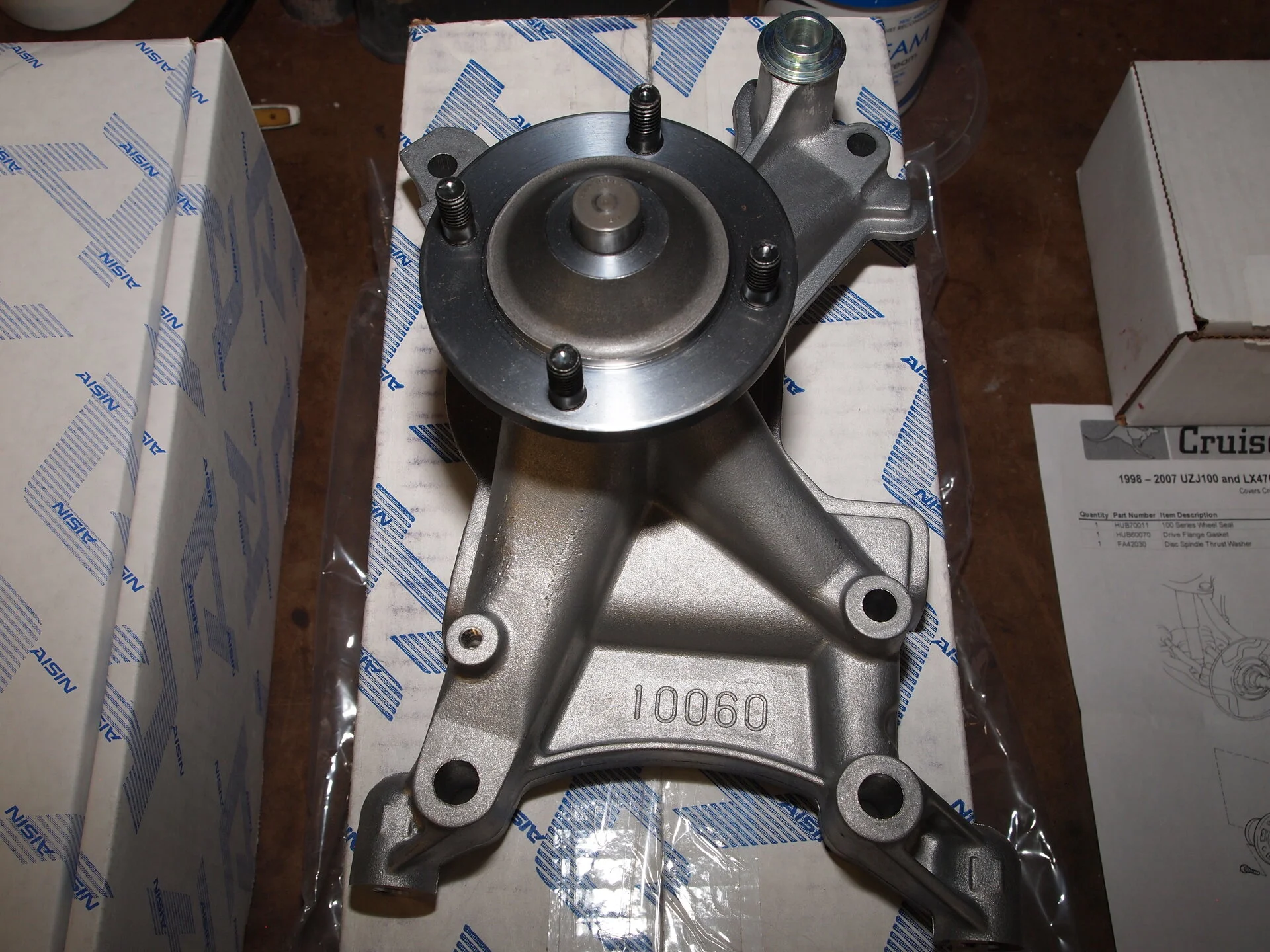

During timing belt service, while fan bracket off the vehicle. I check for sound, play and look for any oil at back seal. Any oil coming from seal, I replace fan bracket. Even if feels and sounds good.

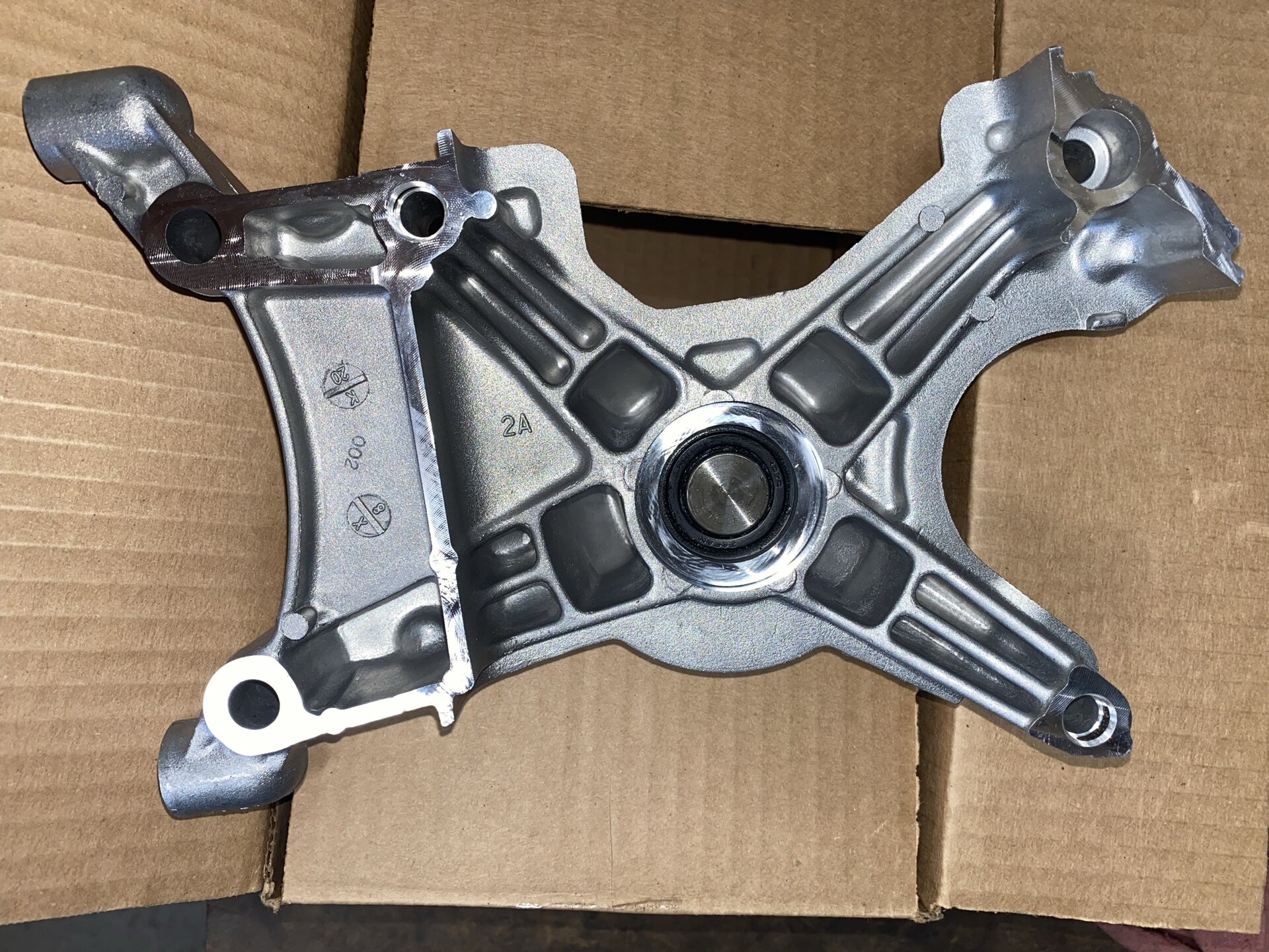

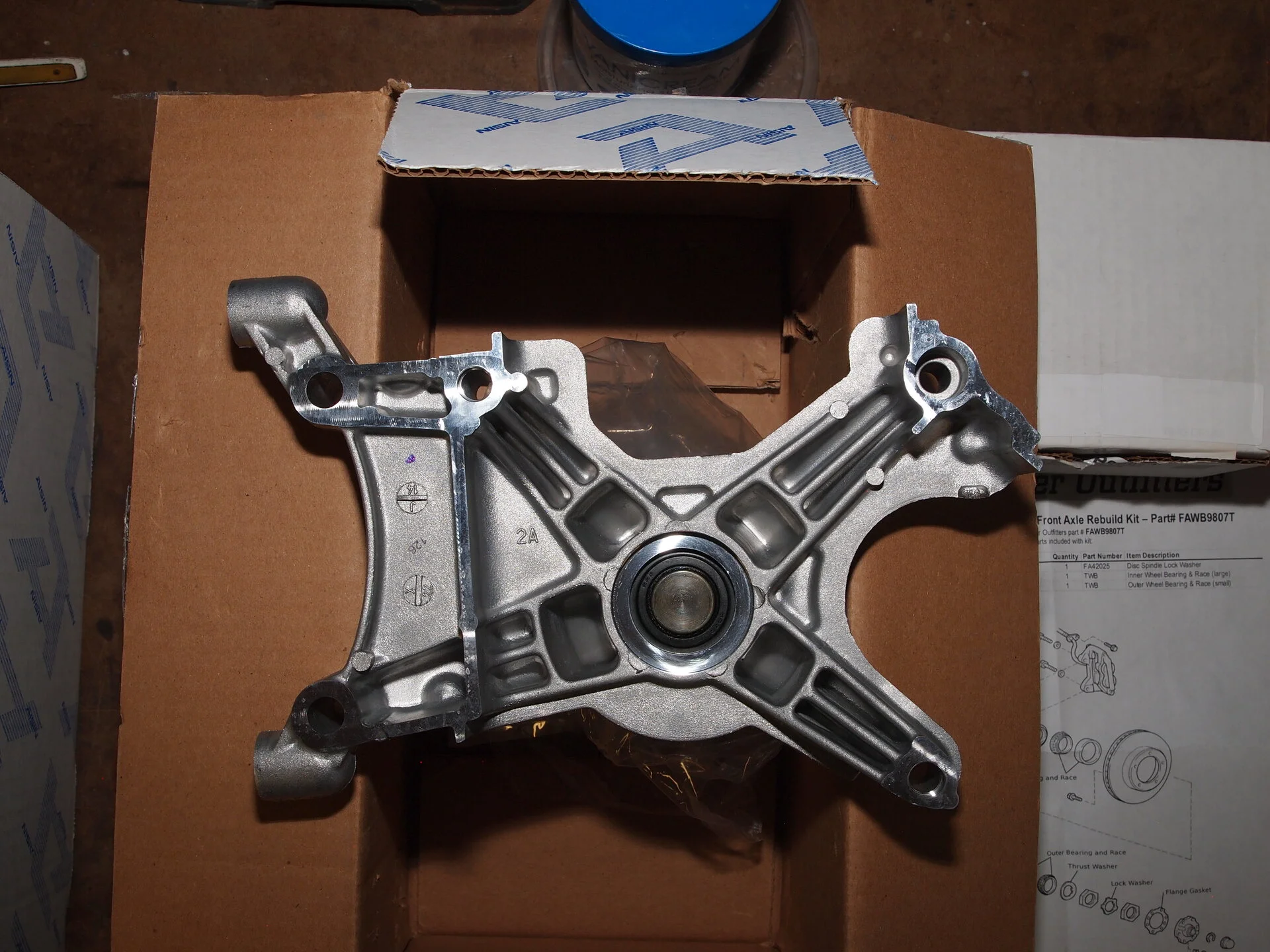

Toyota Aisin fan bracket.
Aisin fan bracket.

I replace, even when oil just beginning to weep from sealed bearing of fan bracket. Dust, sticks to oily surface. Not worth, seeing if can make to next timing belt service. So I replace.

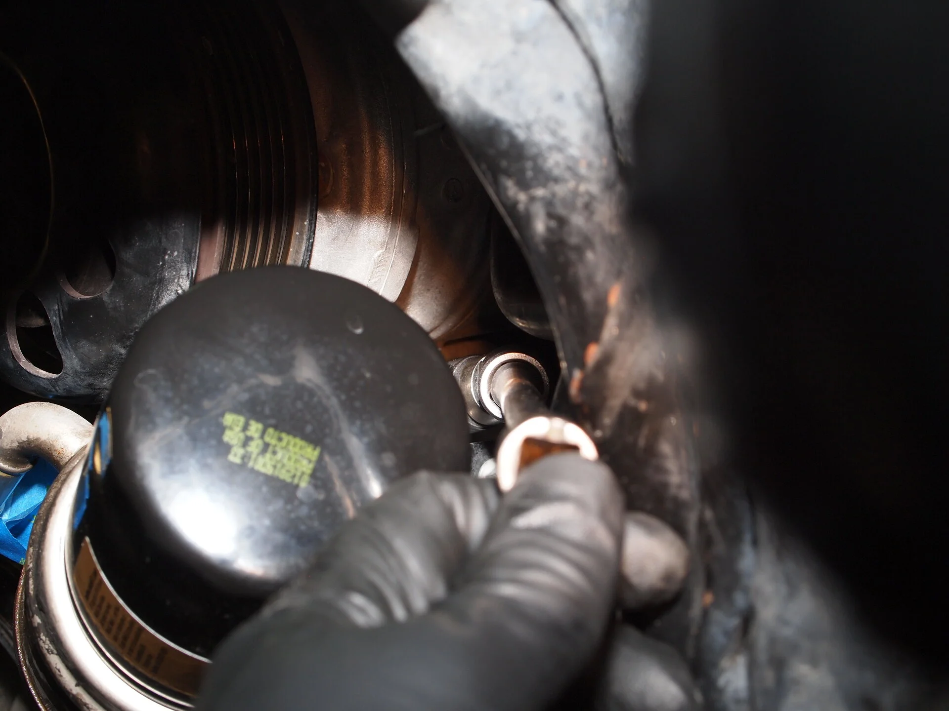

It is possible to replace the fan bracket without removing completely unbolting the AC compressor. Although, the two you do have to remove from the AC compressor are a real pain.
I did have to remove the upper radiator hose (only briefly) to remove the shroud. I was able to replace the fan bracket start to finish in a few hours.

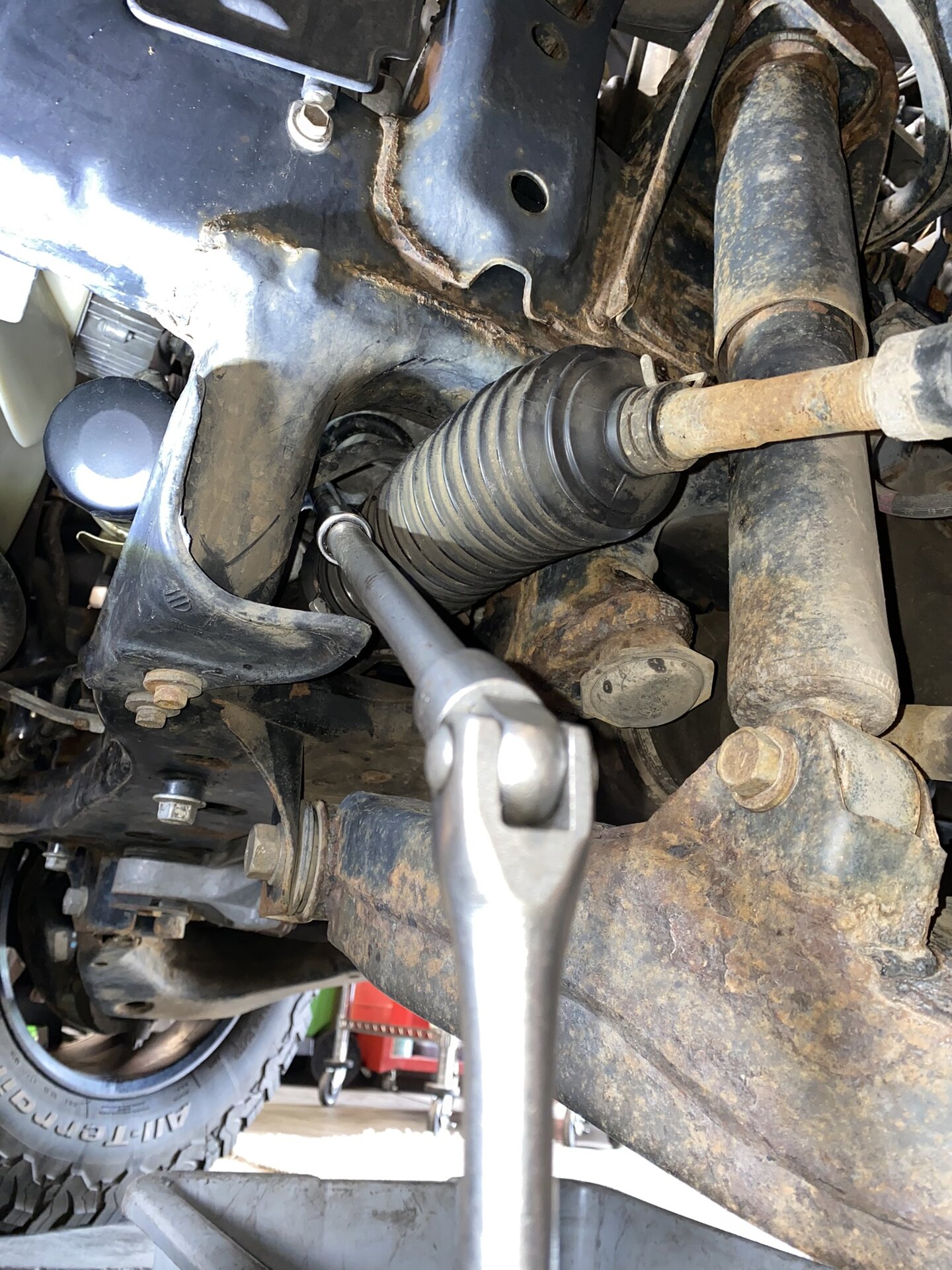

The two front bolts passing through AC compressor, really aren't that bad. If you know the trick.
Top one go at from the top. 3/8" breaker bar with short 14mm socket.
Bottom 14mm socket, universal is helpfully, long 3/8" extension, breaker bar. Come up from below one of two paths. The path between R&P and its fluid lines, is the most direct.

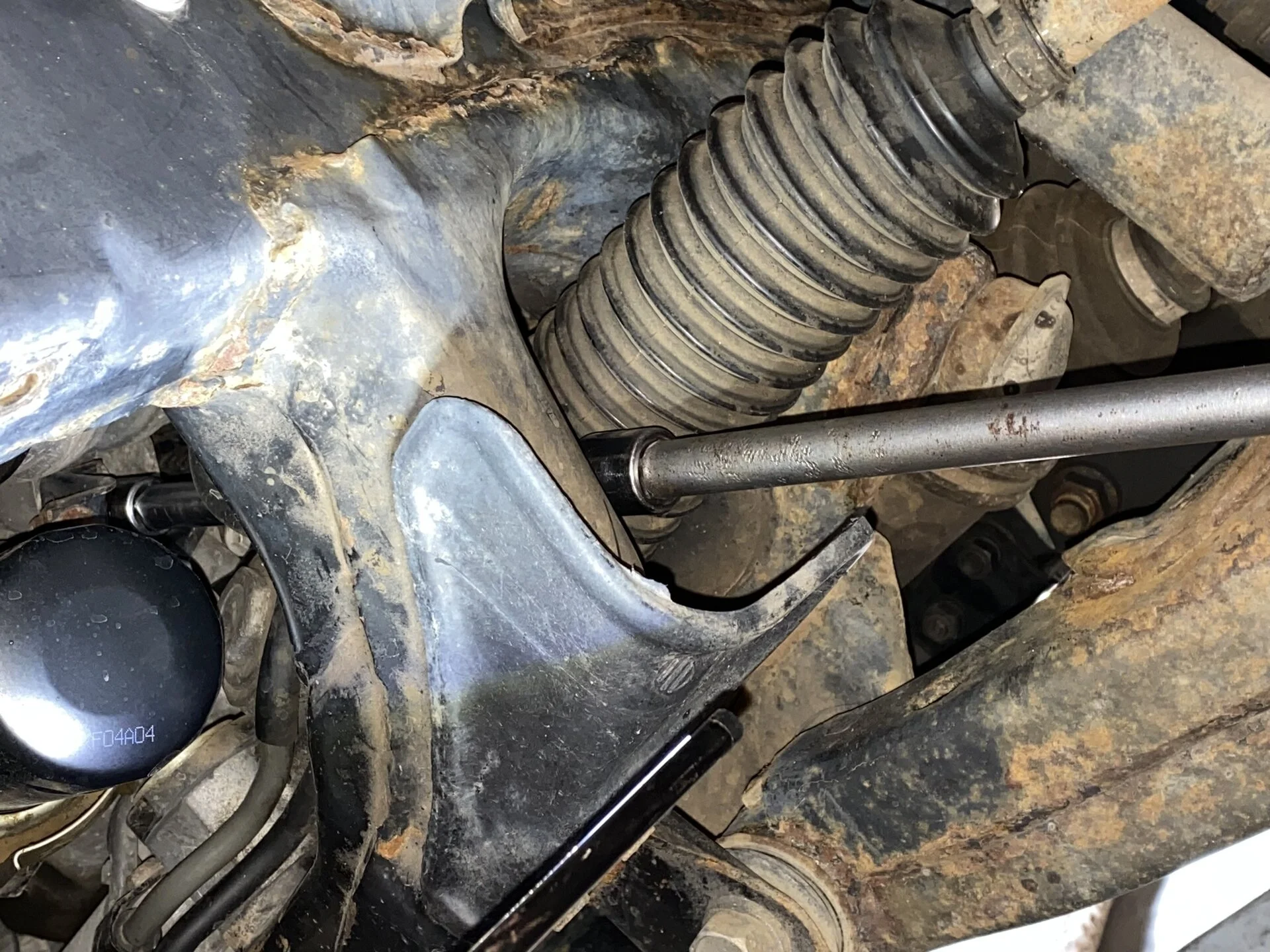

One can come in from, forward of the crossmember. But more angle getting to bolt. Breaking loose and torqueing in, becomes more difficult.

Awesome photo of that angle next to the inner tie-rod!
