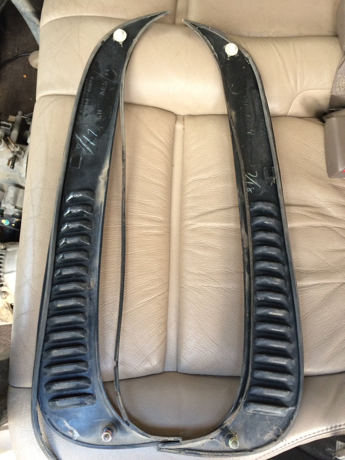

I meant to update my post #31 a long time ago but completely forgot until recently. In looking at an unmolested exterior vent panel, you WILL break one or both clip mounting tabs by sliding the panel in either direction. The tabs are U-shaped, and the open ends face each other. See the pic below. I thought my lower tab was open ended and the top was U-shaped; I guess it wasn't. That could explain why people disagree about sliding them either up or down - depends which one is broken already. I didn't see any access inside the vehicle to push out the mounting clip from inside the body so I guess the panel has to be pried out with the clips still attached like the rest of the internal trim pieces. The clips are smaller than the other trim piece clips, and white instead of red or yellow. They also have a square or slightly rectangular head instead of round. Their material seemed to be a lot less flexible than the red or yellow ones, so care should be taken if trying to pry them out of the body while still attached to the vent panel.
Am I completely overlooking a different method to remove the vent panel? I mean besides fire...
You can remove a small nut at the bottom of the plastic piece from behind the plastic lower interior panel. Then you can punch out a clip at the top by removing the 3rd safety belt connection and plastic trim piece behind the belt. Then just at the edge of the head liner you can get a brass drift and punch out the plastic body mount. Then you are just left with the middle U shaped piece and you pull down on the entire piece to remove it.
Finally got around to adding photos and figuring out which way to pull on them to remove the middle section.
Thank you! Just did this to remove the louver.
