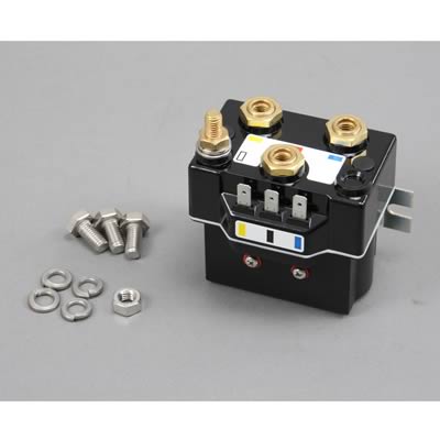

Superwinch unit for $100
Superwinch 90-14452 - Superwinch Replacement Solenoids - Overview - SummitRacing.com

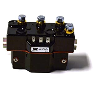

Warn unit for $200
Amazon.com: WARN 34971 Contractor, 12V, SW, W/FACTOR Y Bracket: Automotive

Here's some more info on these 3 different solenoid packs ......
First here's the Warn from Amazon at $199.54:
Here's the Superwinch form Summit @ $96.99:
Here's the Albright from Tecknowledgey @ $171.00 (see:Tecknowledgey - Albright, DC88P for their web site):
You can see that although they are close in appearance, there are some significant differences.
The top molding of the package is different on each, as are the top terminal locations and the area around the switching terminals, as well as the front 2 philips screw's placement.
The Superwinch and Albright 'seem' to be the closest match, but there is still some obvious differences in their cases (at least).
Without the data for each (IMHO) it's a bit of a dice toss as to them being electrically the same .........
