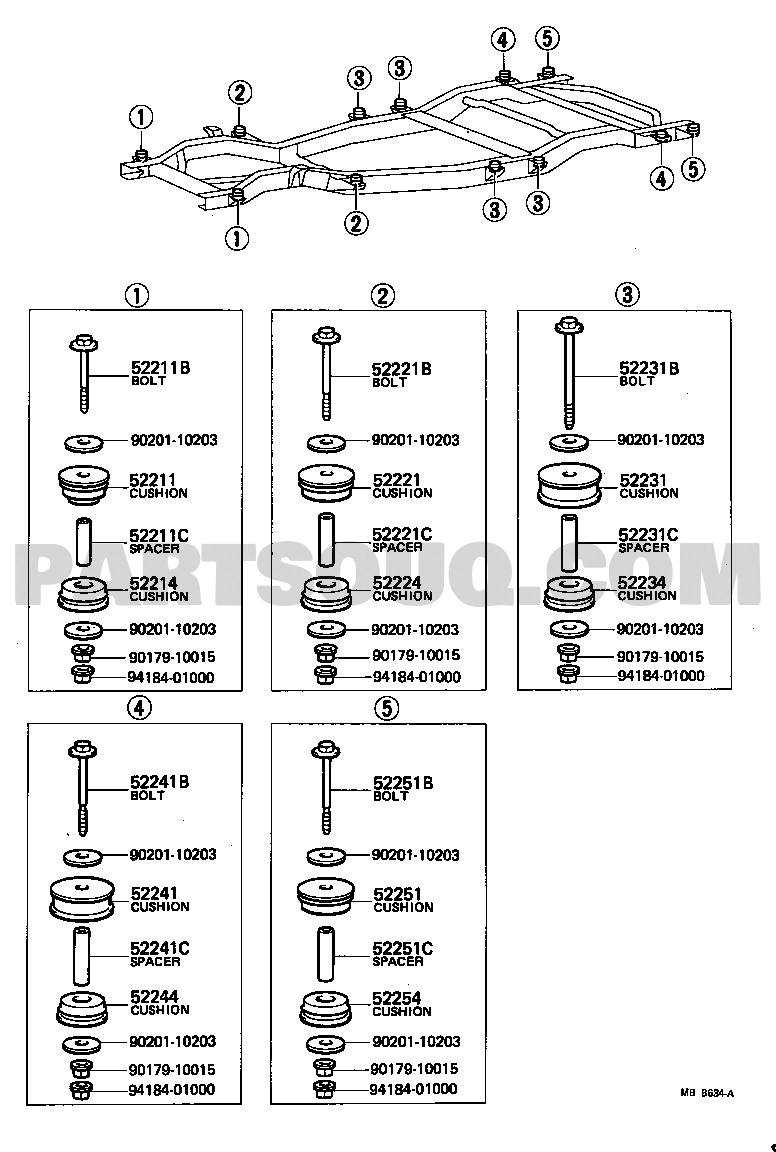

Hello gentlemen...What began as an engine rebuild has turned into an off chassis restoration. I am looking for a complete (24 piece) body mount kit for my '85. I have found kits for 84's and previous but no luck so far other than used (SOR). Maybe have to search individually?? There seems to be three sizes. Any help pointing me in the right direction is greatly appreciated!!! Thanks!
You can still order them new & OEM. Here are the numbers for the cushions themselves but I believe the bolts, washers, and nuts are also available. its all $$$ tho ($350 just for the cushions here). Note, these numbers could be wrong and some are duplicates. This is from a quick search on Parsouq
Body MountsQty NeededPart #
#1 top cushion25220135021
#1 bottom cushion25220235021
#2 top cushion25220125020
#2 bottom cushion25220225020
#3 top cushion45220360030
#3 bottom cushion45202360011
#4 top cushion25220760010
#4 bottom cushion25220860010
#5 top cushion25220360030
#5 bottom cushion25202360011
See here:
This website linked below has all the part numbers. Click on a number next to a part and the Toyota part number will come up.
Copy the part number and enter it into another online toyota parts vender's website to get prices.
On all Toyota drawings, most generic bolts and nuts and washer part numbers are labeled right on the drawing.
Most typical Toyota part numbers are 5 digits with a dash followed by 5 digits.
Example: 52201-25020

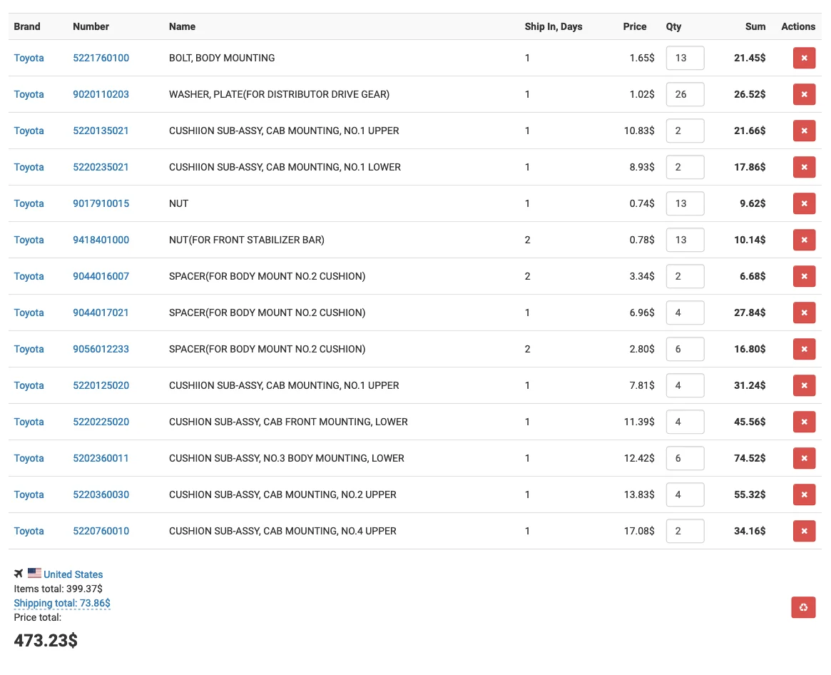

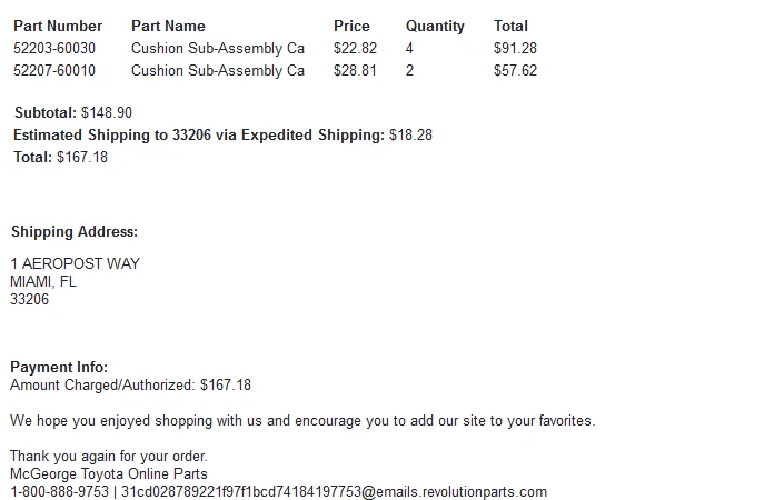

All above info was a HUGE help....was able to order most from Parts Souq...the rest from online Toyota. Yes, very expensive. Thanks, guys!!!!!!!!!!!!!

Hey Mark...here are the invoices...Partsouq lacked a couple items but McGeorge Toyota Online Parts had them... this is from last November so my memory is a little fuzzy but I'm pretty sure everything you'd need is here. It was sort of a pain because bolts, washers, mounts are sold separately and as you see is was expensive as all get out. But everything I bought here worked perfectly. A shop did the work lifting the cabin off the frame, the engine had already been pulled. They told me is was "easy" once the engine was out...but I can't give you first hand knowledge on that. The chassis was is pretty good shape-they did reinforce a couple of areas just in front of where the rear wheels would be. Hope this helps!

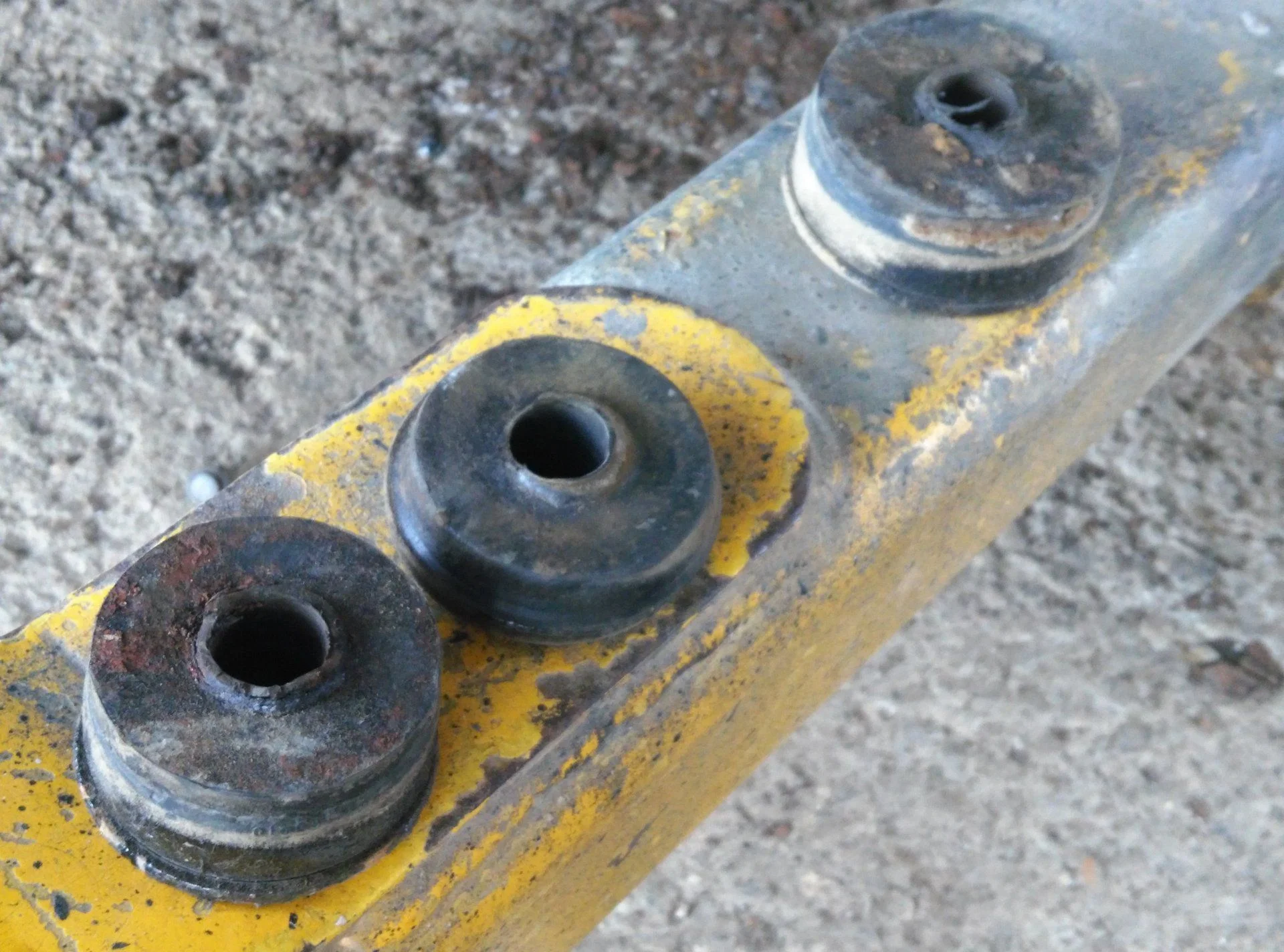

I've used these for 10+ years and they're insanely high quality. The one caveat is that EVERY little vibration in the road, wheels or drivetrain is noticed. Especially in how much the rear view mirrors vibrate now that I have a much more stout arm for it from @NLXTACY. I'm actually considering retaining the 1" lift pucks I got from 4Crawler and going back to OEM rubber body mount bushings to reduce in-cabin vibrations.
Did you also use the bolts in the kit? I am needing bolts (doing a body swap) possibly if the stock bolts happen to break in the process...
thanks!
They're part of the kit right? I have no memory of which bolts I used. Whatever is in there hasn't broken.
They look to be either part of the kit or a separate line item (if parts are ordered separately). I have a body being put on a frame by this weekend and just sourcing body mount bolts in case the dude breaks any....
I just installed the 4Crawler mounts on my 62, and as said, they seem to be of very high quality.
I ordered them long enough ago that I don't recall if I had to order the bolts separate from the mounts, but one thing I did notice is that there were two lengths of bolts included in the kit. The longer ones were coarse thread, and the shorter ones were fine thread. I don't suppose it makes much difference in the end, but until I noticed the different thread types, I could not figure out why some of the nuts refused to thread onto some of the bolts.
4Crawler also use a single nylock nut instead of the stock double-nut system. I much prefer the nylocks for this application.
