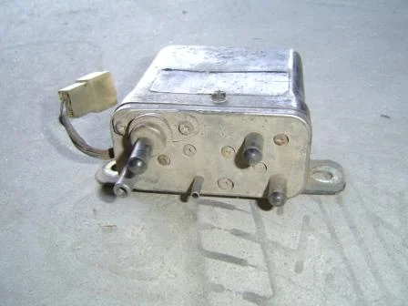

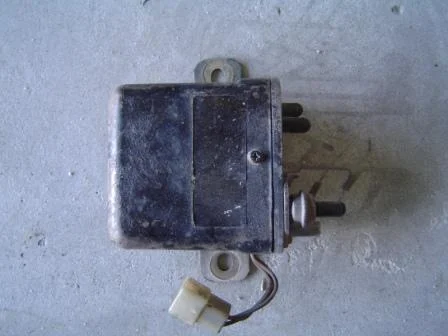

I have a VSV box, but I'm not exactly sure what year it is from. My Cruiser is a '72, but the engine is a '77, so the VSV box could be either year. Here are a couple of pics of it. PM me if it looks like what you need.
VSV
Be careful when you order...in case you don't know, there are two different ones for a 78...fed and CA. I believe you have a CA truck... has more ports...and that would make the VSV you think you need a much rarer item. How have you determined that the VSV needs replacement? Do you have the factory smog book for a 78? If not get one. Went thru this last year. BTW, If you are trying to get the truck smogged, be sure the guy doing the test KNOWS that you won't get a stumble when the EGR hose is unhooked. This is because it is hooked to the carb above the throttle plate and controlled by the VSV. The most you'll get is a small vacuum leak when you unhook it. If you are failing EGR function, most likely the passages are gunked up and you will need to pull it apart and clean the passages and tubes out. Not a fun job!! :bang:

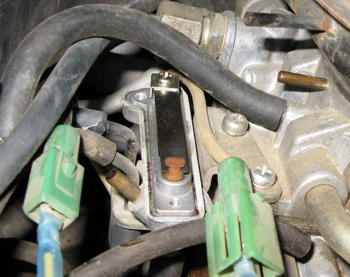

There is no rectangular box thingy (HIC ?) on the top front of my carb, but the manual shows one for Fed, CA and High Altitude. Of the 3 vacuum ports down by the adjustment screw on my carb, 1 is capped off – which does not seem correct? I assuming at this point someone removed the box from my carb. The only thing I don’t get is SOR still shows a carb with no box thingy? I guess I’ll try to find/add the box to my carb if possible.

WTF does the HIC do anyway?
It looks like a sensor of some kind; temp maybe? It only affects one of the three vac lines passing through. The other two are just straight-through tubes; connectors essentially. The line that is attached to the sensor is the 3rd from the top on the right. The top is the air cleaner, then the unplugged one (both unp. for the picture) and the 3rd is the lower of the two in the top of the carb. It might go to the power valve? I didn't look.
Cover removed:
Cover removed:
That's what I was also wondering - looks like a hose-joining point without much function.

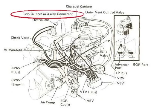

Two Orifices in 3-way connector?
Got some 3-way connectors from Toyota but they can't get this one (Two Orifices in 3-way). Is it important you think?

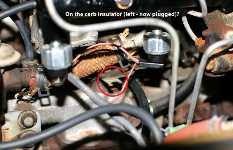

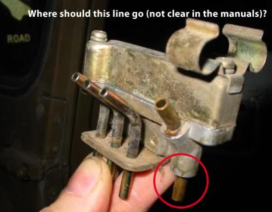

One last vacuum hose?
I've got one last vacuum connection I can't find (see photos). The used HIC from Mark's Off Road had this one plugged with a small piece of hose/bolt. I think it might go to the carb/insulator (now plugged on mine) driver's side, next to the one that goes to the VCV? Tried to search it out here - does not show up anywhere I can find in the manuals.

That tee has different diameter IDs at one or more legs. The easiest way would be to take the right size brass tee (OD) solder the ends and drill to the appropriate ID. If you need the IDs I can take mine and measure the IDs for you.
That would be great - maybe I can modify a standard "T", etc. Thanks! I think it's the 2 at the top of the "T "that are smaller id than standard?
So the bottom nipple is hosed to the caburetor adaptor. Where does the top nipple get hosed to?
Thanks
