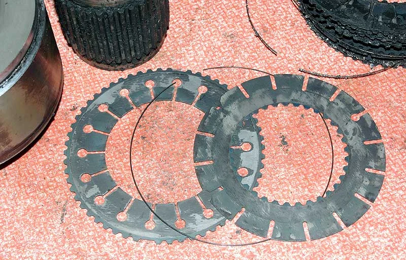

So, did a bit of ciphering. The stack is a disk spline to the outer shell, a wire ring that is a spacer to the next outer disk and the inner spline disk. The disks are ~.016" and the spacer is ~.028". So the stack is ~.044" per layer. The area were they fit is ~1.84", so about 42 layers or 84 disks. The inner disks ride in the space made by the spacer, so have ~.012" end float, if centered, ~.006" on each side for air/fluid. It's basically solid steel, with very little space for anything else.
It has two holes in one end, sealed by pressed in balls, likely how it was filled? If all of the slits in the disks were lined up, may make channels through the stack. The plugged holes look suspiciously like they may line up with the slits. Assuming that all of the disks are installed in the same orientation, maybe able to use a pin through the hole(s) and line up the slits. Possibly be able to pump fluid through it? Still, with the tight spaces, not sure how it would be successful? IIRC, the fill is ~80% fluid to air, but even that would be a small number.

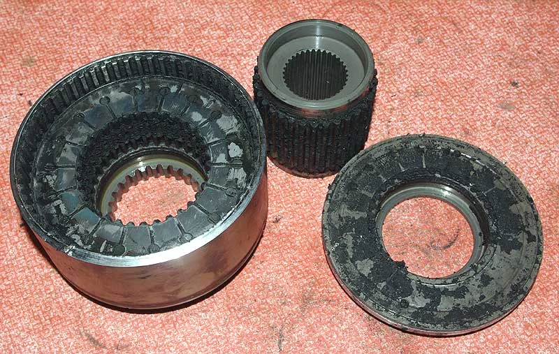

Based upon your description and photos I think the only procedure that could work would be a complete disassembly, cleaning and reassemble each layer already precoated with the viscous fluid and then reseal the assembly.
This would require cutting unit in half, or cutting one end completely off. Going to be tedious to weld that all back together without getting any internals, or fluid, hot. Just toss it, for pitty sakes!
