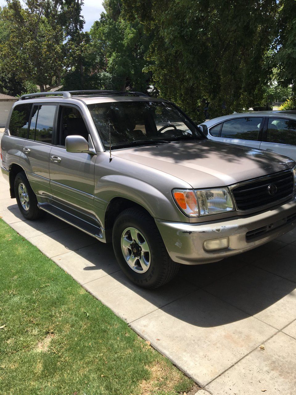

It's definitely fraud, I just I have no way to track the guy down. The guy who sold it to me is not on the pink, said it was his dad's car. we met at an obscure location. I could have an attorney send a registered letter to the name on the pink. but then really what would I be suing for? 1,000 bucks or so?
You're thinking someone bought it from the original owner who signed the title, than rolled it back, than sold it to you and gave you the title the original owner signed?

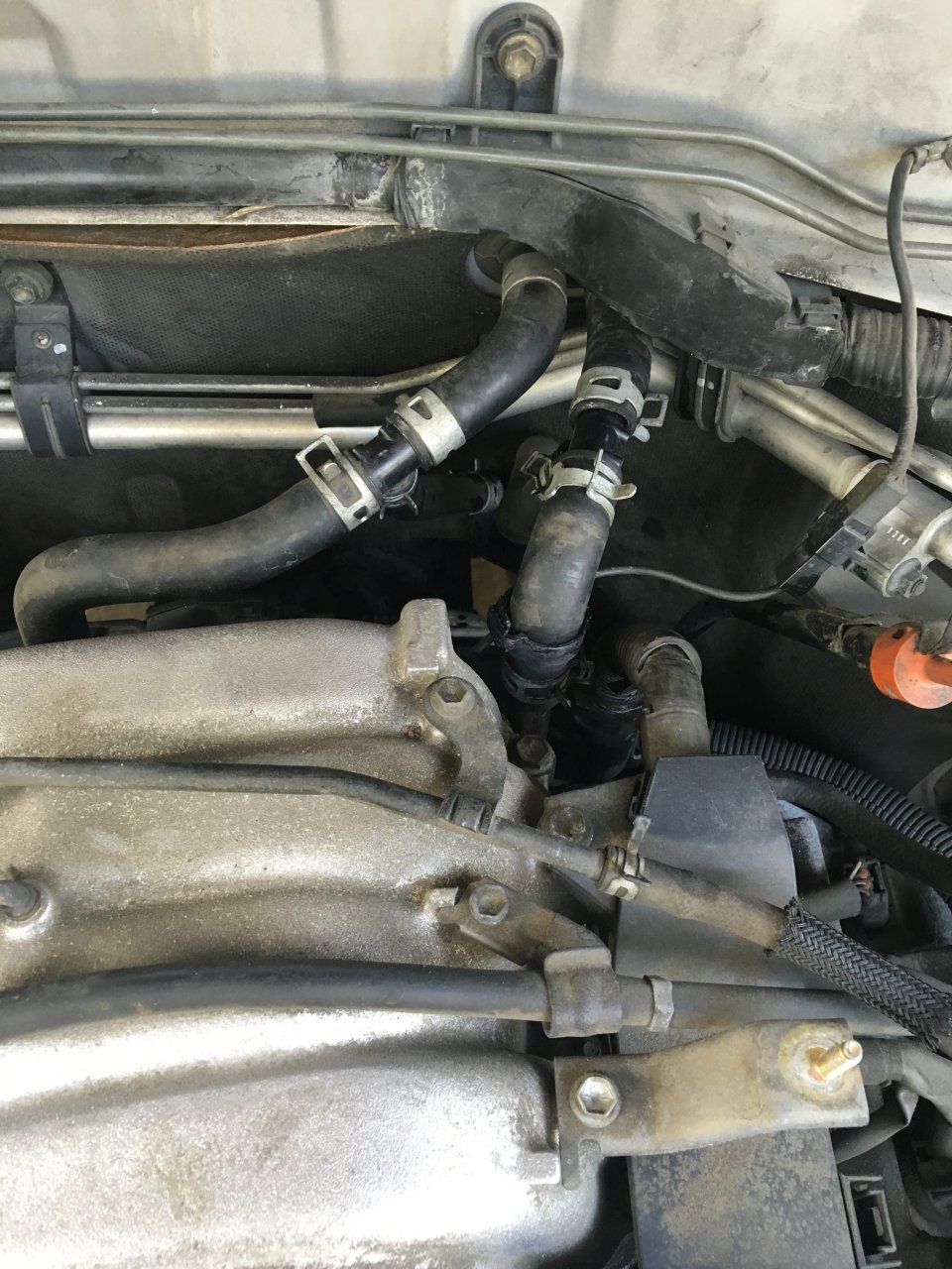

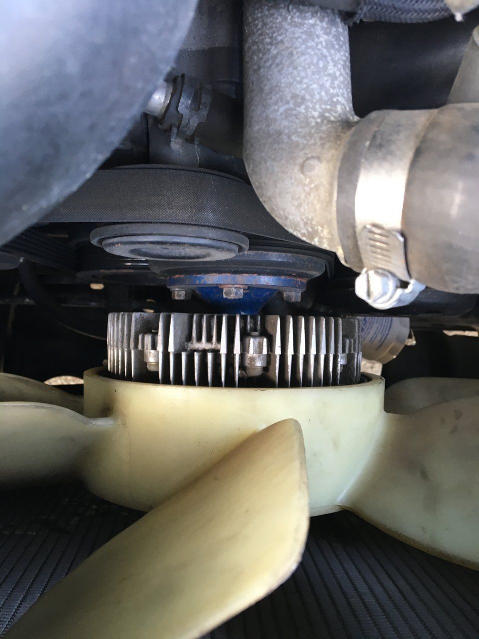

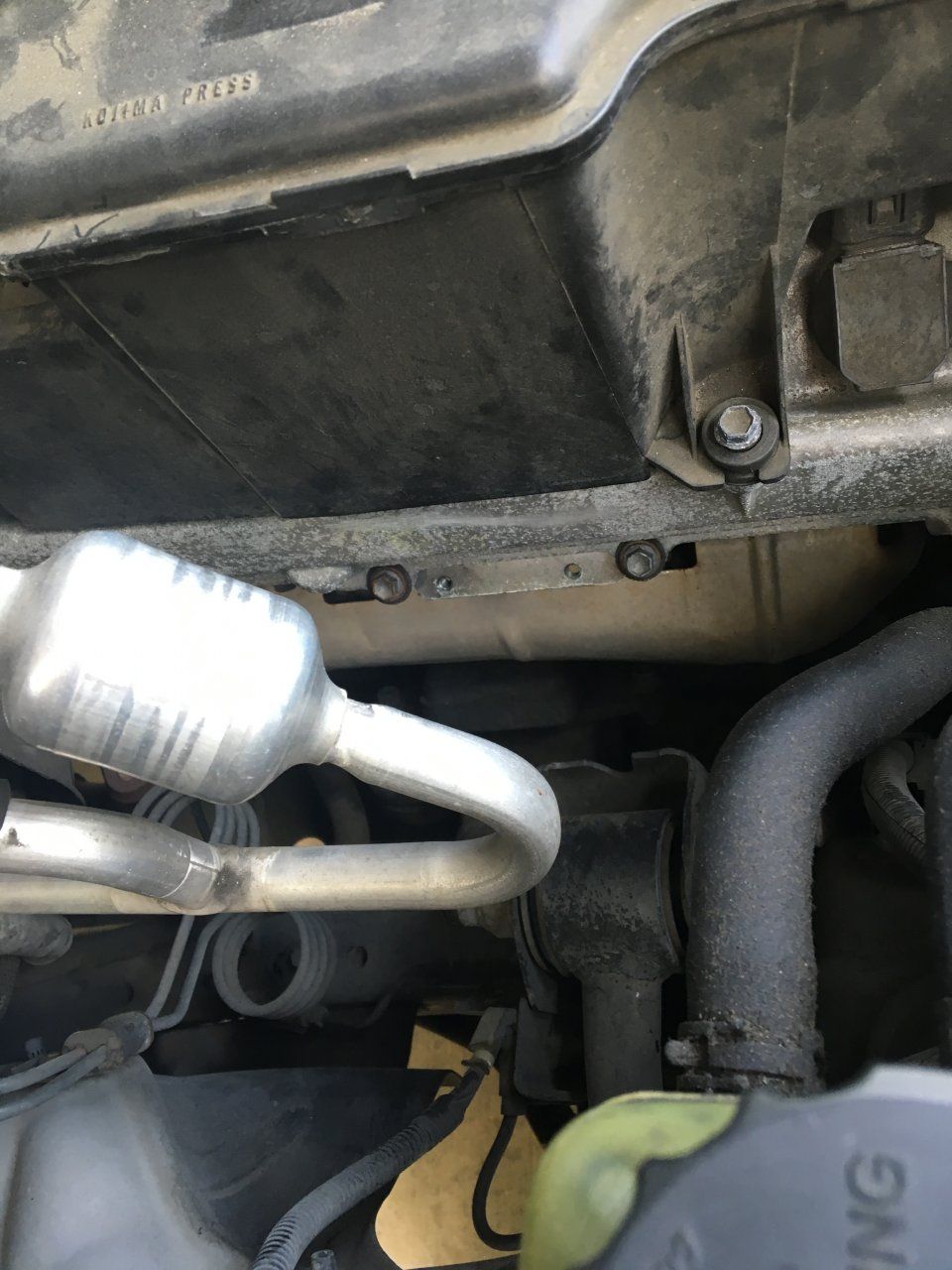

I wonder if my engine was swapped at some point. There is no engine VIN plate, water pump is blue (aftermarket?) . I replaced heater Tees. The old ones were perfect. TB looked good too. Can you tell anything from these photos

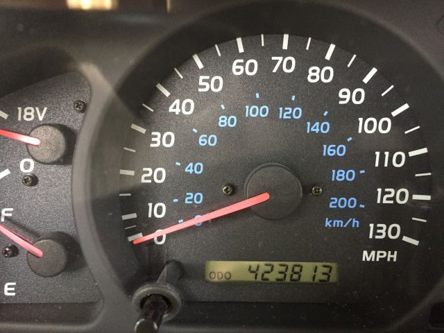

I'm not trying to dispute the plethora of evidence that indicates odometer fraud but from a technical perspective in not sure how you can change the mileage of the vehicle without a ecu flash or a different ecu. The mileage is stored in the ecu , changing clusters shouldn't do a thing. It simply is a LCD indicator that receives ecu feedback. The ecu would be where you'd find suspect tampering imho.

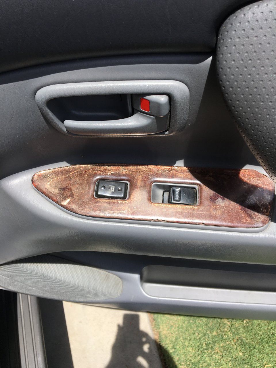

Did u get a new cover for that door panel window and lock switch yet? I have the same problem, I haven't looked into fixing it yet on the list though.
AFAIK, most Toyota/Lexus's store the odometer reading in the instrument cluster.
That's what I've read too. It's stored on an EEPROM chip in the cluster, and can be edited the same way a locksmith would flash an ECU.
Odometer Reprogramming
I'm shocked that there is no other location that's stores mileage information.

Since you have the alarm TSB, they need to remove the cluster anyway, if it came from a junkyard or if it is used it may have writing on the back of it or something that identifies it as such. May help.
If it were me, and I liked the truck, I'd check with Toyota about the service that says just "engine". Wierd was it replaced or rebuilt or something.

Engine serial number missing is a bit concerning. It may be that the engine matching instrument cluster (millage), which would be a good thing. It may be from midnight auto supply.
