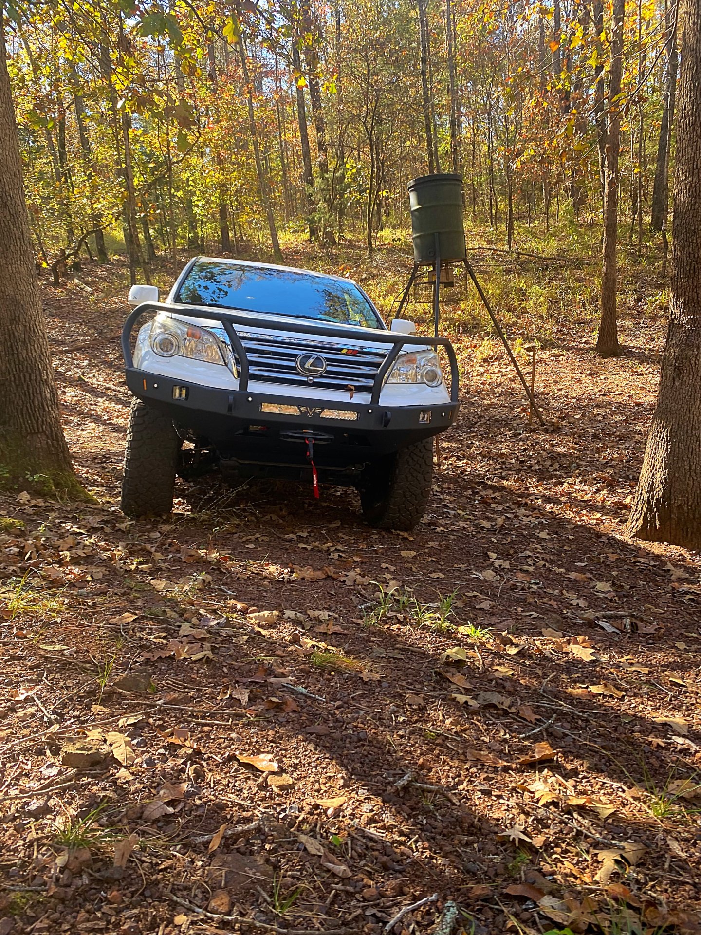

Took the new bumper out to play this weekend!
Doing a little back woods wheeling to check on the family moon-shine still pictured behind you?
😂. We have different Hunting/ Conservation methods in Texas . That is a wild life feeder that distributes corn year round . My Wife and I Love setting in the stand watching the wildlife.
