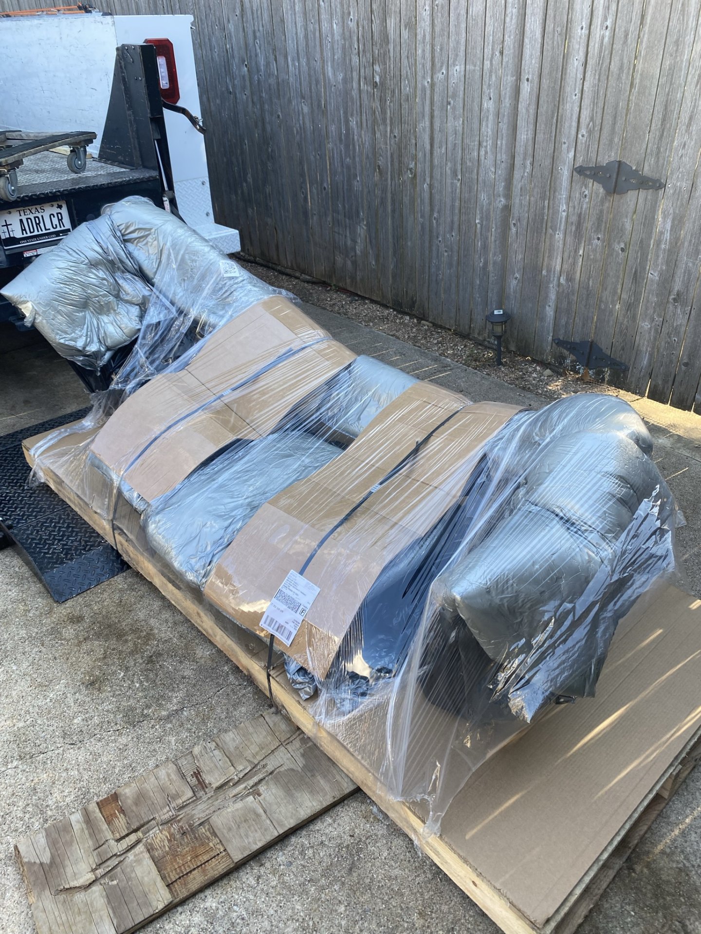

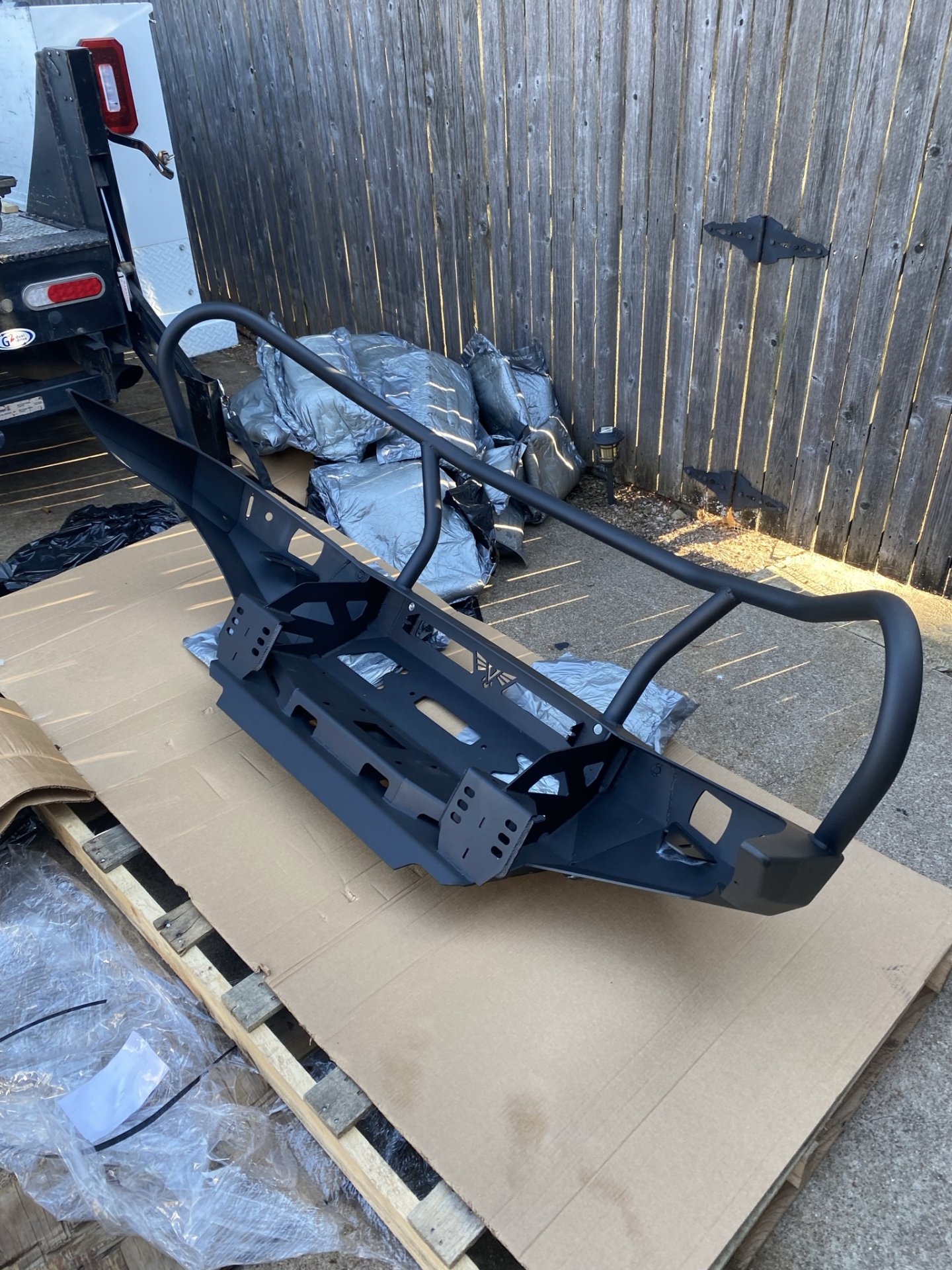

I received the bumper on Friday. Yes you need two folks to move it!
Yes it’s bigger amd beefier than I thought. Kudos to the packers! Not one scratch or dent. My service truck lift gate was very handy. A four wheel cart is a must. More to come.

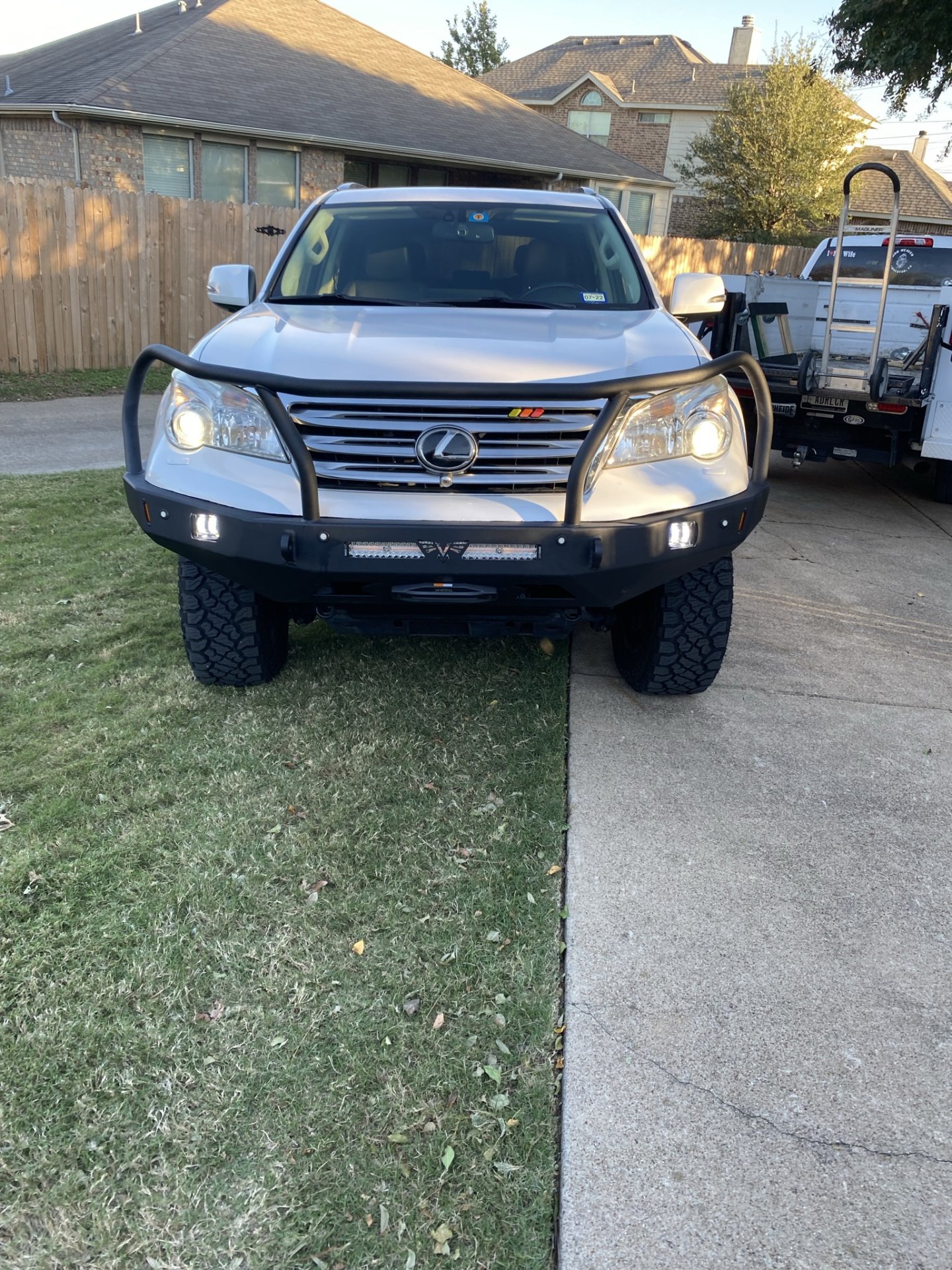

WOW!! And even got the running lights installed and working!!
Looks AWESOME Offroad47!!

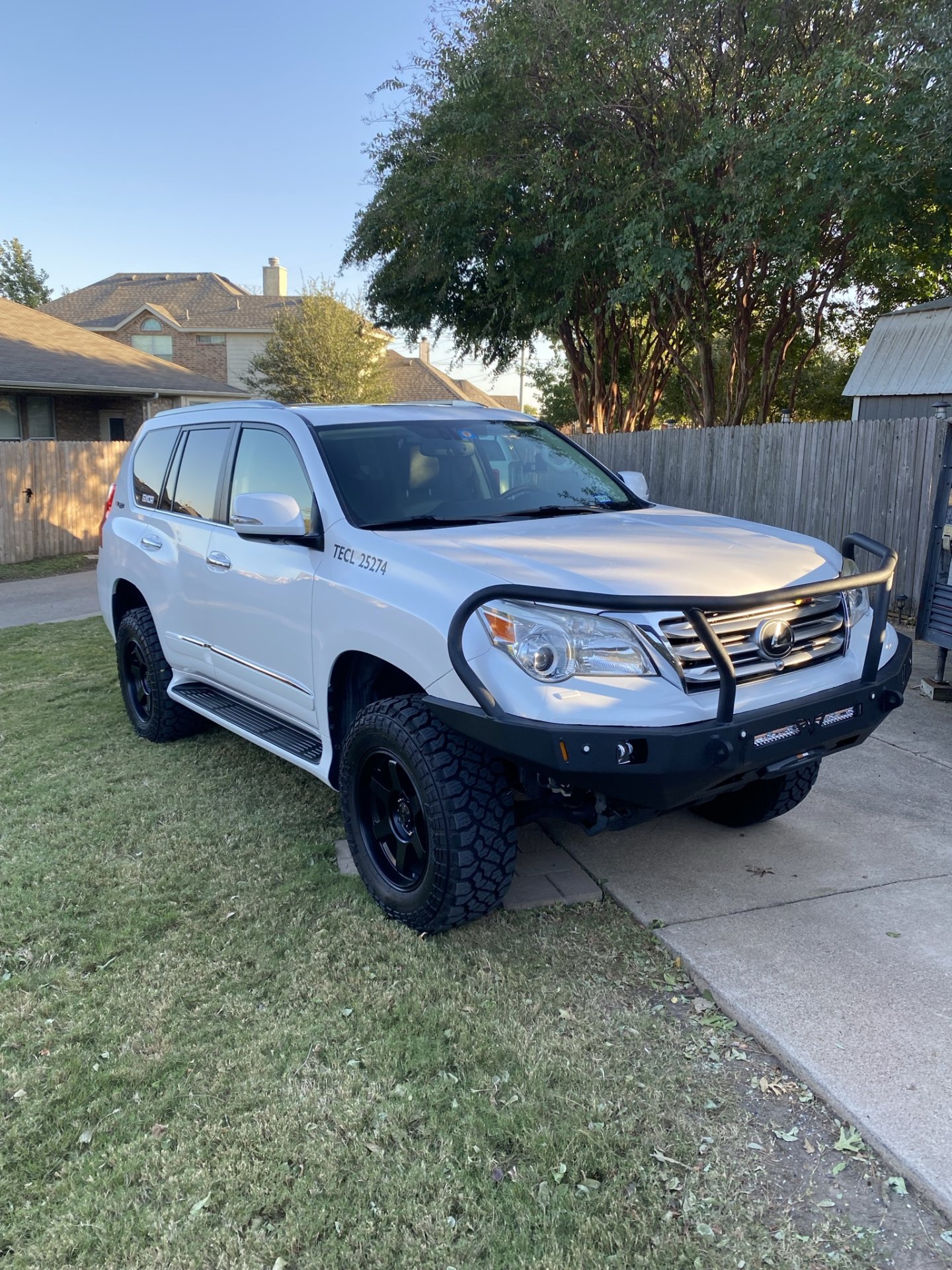

Good to see one in the wild!!!! How did the install go? I've watched the video, and it "seems" pretty straightforward. Any "gotchas" to look out for? Still hoping mine comes this month.
It’s pretty straight forward. You will need to fab a couple of brackets to hold the power steering cooler line if you have not already moved yours. Use a 5/8 piece of heater hose on the 5/8 drill bit to keep it from going in too far. The frame is pretty narrow and you only have about two inches on the backside before you toast the a/c condenser.
You will need a lift table. I need to loosen mine up at the frame and jack up on one side to get it more level with the hood. The measurements they give are very close on a perfectly straight bumper. I’m going to pull my bumper topper back off trim 1/8” off and put a slip on a U shaped on rubber trim.
Mount everything on the bumper first .

No winch installed yet? Where are you planning to install the controller?
I put
I went with the X Bull 14.5K the controls will not fit on top unless you move the power steering cooling line. I installed the controller on the passenger side of the winch. I’m going relocate the p/s cooler. Then I can put it where it belongs.
