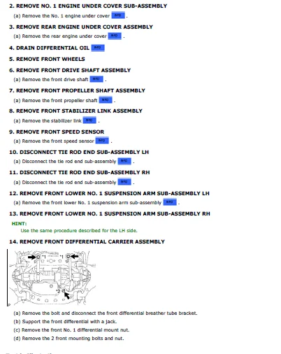

just got FSM, and this does not look like fun....

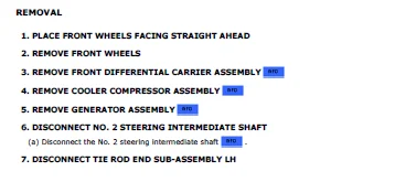

for #4, you have to pull A/C compressor out... FUN...
here are steps for #3

holy cow, what an amazing guide to getting the rack out. 4.2 hours to do this seems crazy fast.... I am sure if it is the 10th time you did it, then maybe.

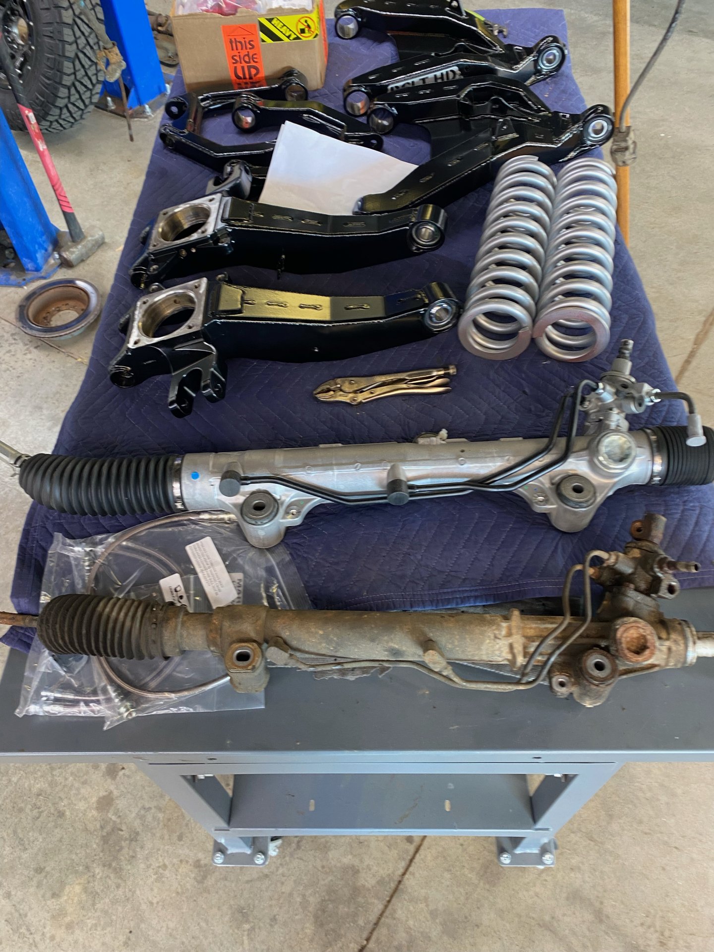

We went a different route and upgraded to 200 series racks with RCLT on our 470s haha. RCLT does work on 460s too though :) The OEM 470 rack is so tiny compared to the 200 rack. The 150/460 rack isn't that much bigger than the 470.
That's awesome. Is the 200 series rack a direct swap to the 150 or is modification needed to make it fit using OEM spindles, LCA, UCAs (not RCLT)?
