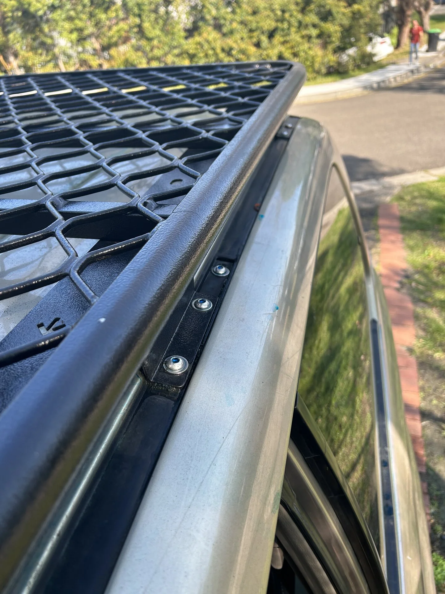

Hiya all,
Looking for some advice on next steps. Have 100 series 1HDFTE.
Decent amount of water coming into the vehicle in rain, the carpet at passenger footwell is extremely wet, car getting that lovely moldy smell.

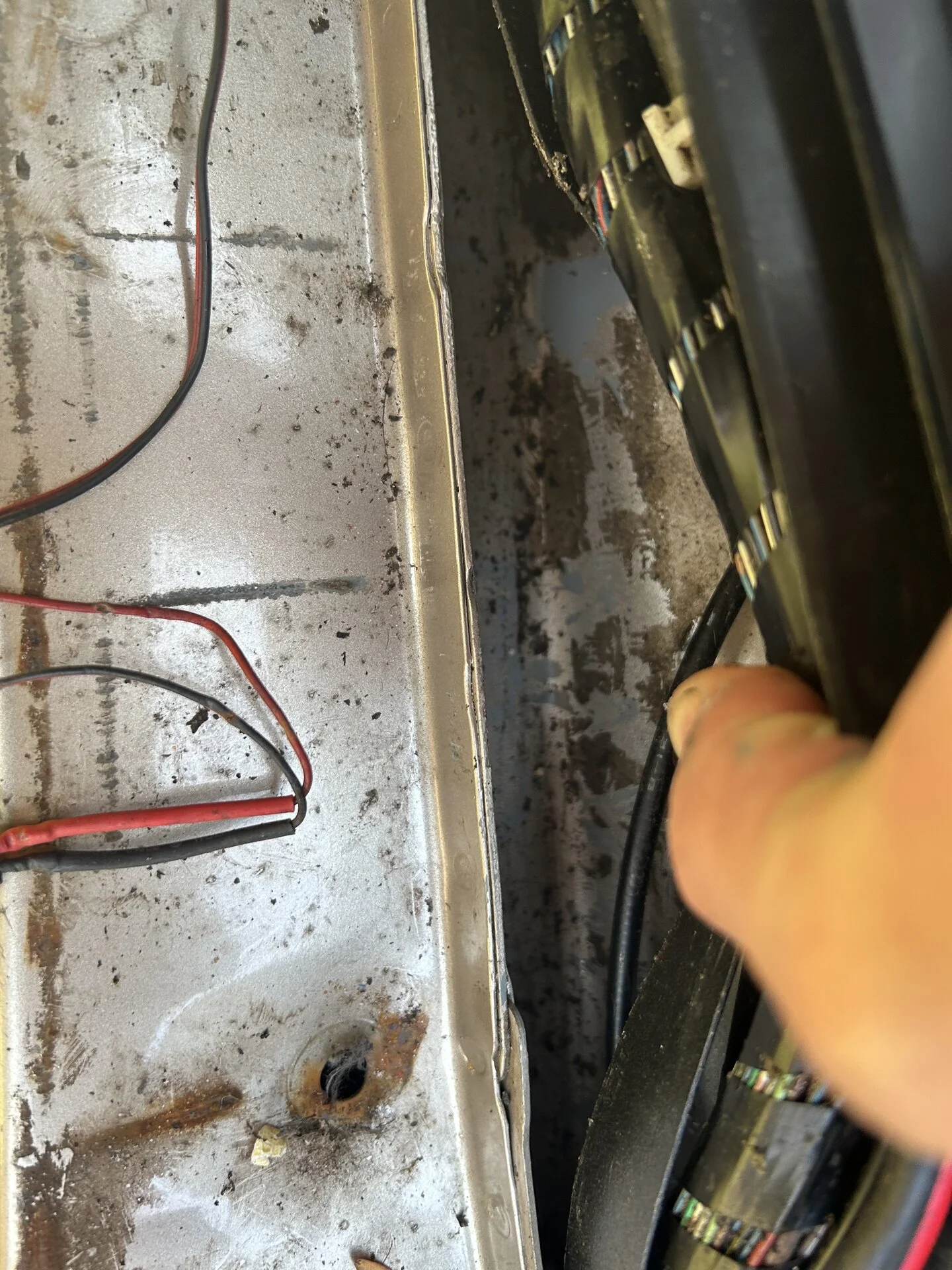

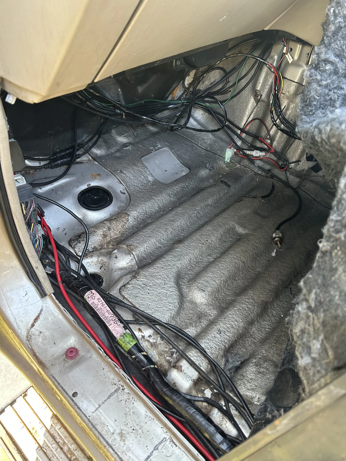

Has both a sunroof and roof Racks which I am assuming that (and from reading through the forums) one of these is the culprit. Also on the passenger side the, taking the carpet up along the outside of the truck, looking under the electrical cable also was pretty wet at the back corner (back seats) Noting I do park on a bit of a hill, sometimes facing up, sometimes facing down. so water could be moving around. Also no visible water damage around on the interiors near the sunroof.

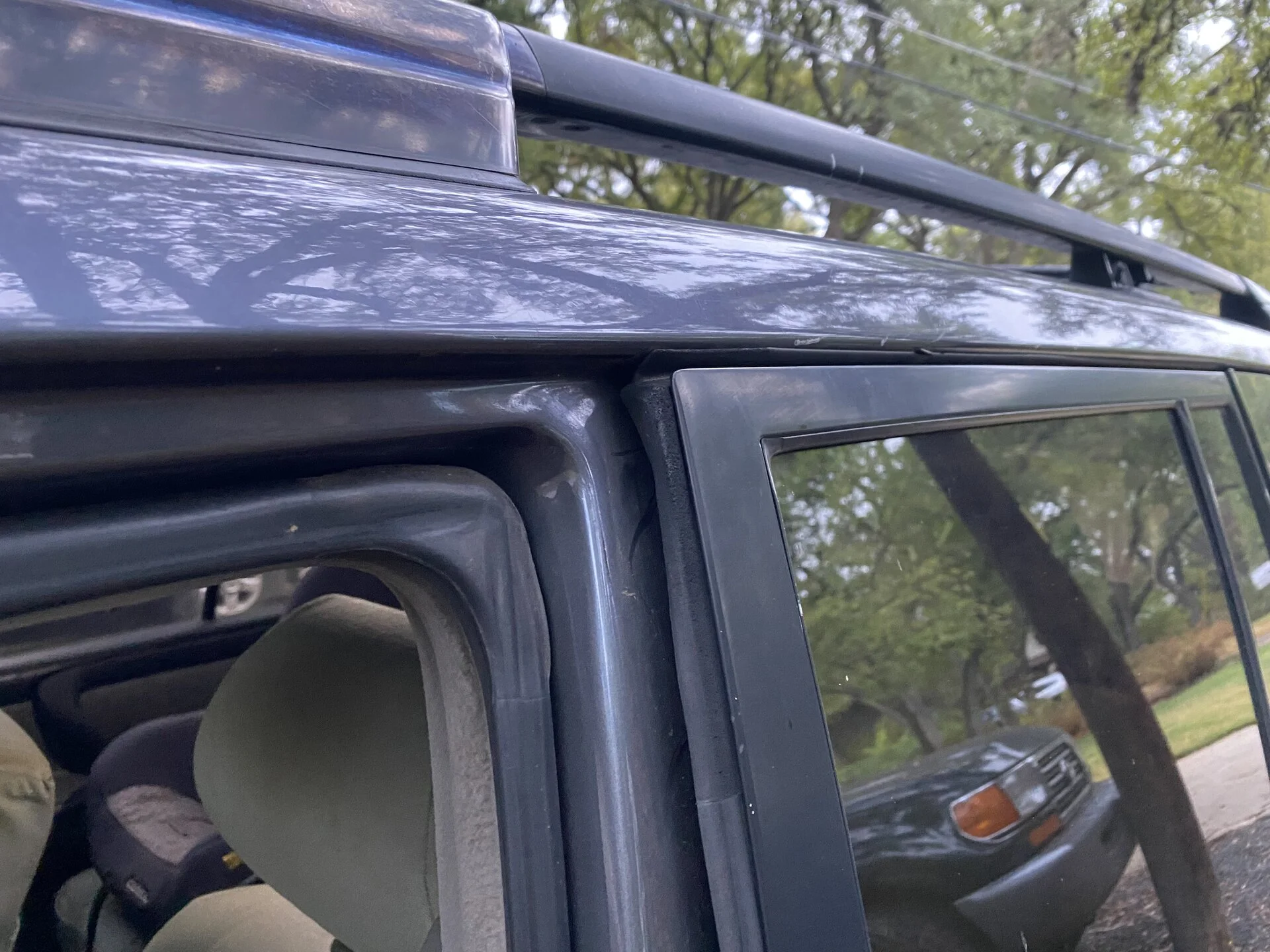

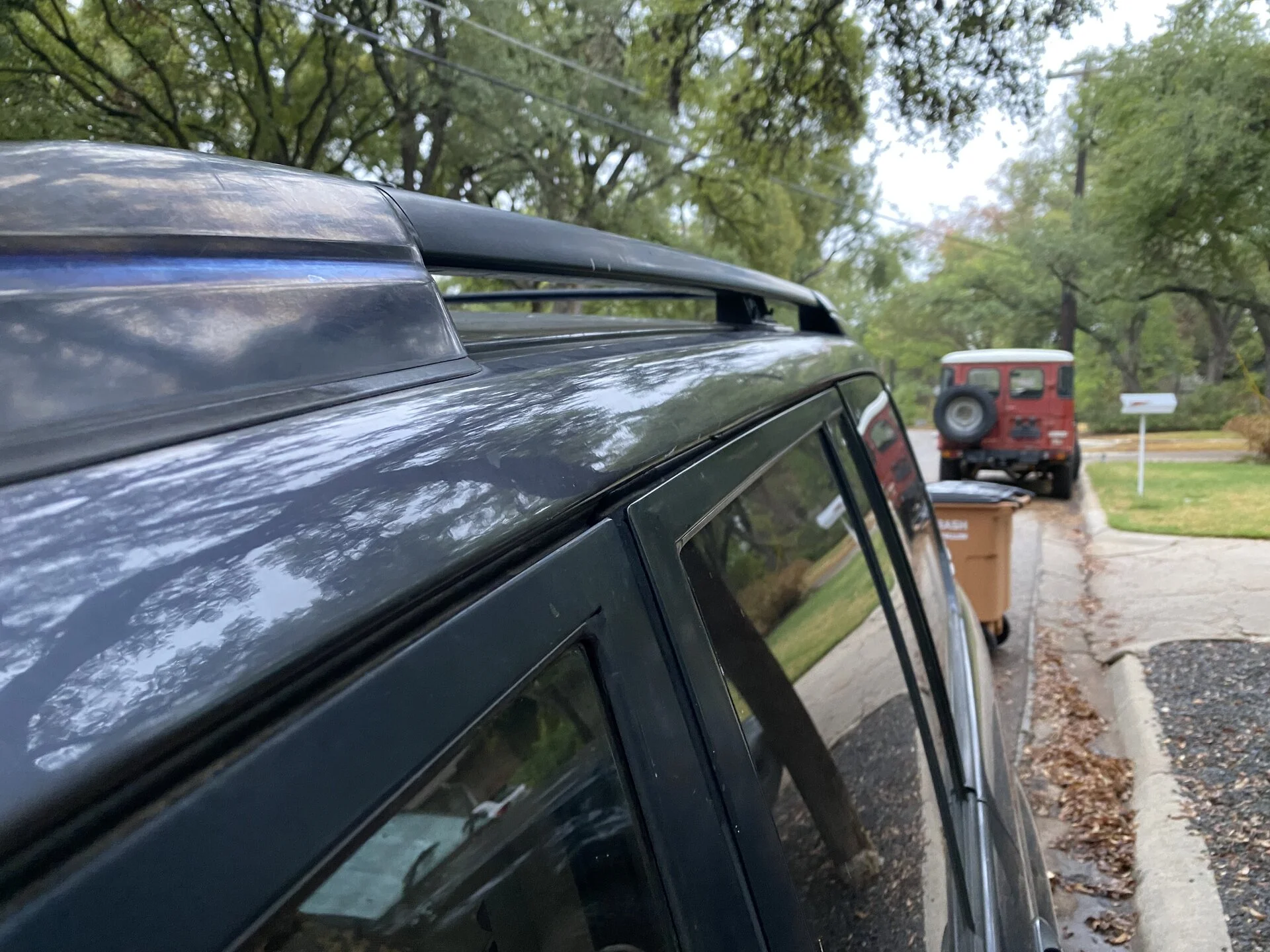

Pretty confident not the roof rack drains, they are running clear.

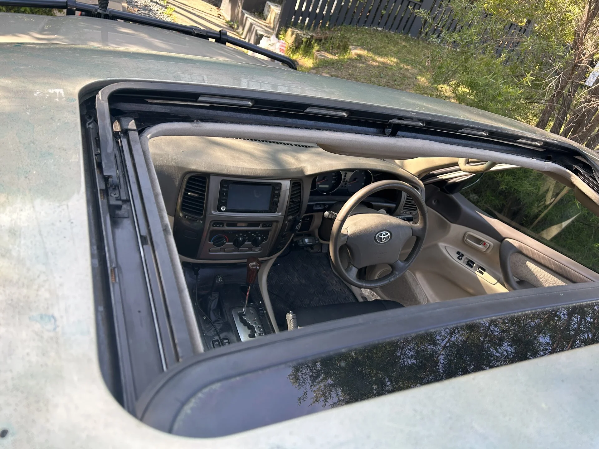

Before I replace the sunroof seal and take off roof racks to seal the bolts, I poured like 10 litres of water with blue food dye first into the roof rack rails and then over the sunroof and also across the windscreen for good measure. Annoyingly none of these tests had any water or blue water appearing at the footwell or along the gutter at the side. Cant replicate the leak.
My question here is - does this test mean nothing, that is, still probably one of these and the fact no water coming through because of time or volume of water and I should just ignore? are there any other potential culprits I should look at?
I am thinking to take roof rack off and silicone the bolts and see if that fixes it when it rains, if not, cover the sunroof to see if that fixes it, then if it does, replace the sunroof seal. If it still leaks then scream at the heavens.

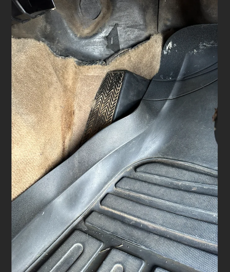

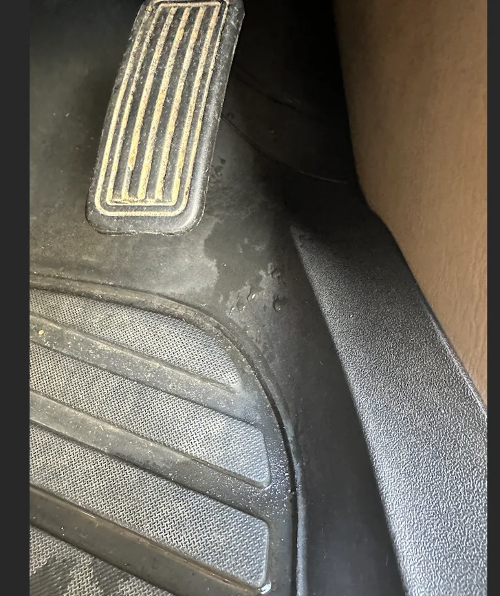

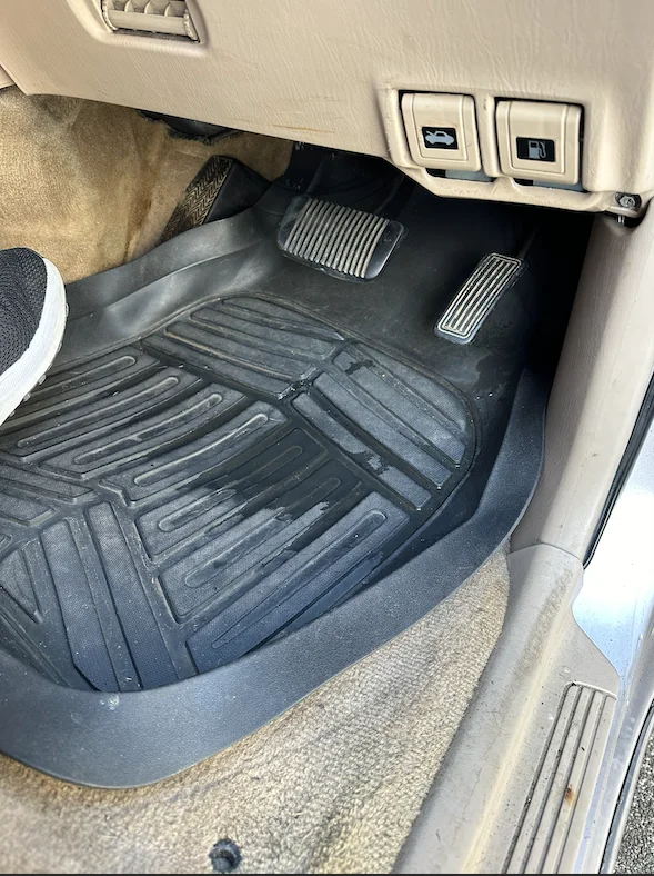

I'm also suffering from water ingress. I recently bought the wagon, so discovering all the new issues with very little info. I get water in the drivers side (right hand drive) - the carpet is damp/wet AND there's water in the rubber floor mat which appears to be dripping from somewhere above the accelerator pedal. A quick feel around up into the wiring area above said pedal is also wet - which is not good - water and wiring are not usually a good idea. At first I thought it was the heater core leaking. Since I bought the vehicle in summer and it was dry when I bought it and I found it damp after using the heater. The heater also doesn't blow hot, so I'm not sure what's going on there. A/C doesn't blow very cold, but does blow a little cold, I had the gas checked and it's low. The motor has had extensive work done, but I'm not sure it's ever been completely out - so I don't know if the A/C is leaking or just low on gas. The photos show water after overnight rain and vehicle parked on a slight downhill toward the front.
All the fun of chasing down old cruiser issues. The carpet is pretty much gone now, but I need to chase out the leaks before I replace it. I can see rust forming along the top of the windscreen seal - nothing seems to be bubbling, but no idea how bad it is until the screen comes out. Pulling the whole dash to get to the heater core is also not something I'm terribly excited about. So befoire pulling the windscreen or the whole dash, I'd love to hear of some way to test/check for leaks to see if I get lucky. Thanks team.
