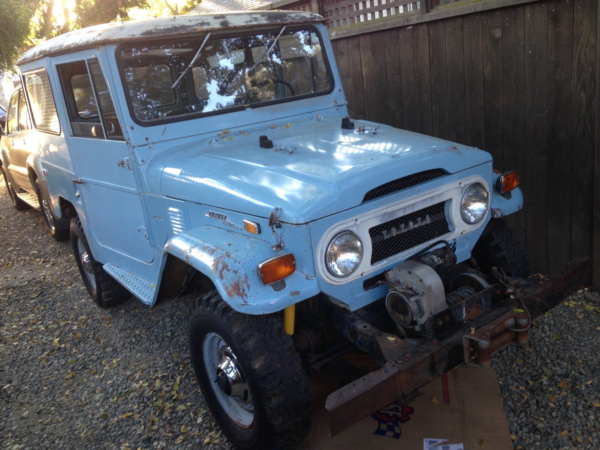

Thanks everyone, for the input. Definitely fear that this could be an extended project going the way of a V8. Not a huge fan of the F engine, but like the 2F very much. This begs the question....What will it take to install a 2F? Are rebuild kits still available for the F and or 2F? What would it take for the 2F or f.5 install? I can imagine mating to the three spd. would require some work. It may be that I keep it simple/original and rebuild another f. I've posted some pics. Check out the serial number on the block...I'm guessing pre 1968. Can anybody provide an actual year of manufacture? ( 259802 )
Thanks-
Thanks-
If that’s the cruiser you’re going to put a v8 in, I’d put a modern v8 or go back to stock. It’s looks to nice for an old school chevota. Looks like my fj40. It’s got a 2F in it. I’m sure it was an easy swap. Good luck with whatever direction you choose.
