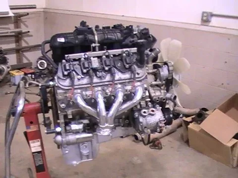

Hooker Super Comp Block Hugger Headers

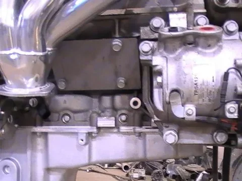

Laser Cut Engine Mounting Plates

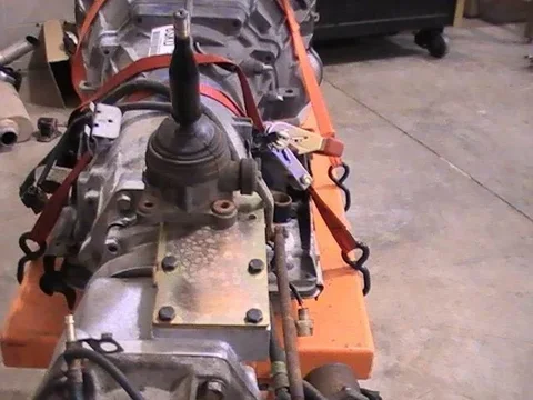

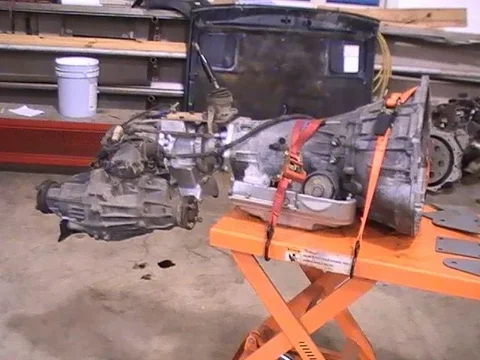

4l70 mated to tcase
marks tcase lever adapter is not aligning
i will be making a new one to replace
id love to see side profile of the motor mount and headers when you get them done

If you're going to fab your own trans/transfer adapter have you given any thought to incorporating a mini truck transfer gear reduction sandwiched between the 4l70 and LC transfer?
I think he means the classic double reduction tranny, like what Marlin Crawler offers for the min trucks.
Kirk,
From the pics I chose to go with the marks setup to save the time of me reinventing something as good as or better. The marks setup worked out pretty good thus far. I dont see how I could do much better.
As far as a double from a mini like a marlin setup I have two issues. First is the mini truck unit is undersized in my opinion to be installed on a 80 series. Second the length issue would be a challenge to squeeze it inline. I think the marks crawler box that I have on the shortbus is a really nice design and works just fine.
Good point on the significant power difference. My mind started working when I saw the adapter stack and what appeared to be enough room to squeeze a double in there. Granted with the grunt of this setup and a slushbox a double may not be needed especially since you already have a rig for giong slow.
honestly most types of wheeling I see the old V8 did perfect with 5.29's and the 39.5's. having a torque convertor with some hpower makes crawling easy. the 1fz needs the crawler imho bc i doesnt want to whind up when you need the juice. My old mini truck was the same way. So my point is a auto tranny and some horsepower can negate the need for the crawler.
