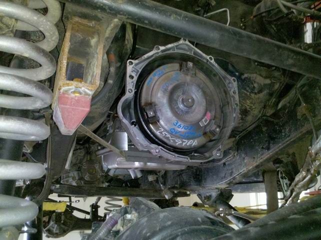

Tranny and Tcase are in. Hope to set motor tomorrow and get the engine mounts tacked in place. There is so much more room in the transmission tunnel with the GM tranny in place. More tomorrow hopefully. Kirk

Also I had two stripped and one broken off tranny crossmember bolts. I drilled all the bad weld nuts out and fished the machined fasteners I had a friend make with a coathanger through a hole in the framerail. Then the step in the fastener pulls tight to the bottom of the framerail when in place. I then TIG'd the fastener in from the bottom and the problem is solved.

Great progress. Man, I'm glad to see the adapter fits into the cross-member! It's also interesting, to me, that the torque converter only has 3 bolts.
That is 100HP per bolt ;p

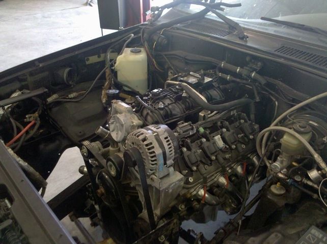

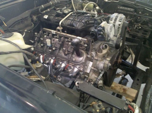

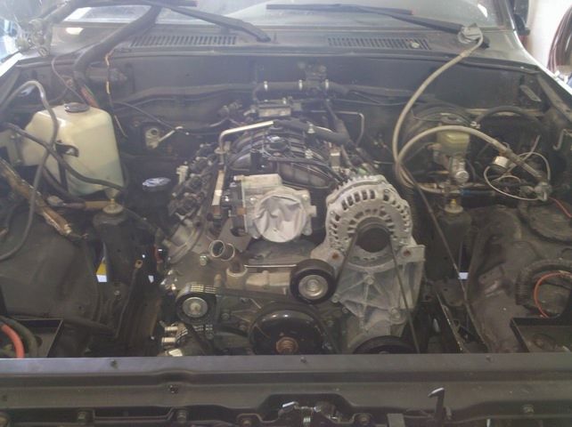

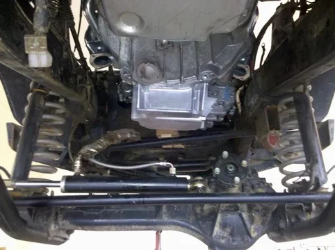

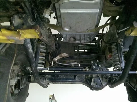

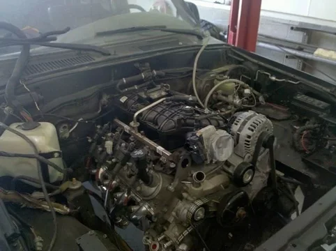

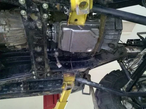

Motors in! Need to laser cut different motor mounts. The ones I pre cut are way off. Also a 1500 silverado oil pan is not going to work. My ram assist steering will be in the way. I am thinking the trailblazer ss pan I have may work. As a last resort I know the kevco with remote filter will work.
Other observations I have is the motor is definetly taller than the LT1. I think the alternator and throttle body will be very close to clearing the hood. The hooker super comp block hugger headers will work perfect. More to come.....

Nice work
That motor looks like it was meant to sit there. I never really considered even trying to put a V8 in the 80 but those of you that are doing it and documenting it are making it seem more realistic. GM has even come out with a LS3 EROD crate motor made to work with a 4l80 and a few others, its a little expensive but seems almost plug and play for those of us with a 95’-97’ and would like to pass emissions and want a base motor @430HP. They even provide an instruction manual and wiring diagram. The really good thing is everything is very similar to your setup other than the marks adaptor.
Nice work on pictures and documenting your progress. I now wish I could turn that key and hear the LS motor purring every time I jumped in the FJLS80.
