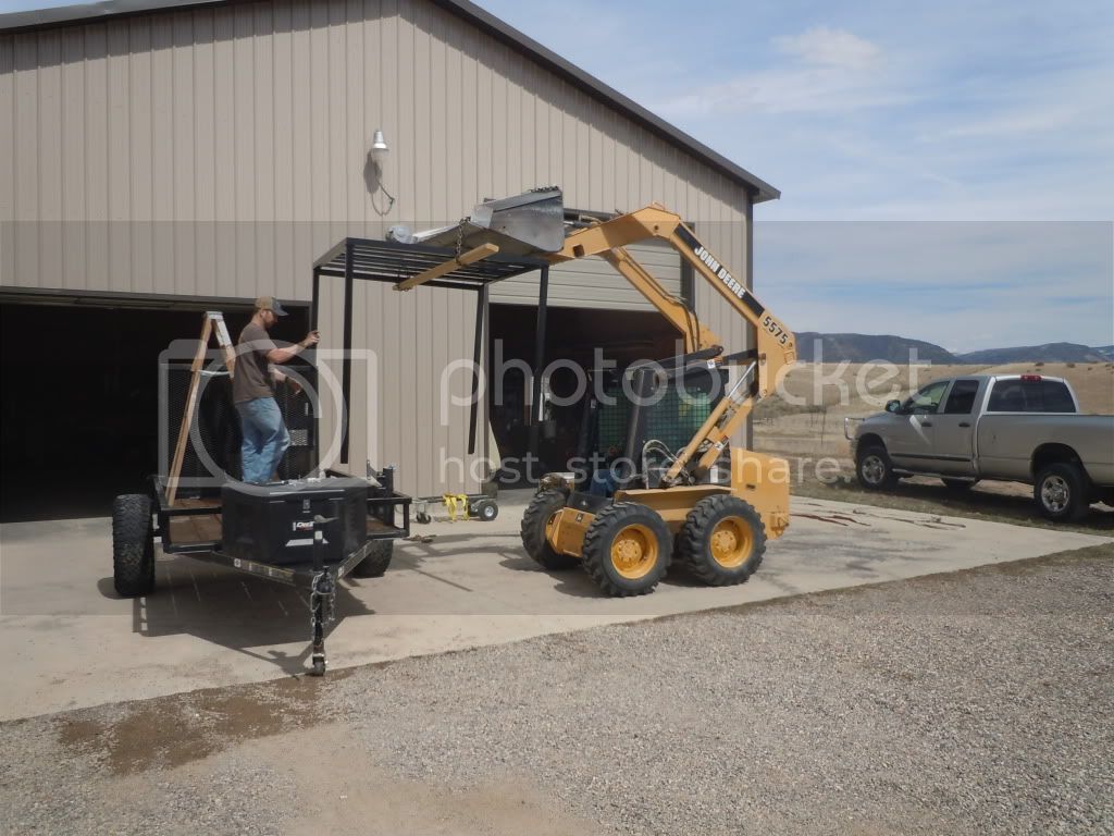

Finally got my axel and other misc parts in from Classic Trailer, great weather this weekend to work on the trailer. Torched old axel/fenders, welded new axel and painted the tent rack and drilled holes for attaching it to the trailer.
Up next, wheels and tires...
Cut the old axel and fenders off.
Welded the new axel on.

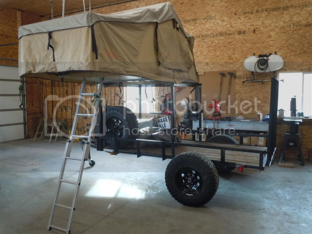

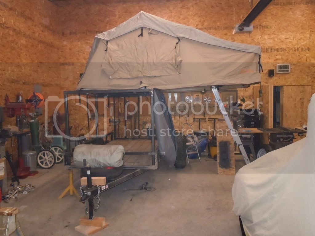

Worked on the trailer more this weekend.
I think Bandit approves of the wheels/tires.
Putting rack in place.
Test fit of ATV with new spare mount.
Bolted down the rack and tool box.
Tent opened.

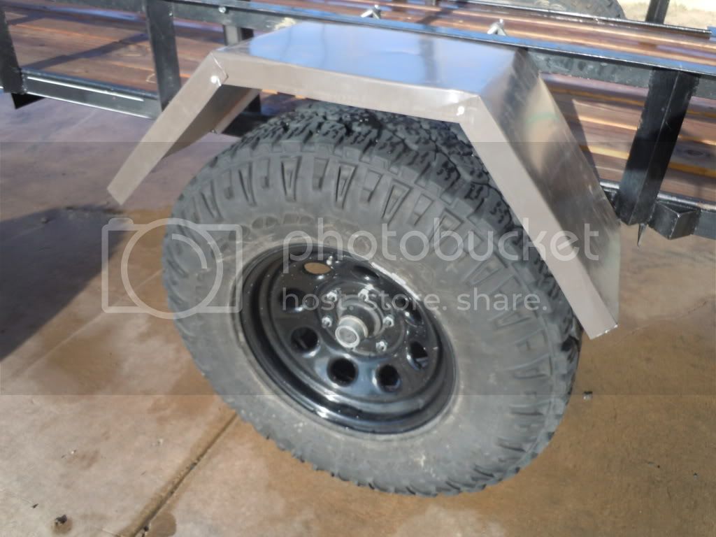

Sheet metal fender template.
Hopefully I will get the fenders made this week and we can come up with a folding table. :hhmm:
