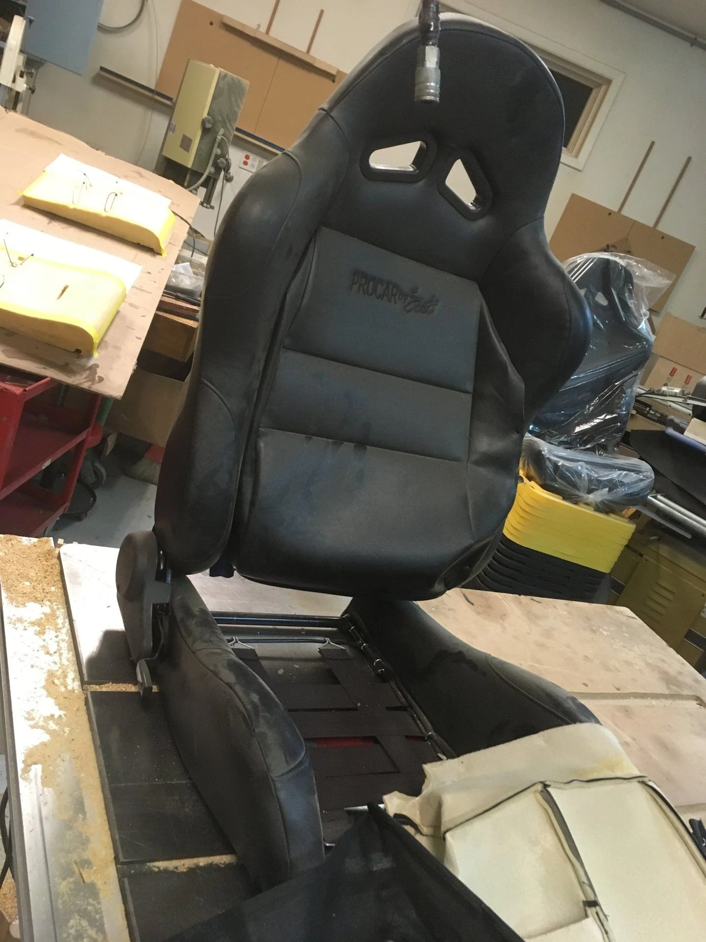

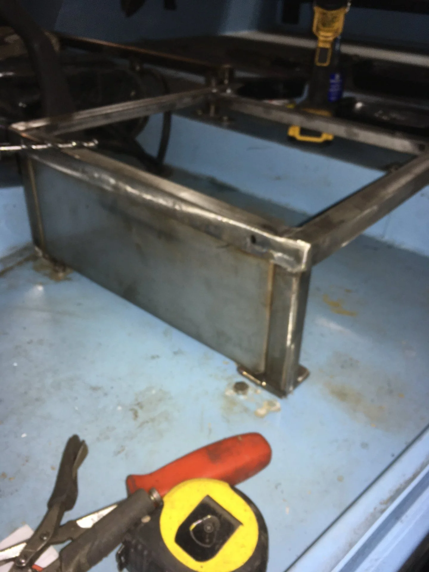

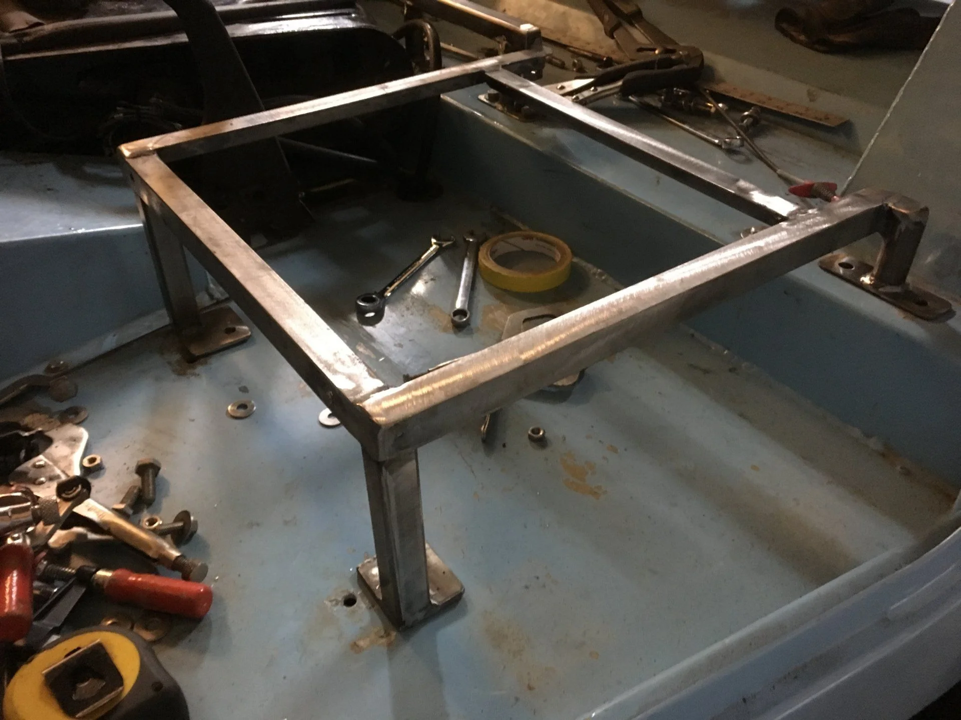

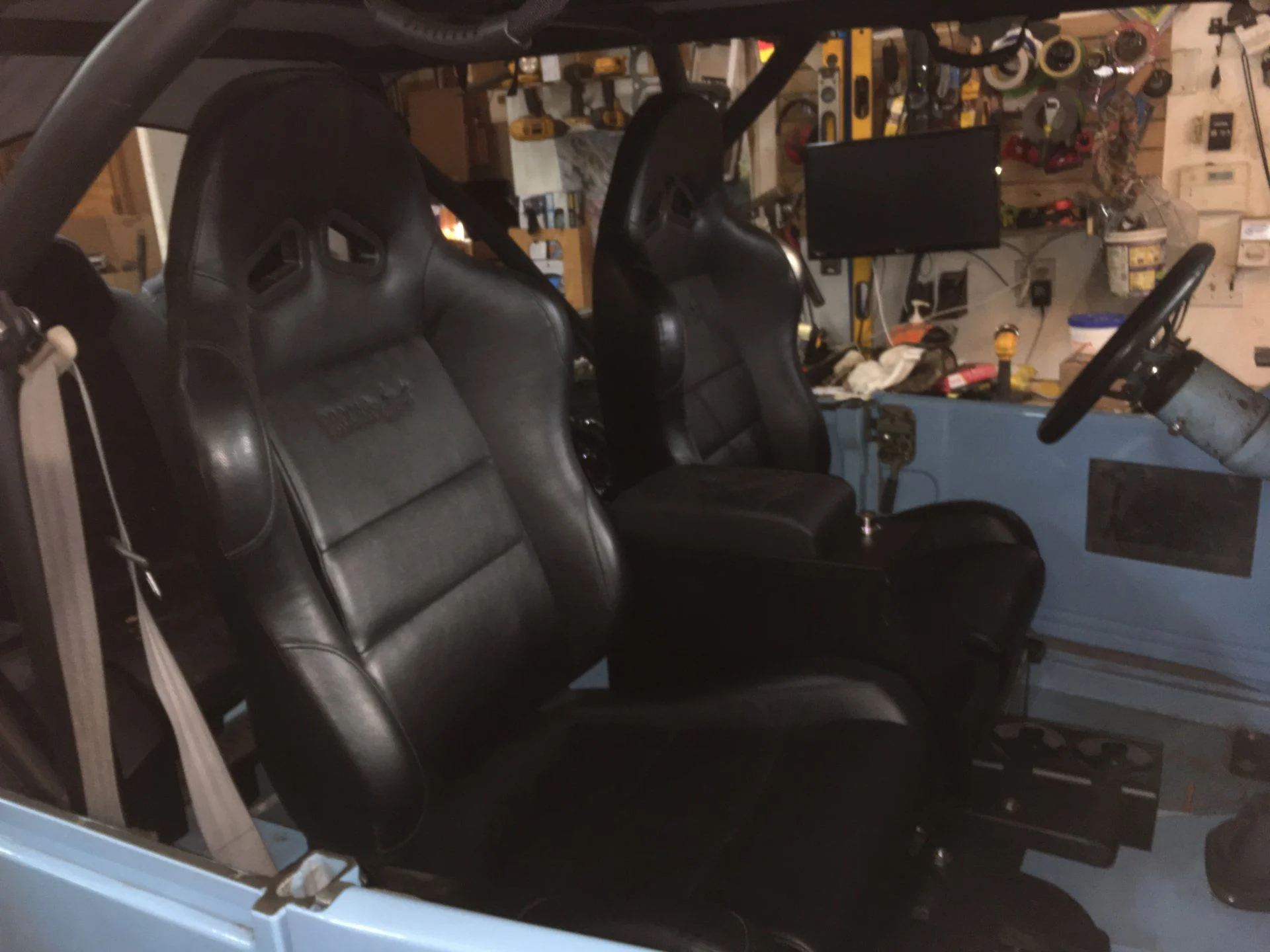

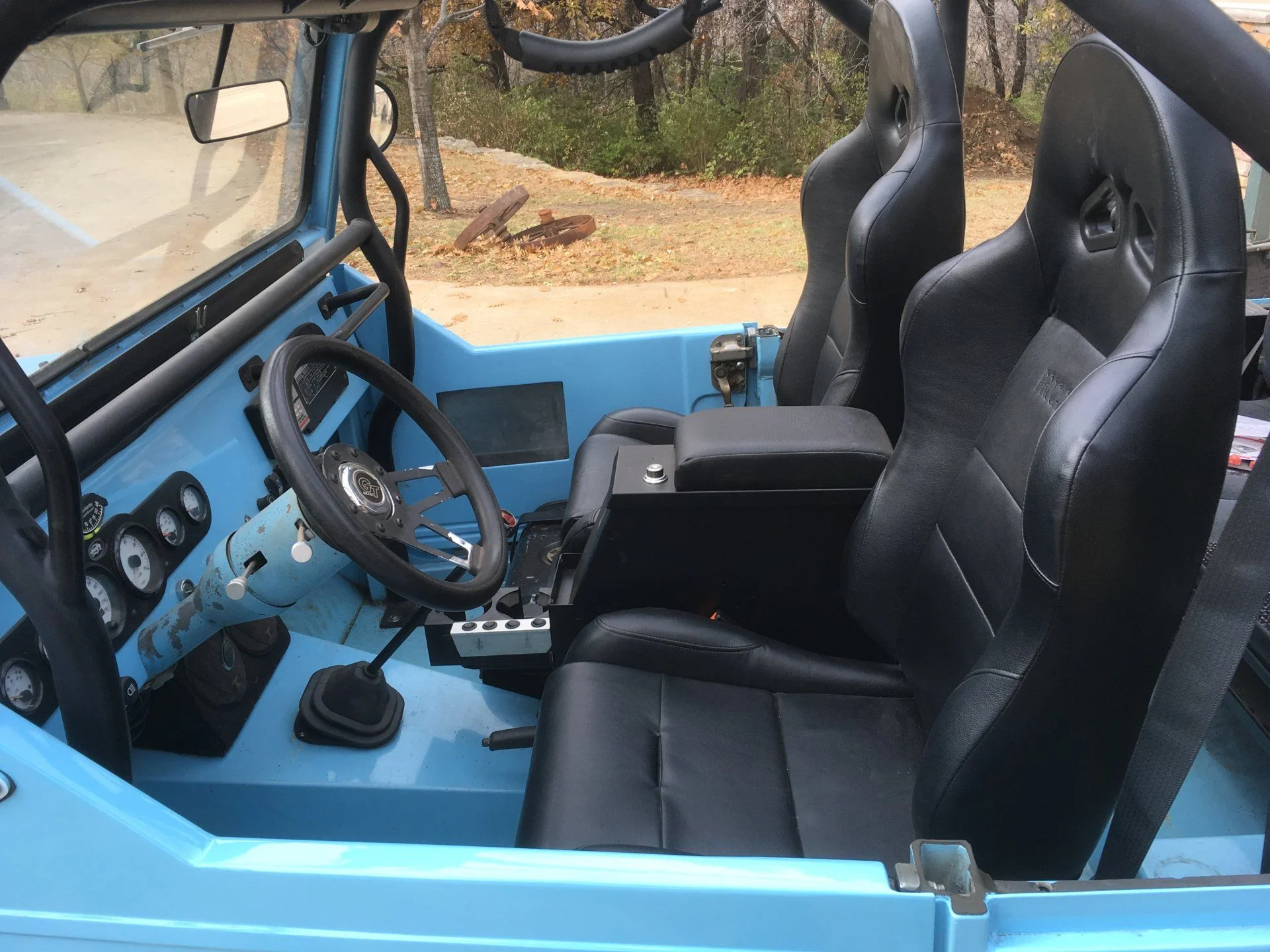

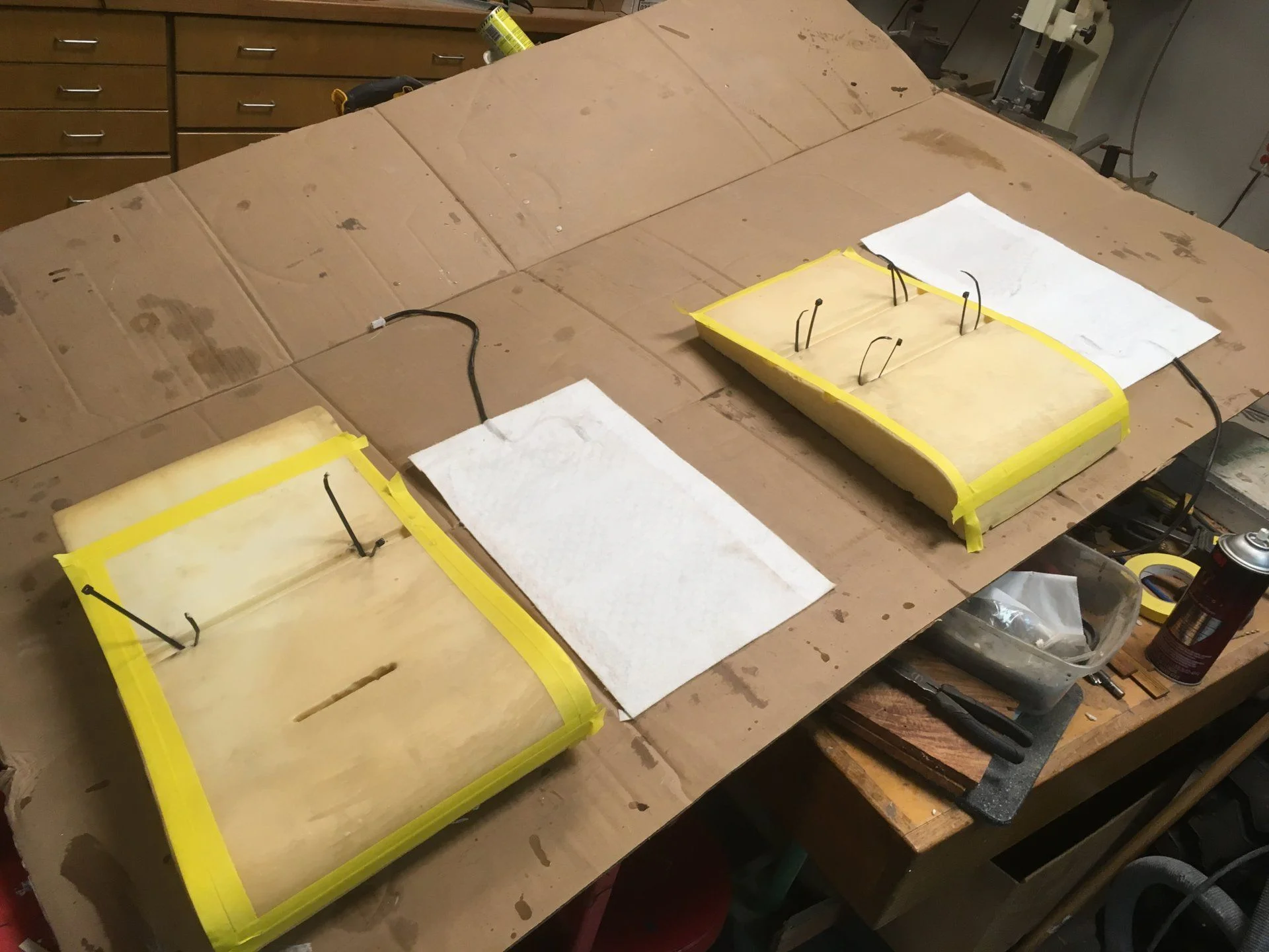

Well this weekend started with trying to get seat heaters put in the seat the Santa brought last year that have been sitting in my shop. That took about three hours to get completed. Then I decided to go ahead and install them, that then wiped out the rest of the weekend. Well, some jobs just take way longer than you expect. Main thing was that I found out that the seatbelts and seats were attached with really flimsy thin steel. 1/8 steel and light gauge square tube - 1/16 wall. I also wanted to get the seats moved back and low as possible -- so out with the old and fabricated all new parts.
Ended up making almost everything out of stainless, except for the strap and plates on top of the gas tank. I’m going to put a plate on front of the driver seat frame to give more under seat storage. Went to put the tuffy box center console in, but it was too wide as it had the radio part in the front.... will have to sell it and buy the 6.5" unit.

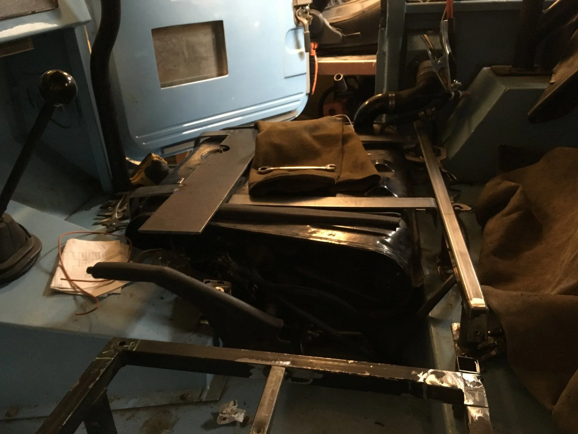

Got the front panel made for the seats then started working the seat belts and realized that I had to make a new mounting points Made the front panel lot of 14 gauge stainless bent on three sides to fit, should be stout enough to hold a fire extinguisher
New top seat belt brackets are bent quarter inch stainless steal

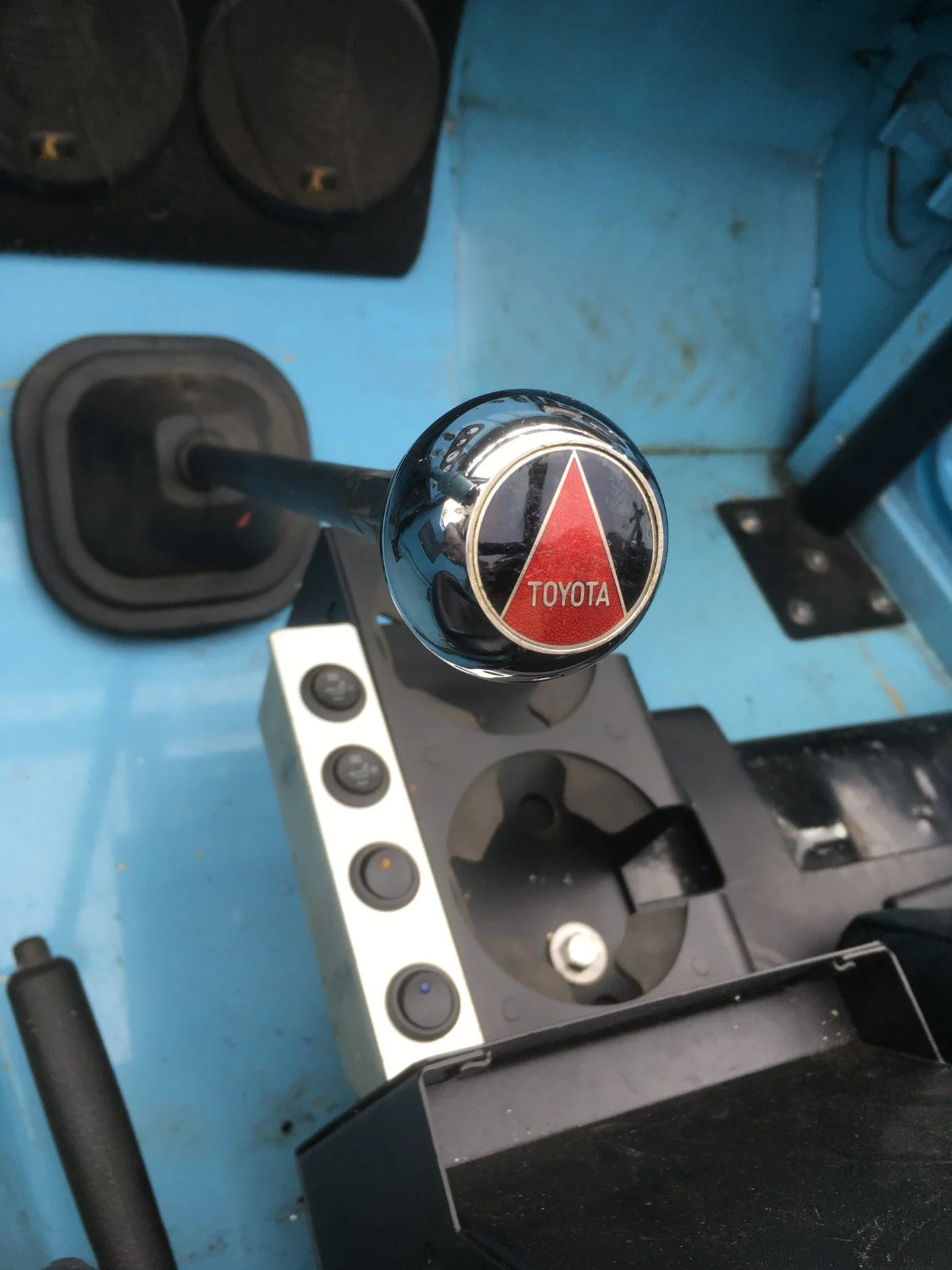

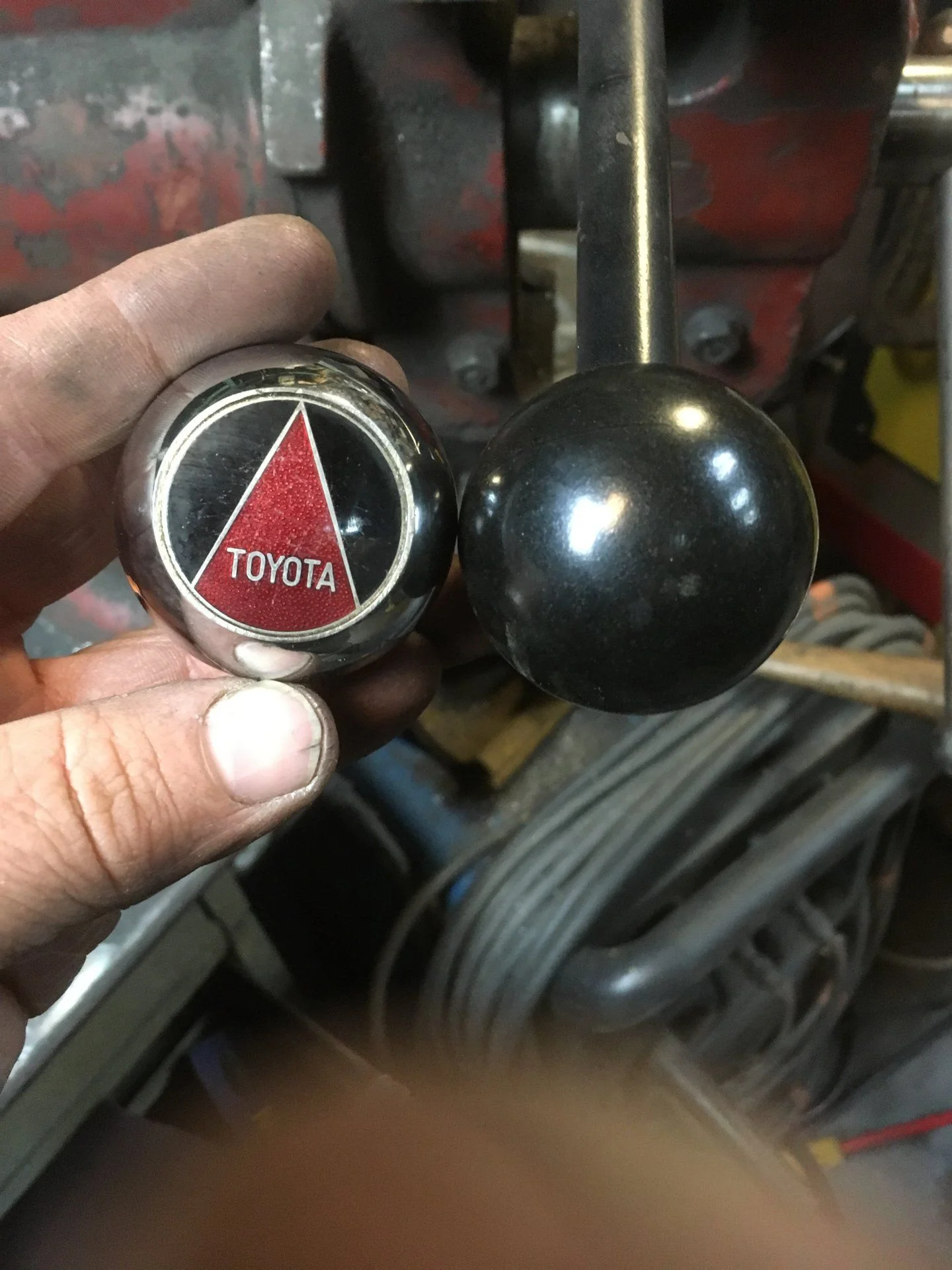

Finally, started working on new shifter knob. Couldn’t get the old knob off, must be Epoxy’d on.
Seats and Tuffy box are in, but realized I had not installed the seatbelt Female receiver side. Oops.
Can't figure out a way to mount up the seat belt receiver side. Only about 4" long, and no place to mount to seat, so did some quick mud research, and ordered a set of HMMMV seat belts.
Oh well....
Gives me time to wire up the seat heaters.

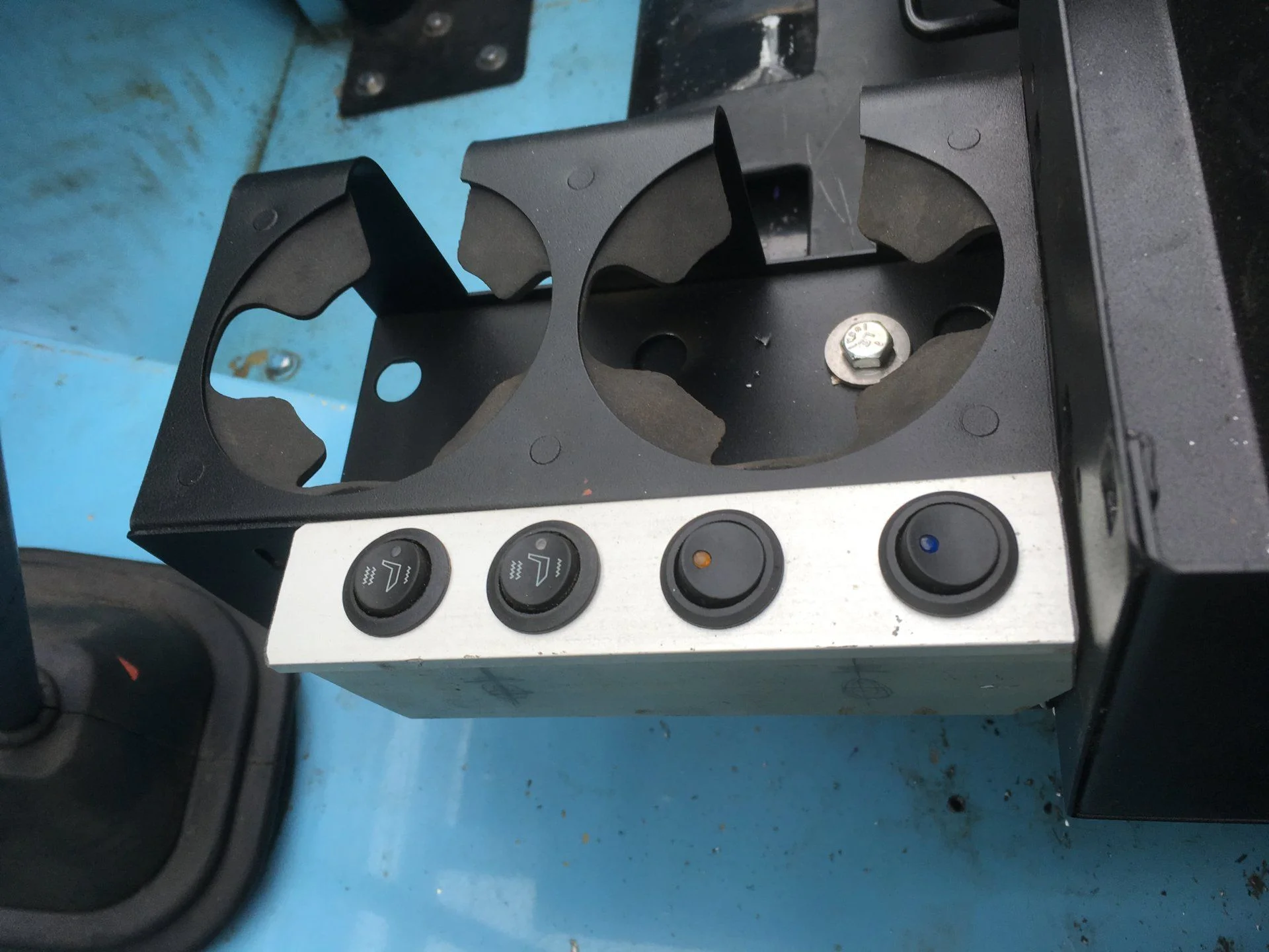

The seatbelt came in so installed those and then wired up the seat heater switches and two additional switches to run lights. Also got the old-school knob installed
One will be interior lights, the other will be front lights

In case your wondering where that aluminum came from that the switches are in..... next time you are in an old bathroom with partition walls, you might see this extrusion, the top structural piece tied to the wall. Maybe I am a hoarder.

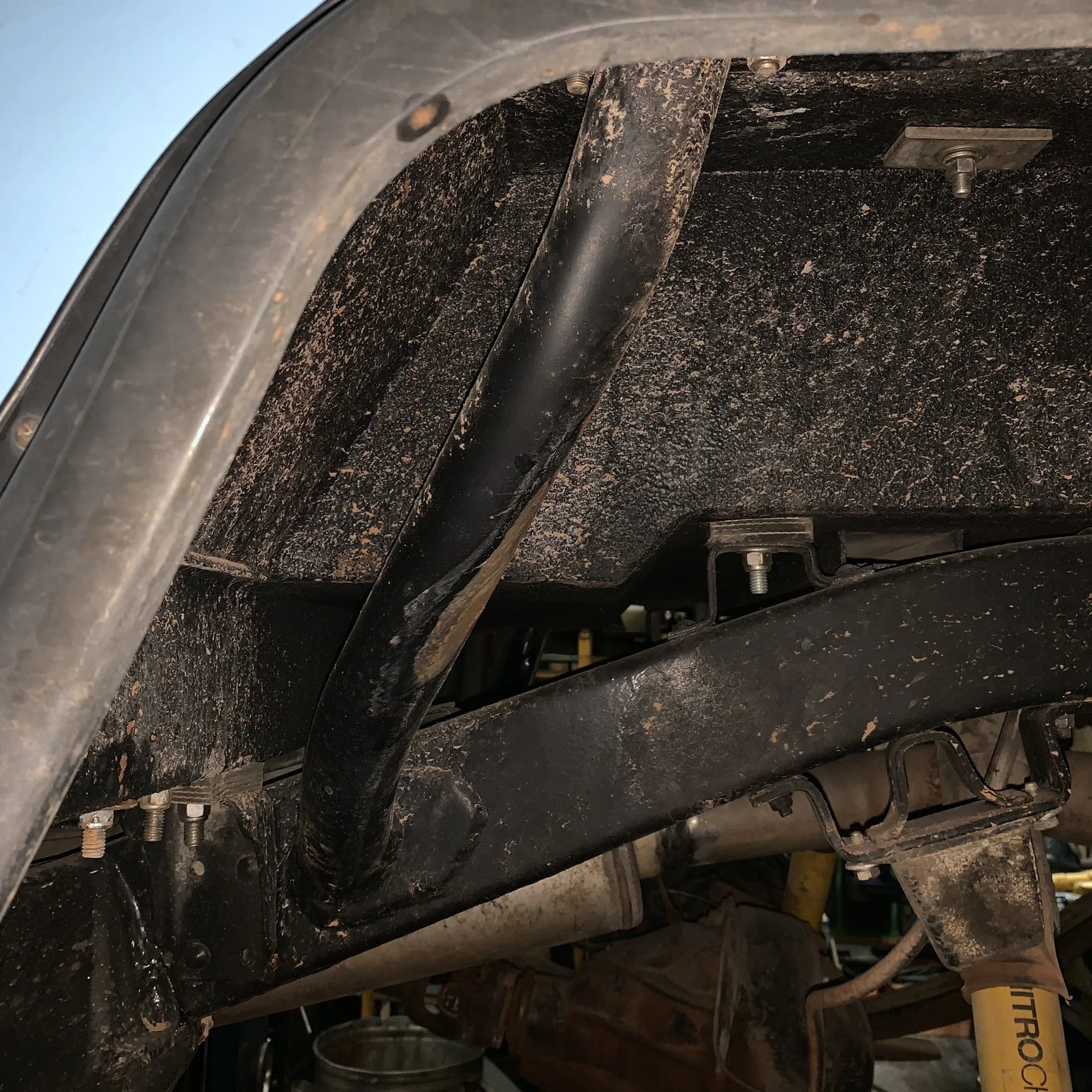

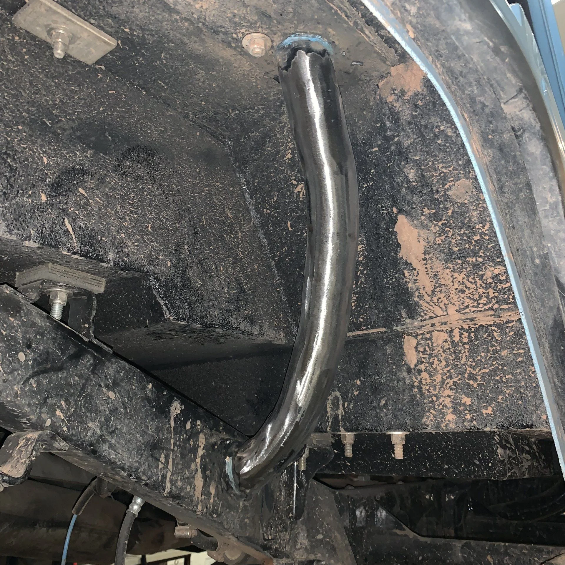

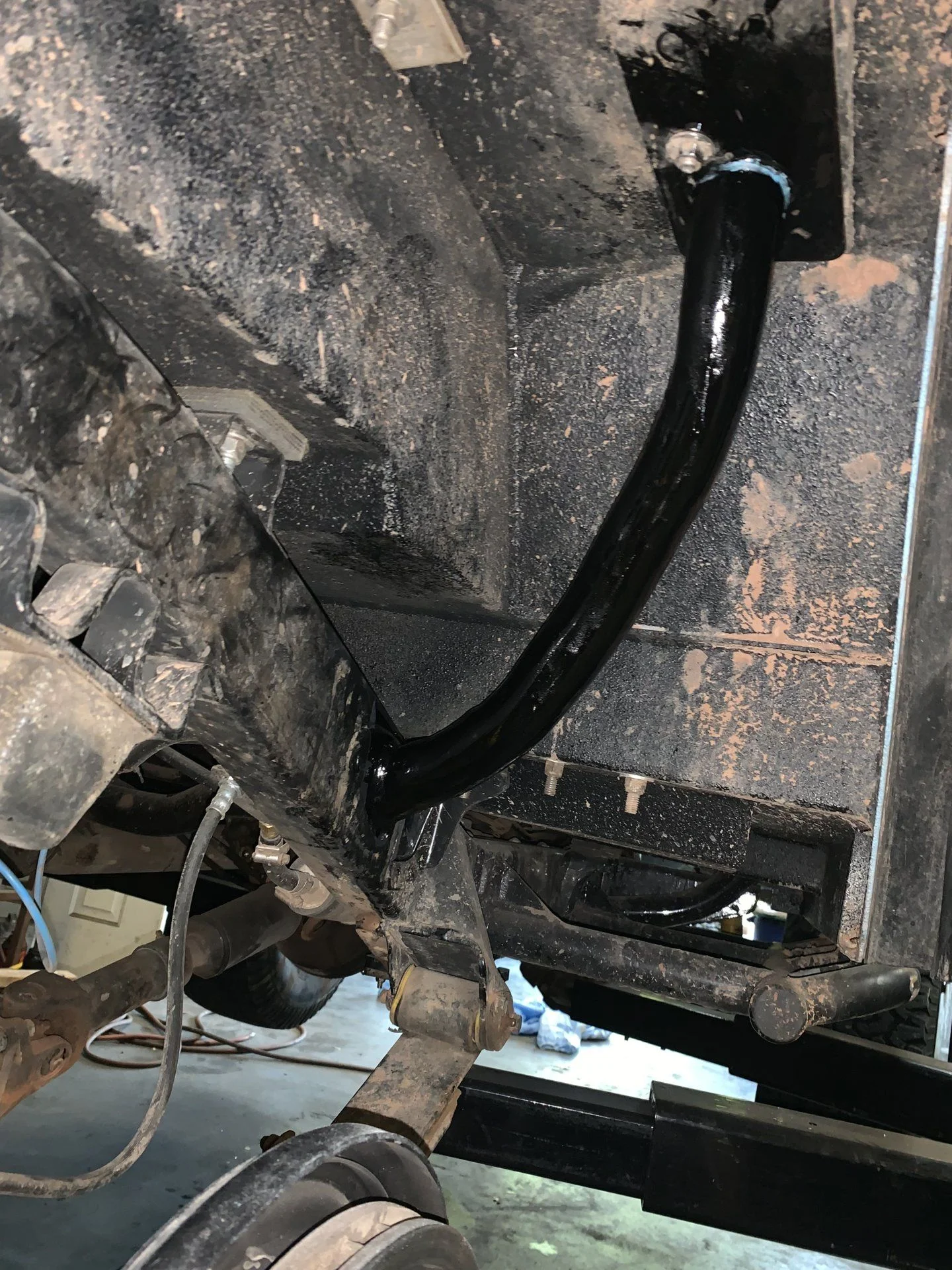

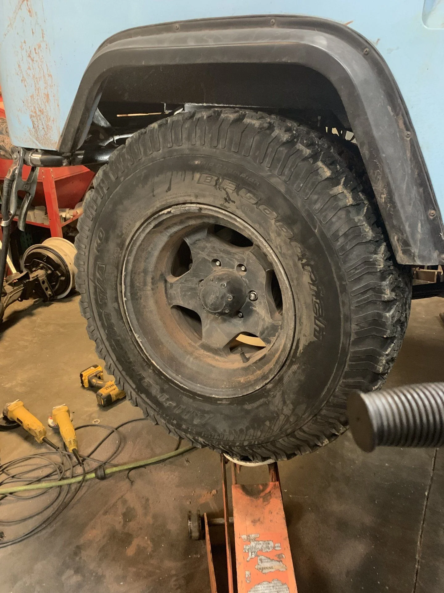

We found out in Moab that I had an issue with tires in the rear wheel well rubbing on my frame to roll cage links, so starting to do the chop work to get them moved

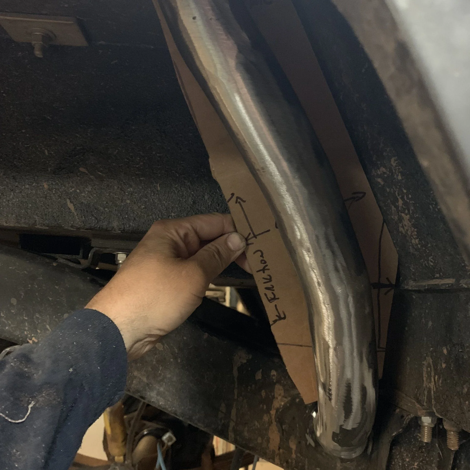

Got one side welded up. On the center one, I did not want to change the mounting points at the top or bottom, so I just change the bend of the pipe. The cardboard is original size
The rear was moved back about 3” total
I forgot to take a before picture of the passenger side, so here’s before on the driver.
Got the new structure finished and painted
