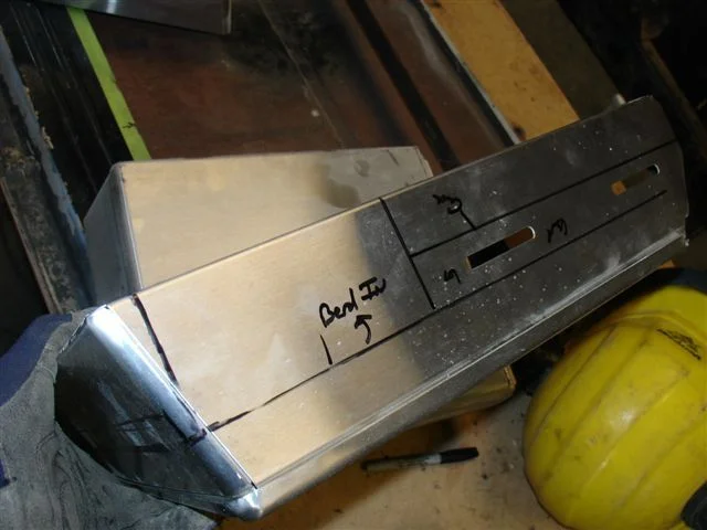

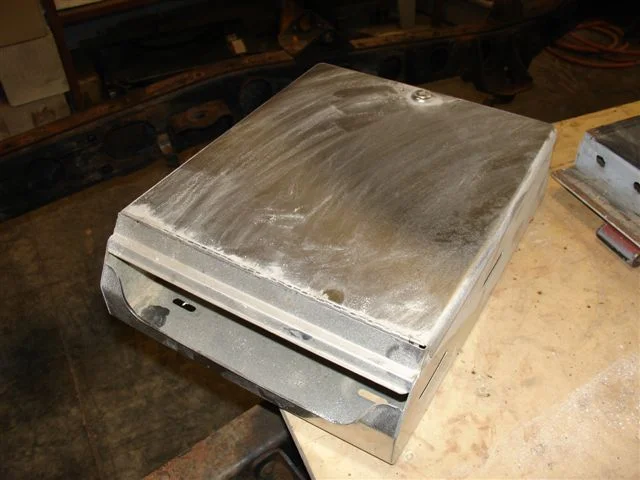

My issue with the inserts was how could I protect them from rust. I looked through a junkyard, and could not find anything close to what I wanted. I could make them from metal, but I didn’t think I could paint them completely if I made a pocket 8” deep, and still be able to weld them on. (I don’t want phantom rattles) One day I was looking at my shelf and I saw an stack of old stainless steel paper towel dispensers – the kind from commercial restrooms that were stocked with 3”x 10” folded towels. I thought that if the frame were narrower, they would be perfect…. Stainless steel, no need to paint them, and rust will not be an issue. Now, before you say this is way too difficult, or “you have to be an awesome welder” – the way this goes together, all the welds on the paper towel dispenser are not visable when you are done, so they can be as ugly as possible. Also, when completed the “viewable” section of the dispenser is actually the inside of the cover (hinged piece that you typically would have seen the outside of when looking at it hanging on the wall) As you can imagine, this would not of got any abuse, and all of mine were in excellent condition with no scratches. Also, the depth does not need to be precise, because this cover overlaps the stainless frame. This gives you a good ½ of movement. I did not weld these pieces together until my final fit, so I could give some pressure (structure) to my door to keep the outside straighter.
I kind of skipped ahead there, so let me back up. With nothing to loose, I marked one of the towel holders with some estimated cut lines, cut them with a cutoff wheel,
banged on them for a while to make the bends, then welded them up. Honestly, they look ugly, but again, these will not be visable.

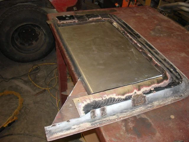

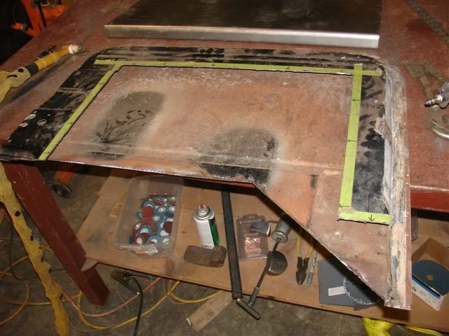

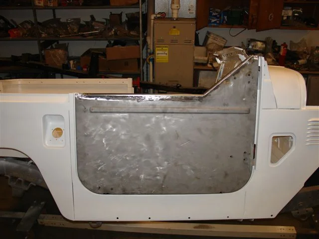

For cutting the door, I wanted to clean up all of the messy indentions on the door, to make it as clean as possible. I left the bottom two indents in the door, and I wanted to keep the original hardware, less the outside handle, so I left enough on the door to keep the mounting bracket. This was a deeper part of the door, so I bent it down, by putting a 1.5” angle iron scrap in the door temporarily and made a bend to contact my new skin. So, the hinge side, bottom were the same level, and the striker side was bent down the ¼ inch to meet my new skin.

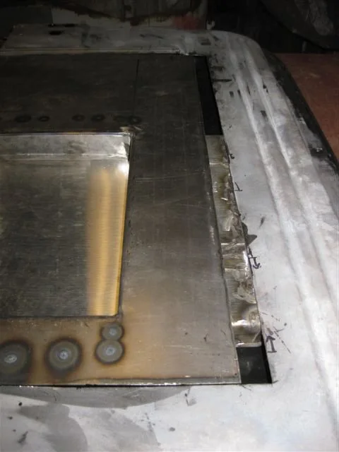

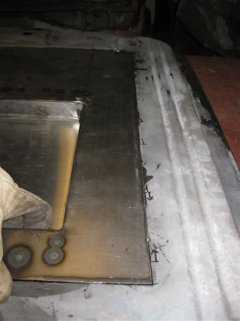

I bent a profile I liked for the door on a brake at a local school out of .060 metal. I wanted on the outside to be a nice tight profile, so I made two 45 degree bends about 3/16 apart to get my outside bend. On the inside, I thought that a nice half round looked good, so I made 8 markes about 1/8 apart, and basically made 12 degree bends on each one. This made a nice rounded profile.

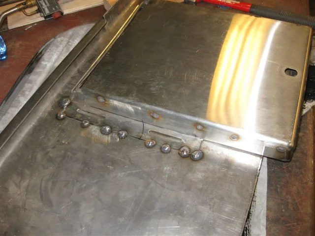

After a lot of cutting and fitting, I had my main piece that I allowed to extend as far as I could across the door to add some additional structure to my door. Then, for the opening for the stainless cubby, I cut an opening ½ smaller on each side, then bent the metal back. This made a great easy paint line. On the bottom of the opening, I did not crimp the metal tight until I slid the frame of the cubby under it, making a smooth transition.

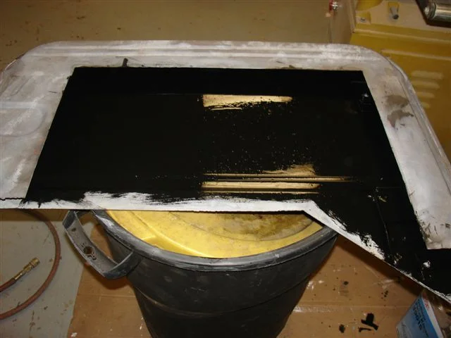

Oh, I forgot, after I did all the rust repair, and filled the holes on the cut door, I por 15'd the inside of the doors.

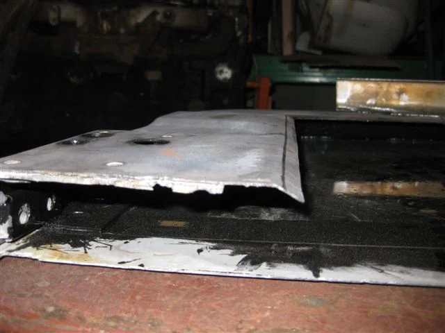

After tacking welding all this in place, ( I also drilled some weep holes in the section that would be hidden under the diagonal section) it was time for the diagonal piece to go in. Again, after some cutting and fitting, welded this into place.

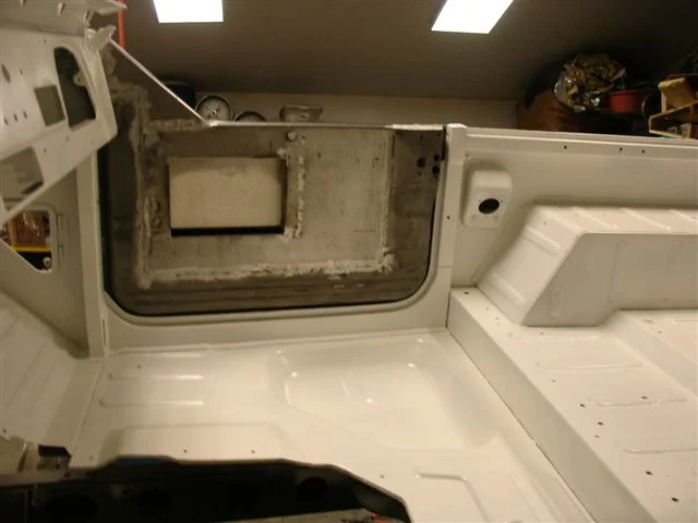

I am very happy with it, and although I know I spent a ridiculous amount of time on it, (and I still have to do the drivers door) I was amazed at how simple it looks. It incorporates the stock Toyota elements, and a nice straight center section. If I squint just right, it looks like it could have been a factory option door.

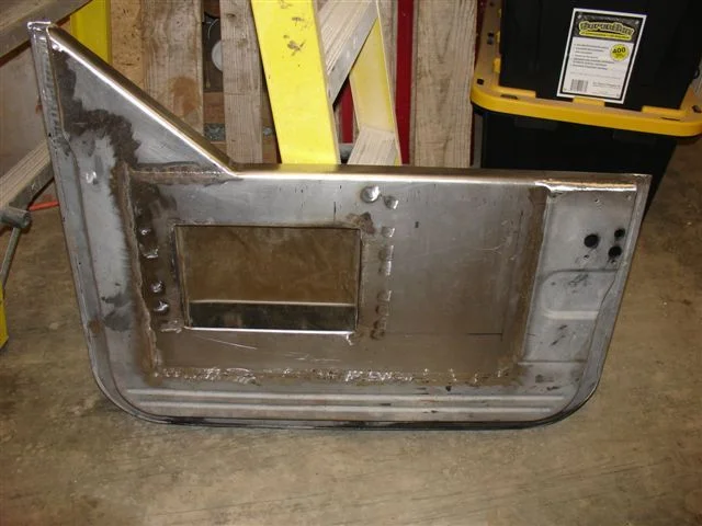

Just looking at the pictures of the cubbies above, there is not a dark line inside of them, that is just shadows from the flash/camera. All you see looking in is the brushed stainless steel.
I don't think I posted this picture of the frame welded to the new skin before I installed it into the door. This may give you a good look at the original outside of the paper towel holder and understand how I did this.
